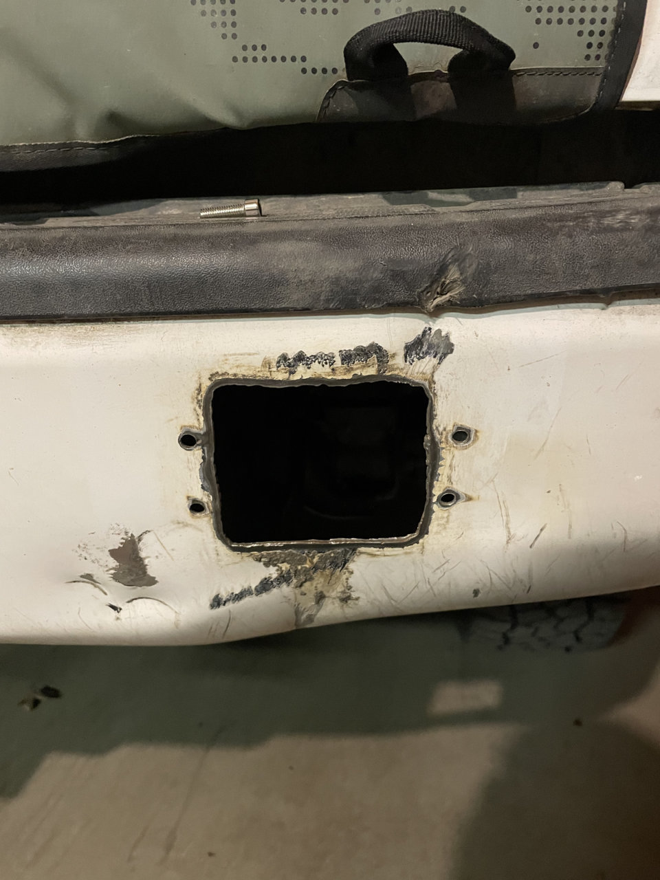

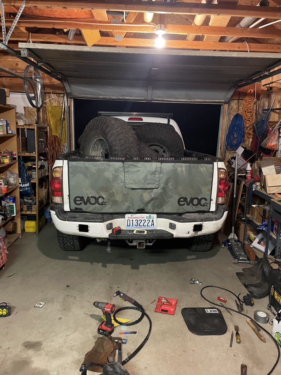

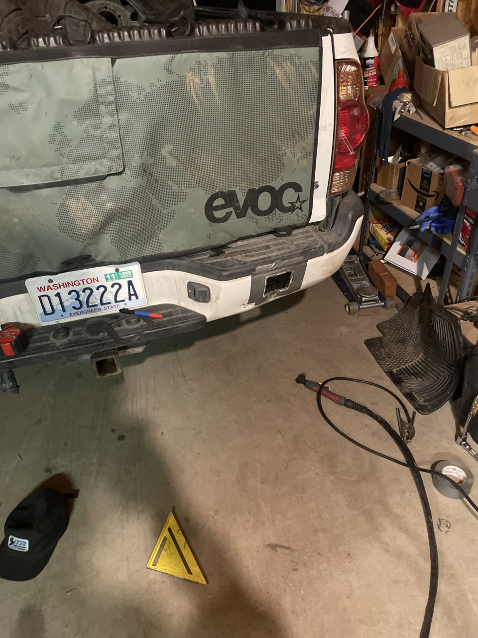

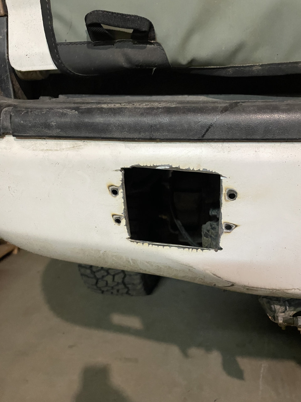

    Put in backup lights and I kinda hate them...
    Roast them praise them give me your opinion...
    Waiting to wire till I decide.
    Siliconed the lenses and strain relief on these guys to hopefully prevent their fogging issues. I tried plasma and grinder for the hell of it, 1/4 of the time with the plasma but you can see the results for yourself. Don't try to use duct tape to prevent slag scarring it just melts the tape and drips
    :bananadead:.
    Also painted the edges of my cuts trying to be more "pRoFFsinal"
    [​IMG][​IMG][​IMG][​IMG]Sneak peek of the 35s to come![​IMG][​IMG]

    No grip zone?

    Nope :anonymous:
