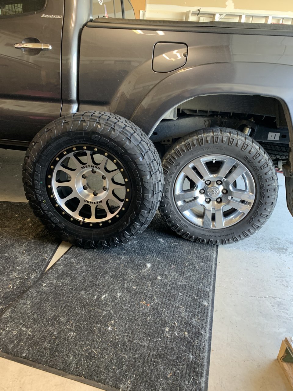

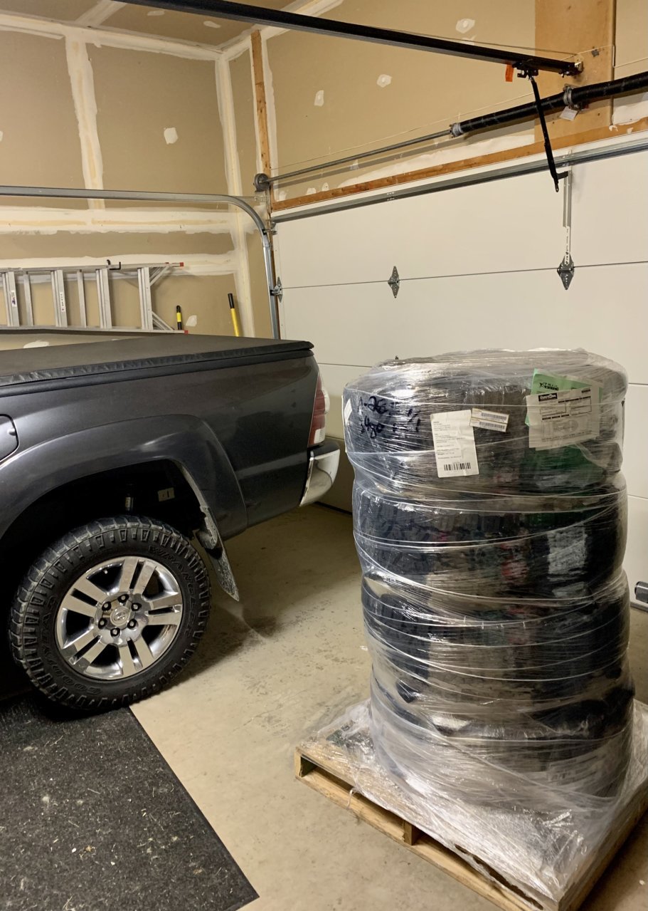

    Unpacked the order ..

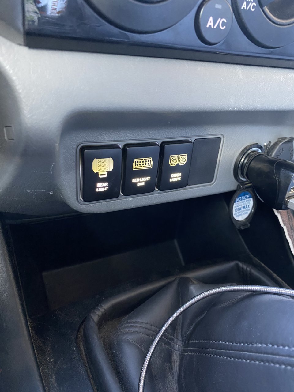

    They don’t yet. But I am doing some research on how I can make it switch activated as well as triggered. I was worried about blinding people in parking lots. That would be nice though for most situations where I backup in the dark.

    SPDT or DPDT (without using the other legs), tap the reverse wire for one throw, constant for the other. I did it on my F150 so I could have them auto-on or on when I want them on, or aux off completely. It's not hard, just takes a second to get your wiring in order.

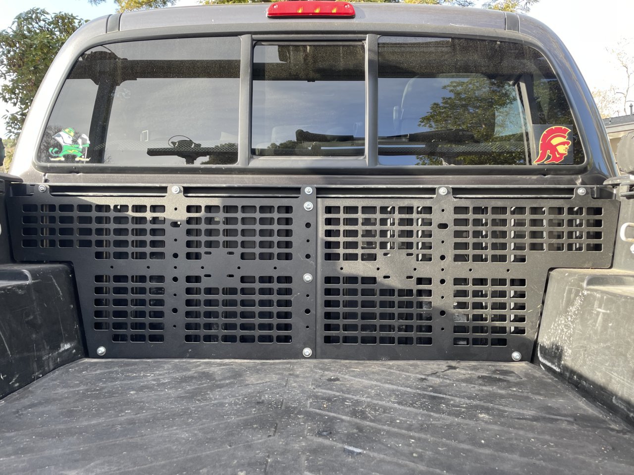

    Installed Cali-Raised Molle panel to front of bed.
    Bed bolts were very difficult to get off - I ended up giving up and hiring someone.

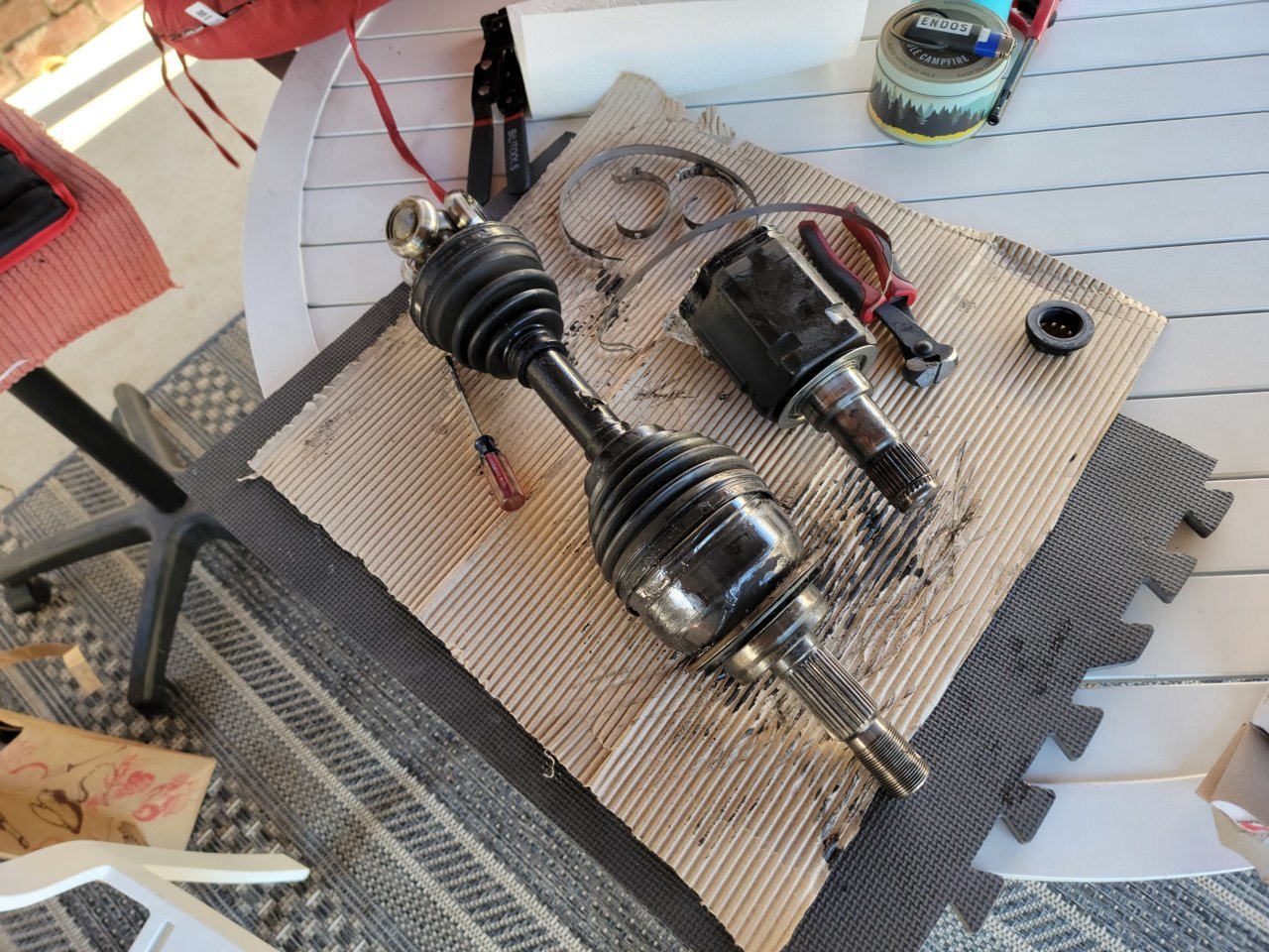

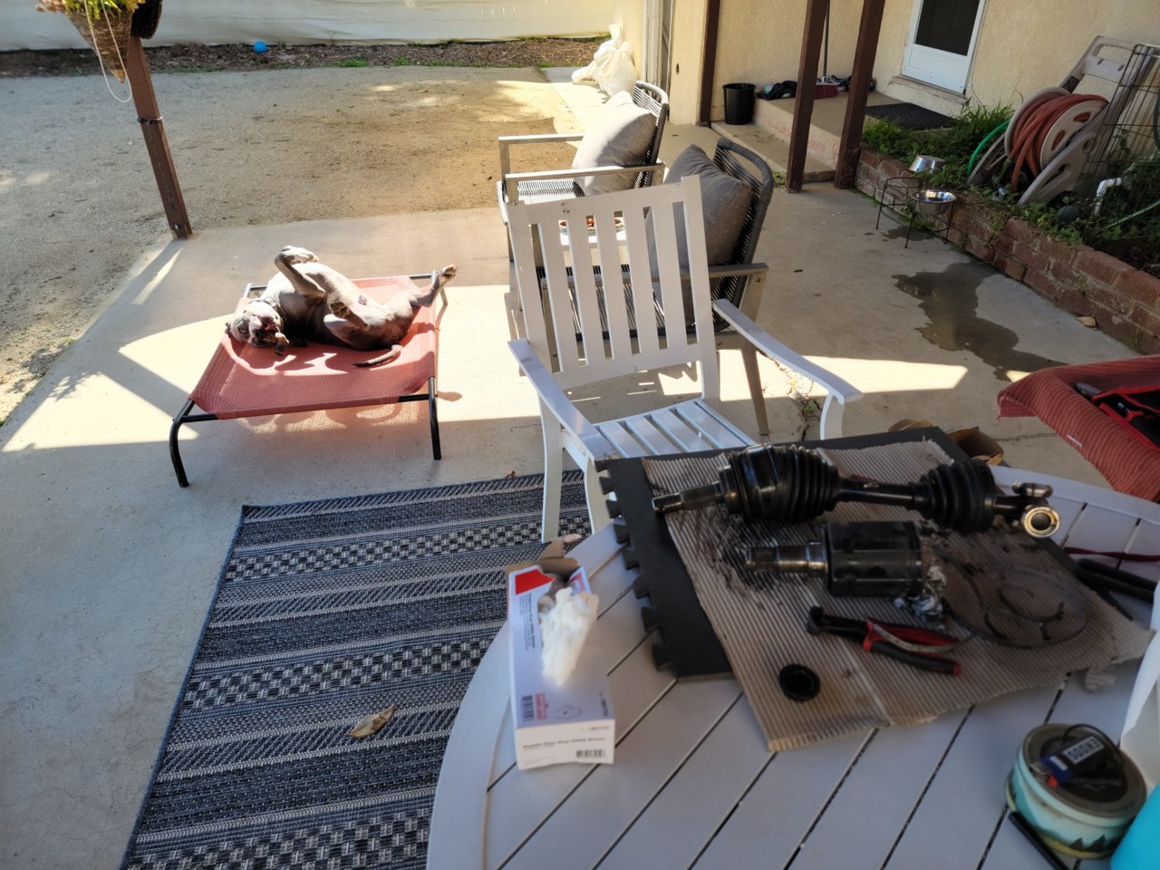

    20230219_121934.jpg 20230219_121923.jpg CV Axle rebuild for a new trail spare. My supervisor is such a distraction

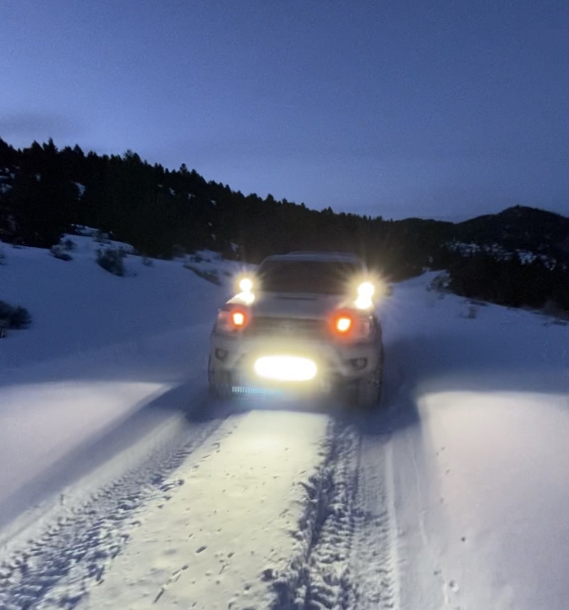

    Welcome to the forum! Your truck looks like it fits right in with that beautiful area and all that nice snow wherever you are.

    That's about the cutest supervisor I have ever seen though!

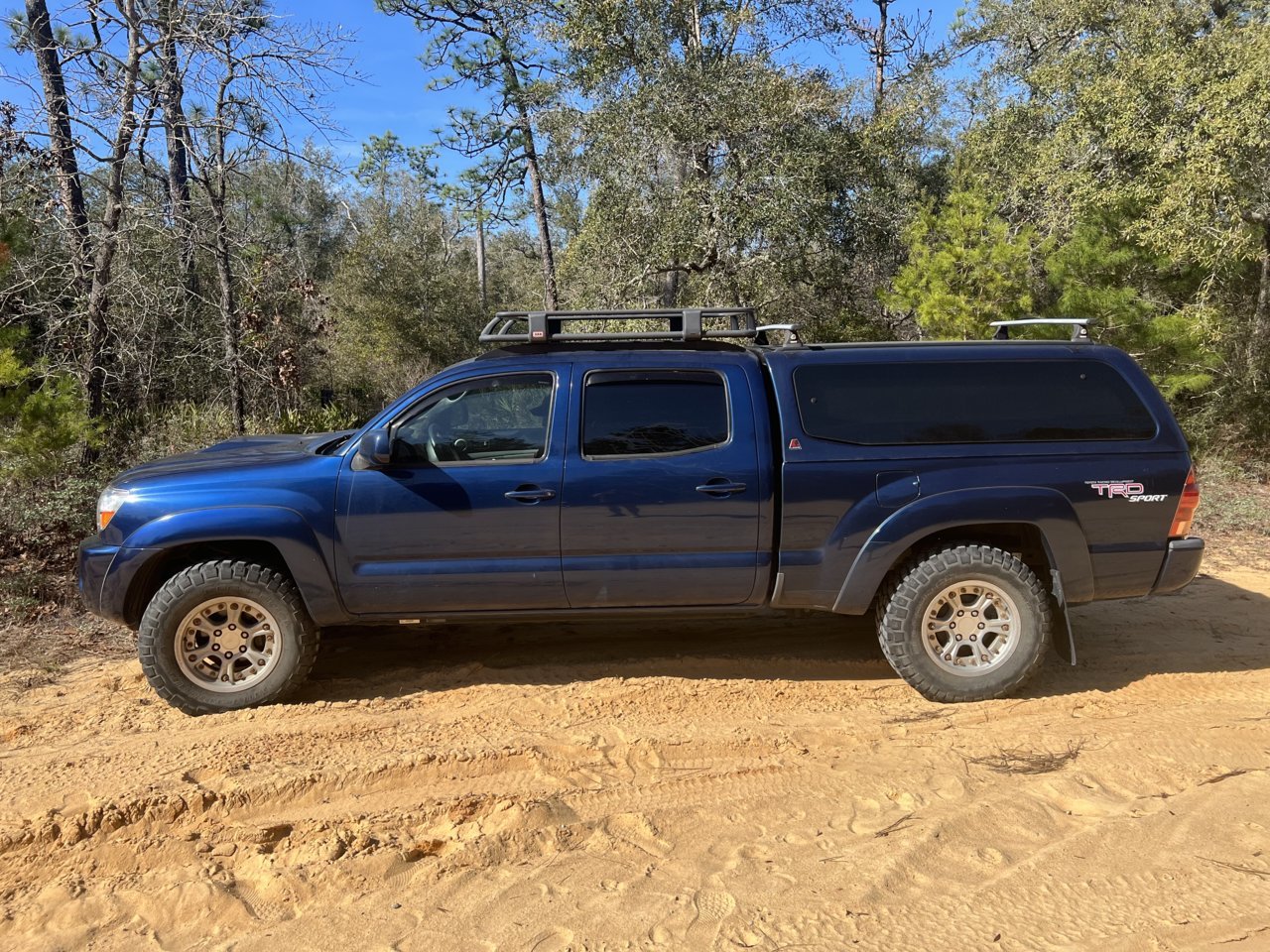

    Got a used camper shell for her. Planning on putting a platform, bed, and shelf system in the back. Anyone know where I can buy new gaskets for the camper shell? It’s a leer 100xq.

    Looks good!!!
