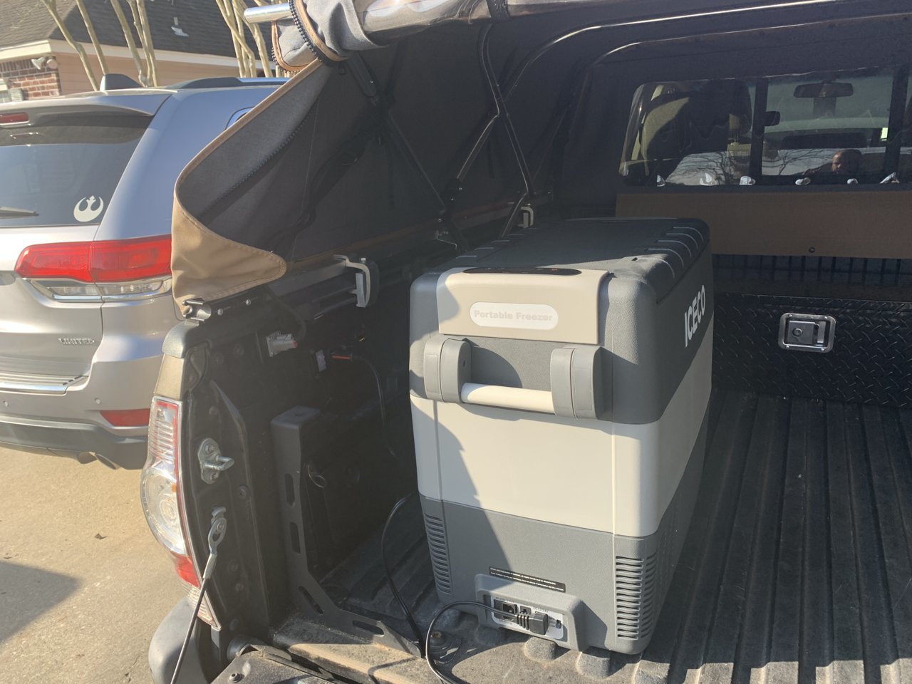

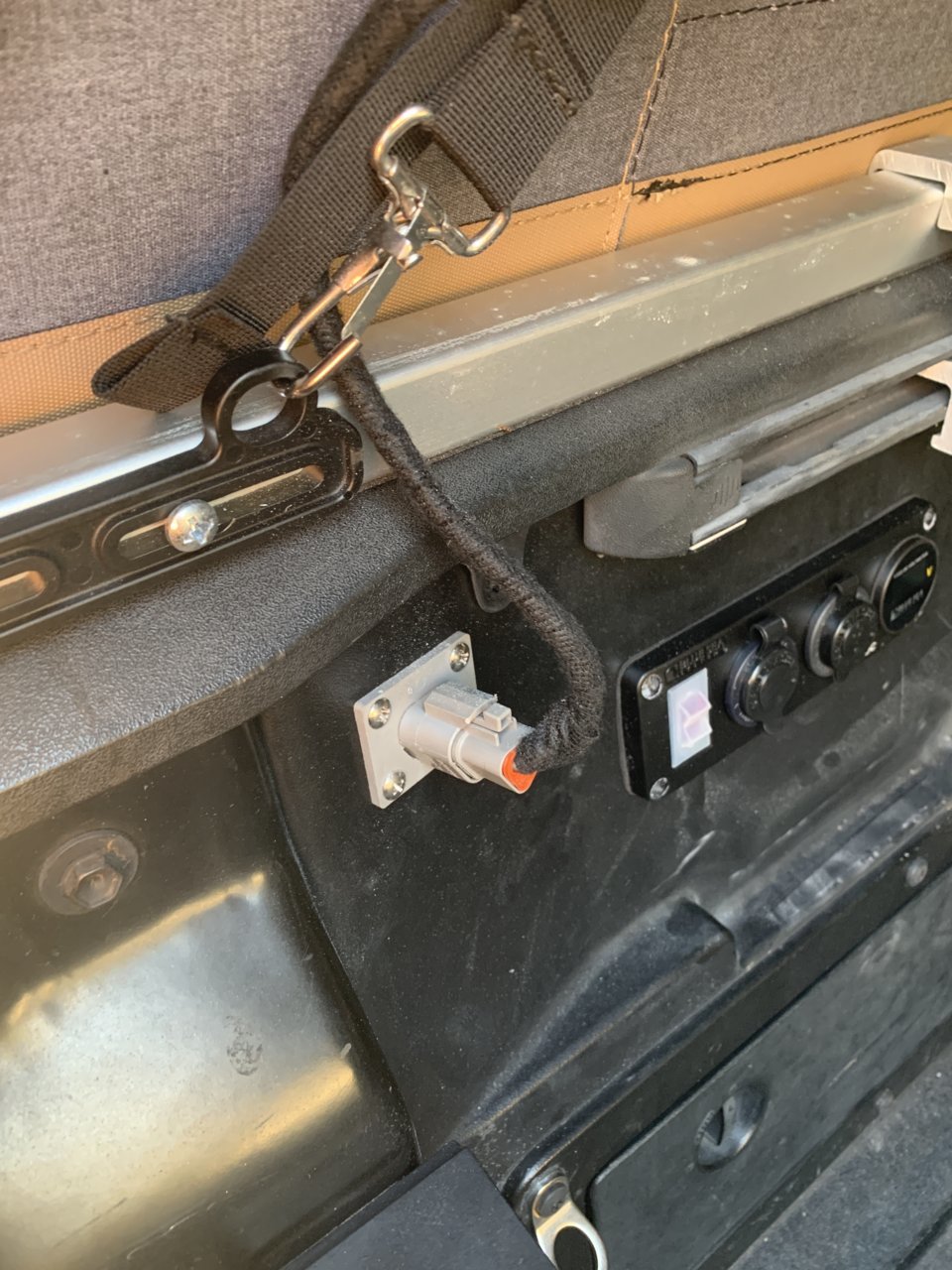

    Finally caught up on a few projects.
    Got a third brake light added to my Softopper. LED has neo magnets epoxied to the back, more magnets on the inside of the top to hold it in place. Wiring is tapped to the brake light via a weatherproof Deutsch connector so I can pull one plug and fold the top down.

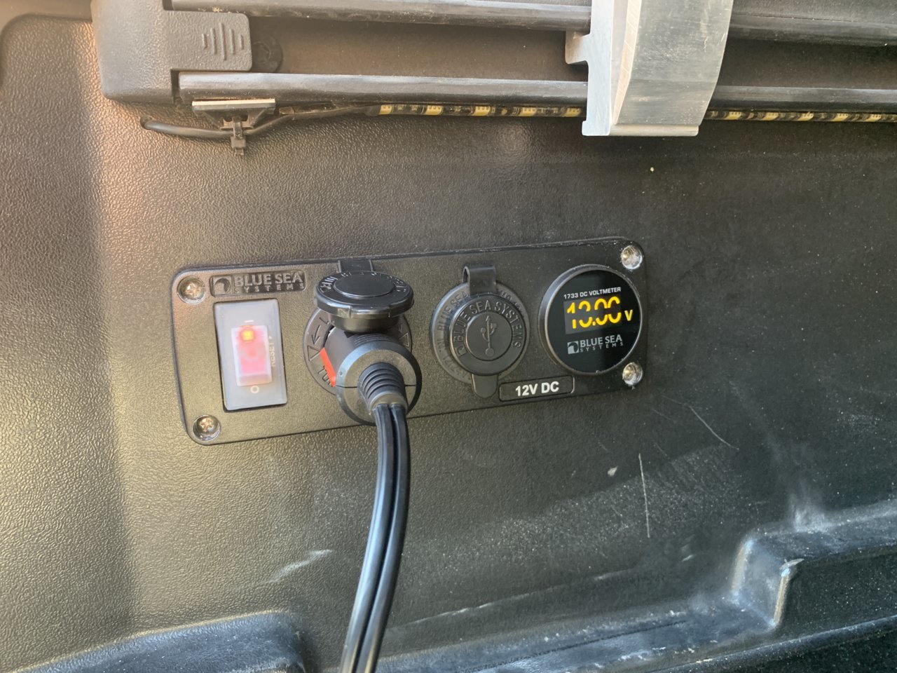

    Also finally got my Blue Sea Systems panel installed in the bed and power run so I can run the Iceco fridge while driving and not crowd my daughter in the back seat.

    I like the magnet idea, I’m assuming no issue when going highway speeds?

    I’ll let you know when I get it on the highway, but I don’t anticipate it. There’s six neo magnets on the light, six more inside the top, and just one was enough to hold the weight of the light.
    IF they let me down, I’ll just bolt the SOB into the top bow but I’m trying to avoid punching holes in the canvas.

    Pretty much exactly how and where I installed my fuse box and buttons.
    I put a bunch of silicon around the bolts n stuff over the fuse box

    That's a great idea routing the brake light to a plug mounted in the side wall of the bed. Beats the heck out of having the connection dangling around like I do. Looks like I found my next project. Where did you find that at?
