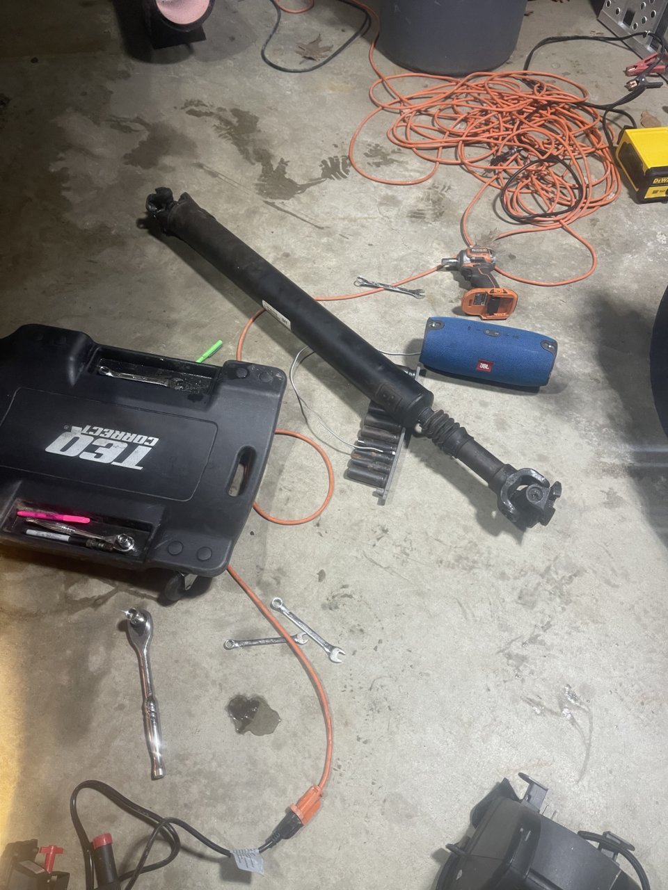

    Update: driveshaft is out, u joints move freely on one axis and super stiff on the other. Praying that that’s my vibration issue

    Grease the slip yoke while you have it out.

    Red n tacky work okay for that?

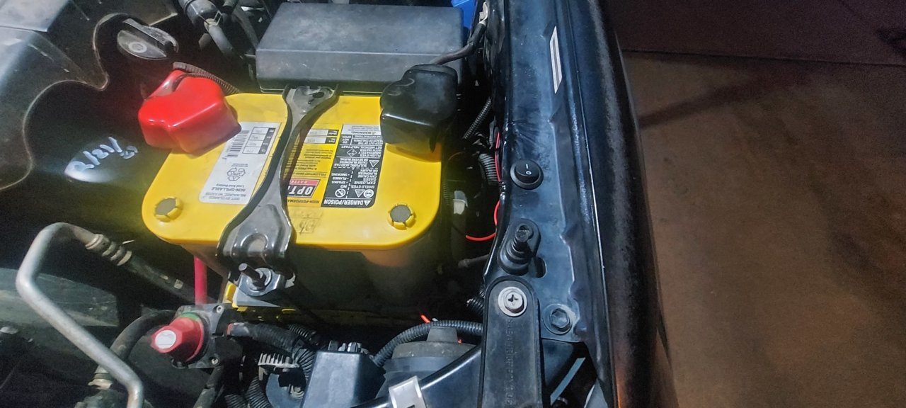

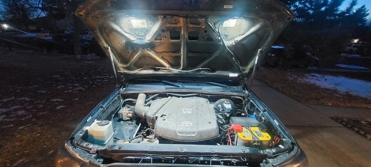

    Got some rock lights as a Christmas gift and I'm not much of a rock lights guy so I installed a couple under the hood. They have a door switch to turn them on when you open the hood as well as a toggle to fully disable them. I also considered I'd have to have the battery out at some point and still want the lights, so I made a jumper cable that connects to the harness with a "weatherpack" connector. Please excuse the dust, I'm lazy.

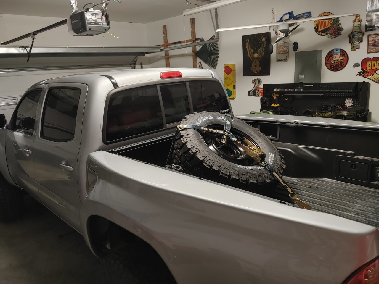

    Bed space delete mod.

    Got the new u joints in. Feels smoother on acceleration and I’m sure they were due for a change (65k miles, assuming they were changed when I bought truck used. If not, 123k miles on em).
    bad news is the vibes are still here. Pretty sure it’s the cvs and tires. Ugh. At least I can say I’ve done u joints

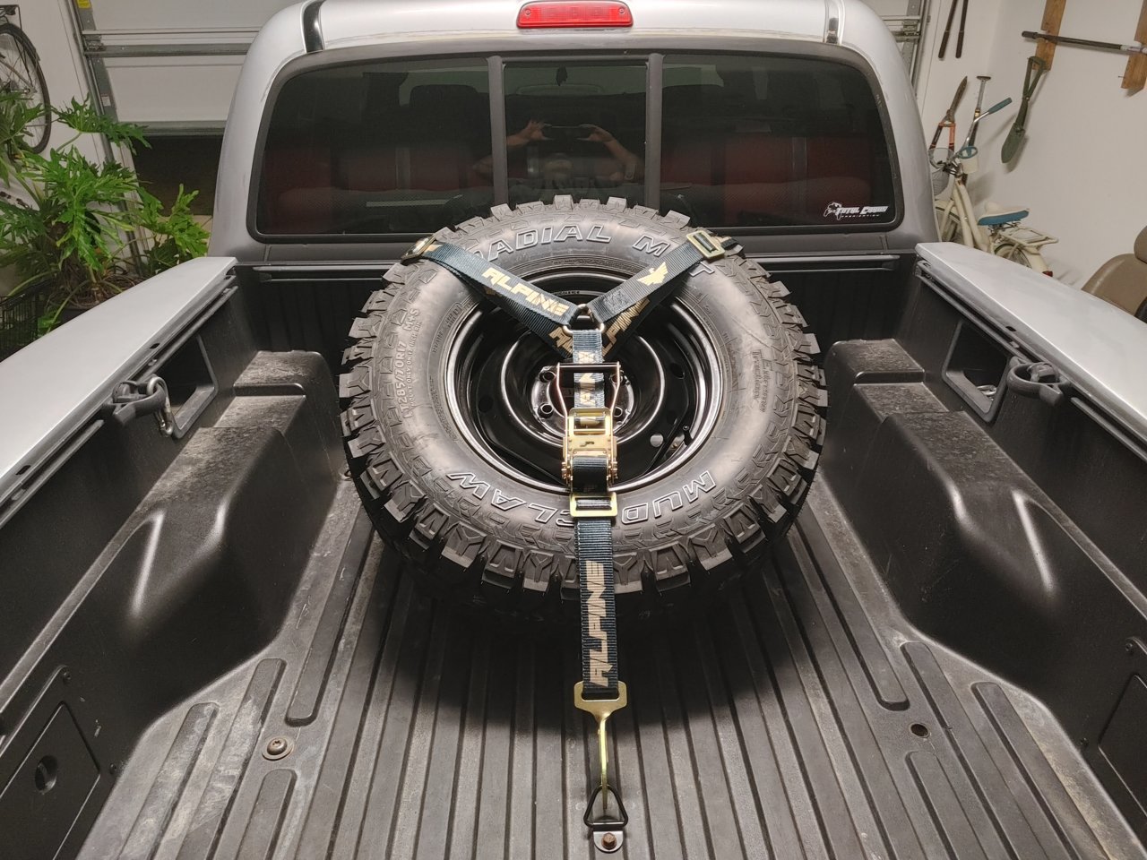

    What do you have under the tire to raise it like that? I've been considering doing the same thing.
