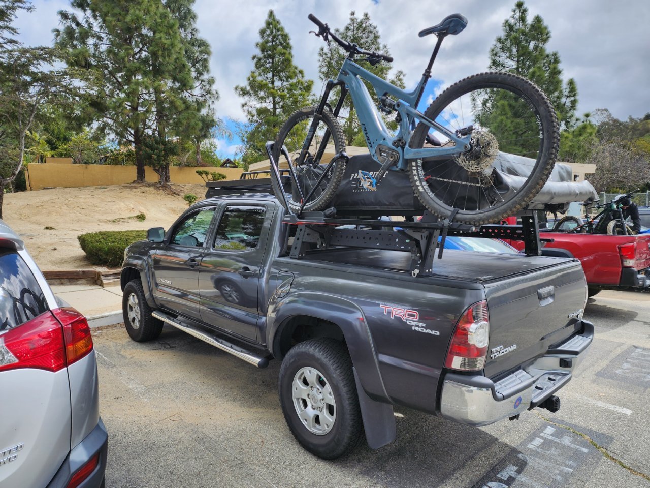

    Not really today, but wanted to be a bit more active posting for fun. Lifted with Bilstein 6112/5160, Dakar medium load leaf with extra leaf added and Archive Garage U-bolt flip kit with superbumps. Truck is only 2WD but got the shocks and leaf pack for a killer deal so I couldn't resist. Here's where I am with the truck now! Got some other things in the works for it.

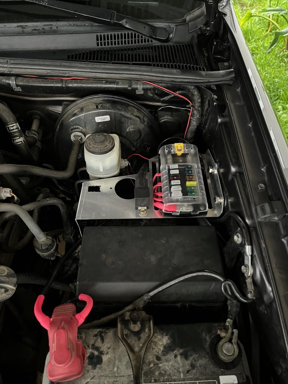

    https://www.amazon.com/dp/B09WYMYQZW?ref=ppx_yo2ov_dt_b_product_details
    Finally got rid of the rats nest my battery was becoming with recent electrical add ons of the ultimate H4 headlight upgrade and harness, an LED bar in the bumper, bed lights, and ARB compressor. Used the Amazon special LAFORMO fuse block bracket for a BLUE SEA 12 ct block. Still need a couple more wires to clean up, and id like to get all the relays mounted on top of the bracket next to the single.
    This was my first big wiring project and it feels awesome when it all comes together and the wires begin to disappear.

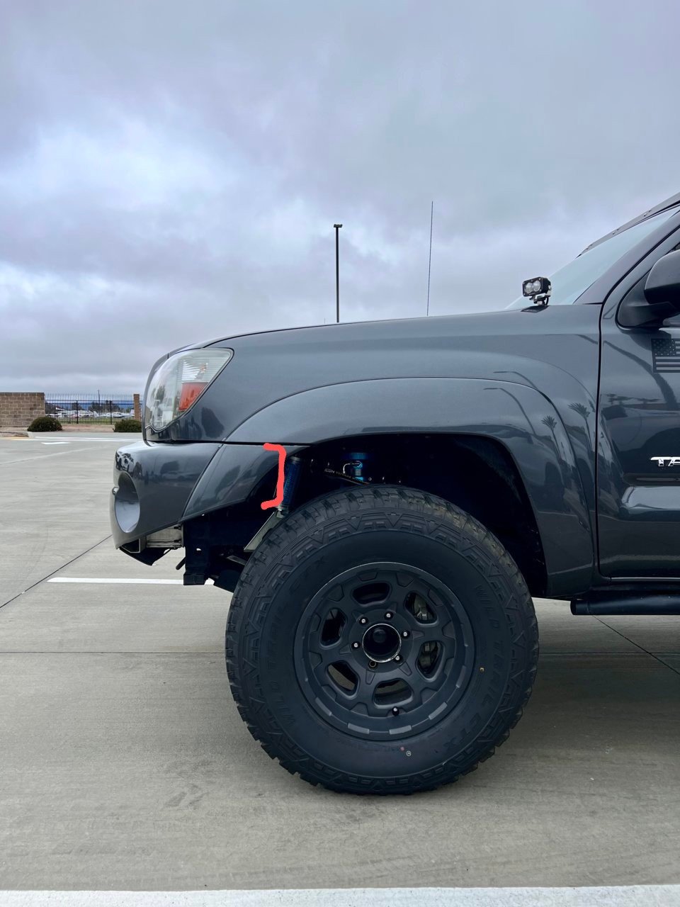

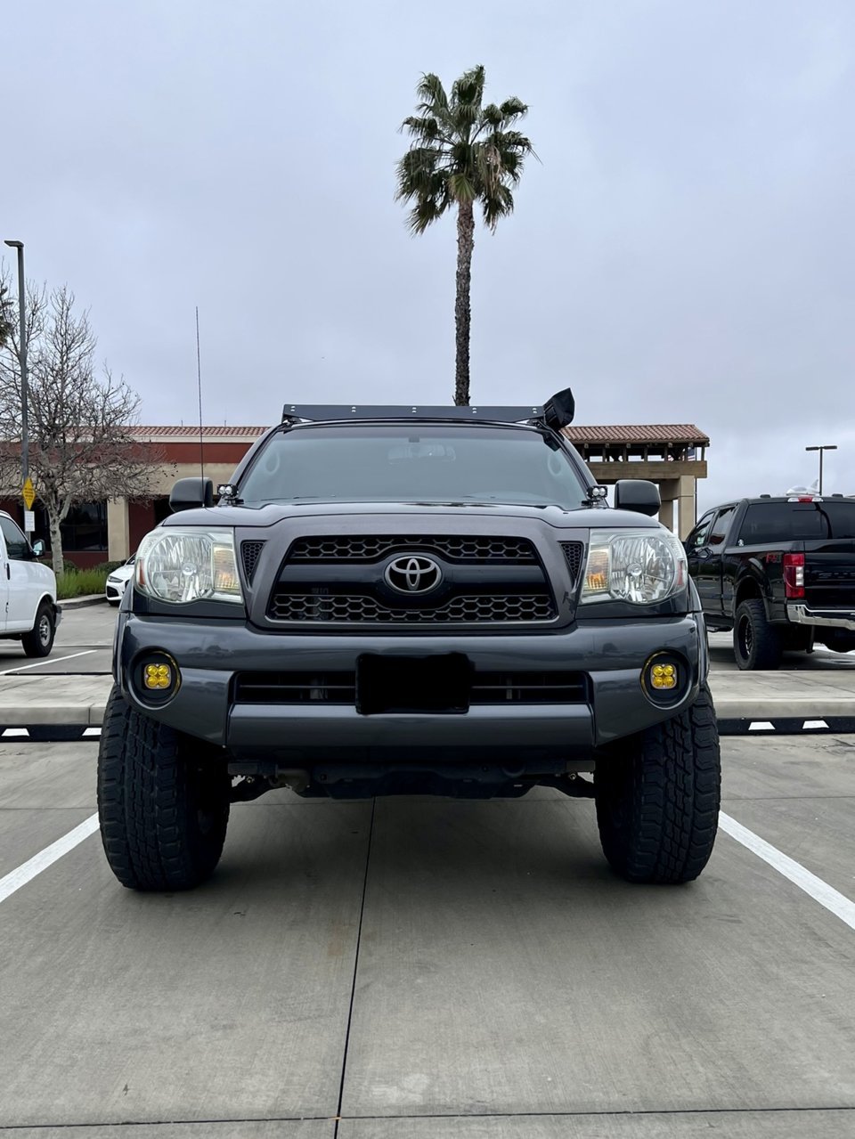

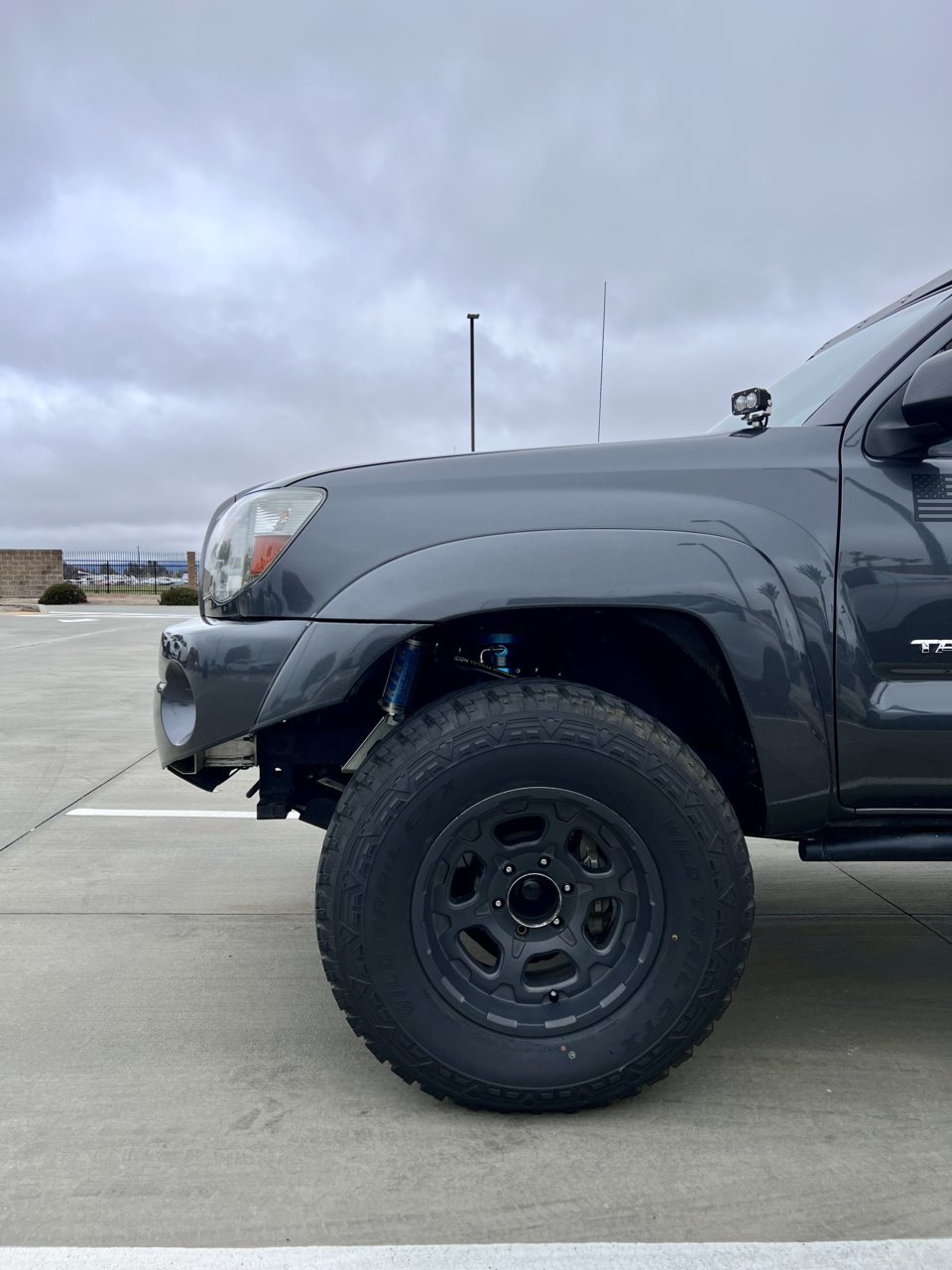

    More photos is more better! I measured and it’s 6” from the top of the bumper to the cut line, it’s about 1 1/4” under the fog light bezel and then it ends where the bumper meets the lower middle section if that makes sense. Again I’m on 295/70R17 and about 2.25-2.5” of lift

    Because I'm dumb and not near my truck, when you say 6" do you mean this dimension:

    Yes, exactly! Sorry I wasn’t too clear on my measurements

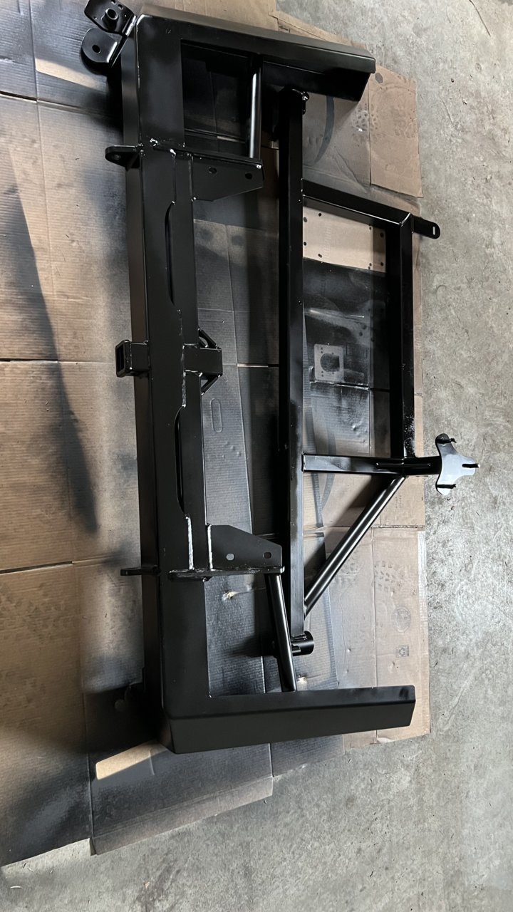

    New frame, Upper control arms, roof rack , method wheels fallen tires duel battery

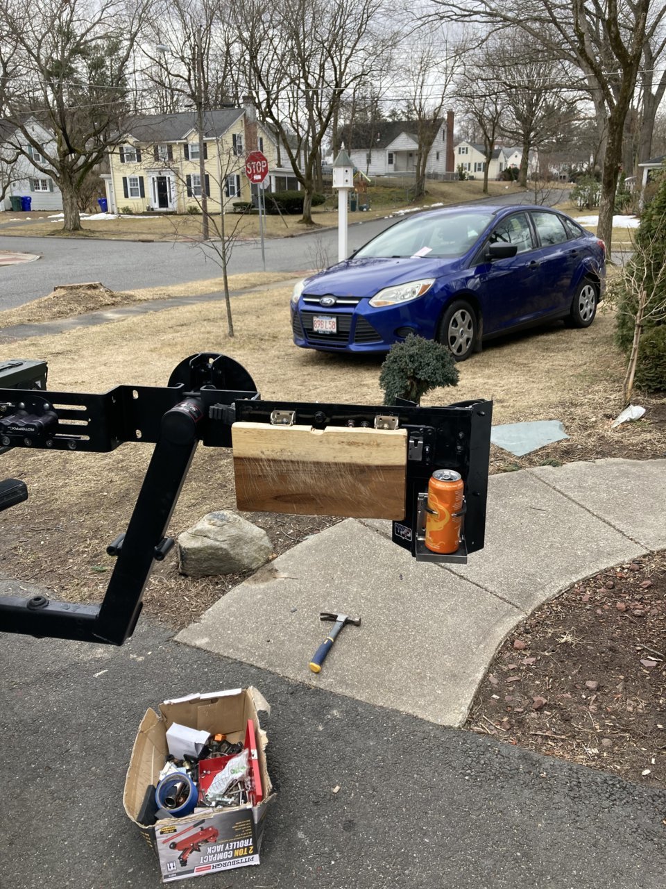

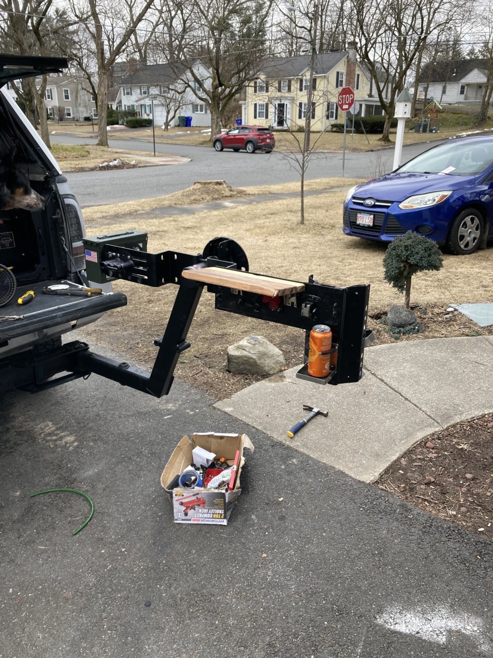

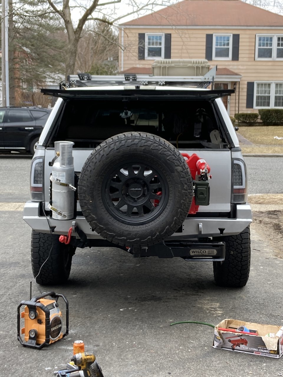

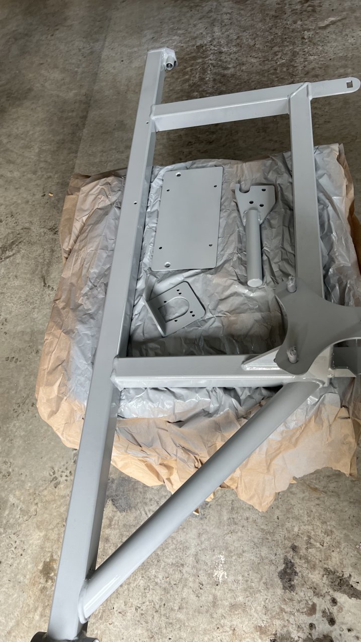

    Set up swing out how I wanted

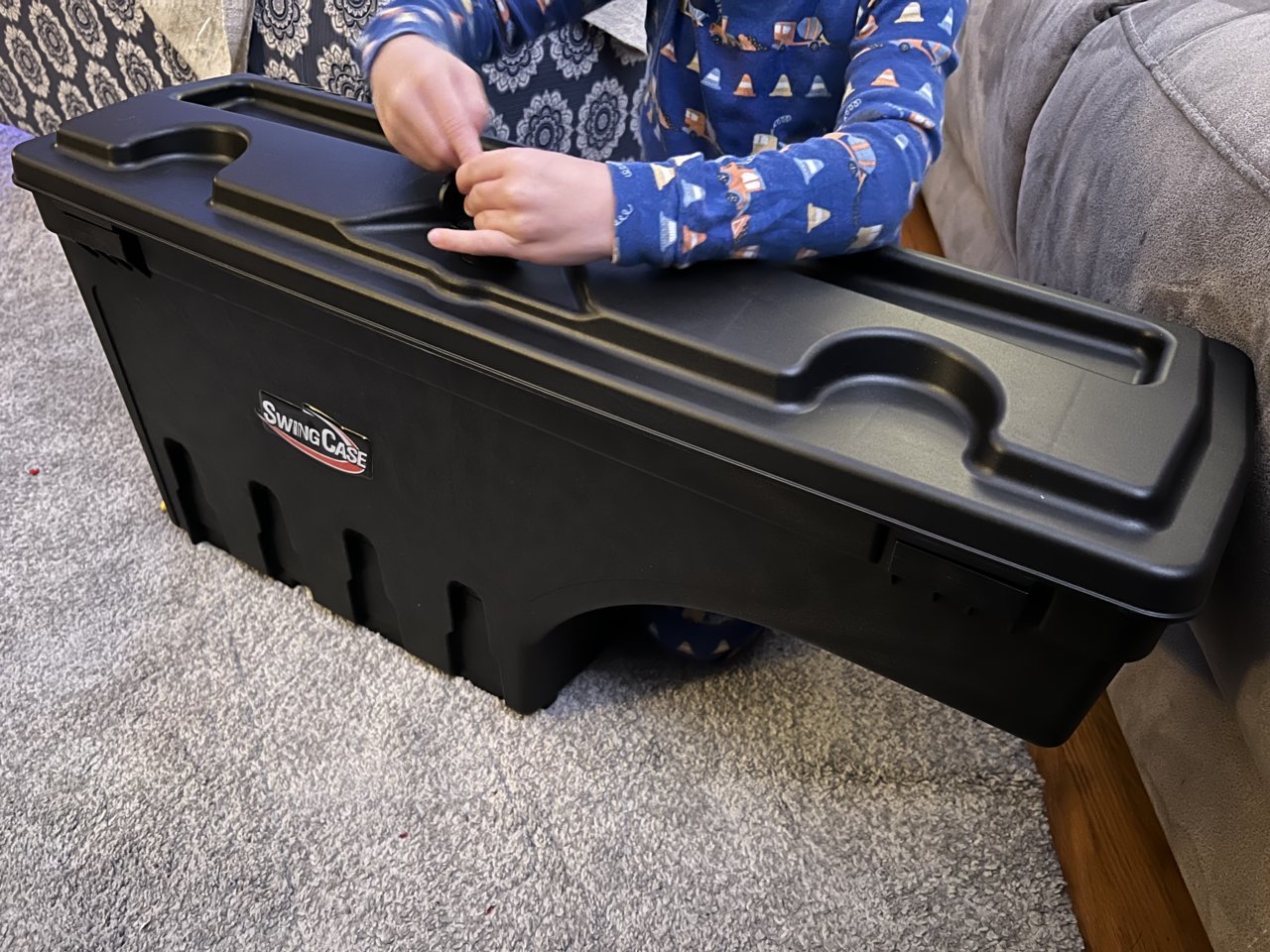

    Early bday gift from the wife!

    All good man. Again, I'm kind of dumb. Thanks for all the info, I'm going to cut mine tomorrow.
