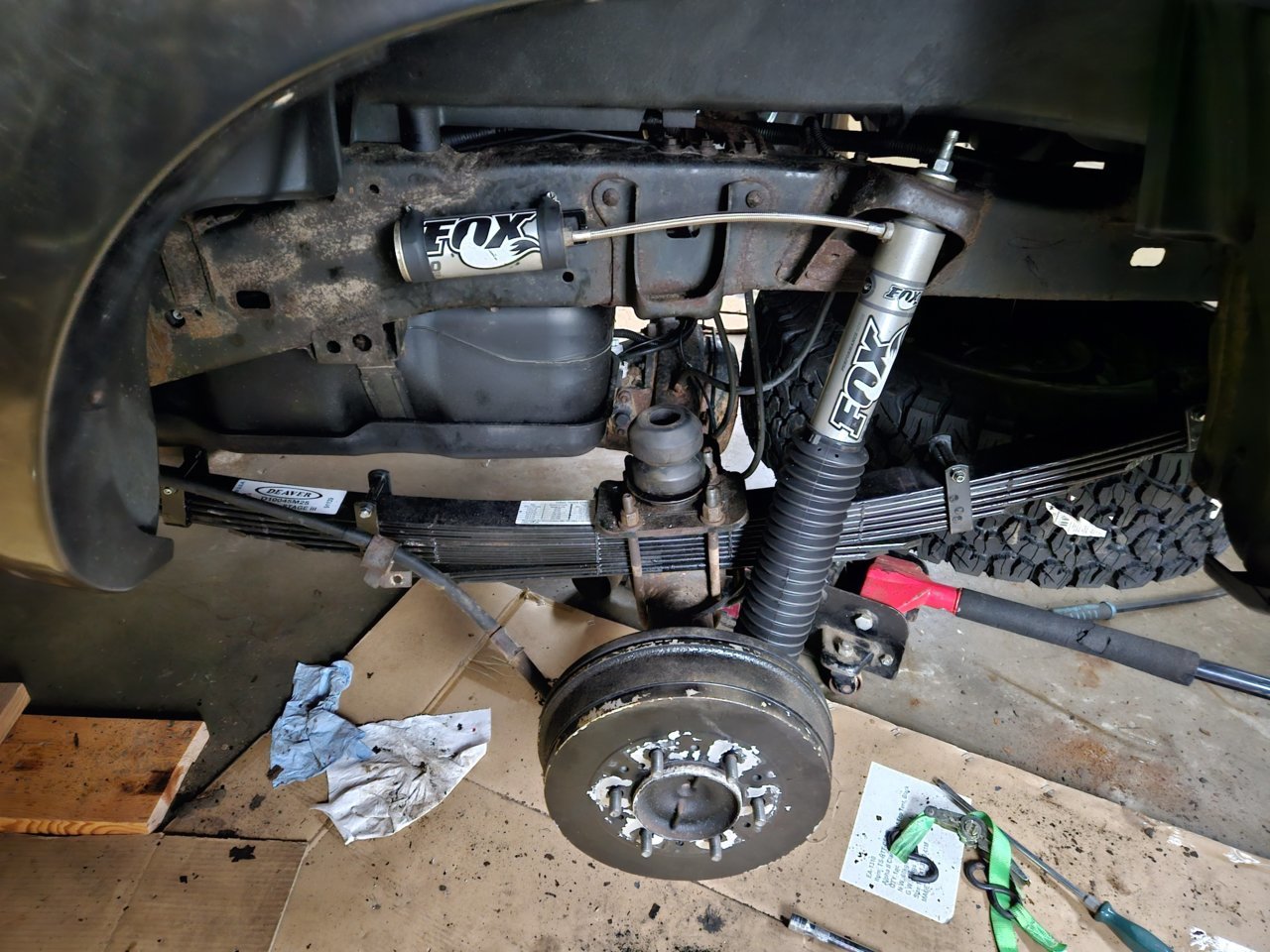

    Added 3.5 degree axle shims and removed my Carrier bearing drop spacers, FINALLY!!!!!!! No more drive shaft shudder at all.
    Was trying to swap out my old passenger side leaf spring with my wife's 3rd gen take offs but the bolt will not come free soooooo on it stays until I can figure it out later.

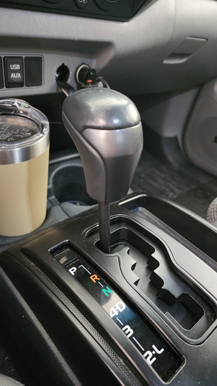

    Also added a 3rd gen shift knob from my wife's truck........still testing it out to see if I like it.

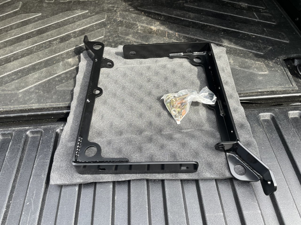

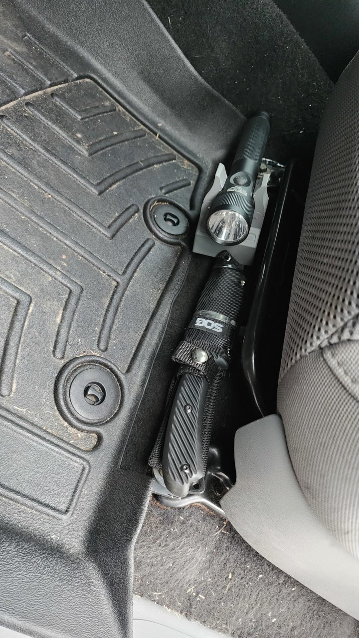

    And for the finale a diy mount for the driver's seat. Attached my Streamlight flash light and a Chinese SOG knife for now.......got to sharpen my Benchmade.

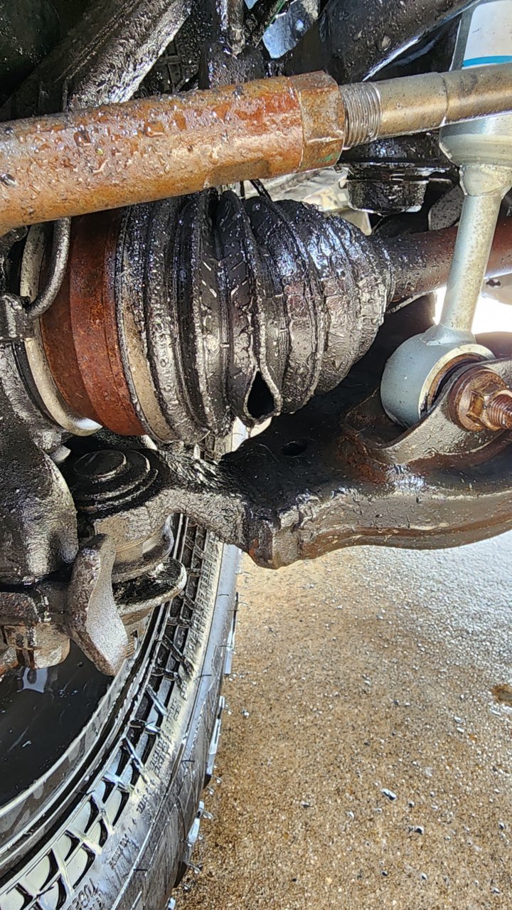

    Oh and found a split CV boot so that'll be getting fixed in the near future.

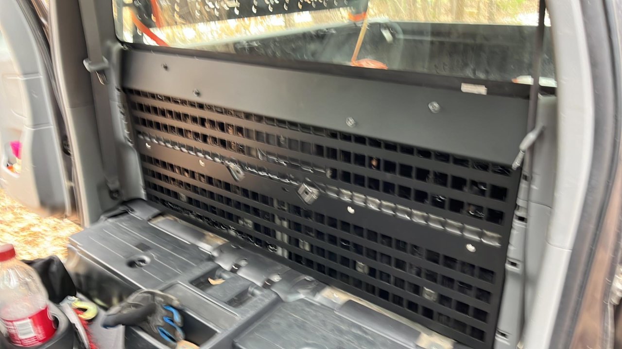

    Just finished doing a test fit install on the access cab back panel. I ordered it up from Underland a few weeks ago and it arrived on Monday night. I had to trim off a couple tabs on the little airbox/vent so it fits flush. I'm going to order up some thin industrial felt and acoustical foam to put behind it. The nice thing is that this wall seems to add about 3-4" of extra space compared to the original access cab seat wall. Now to get going on the template for the platform. (I tried posting this to the everything molle thread but I don't post enough here to meet the 50 post theshold yet)

    I’m trying to decide on shims or a one piece drive shaft. I’ve had driveshaft woes the whole life of the truck and blown up two diffs….currently i have a 2.5” lift and just a CB drop with no shims and the shudder is downright infuriating. :pout:
    glad you got yours figured out!

    Yeah I want a one piece drive shaft also but just don't have the $$ right now. All I ended up doing is eye balling the drive shaft to get it as straight as possible. I had 2.5° shims at first then decided to try 3.5° once I put those in I saw my CB was too low so took the spacer out and vibes all gone. So happy. Hope this helps you though.

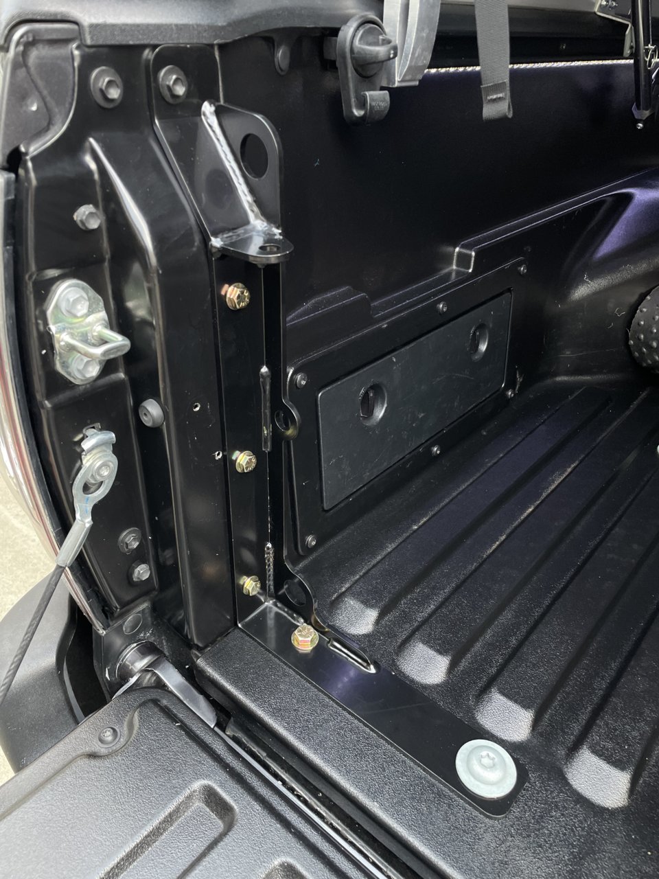

    Installed the Total Chaos bed stiffeners. So far they seem like a great addition.

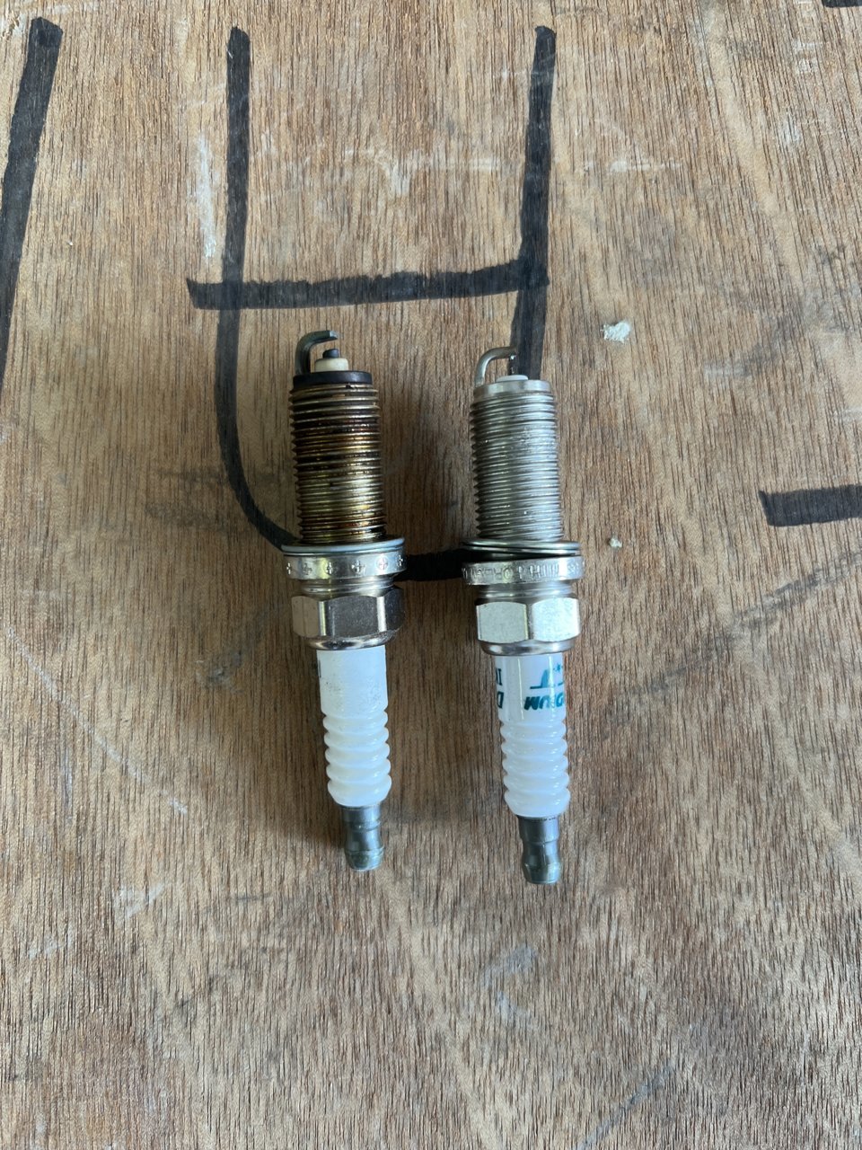

    Swapped the old plugs out.. and 80k check up.

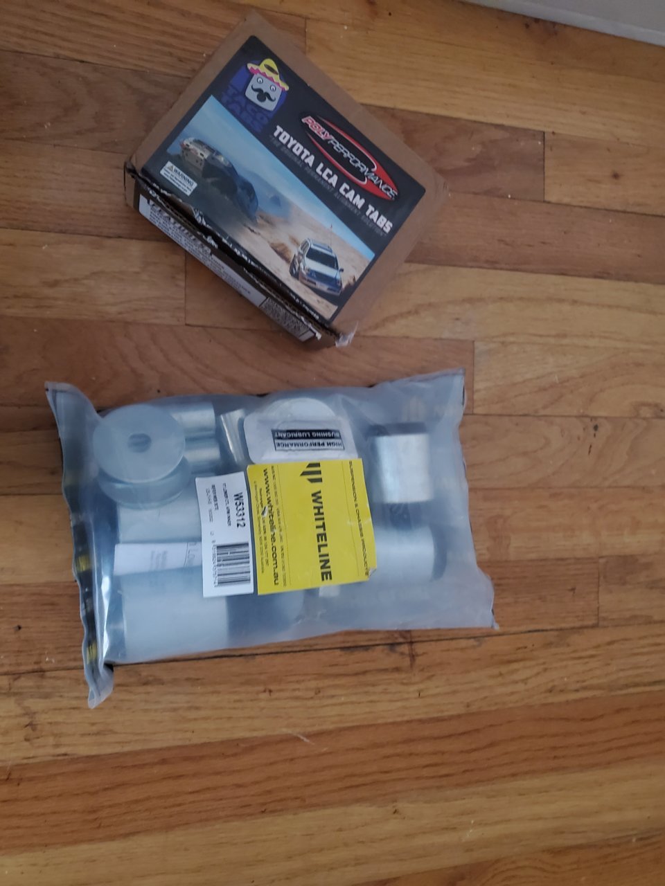

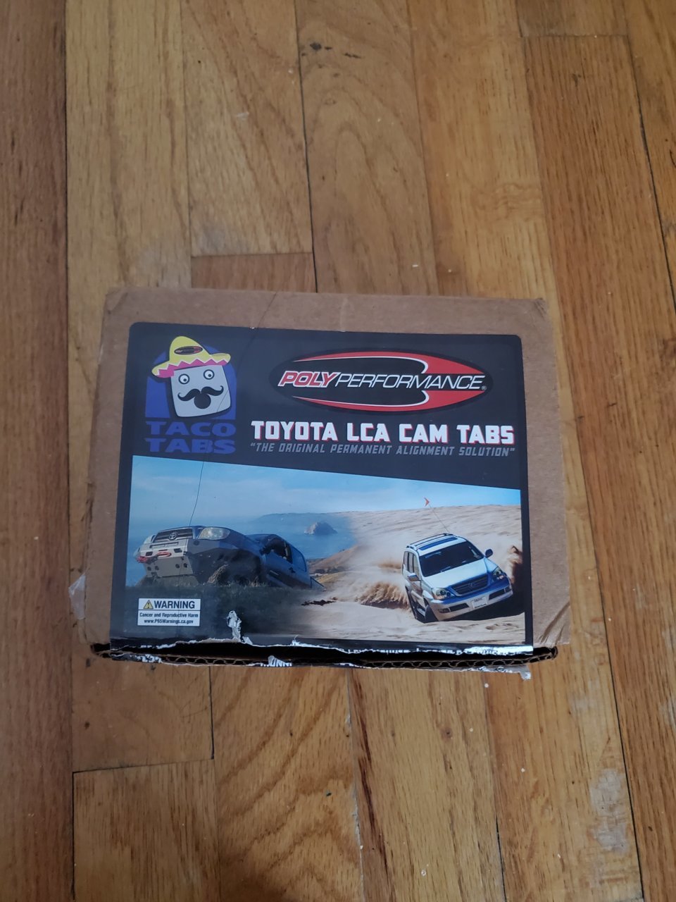

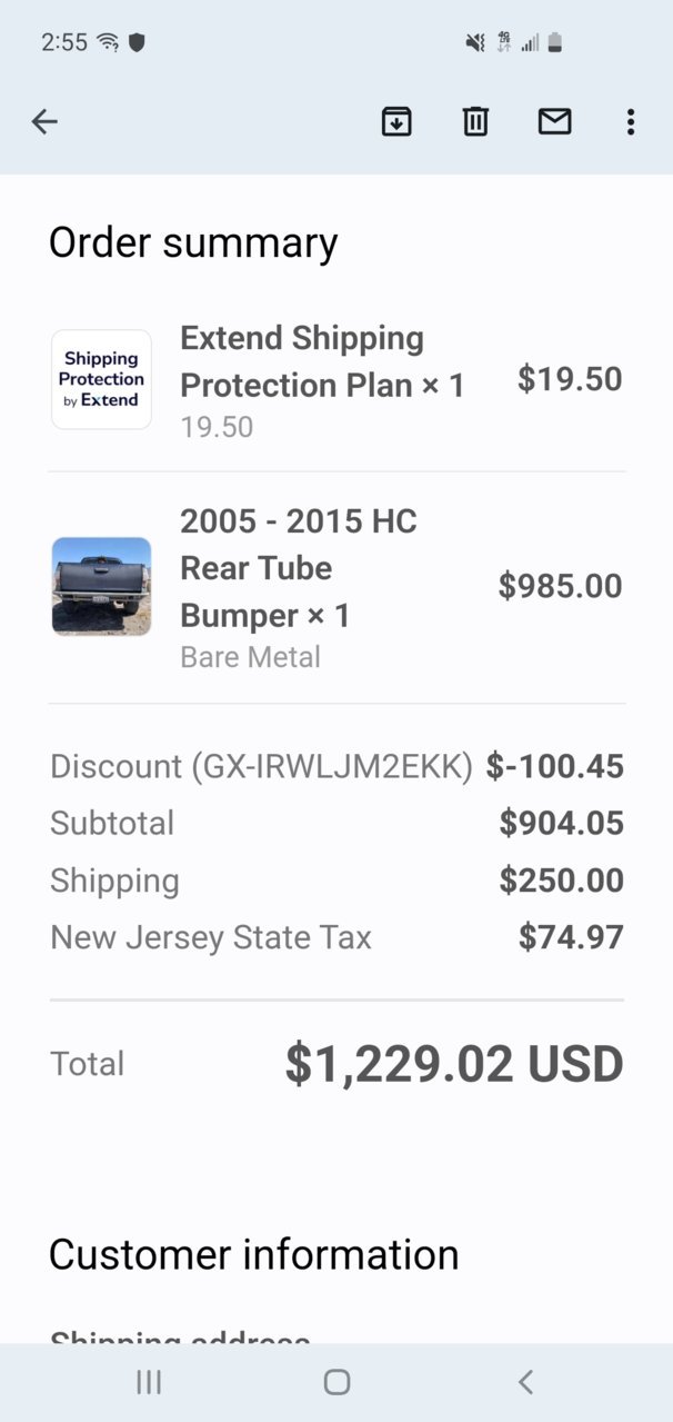

    Started a small shopping spree for a light rebuild/update so far got some polyperformance taco tabs ,whiteline lca bushings , new moog lcas,and a new rear outgear solutions bumper which should be here wendsday I can't wait 20230318_091149.jpg 20230318_090843.jpg Screenshot_20230305-145549_Gmail.jpg

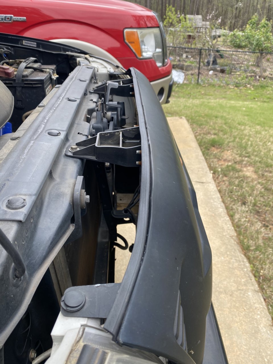

    Installed stripping on my faux trd pro grille today. Much better than the crap they sent me with the grille.

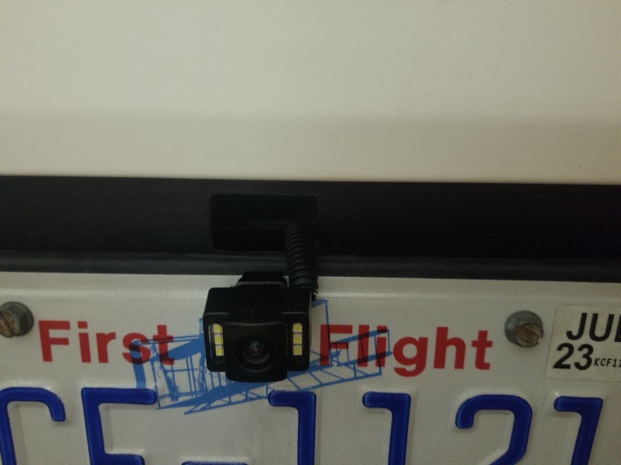

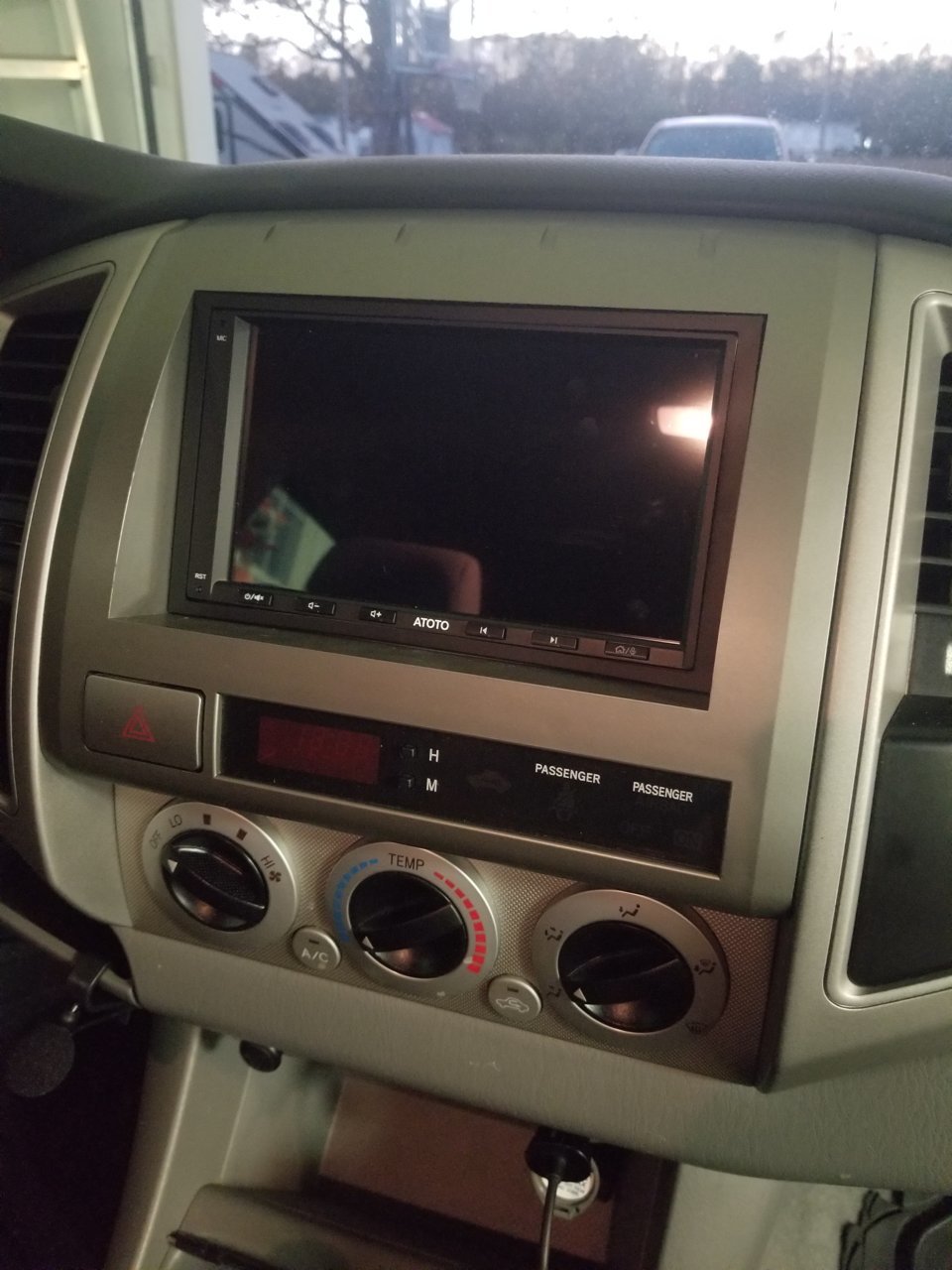

    This actually happened several months ago. Installed a new head unit and back-up camera on my boys' '07.
    I had one of my boys under the truck running the wires for the camera in the frame while the other was butt splicing and heat shrinking the harness adapter to the radio harness. Great project for spending time with the boys. Awesome little head unit. Can't beat it for the price. Tons of functionality. It was on sale on Amazon and I got it for $170. I had some reward points at Crutchfield and that's where I bought the camera.
    Big shout out to @mrproduxn for turning me on to the unit and his recommendation regarding the Scosche dash kit and harness.:thumbsup:

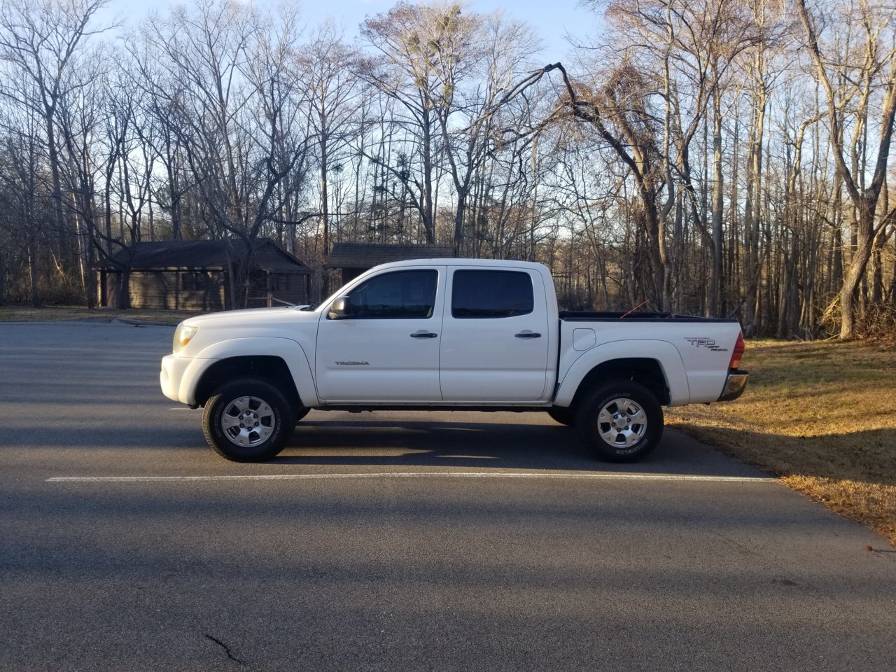

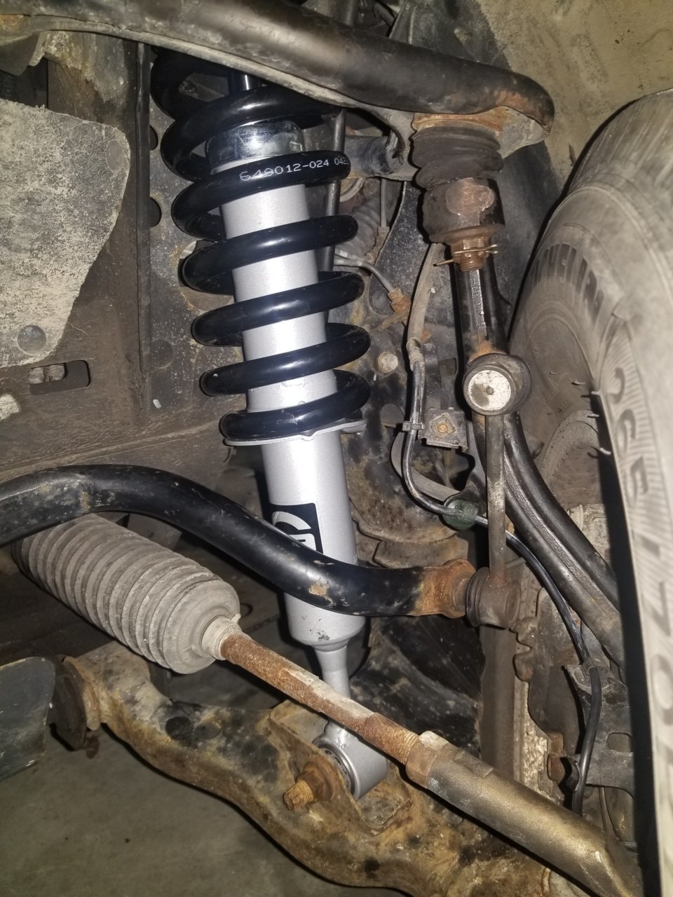

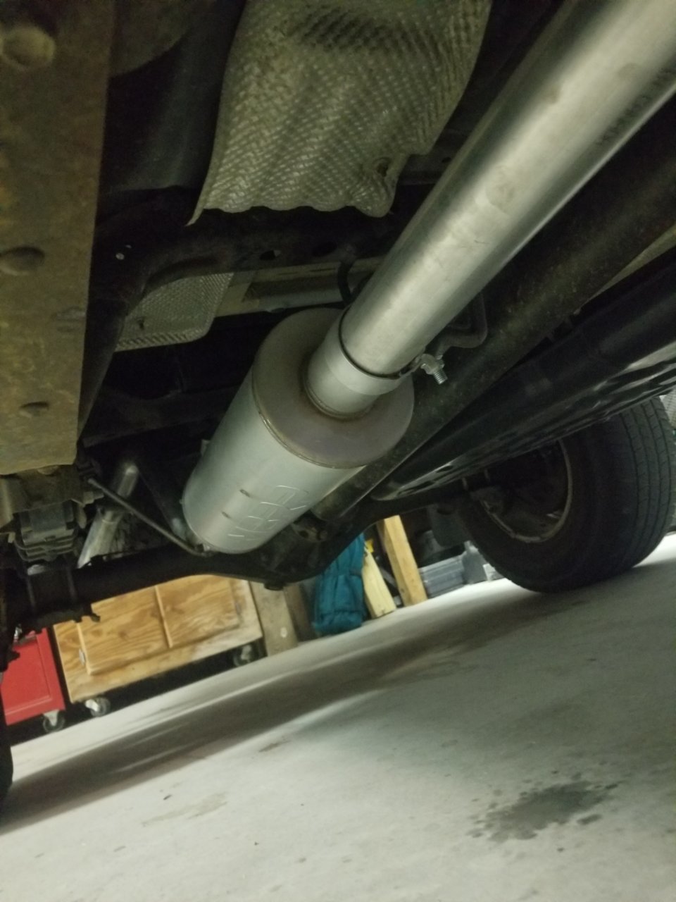

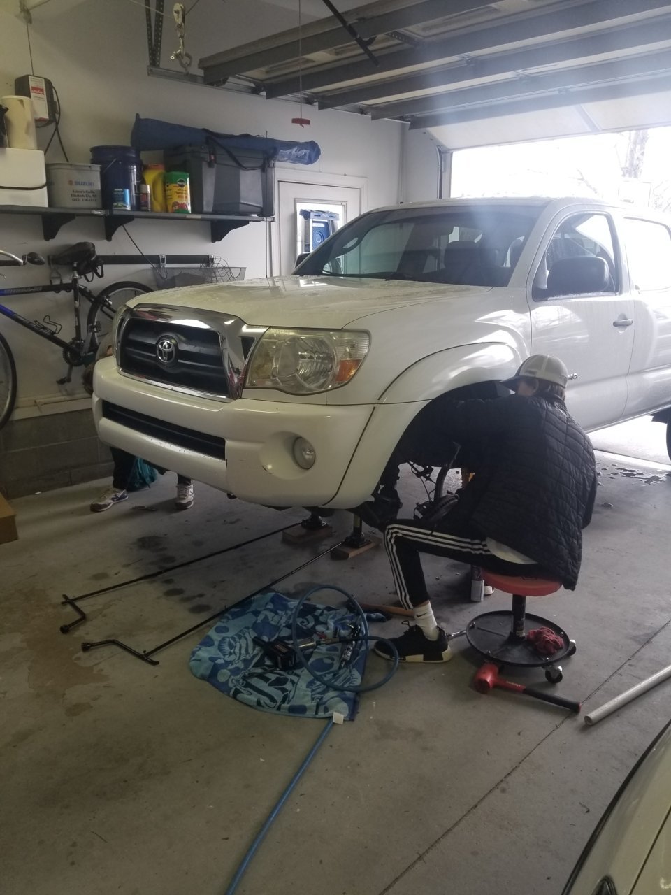

    Playing catch-up. My boys added a MBRP exhaust without my help last month to their '07. Very proud. And we also added a 2" Rough Country lift.
    Getting in there...
    Turned out nice. We added a 1-1/2" block to the rear along with the new RC shocks. I really liked the coils and the shocks coming pre-assembled. The only tough part was getting the UCA connected after installing the new shock assembly. Fun project.

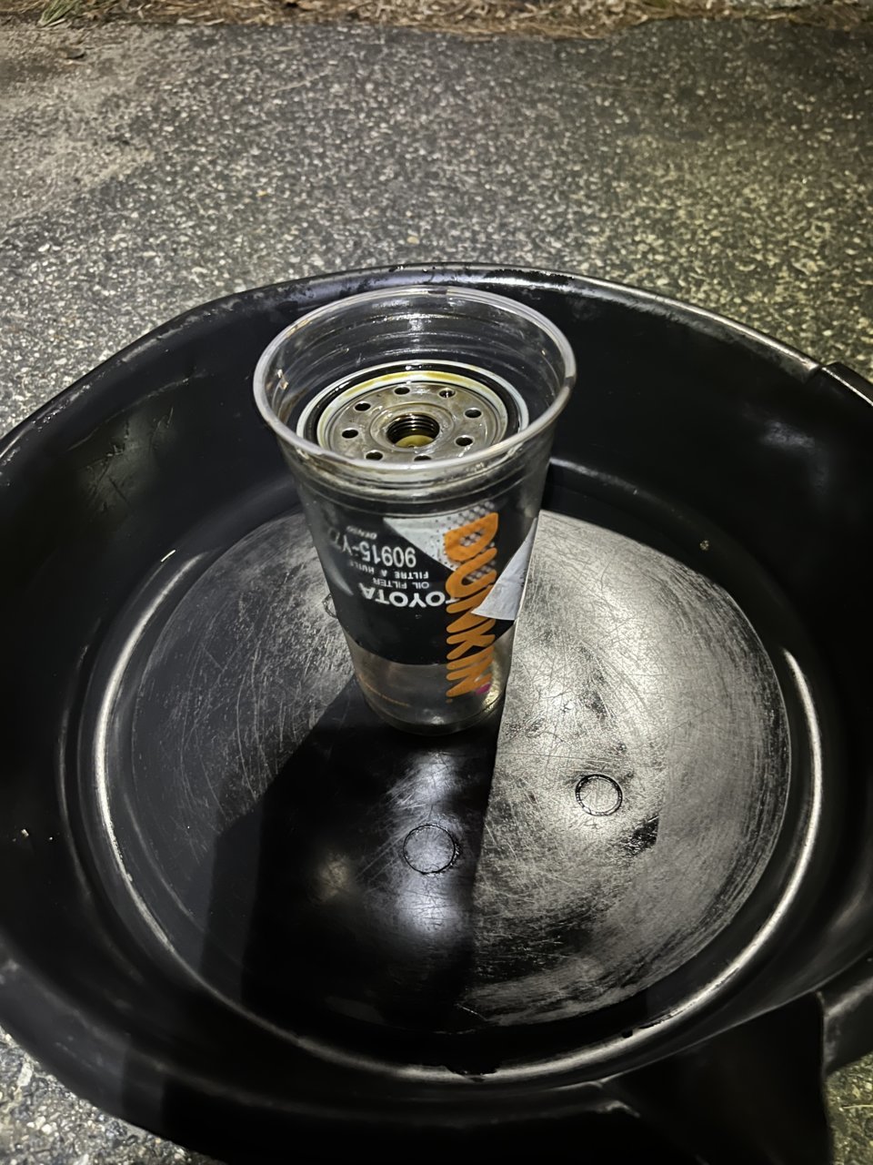

    Waaay past due oil change. Finally warm enough in the driveway. Lubed the zerks with red and tacky. Also topped off the coolant...it was just above "low"
    Life hack - a Dunkins cup is perfect for removing the oil filter and catching all the drips.
    did the wife’s Subaru. We’ve got almost 1/2 a million miles between our two cars.
