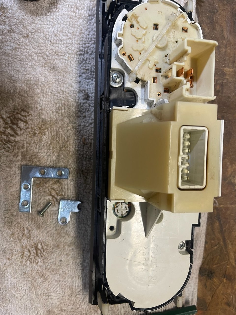

    This was actually done several weeks ago. I got sick (....and tired) of dealing with the HVAC control back lights going out. Replaced bulbs, added solder to the contacts, ...... nothing helped long term. So I made some hold-downs from angle brackets. Seems to have put this nagging issue to bed.

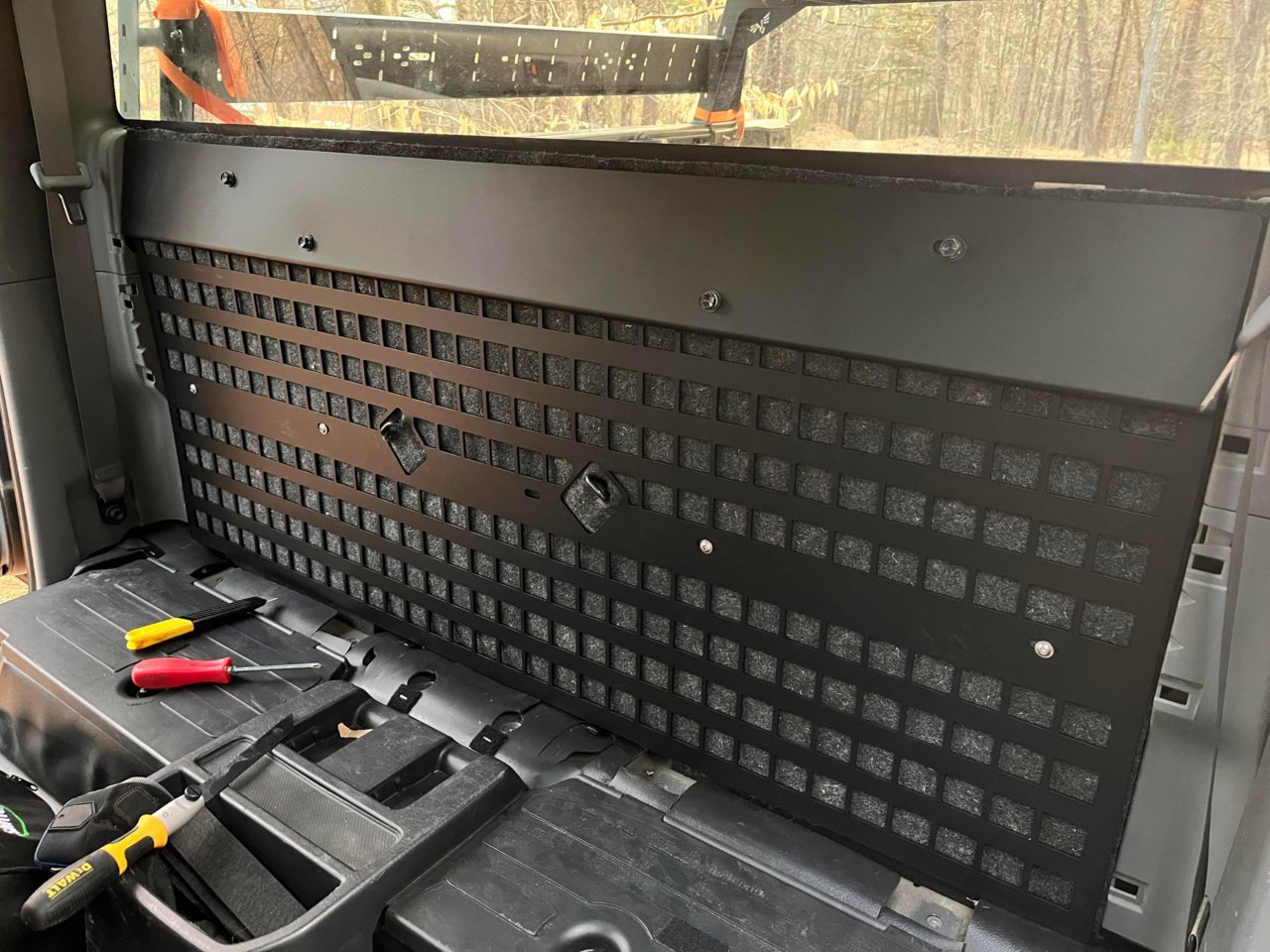

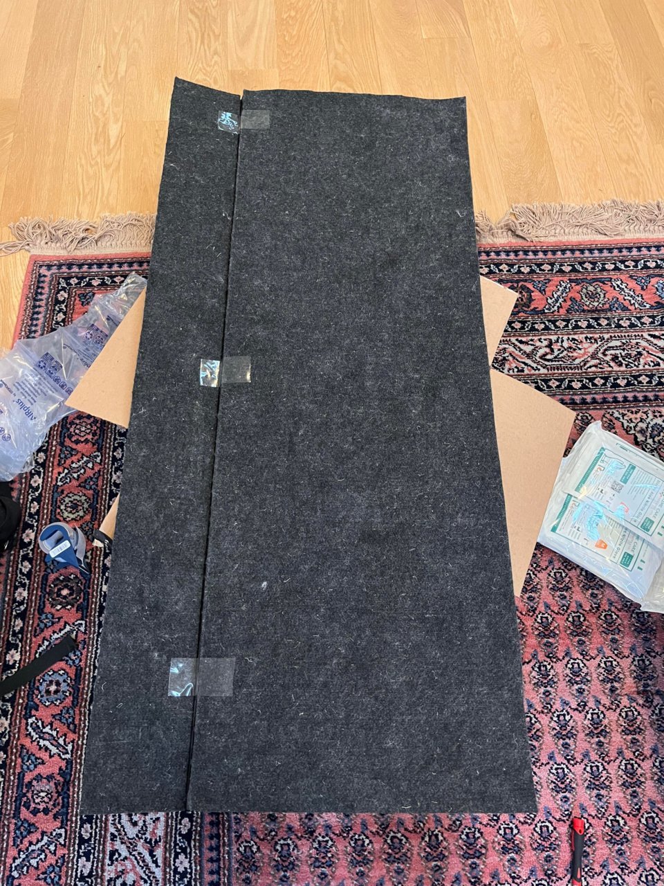

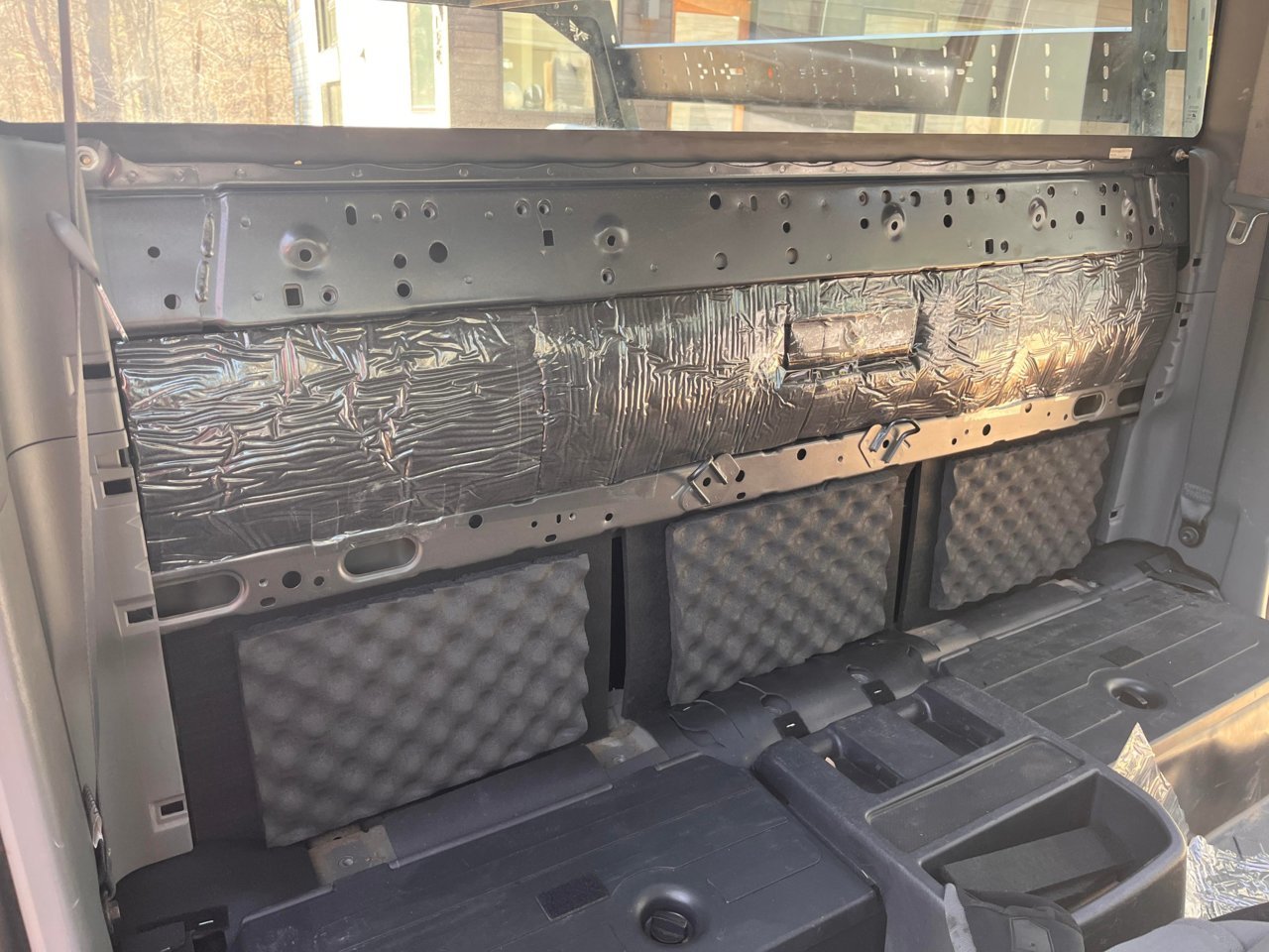

    Finished the rear molle panel install. Took out the test fit panel, tried building a hard foam airbox for the vent (that helped some but not a lot). Used egg crate style acoustical foam to form a channel along the top half of the wall to let the air vent breathe, but to try and quiet it down. Used a combo of hard foam and egg crate acoustical foam to add more mass and damping to the bottom half of the wall. Then cut and fit 1/8" industrial felt to act as a backer for the molle panel. Then reinstalled everything. It's quiet - at least as quiet as the original wall and looks great.
    As are as sound deadening, I wish I'd checked with a decibel meter before and after, but since I didn't do that I can just assume it's perfect!
