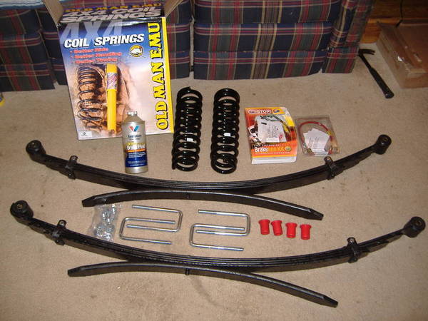

    lets see......today, i installed all this stuff(well.....my buddy did it at his shop, but i helped him with the rear springs and rear brake lines til i had to go somewhere with the wifey:rolleyes: for a while) today........
    it was an utter bitch with the driver side rear spring.....we broke out the torch, cut the spring right by the frame, then had to grind the rest of the spring and the metal collar around the bolt to get the bolt loose and out......oh yeah........caught the frame on fire, and not fun while its right by the gas tank:eek::D. but we got all this done, and now my truck has a bit of a lift, but more importantly, it rides 500% better than the worn out stock suspension!!! and it looks awesome too, plus....no more axle wrap!!! pics will be up later on my build thread(although there were no pics taken during the factory suspension removal/ new suspension install............didnt have the camera!!:rolleyes:).

    bout 2 inches in the front, and around 1 and a quarter inches in the rear.

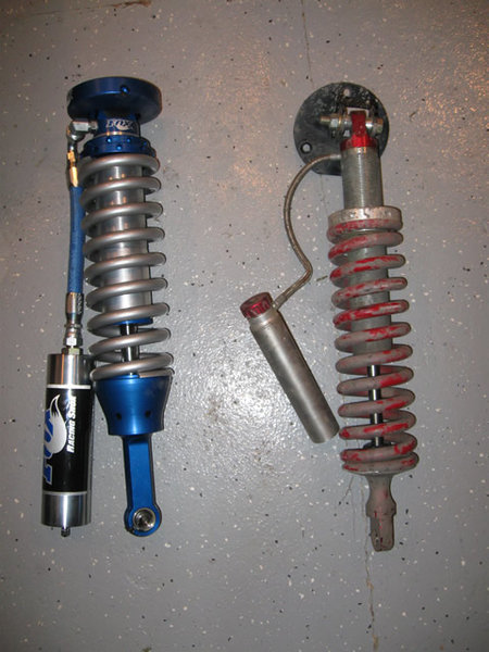

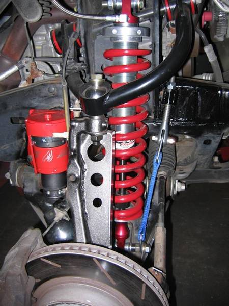

    Replaced some worn out components. Went from this:
    To this:

    hell yeah,Mike!!! very nice!!! those should do very well for the baja!!

    those are sexy! Drool! :d

    Thanks! I was really concerned when I snapped the All Pro UCA after 20 miles of knocking around, but the Total Chaos upper control arms are considerably beefier around the welds so they should hold up well.
    I'm going to contact All Pro and provide them with pictures and a description of what I did to break their gear. I might have had a bad UCA or they might have since changed their welding technique to get better penetration. Either way, I hope that their future products hold up better.
    I got the 2.5" Fox coilovers from them and have had nothing but good experiences dealing with the company. When it comes down to it, the desert is far more punishing than rock crawling and I wasn't using their products for their intended purpose so it's really my own fault. The hardware held up great when I crawled with it, and soon we'll see how the new setup performs! :cool:
