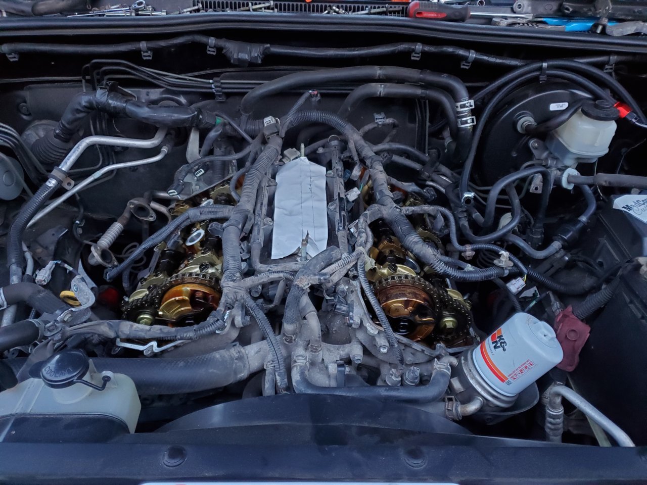

    If it takes more than two revolutions then your engine is out of time. Some apparently came that way from Toyota.

    I got it for some reason my dumb a$$ thought I had to align all the painted chain links too instead of the actual timing marks so I keep turning and turning to try to get the factory paint marks on the chain to line up with the timing marks and that made a 3hr job turn in to an 8hr one

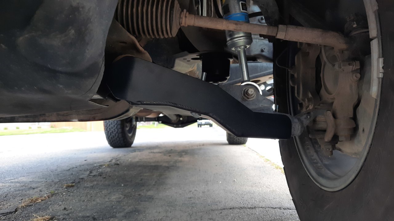

    Installed RCI Offroad Rear Diff and A-Arm Skids

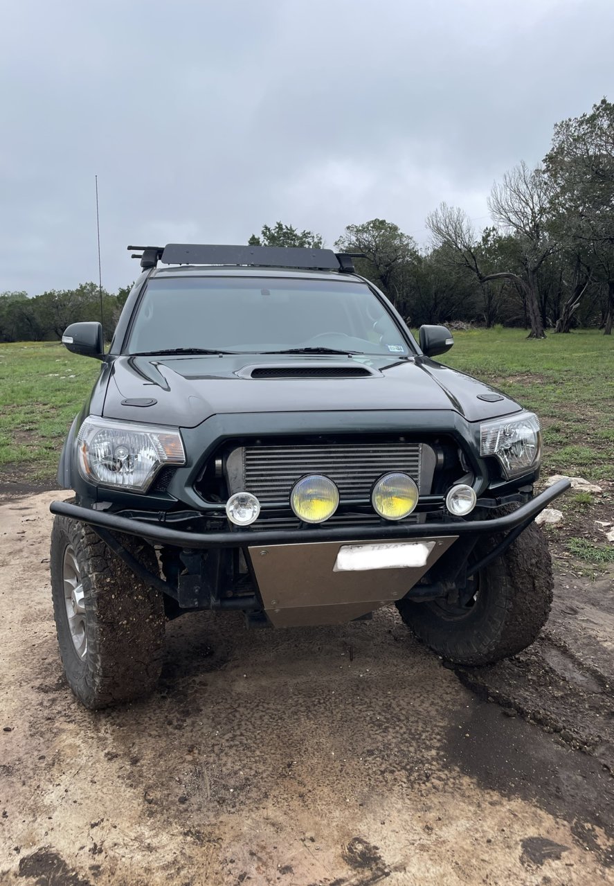

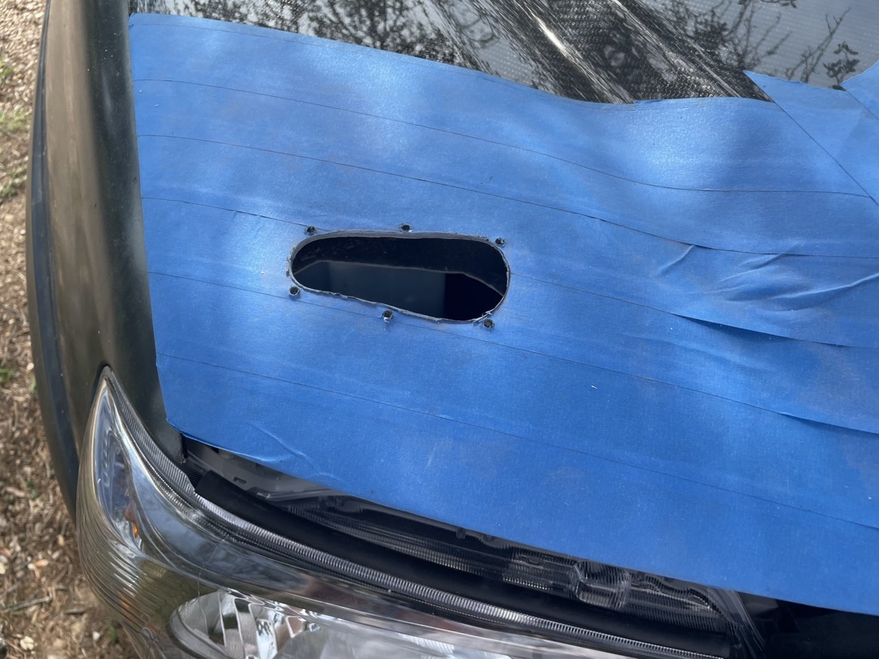

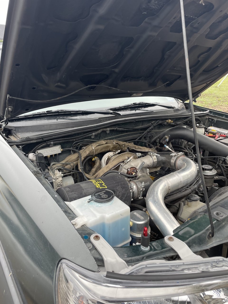

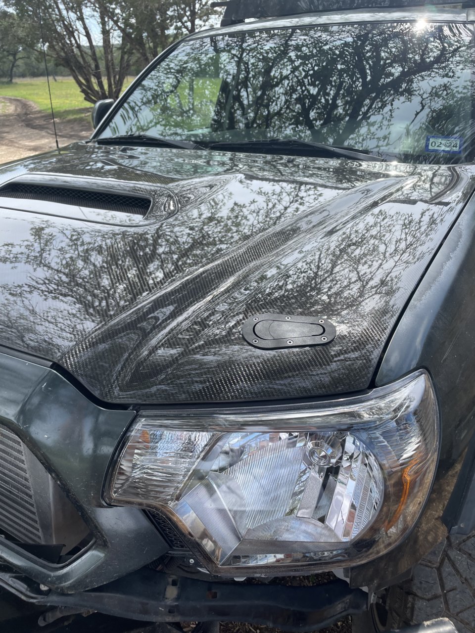

    Installed some Aerocatch hood pins on my Seibon hood and also lower headlight filler pieces to finish my 12-15 front clip swap.

    What's the weight savings from a stock hood? I'm curious

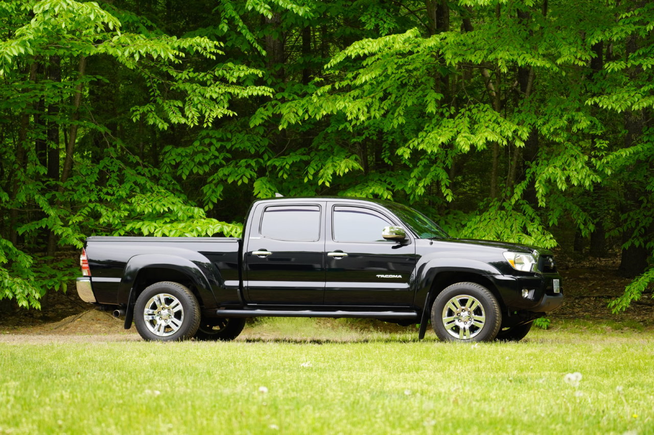

    Gave her a wash, clay bar (first time), and spray wax. Came out sharp and slick.

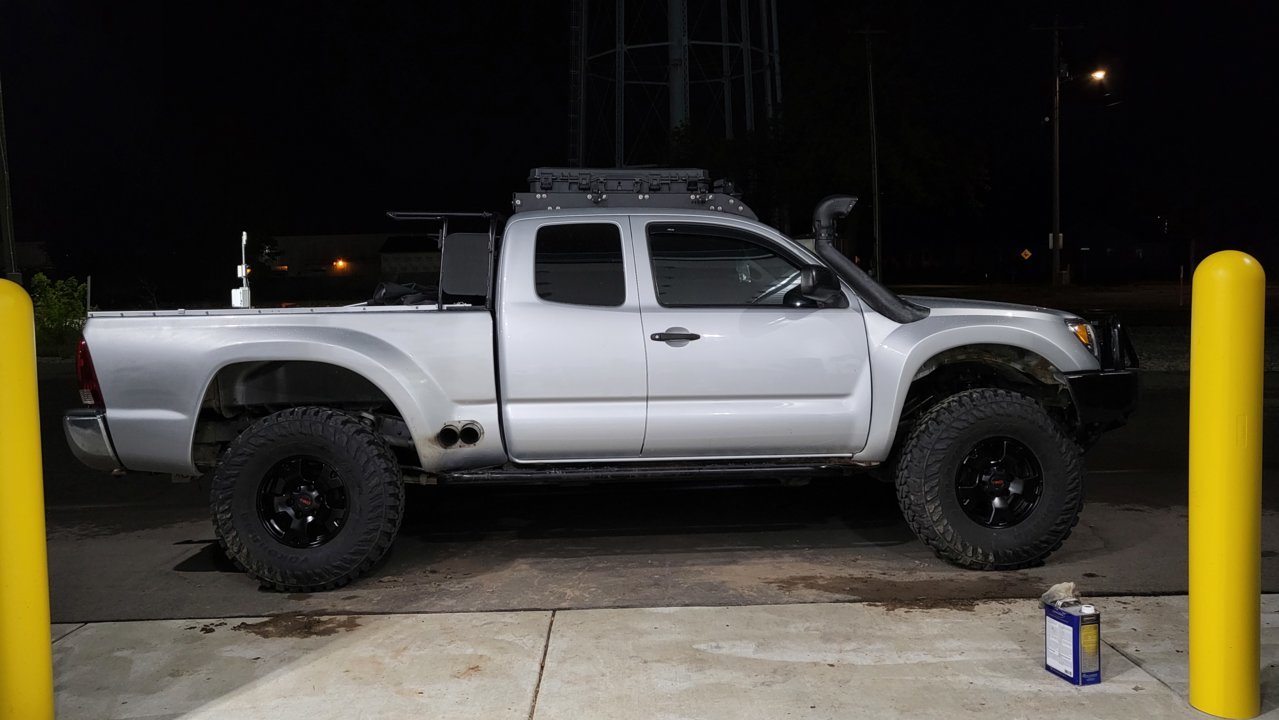

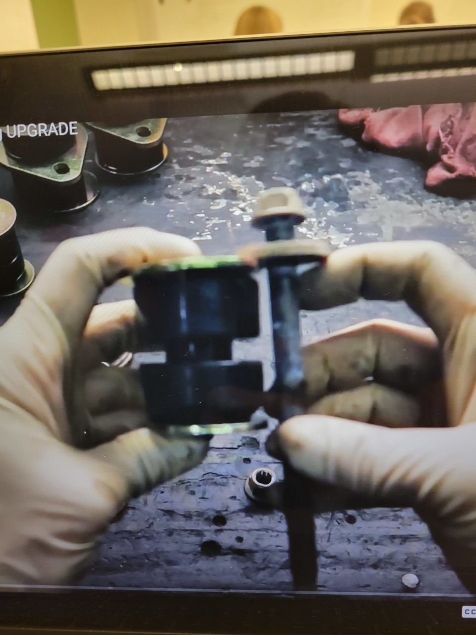

    PSA about Tacomas and Energy Suspension radiator core support bushings!
    Anybody considering replacing OEM radiator core support bushings with or thinking about replacing them with ES polyurethane bushings think carefully about doing this. Meaning don’t fucking do it.
    My OEM bushings were shot after about 60k miles. So I was clever and used the poly bushings. Problem is they are really stiff. If you wheel at all or have a heavier or dual battery the weight and the flexing can cause issues with the sheet metal core support itself. I developed a 6” crack on both sides. Had a plate welded on both sides. On the passenger side another crack developed and went around the plate. Had that rewelded… and it happened again.
    Poking around I found anothwe crack above it and multiple cracks in the engine bay.
    You were warned. I have ordered new oem ones and am swapping out the ES bushings ASAP. There are numerous threads about this issue on Tacomaworld and other sites.
    Note that the passenger side (without the heavy battery is the side with more cracks…, so it’s not just the weight of the battery)

    thanks. I was just looking into doing this. I have an odd clank in the front when I take off. noticed today those bushings are bad.

    Nice :fistbump:

    Hood looks amazing! I thought about getting one for my ‘09 to match the carbon fiber fenders IMG_1225.jpg

    What roof rack are you running?

    where are you guys buying your radiator support bushings from?

    looks very nice! what is your suspension setup if you don't mind me asking? Thanks

    Buy OEM

    I haven’t weighed the old one yet, but I bet it’s at least 25-30lbs lighter. It is quite noticeable when opening the hood now.
    thanks man! And you should, they would pair nicely with those. Are those a +4 fender? You have me wanting a pair of those for my truck now:D
