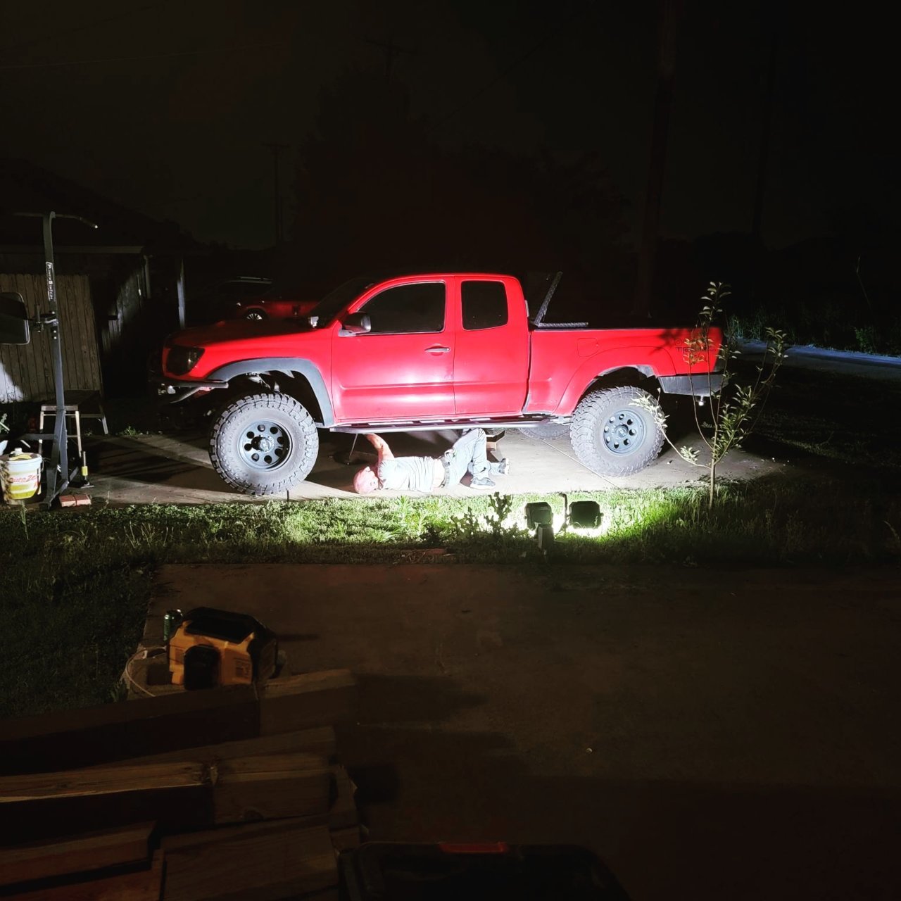

    Finally put slider on the damn thing

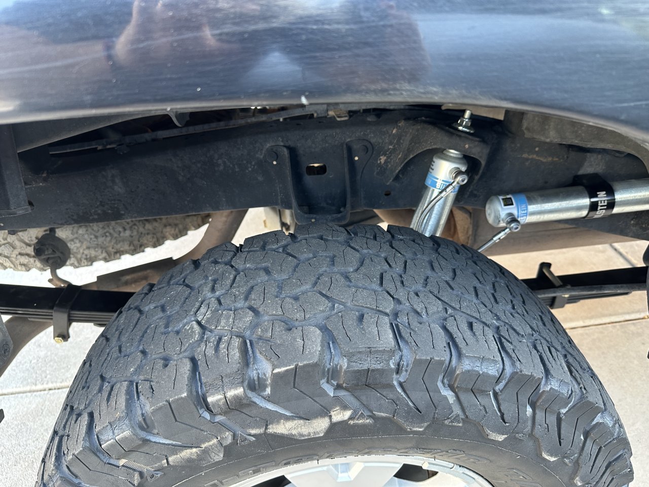

    Finally upgraded my rear suspension today. Icon RXT leaf packs on Option 1 and Bilstein 5160s to complement the 6112s I put in last year (I probably should have saved $300 and just gone with the 5100s since I use my rig for hunting and not serious wheeling, but they’re in now!)
    Im uploading pics for anyone looking for examples of what the Icon RXT packs look like on option 1 with an unloaded rig. The rear is now sitting at 23 1/2” driver - 24 3/8” passenger from center hub to top of wheel well. If they settle 1/4” like everyone says, then they will be perfectly level with the 6112s on 5/6 setting.

    Looks great. In for your thoughts and for results after settlement. I recently bought, but haven't installed, 6112s at 10/8 and Icon RXT leafs with the intent on setting at Option 2. Your photos are making me lean towards Option 1 and dropping my clips down. Do you have the older style 6112s or the newer ones with 11 clips?

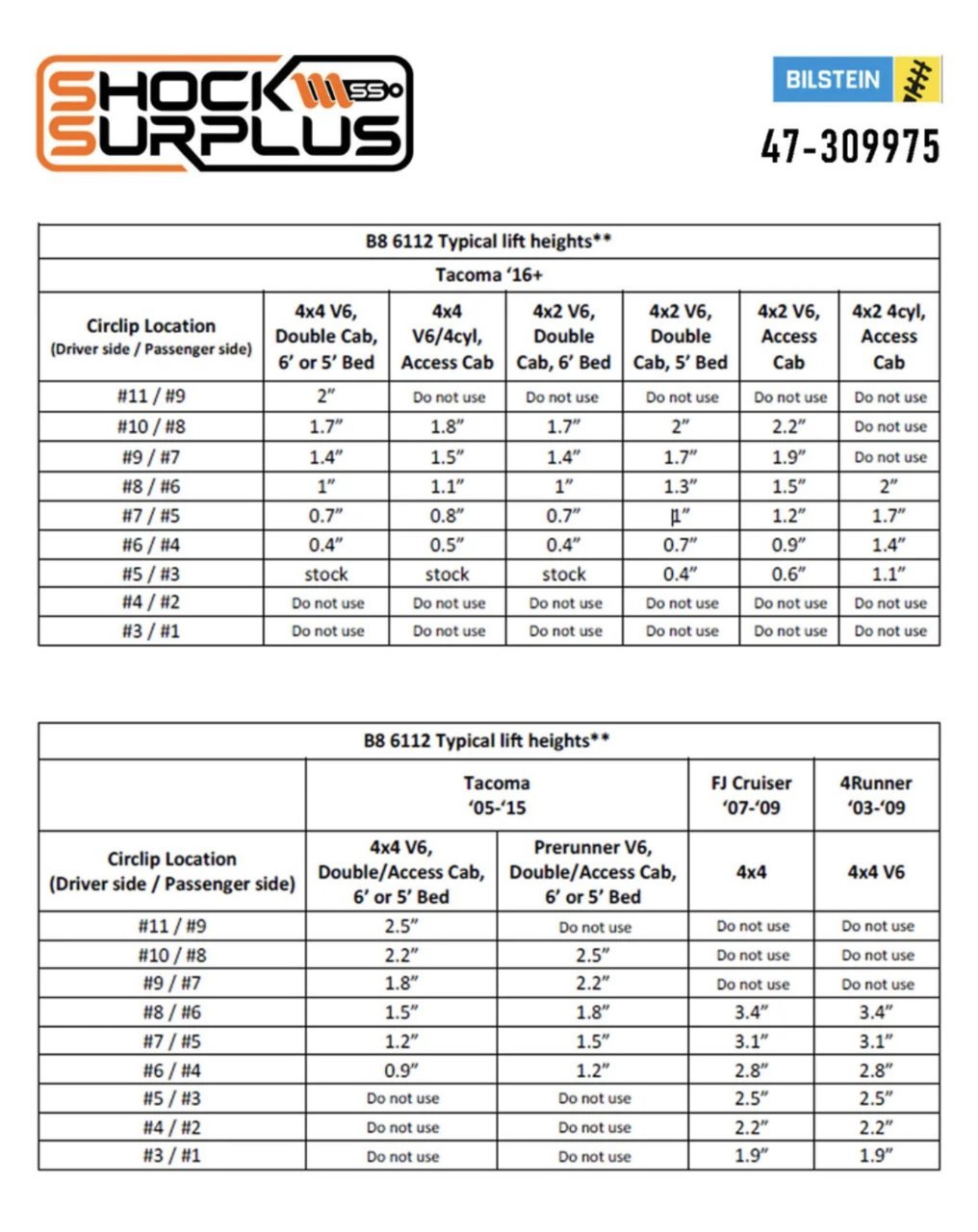

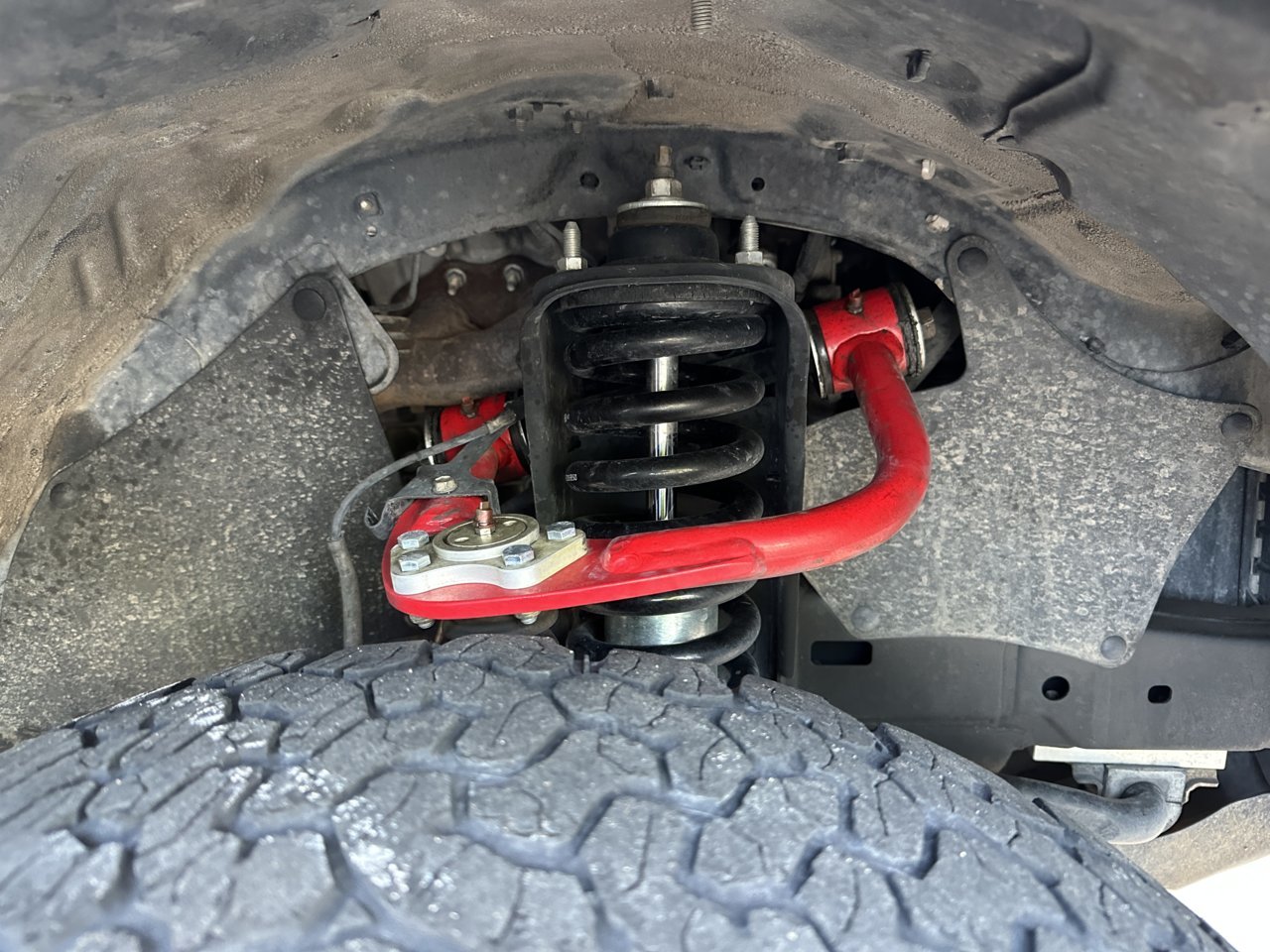

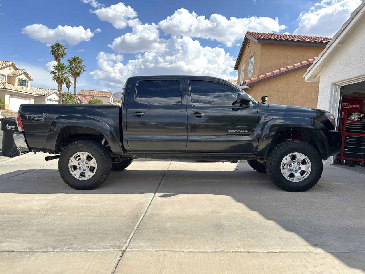

    Apparently, I have the older ones because I didnt even know what you were talking about when you said 10/11, ha. I bought mine summer of ‘21, they have 6 clips.
    I just looked up the new ones, definitely more options now, but seems like the options are more complicated based on whether or not you have a 2nd or 3rd gen. On the 5/6 option of mine, I believe that put it at just under 2” lift, and option 1 Icon rxt’s is supposed to be about the same once settled, at 1.85” lift. But again, that’s also unloaded.
    After all of the research and worrying that I did about whether or not I was making the right decisions, I would just trust the lift charts that bilstein and Icon put out.

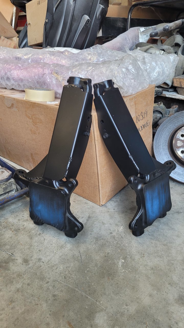

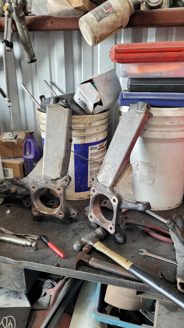

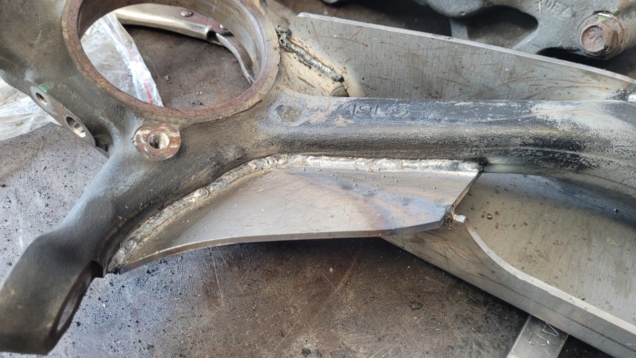

    Welded up some spindle gussets
