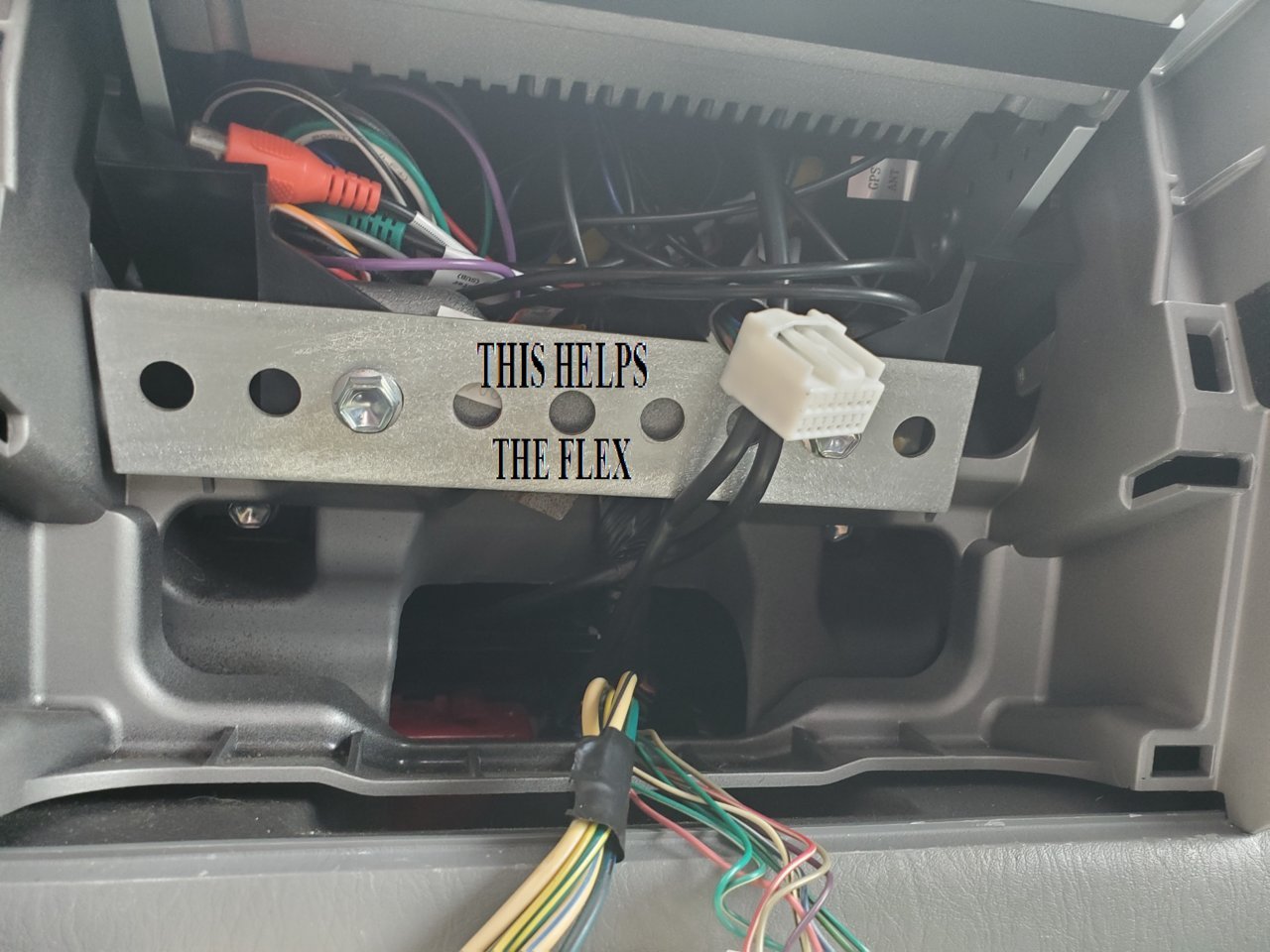

  7. Jun 2, 2023 at 10:33 AM
    mrproduxn
    mrproduxn Well-Known Member
    Feb 22, 2013
    #98175
    6,391
    steve
    Retired DoD SE VA
    Tacomas 1987,2000,2008, 2016,2012,2008
    Retired/Hobbyist old as f***
    I don't know when I will get to do this. Maybe this weekend. All of my wires are ziptied tight under the dash. It is going to be somewhat of a pain to cut the zipties and remove the radio. The 1st thing you should do, which I did not do, is try the big metra trim without the radio installed. See if it clips in place up top and bottom. If so then my issue may very well be that the mounted brackets are slightly off angle, where attached to my hu, thus causing the lower radio face to be pushing out on the lower metra trim which, in turn, would prevent the top clips from locking in place. The face coming through the trim, in the square hole, appears to be equally aligned top and bottom. Whatever my issue is the result is the top face of the hu flexes in and out, just enough to cause the rattle, on rocky or rough pavement. Sons scosche has zero rattle. I installed both radios myself. It could simply be an installation error by me.

  14. Jun 3, 2023 at 12:24 PM
    mrproduxn
    Feb 22, 2013
    #98175
    6,391
    steve
    Retired DoD SE VA
    Just a quick update. (1) I removed the metra face plate and the plastic brackets are indeed the reason it flexes. (2) The trim faceplate top clips are engaged however they do not let the faceplate go in deep enough with metra or oem clips. It has wiggle space. The problem is the holding posts on the metra faceplate, where the clips mount, are made incorrectly. There is nothing that I can file to make them work because the "spikes" holding the clips in place are too far forward. If it was the opposite problem I could file the "spikes" to adjust the in/out position of the faceplate.
    I am first going to fab a piece of metal to go across both upper radio mounting screws to see if it eliminates the flex. If not then I will remove the whole unit and replace with oem brackets. The factory steel brackets should be more rigid than the metra plastic ones. Then again I had no issue with the 2012 scosche kit. I would return the metra and wait for the better faceplate kit with or without the oem metal brackets. If all else fails then I am going to swap to my oem metal brackets. I may have done that on the 2012 scosche but I just cannot remember.

  16. Jun 3, 2023 at 1:45 PM
    mrproduxn
    Feb 22, 2013
    #98175
    6,391
    steve
    Retired DoD SE VA
    Well my added plate makes it a little more rigid. Had to shift plate up to get ac control back in. Added foam up above and below radio to add stability. Total PITA. Not road tested yet. Note factory radio bezel has a 3rd clip up top. Metra only has 2 up top. Just not happy with entire fit of metra.

  20. Jun 3, 2023 at 3:48 PM
    mrproduxn
    Feb 22, 2013
    #98175
    6,391
    steve
    Retired DoD SE VA
    This indeed fixed my radio rattle. Took a long drive on some bumpy roads. Radio is solid. Now to cut foam for my rattling tools in my rear seat cubby spots.
