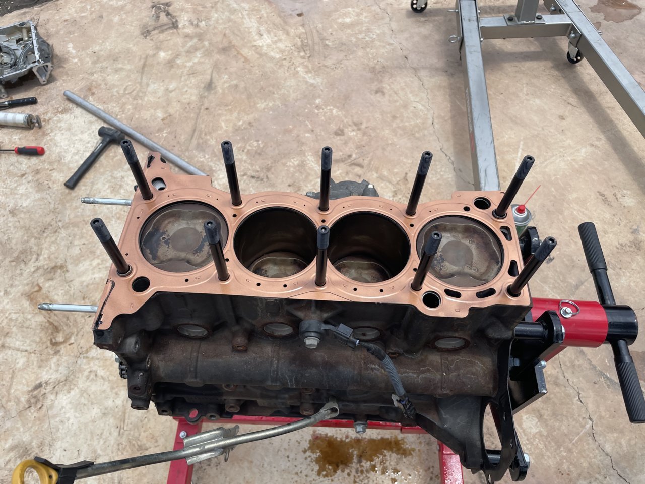

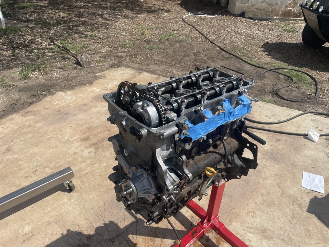

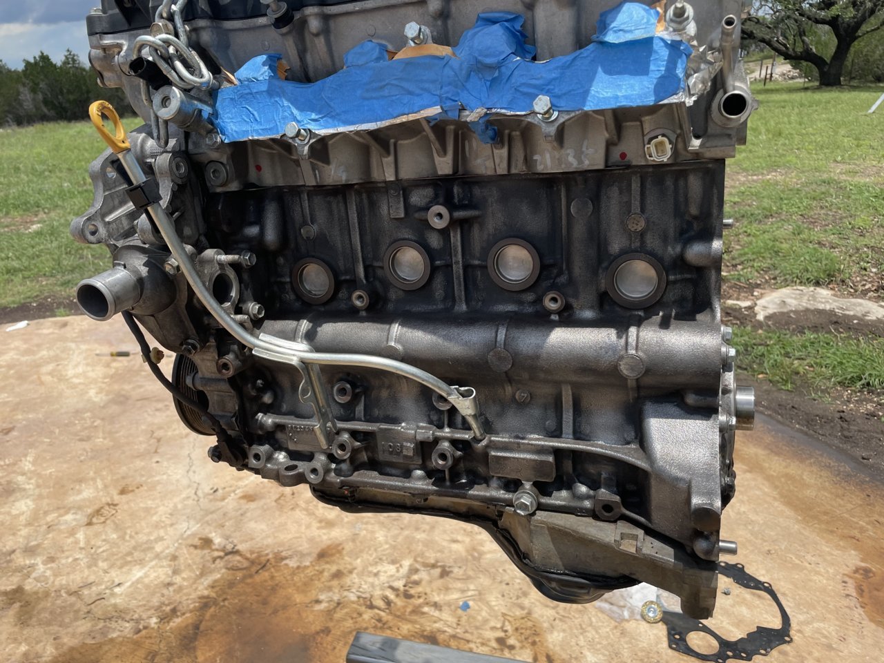

    Refreshed my new long block yesterday. Did a .010” thicker Mahle head gasket, ARP cylinder head studs, OEM thermostat, Aisin water pump, front & rear main seals, and swapped my upper oil pan out for one with a drain for my turbo.
    Today I moved on and cleaned up the block with wire wheels and the dremel, then hit it with 2 coats of rustoleum engine primer, and 3 coats of grey VHT engine paint.
    cleaned
    Primed
    All finished up!

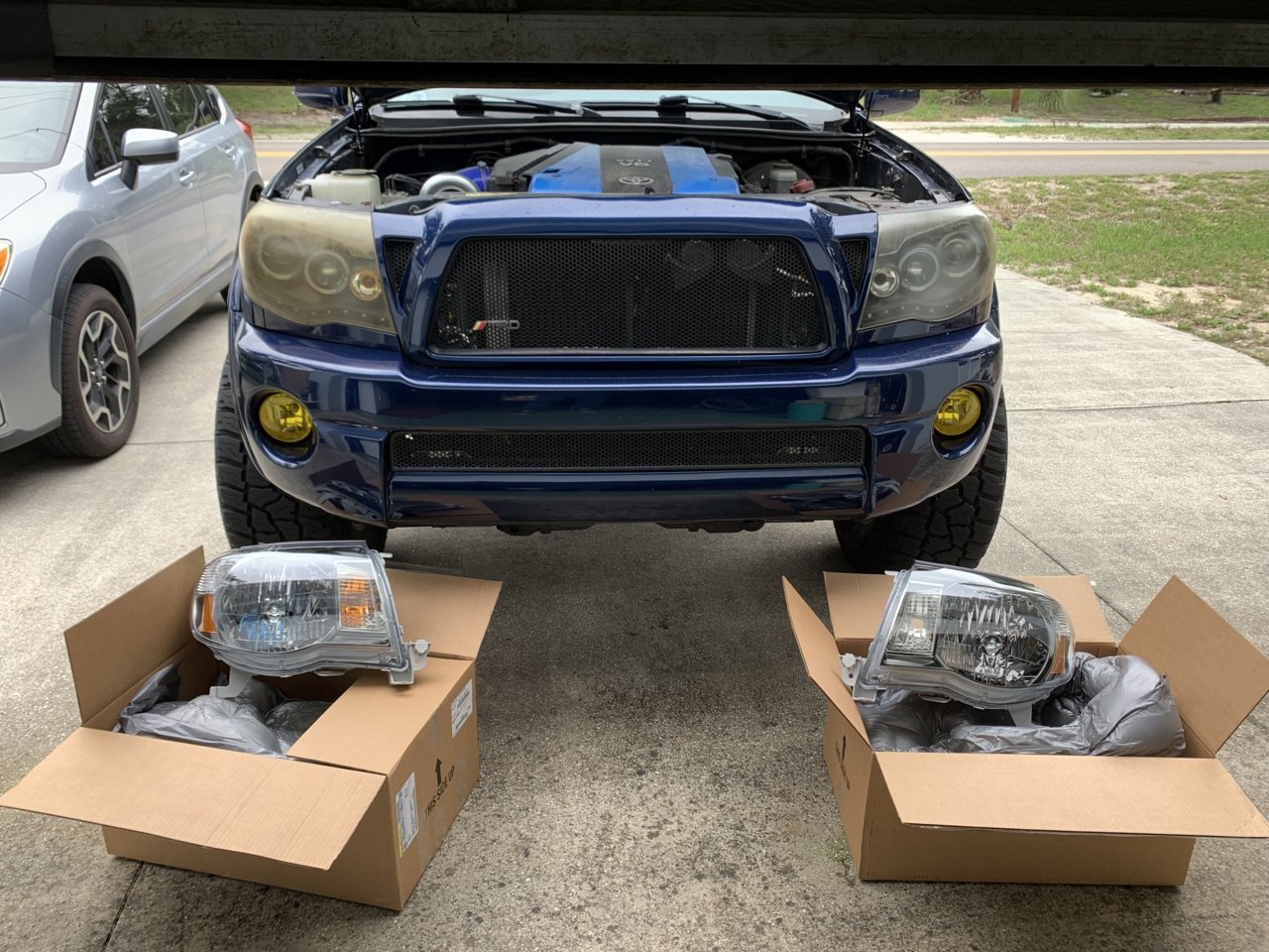

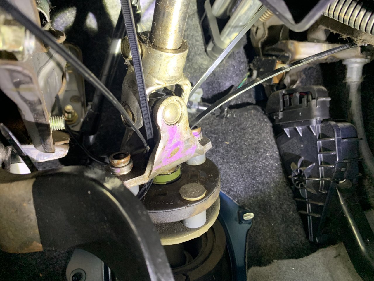

    What was the issue that causes you to do the zip-tie mod on the bushing? It has me intrigued and makes me want to go check mine.
    Ultimate headlight mod is one of my favorite mods by far!

    @dborrer X2. Interested about this mod as well.
    Been tempted to do the ultimate headlight mod as well. Soon or maybe I'll hint at it to my wife as a Christmas gift.
  17. Jun 8, 2023 at 7:02 AM
    elricfate
    elricfate Well-Known Member
    Nov 26, 2019
    #311771
    879
    2009 Tacoma AC Silver Mica
    Do it. It's worth every dollar you spend on it. Get a half dozen extra bulbs when you do it. The good ones are rated for only about 200 hours, so if you do a lot of night driving you'll need to swap them out often.

    My taco is a DD. And slowly I started noticing a sort of knock sound and feel in the steering wheel, when going over bumps and especially when bumps during a turn... Apparently there is a TSB for a better bushing/shaft, but the 4 wire ties create the bushing effect and obviously don't require you to remove that lower steering shaft, which is doable but not super easy...
