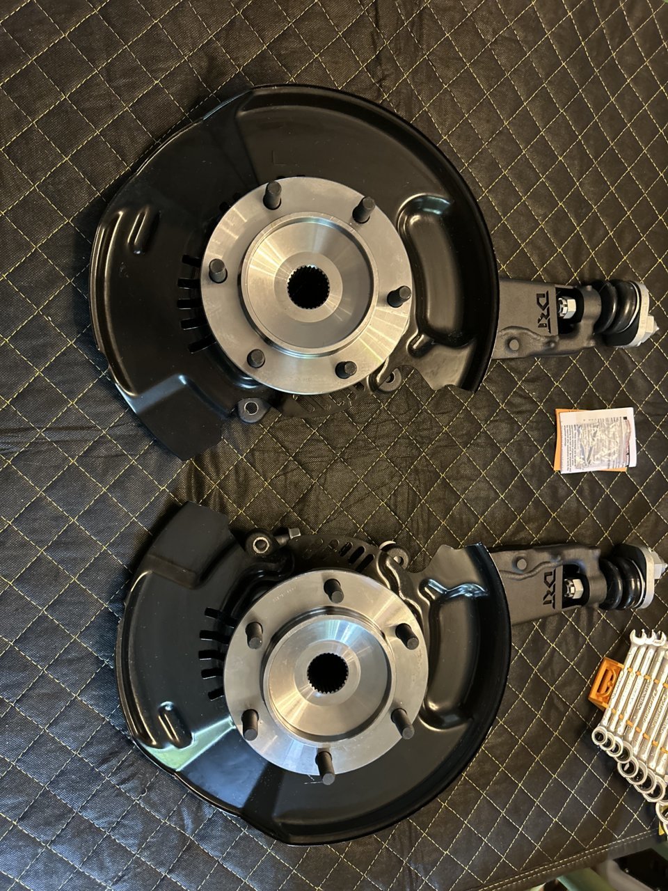

    15C11D06-EE87-42F7-A4CD-B0EF8AD73CC9.jpg Got front spindles assembled

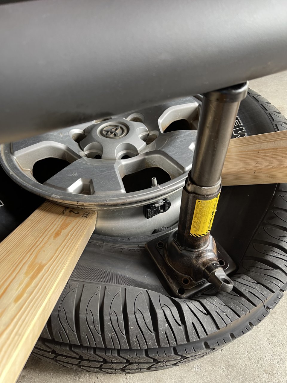

    I just changed the rear and front diff oil. I used Valvoline ATF.
    Also, I replaced a bad TPMS sensor with an Autel MX one. I got the hex IDs from the ECU with my Innova 5510, and one of them was bad, although I couldn't tell which one because the tires had been rotated and the ECU order wasn't the correct order. After much research, I decided to buy an Autel TS508WF with a set (4) of metal stem MX sensors, and a rubber stem one for the spare. With the TPMS tool I was able to identify which of the four sensors was dead, and I just used the tool to program one to the same ID of the one from the ECU that had to data. All I had to do now was to take out the sensor from the tire and install the new sensor.
    Here's the old sensor after breaking the tire seal with the taco factory jack:
    After installation and a short drive, the ECU recognized the new sensor as if it had never died:
    One thing I noticed is that the Autel MX sensor angle isn't exactly the same as the one that was installed, so it doesn't sit flush against the rim. There some minor play even though the stem is tight and there is no air leakage. I imagine that all is good and the sensor won't fly off the stem inside the rim at full speed.
    Now that I'm familiar with the procedure, I need to replace the other sensors which have been there since 2009.... and install one in the spare tire as well. Then I need to tell the ECU to recognize the tire order (FL, FR, RR, RL) so when I get an alert I can just plug in the TPMS tool to the OBD port and know which tire triggered the alert.

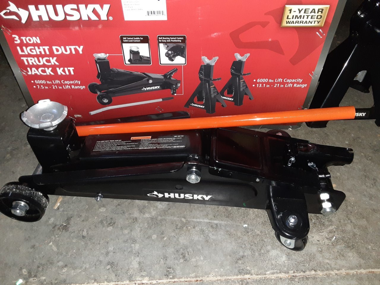

    20230610_144149[1].jpgCompleted a replacement jack handle since the kit was missing that part, which Husky Tool said would be 6-8 weeks out, and four hours later emailed that it is unavailable. I could take the kit back to Home Depot and wait for a replacement, but rather than subject a future customer with receiving this kit after it's back on a warehouse shelf, I drove to Pacific Steel for steel tubing. They're now commercial sales only, and referred me to a local welding and machining shop on the north side of Post Falls. After measuring diameter (a little under 7/8") and scaling the box images for length (23.98"), I drove out to the shop and farm, had a great visit with the owner and left with his "cut just over 24 inches" piece of schedule 40 steel tube. Spent the rest of Friday afternoon putting a smooth coat of Allis-Chalmers Orange from one of Dad's old spray paint cans that works, in three turns on an old newspaper. Happiness!
    Pacific Steel said that they're not getting much from China, and we know the Port of Los Angeles hasn't been very busy as China switched their trade emphasis to domestic markets. They stopped accepting recyclables (1/3 of returning containers would be loaded with recyclable material that would otherwise have been empty in the past.) Another reason to do things local...
    Now I'll be able to work under Barcelona Red and install the LCE Street Exhaust Header this summer.

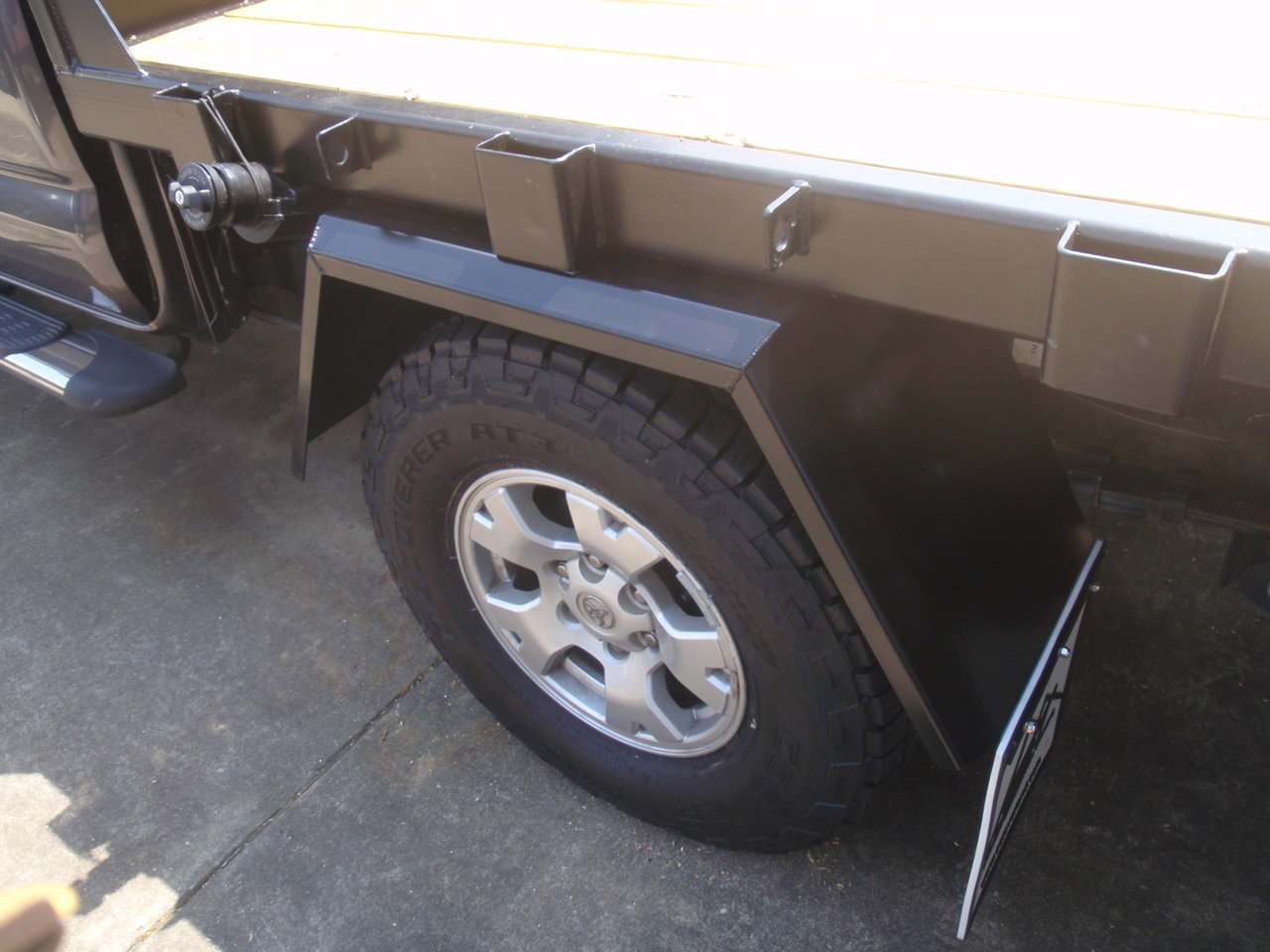

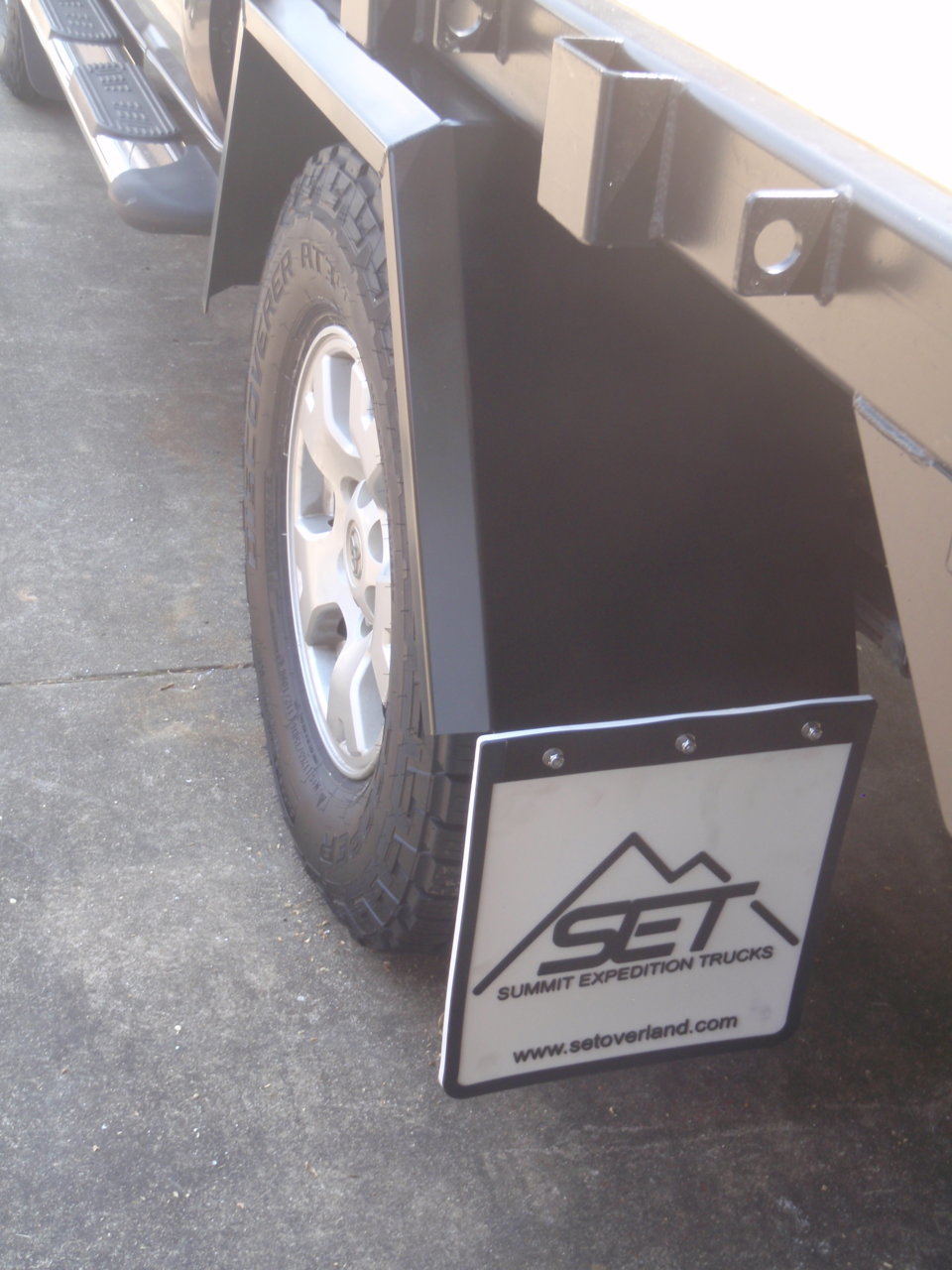

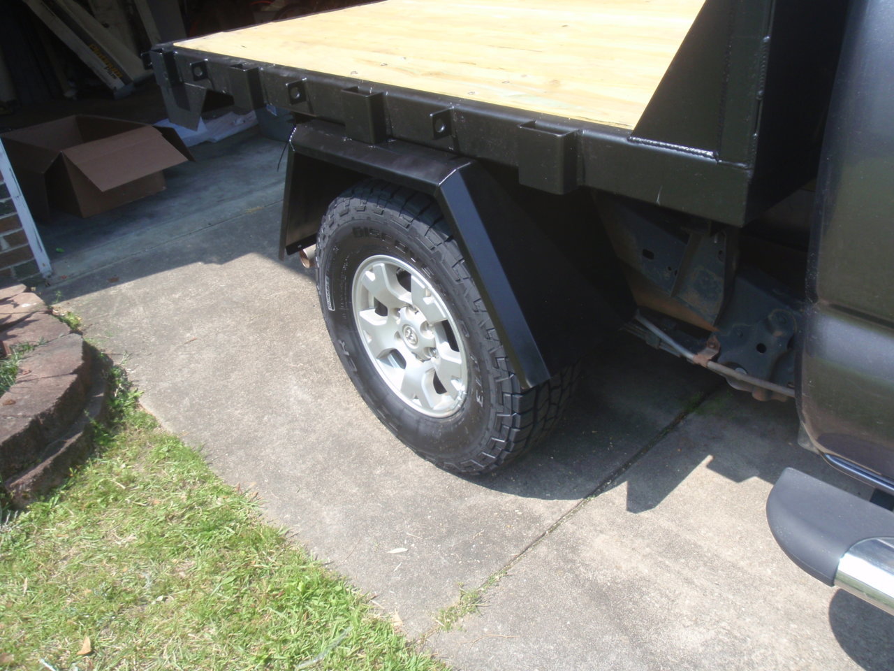

    Installed my Summit Expedition Trucks (SET Overland) fenders and mudflaps. Ralf at SET was great to work with and gave me constant updates- out of Alberta Canada.
    https://setoverland.com/fenders/
