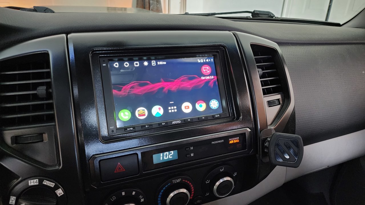

    Almost done with my Atoto A6 install on a 2012 with JBL. Got the steering wheel controls to work flawlessly, right now just waiting for my step down converter for the back up camera.
    I'll do a write up as I had a hard time piecing stuff together, and couldn't really find a direct thread on the install.

    I imagine the JBL caused a little more work plus the camera converter requirement. I didn't have JBL, or any amp, but I can really get the Kickers thumping in mine. That cheap unit has such a wide range of adjustments that I have no need for an amp. I like the bass boost for each speaker. That helped me with no sub. Glad you figured out the steering wheel controls.

    Well I bought a wiring harness (instructions vague) and turns out didn't even need. after some research and digging through wiring diagrams and finding a video of someone installing the same head unit in his F150. So saved $50-60. The head unit is amazing for the price and you are correct the EQ settings makes 100% difference than my stock HU. Very impressed and worth every penny.
    Working on my write up to post. Hopefully it'll help other 2nd Gen peeps.

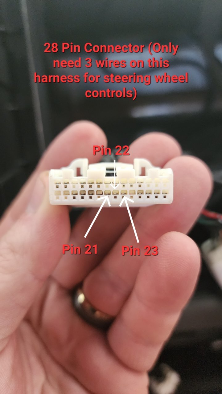

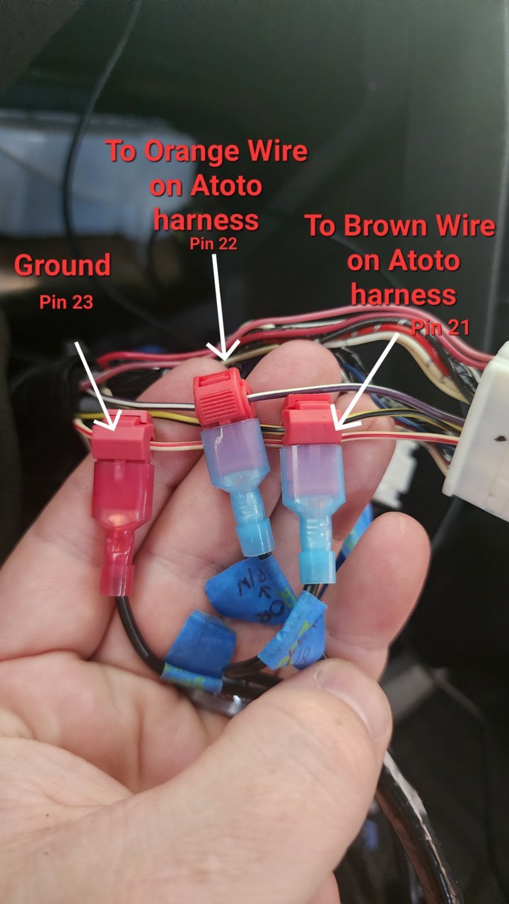

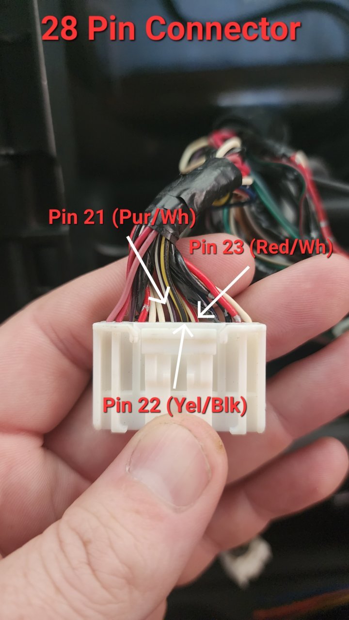

    So for the steering wheel controls you don't need any kind of wiring harness. You literally take pins 21, 22, 23 on the 28 pin connector and connect one to the ground and the other 2 to the brown and orange wire on the Atoto A6. Then program them in the head unit.
    This is really the most complicated part. The rest is just matching wires so not 100% sure if a separate thread is worth it. But let me know what y'all think.
