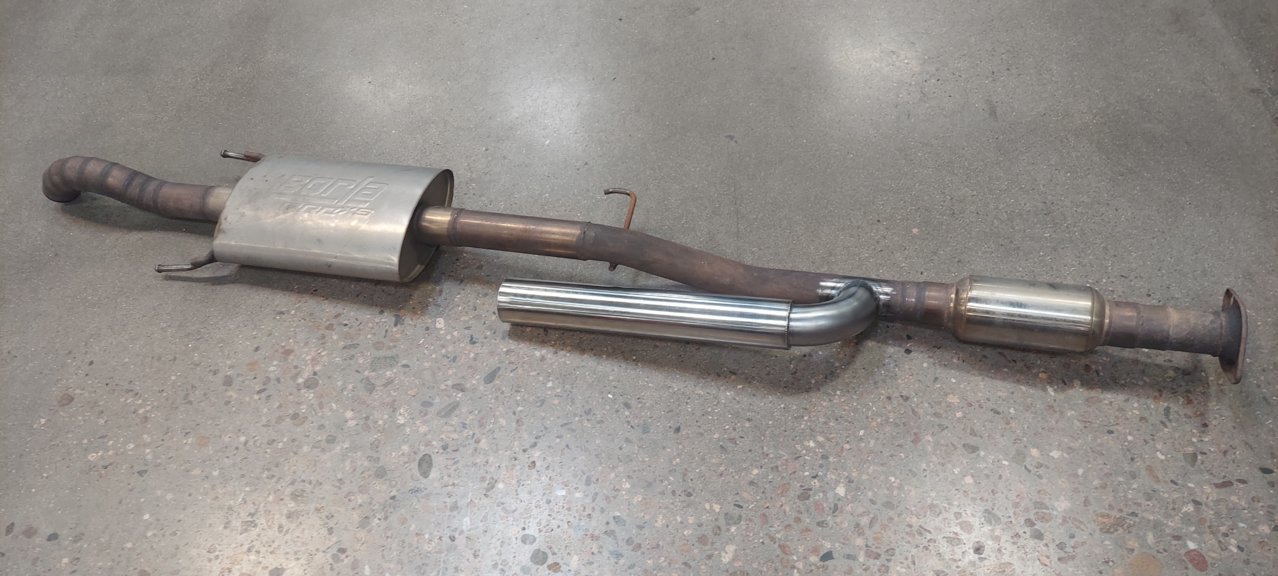

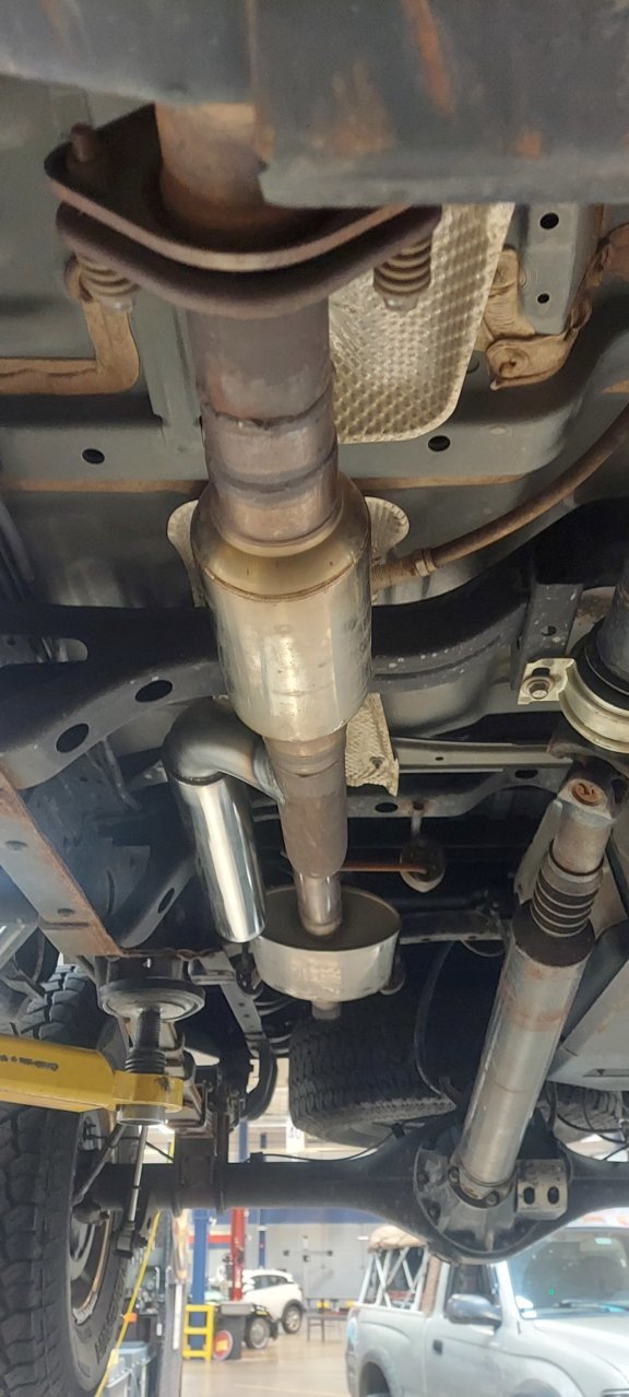

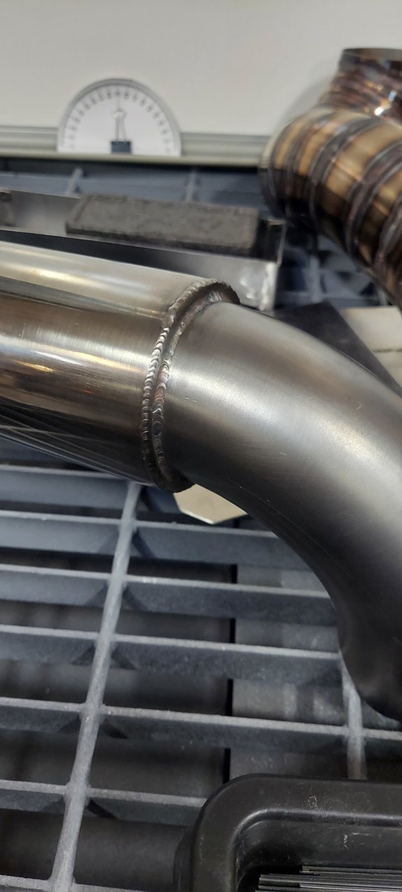

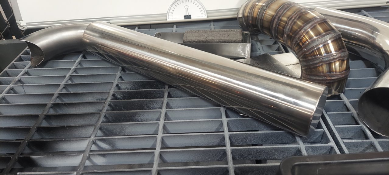

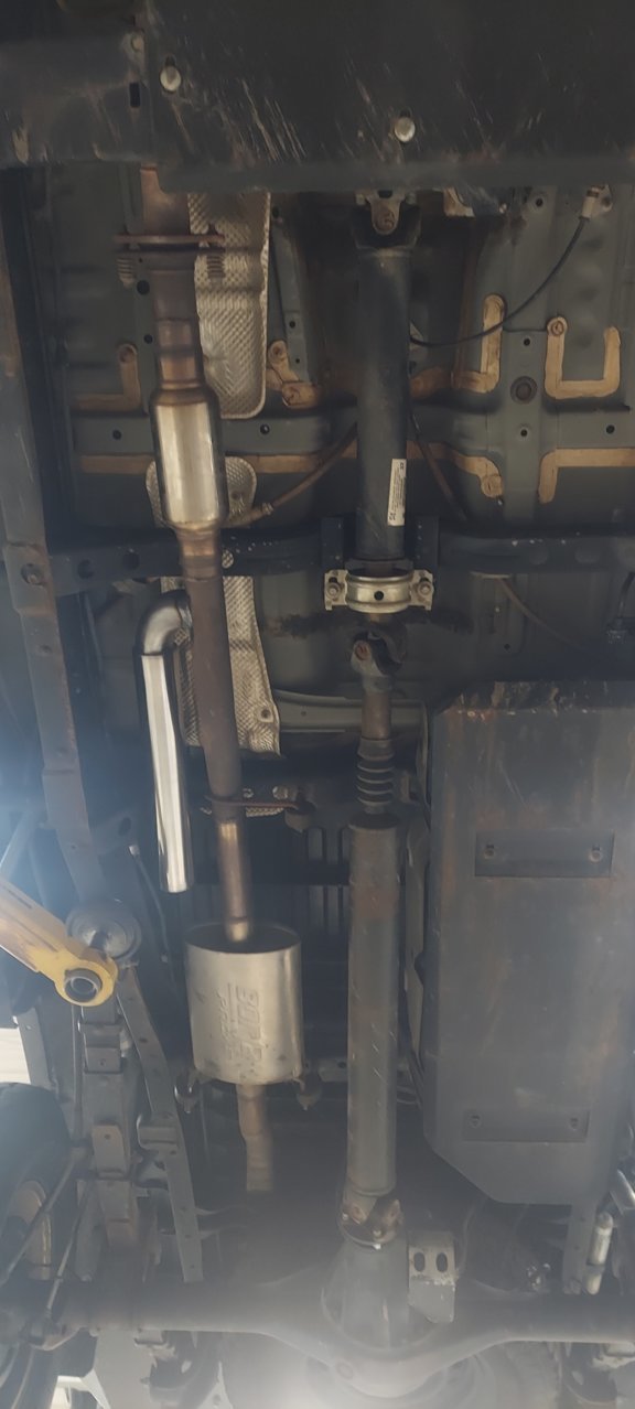

    Well guys, it worked WAY better than I expected, almost too well. Kills all drone from 2500-3000. I tried to record it but it doesn't really capture it.
    I used a 2.5" mandrel bend and 3" exhaust tube(both stainless). I capped with 18ga 304 SS sheetmetal. There is 5.75" of length in the bend and 18.5" in the 3" tube. I tuned for 125hz at 300deg F.
    I'm super satisfied with the outcome.

    Do you have an aftermarket y-pipe or headers? Also, what resonator is that before the J

    Yeah, I mean the stock muffler was split at the seam up at the frame since I bought it so there was always some extra noise, when I cut it at axle dump it got worse, when I removed the stock(and found it was split pretty much its full length) and added the borla it got worse.
