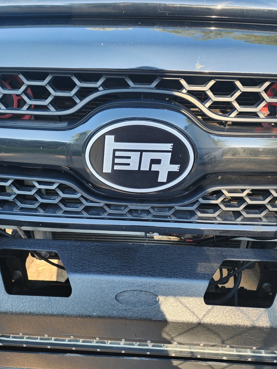

    Got a new grill emblem.

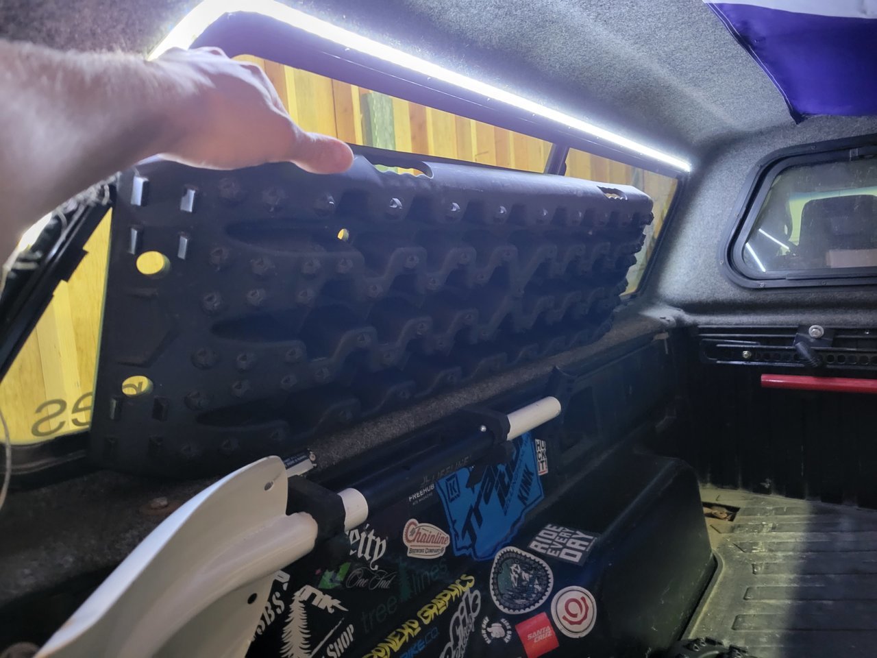

    Anybody have any solutions to mount Traction Boards up by the windows in a canopy? I'd also like to mount a spare gas thingy (rotopax?) On the other side. I want it up and out of the way of my bed.
    Shitty pic for reference

    I'd like to avoid drilling into the canopy. Maybe something that utilizes the bed rails?

    i mean aluminum bar is pretty easy to work with build some straps off of the rails, or maybe even build off of the canopy mounts itself. i would hate to drill into your topper and likely introduce leaks, and its not a quick patch if you hate it

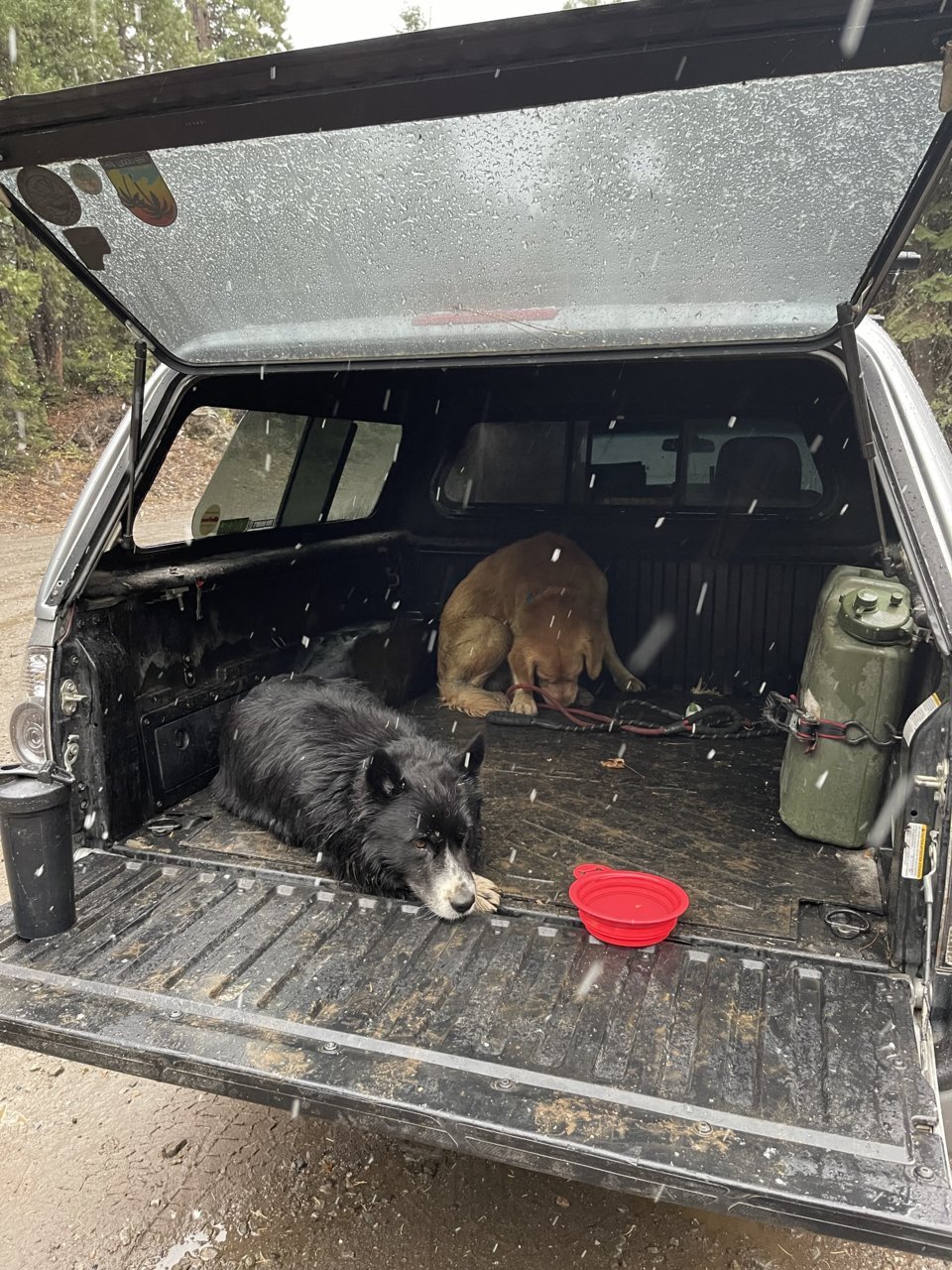

    Here is what I did. Water on one side, and fuel on the other side. Not always with me though

    Ya, I want it up and out of the way. Tons of space that isn't being used

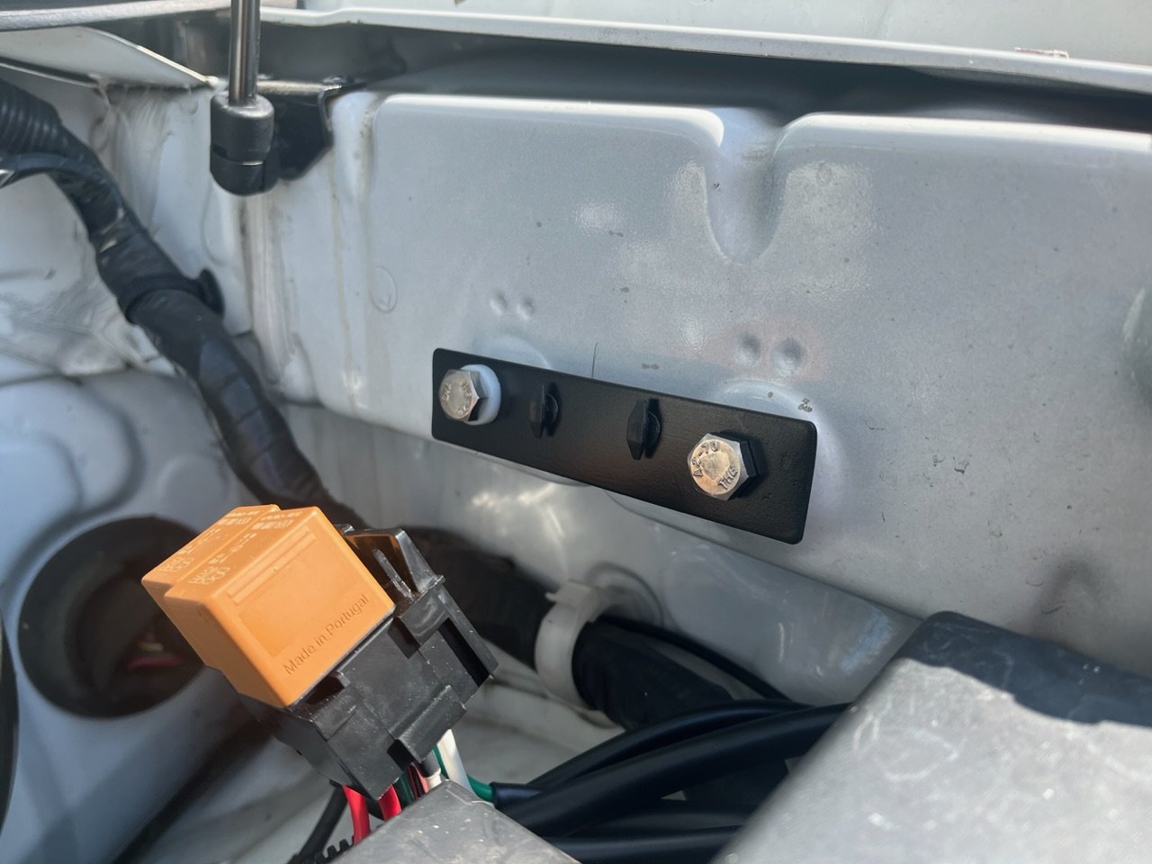

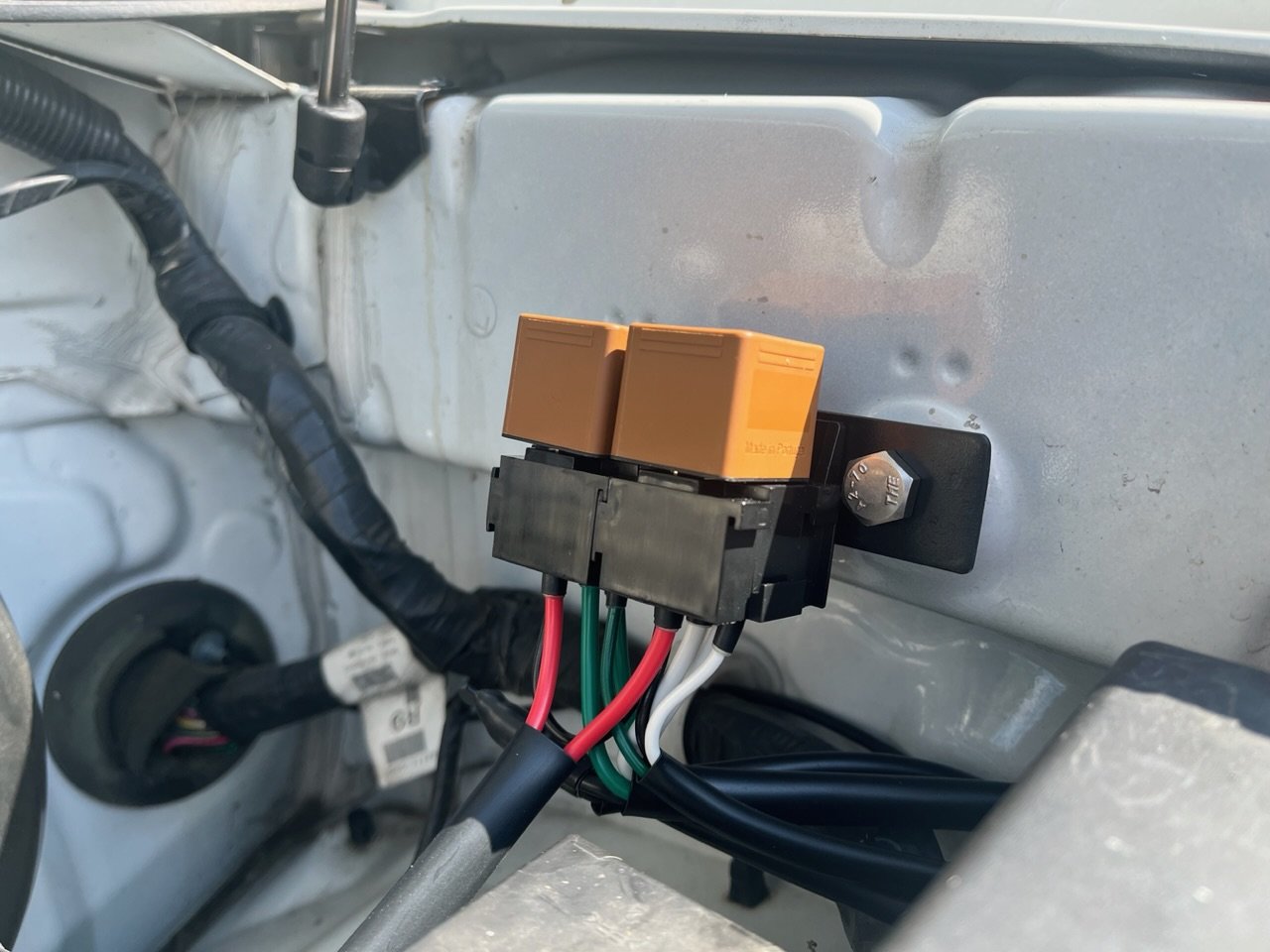

    Pictured is the aluminum bracket I put together for the relays. Nothing fancy but it does the job. I offset it from the inner wall of the engine bay with 10mm nylon spacers so it would clear the plastic clips I used to slide the relays over.
    For those wondering, the factory bolt holes are M8 x 1.25 in this location.

    that is the best part of toyota, if its not M8x1.25, its M6x1.00, well outside of the big stuff
