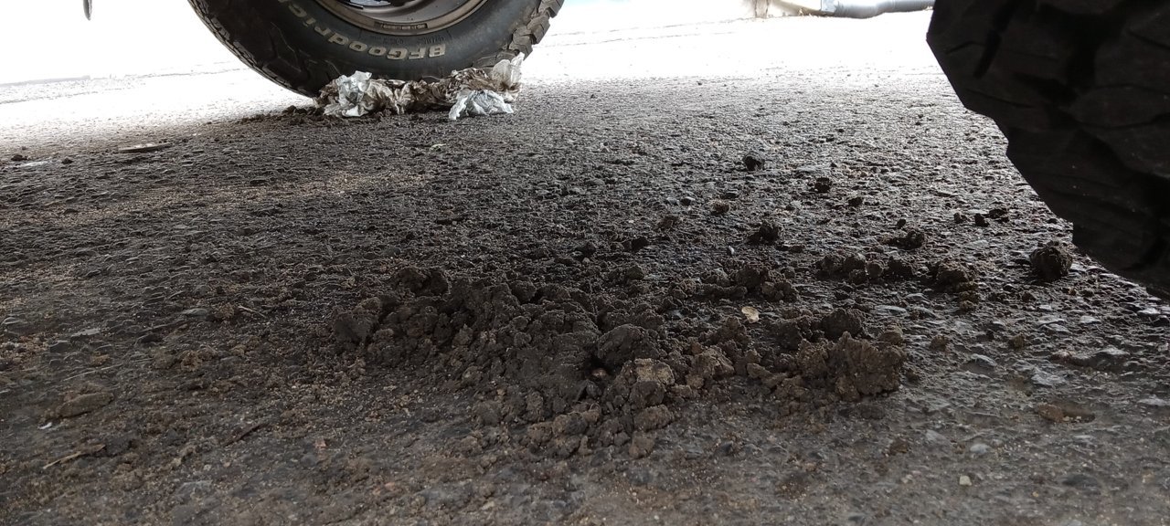

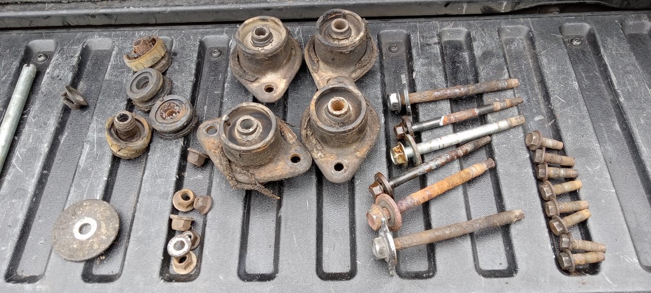

    Did the body mount the few last day.
    Had some problem with the part in the Whiteline kit but the job turned out great. Had to redo the hole in the 8 cab washer and plate mount. The job took 20 hours with the interior clean up and putting back everything together. I'm sure this can take way less time to complete but we love our road salty here so i took my time to not snap or strip a bolt.
    It was a great opportunity to clean the frame where the bushing go. You can't realy put your hand here when the bushing is installed. I was good to remove alot of sand/gunk. I was happy to see paint and no rust with all this dirt sitting there for maybe 10 year. Covered the inside with rustproofing oil and installed the bushing.

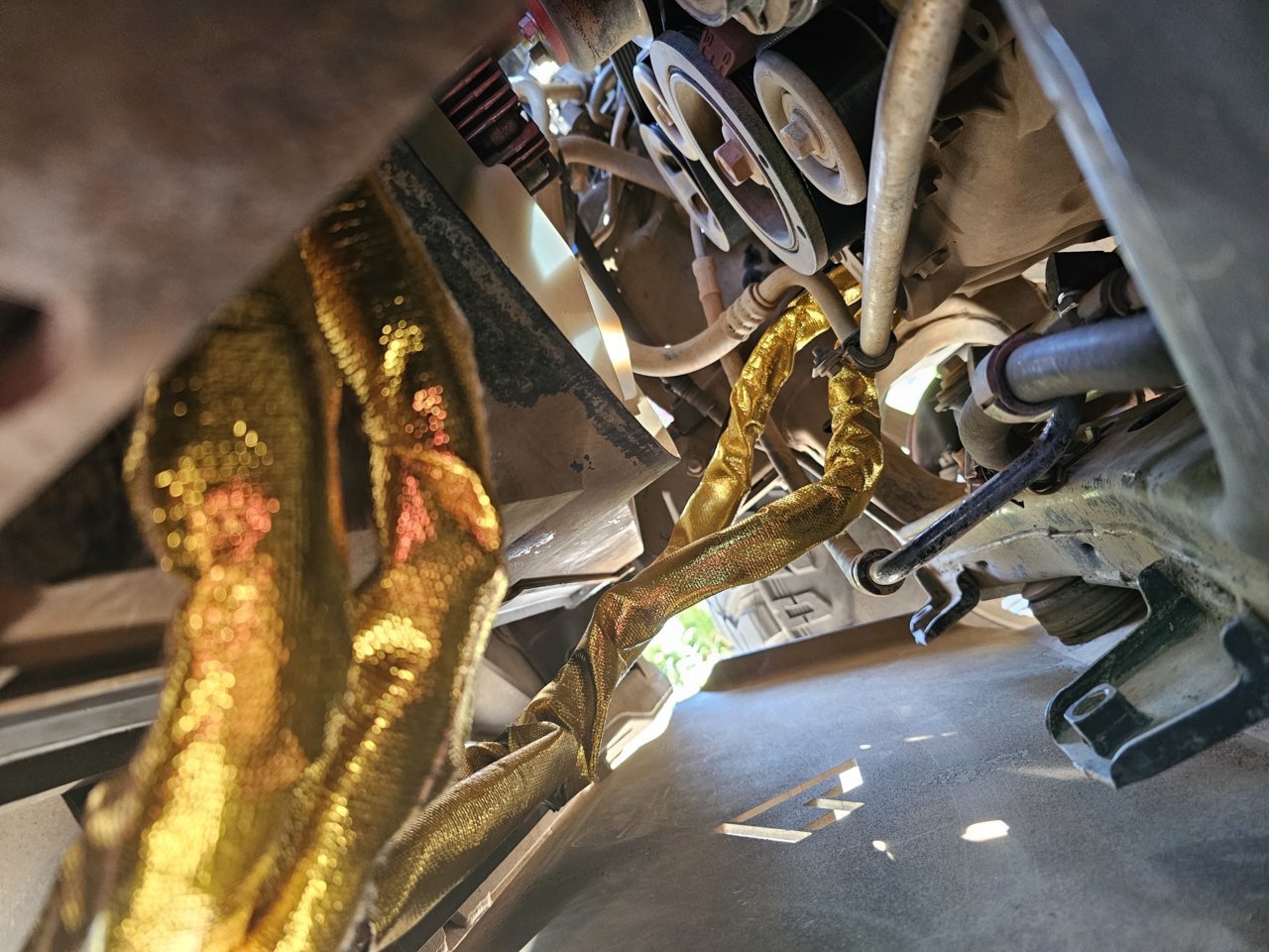

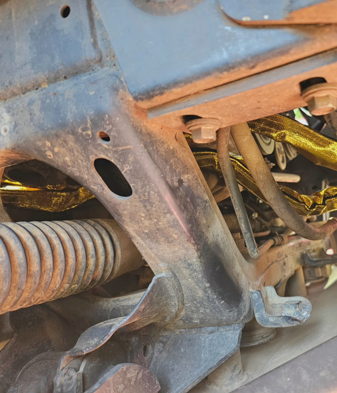

    Heat wrapped my transmission cooler line all the way from from transmission to the coolers to try and help with the temp.

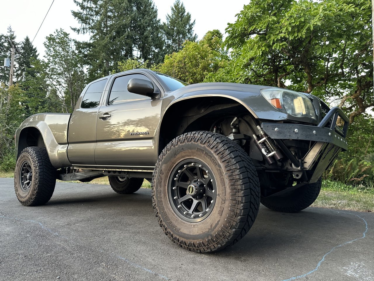

    Trophy truck style fiberglass fenders

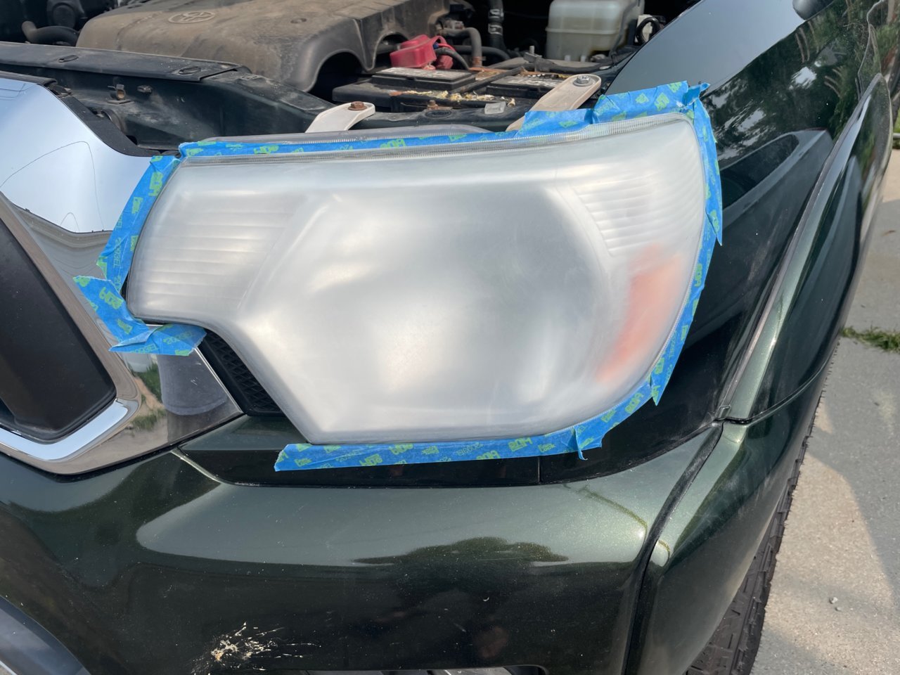

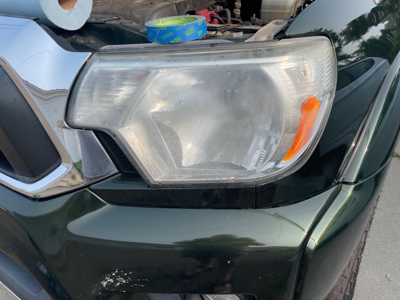

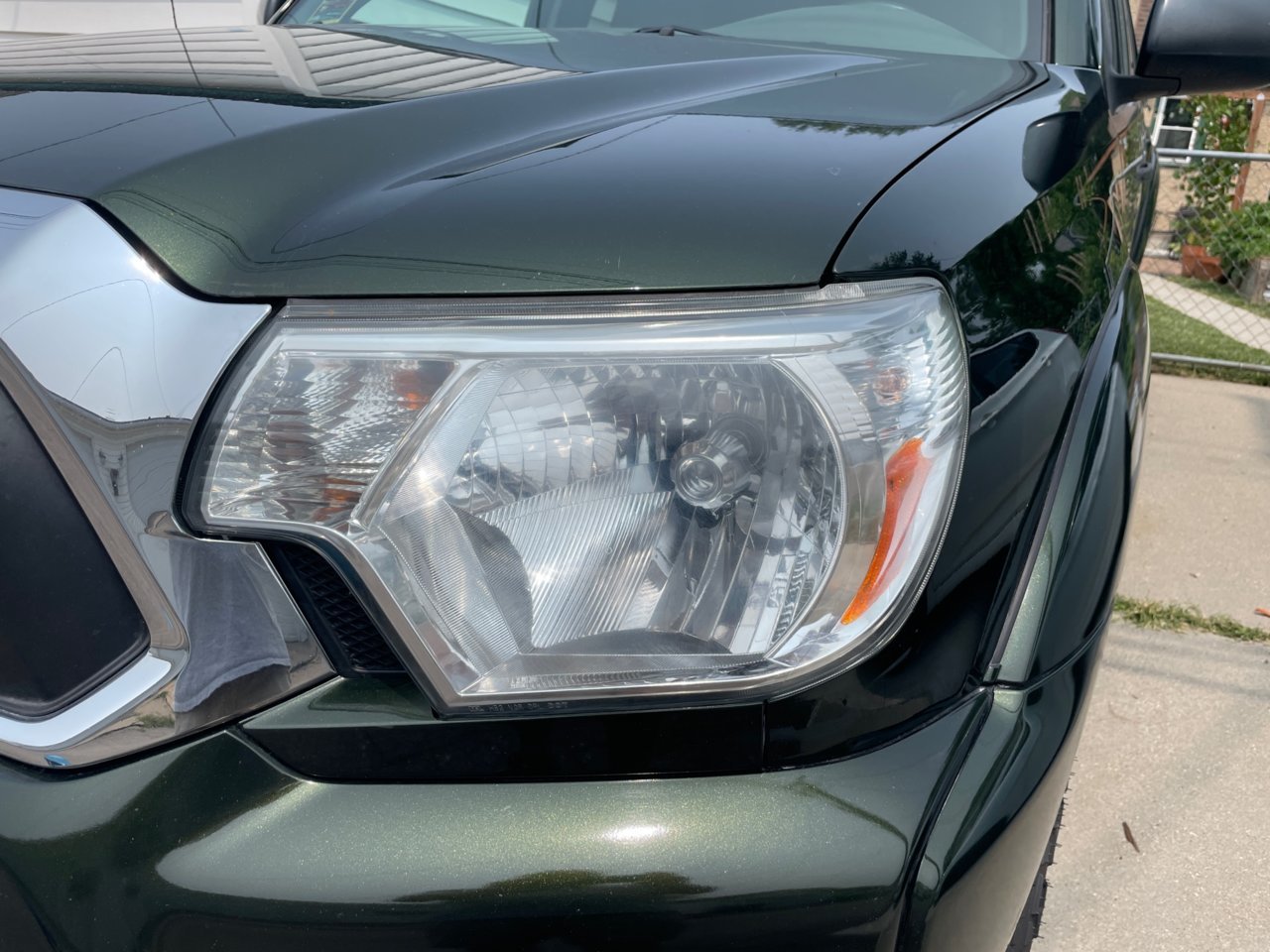

    Cleared up my headlights the other week with a 3M restoration kit. Easy enough to complete, and WAY less expensive than replacement. Driver's side progression pics to show the results. Very happy right now, much clearer, and better light at night as well.
    Original (11 years of wear)
    Mid-process...
    Final result after sanding and clear coats.

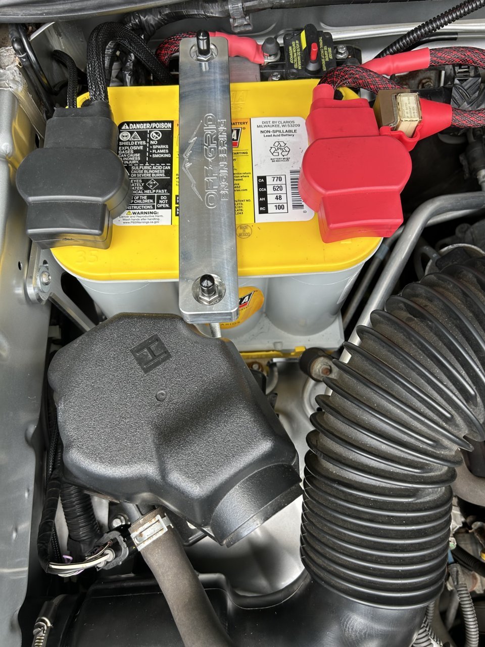

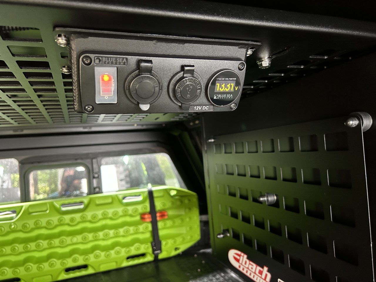

    Finally finished wiring my aux battery and got to see some things work for the first time! :)

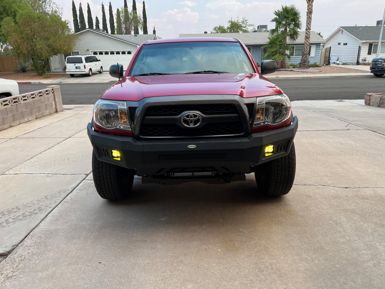

    Looks great. What year?
