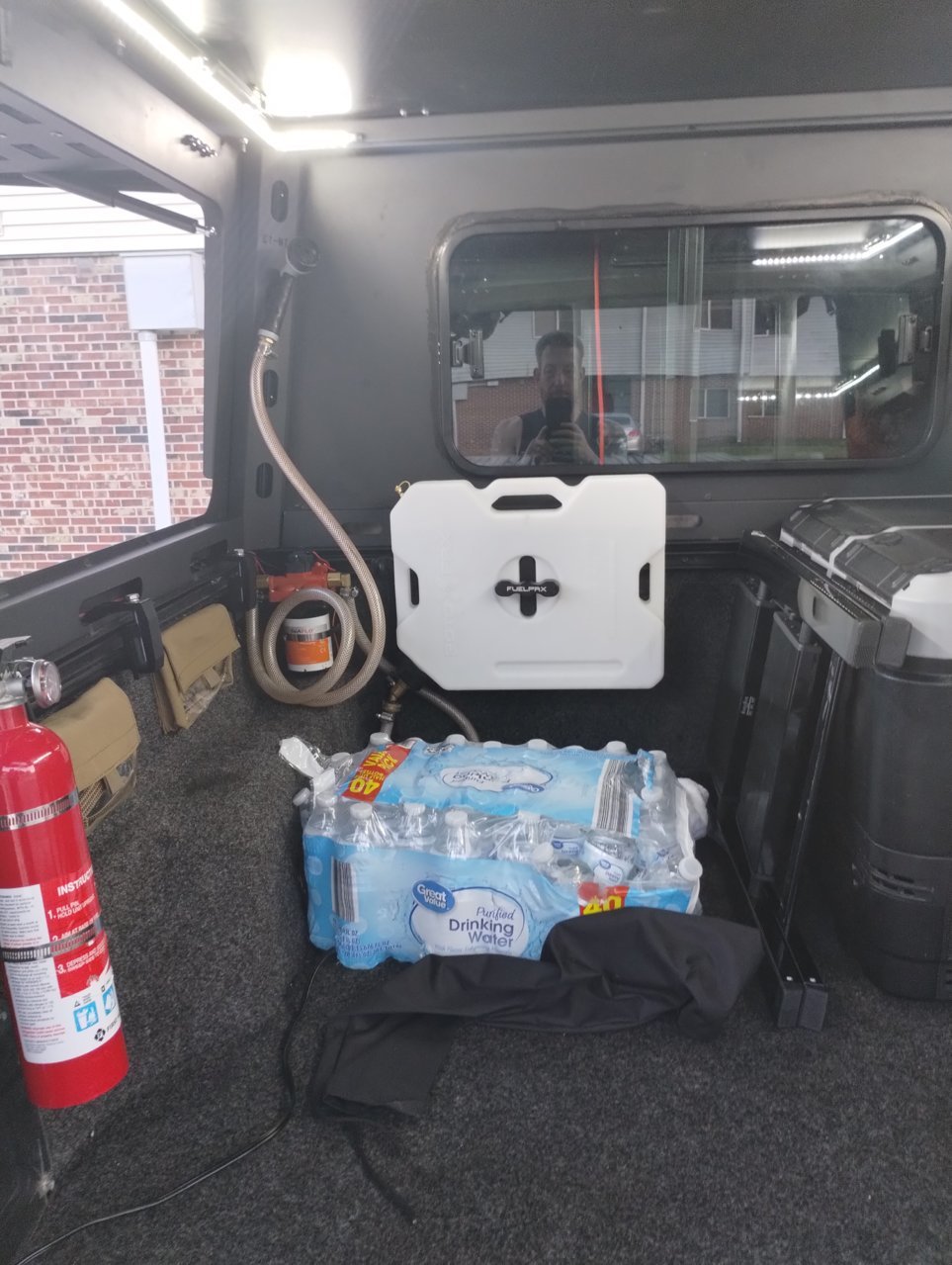

    Redid my water system....again. The spigot on the rotopax is nice!

    Can you store that at 45* greater than current, spigot down, on the rotopax mount?

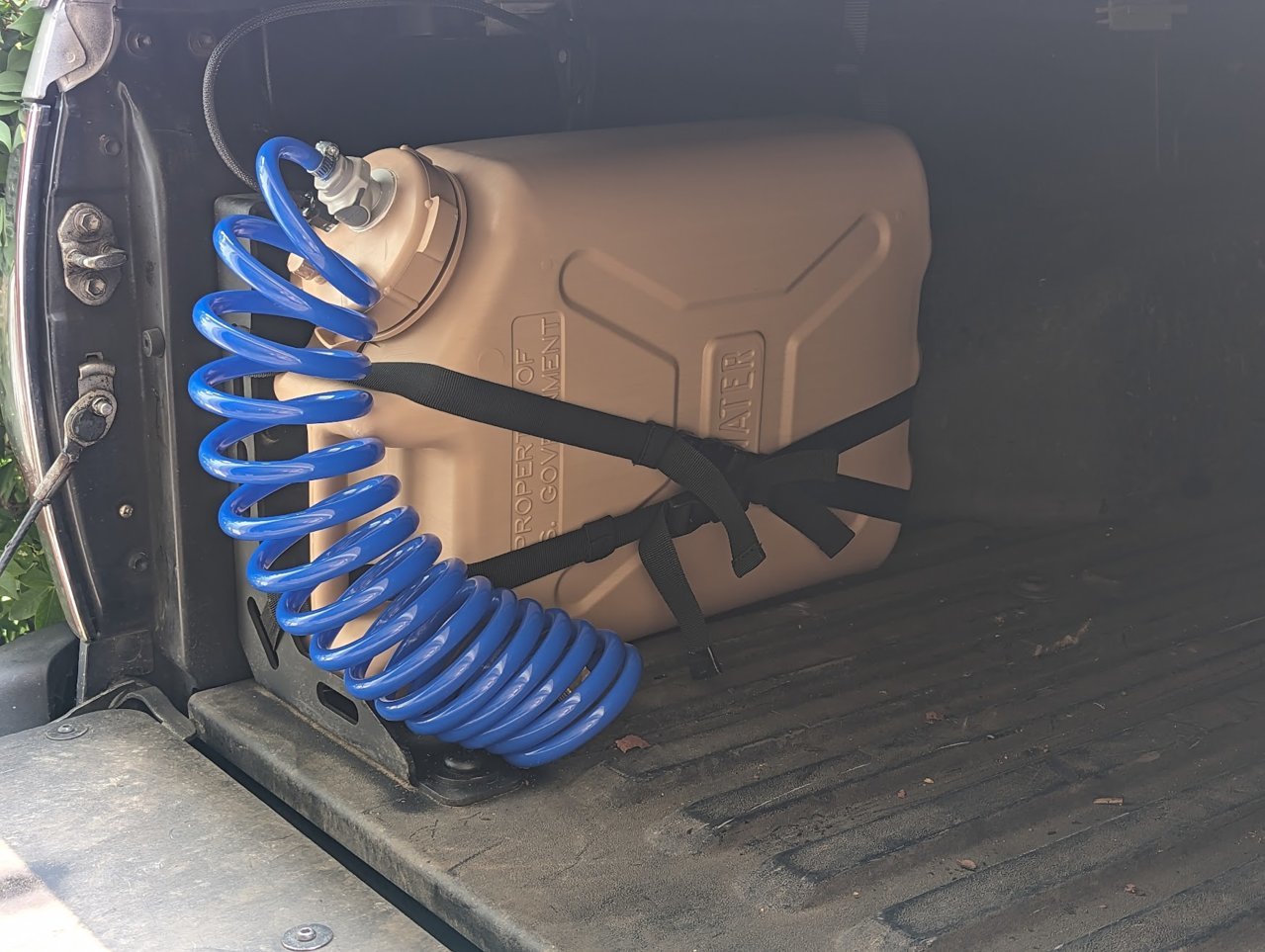

    Not really, but from observation - only their 2 gallon system will fit in a Tacoma with the bed rail mount. I like that the sprayer portion is self-contained so it doesn't require submersion of an in-tank pump, or hard mounting of an external tank pump, but that also has the drawback of being a proprietary charging/battery system. I really really like the "rain collection" aspect of using the entire long side of the tank as a graduated funnel system.
    Having said that, I prefer my DIY implementation vs it, even with an in-tank pump. It's 5 gallons, it straps easily in place, I just used it when I was out on a mountain in MO for washing/spraying/mess duties, and it kept up with me and two other people both washing our hair twice, and all our dishes, and I still had a gallon in it when I lit out for home 4 days later.

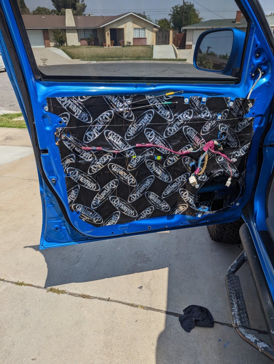

    What did you use as a hard surface to patch the bigger hole(s) in the door?

    Honestly I didn't even use anything. I know it probably just material being wasted, but it made a huge difference.

    It locks in at any setting. The Marine pump I have pulls like crazy so I think I'll be fine. But I might adjust the cant if I need to. I have a trip out this weekend and with the heat I will for sure be taking a shower in the evening.

    I heard that it's best to cover the hole with something hard and then sound deaden it.
    I'm sure what you have is better than having the hole open, but the sound deadener might act like a lung and mess the quality a little.
    Don't take my word for sure but that is something I've heard from someone that claims they are an expert lol. I will try to patch my hole with something when I get around to sound deadening!

    It’s impossible to fully seal the door because of the window of course. Any speaker would sound so much better if it was possible, but it sadly isn’t. However, you are correct with using a hard cover, it will add more rigidity to the panel to cut down on loss of acoustical energy. My plan is to buy a big cheap 1/8 or 1/4 thick HDPE plastic cutting board from Walmart for each door, get them all cut out, and mount them with threaded inserts. I’m going to make a build page in the TW AV section so others can reference.
