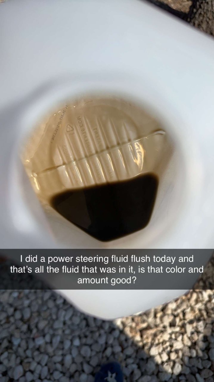

    Also decided I wanted to flush the power steering fluid. “flush” being a key word because this is all the fluid that was in the reservoir. Maybe 4 oz, and for those that don’t know PS fluid should be yellowy clear. I had 44 oz of power steering fluid. Put oz in, cycled the wheel and pumped it out until I was out of new fluid. Didn’t get it back to perfect, but got it to full and only slightly murky fluid instead of black. As you can imagine my steering is much smoother and quieter. But I’m sure i’ve got a leak. The cheapest way to fix a leak is just to let it all run out

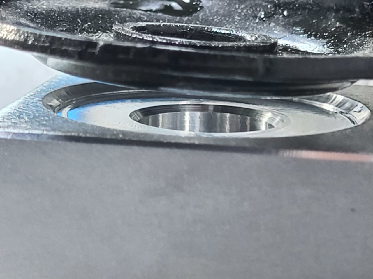

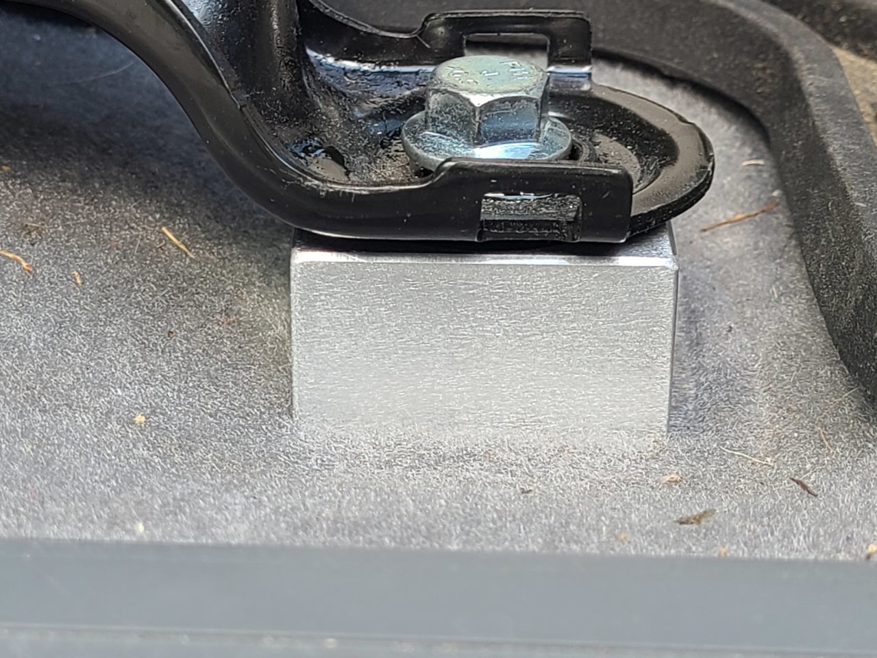

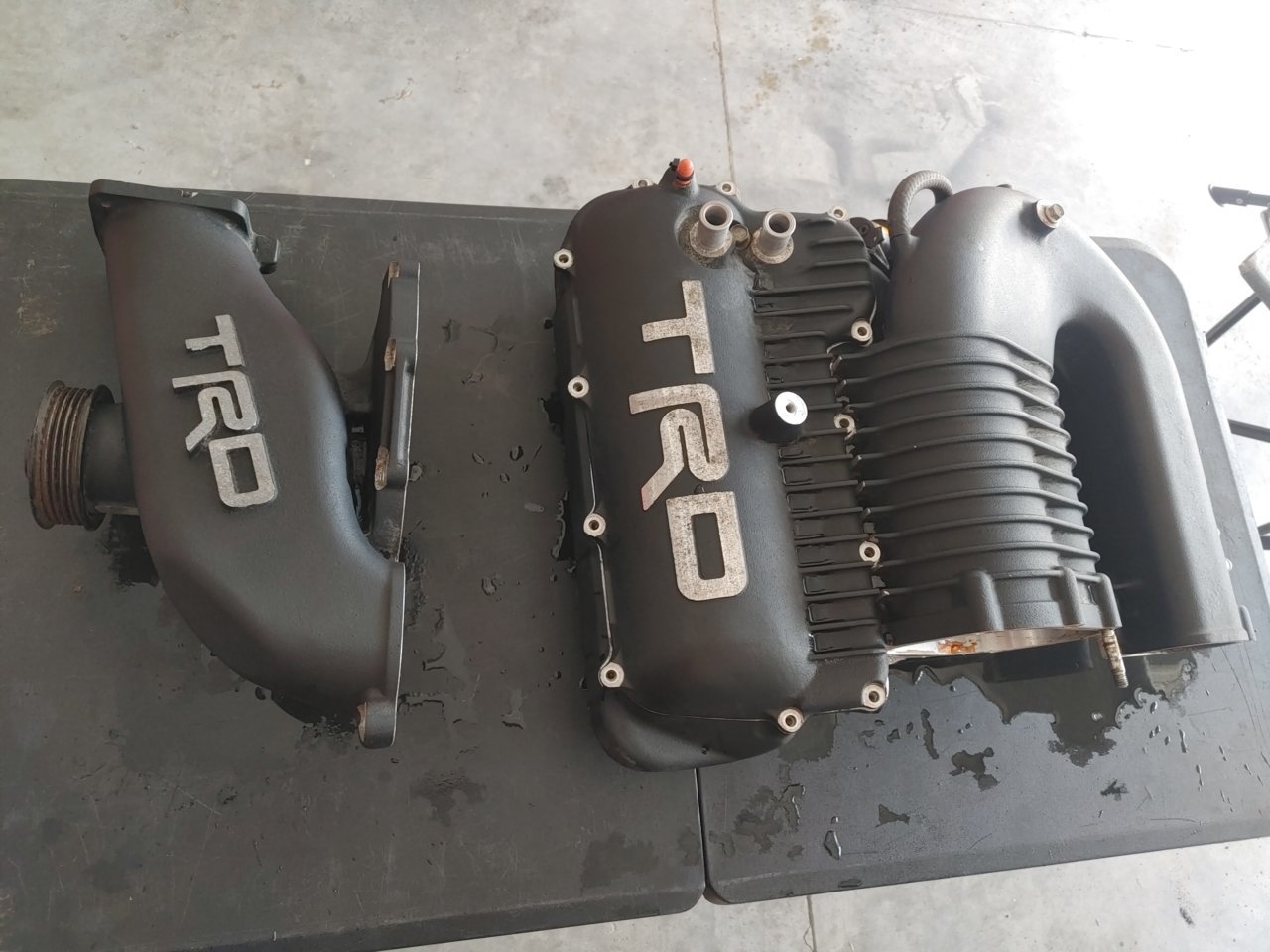

    I redesigned and released all new QuikFix™ "safe" spacers for rear brackets of front seats (2nd gen/3rd gen/FJ Cruiser). Brackets sit in the spacers securely instead of on top of flat spacers. 20230818_080132.jpg

    I use Maxlife ATF for my power steering fluid, which is reddish in colour. I suspect there are a few different colours of PS fluid, but like you mention, black fluid is an indicator that maintenance is required.
