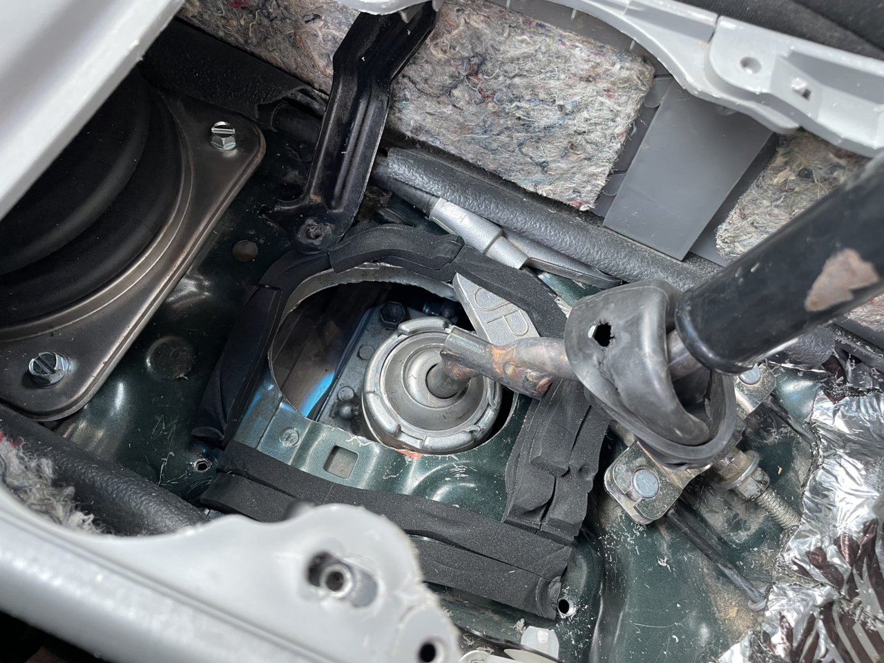

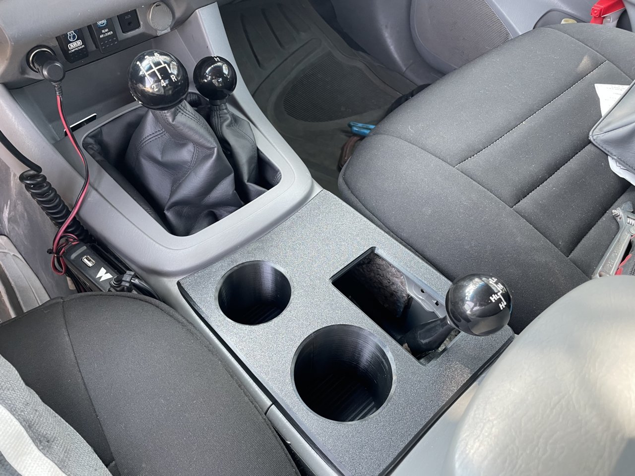

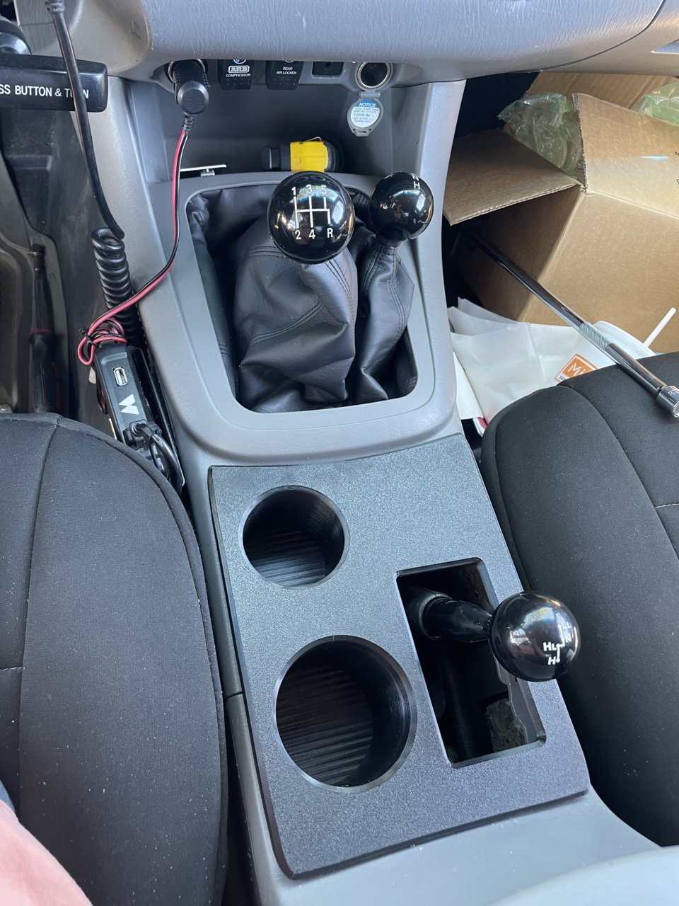

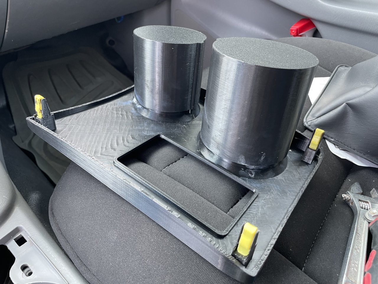

    Relocated my AWD t-case shifter and added a 3D printed cupholder this weekend. Working on a boot for the cupholder’s shifter now
    Before
    After

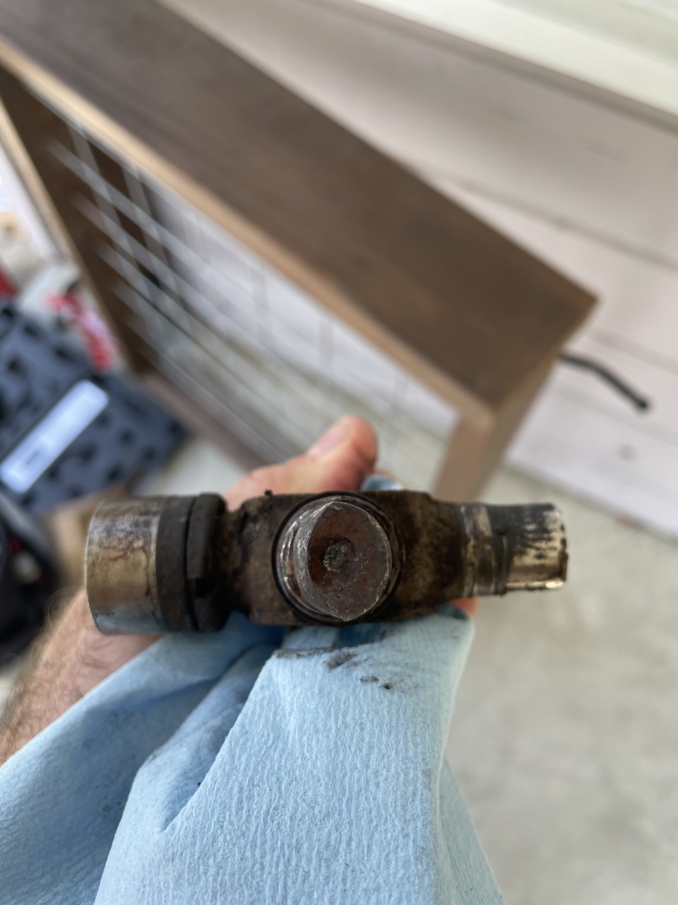

    Got through Rubicon, and swapped out my driveshaft before heading home. Thanks a ton for the spare, @Radarninja!

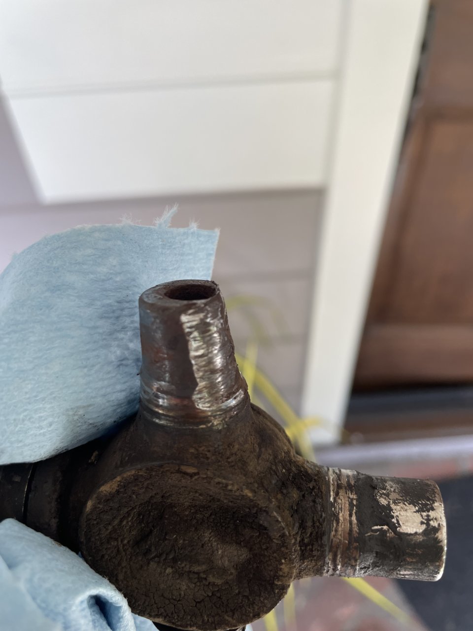

    What did you weld that extension with?
    why not put both in the console so they’re separate from and not hitting the shifter or your hand?

    How this thing should have come from the factory! The AWD is pretty sweet in a truck other than the gas mileage
    I tig welded a piece of a harbor freight 3/8” drive socket extension on it.
    I didn’t want to deal with trying to make 3 shifters work together. Seemed easier to just relocate the rear one since the front two didn’t require any modifications

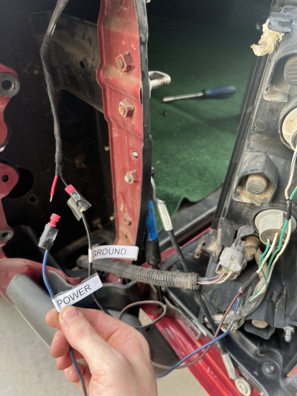

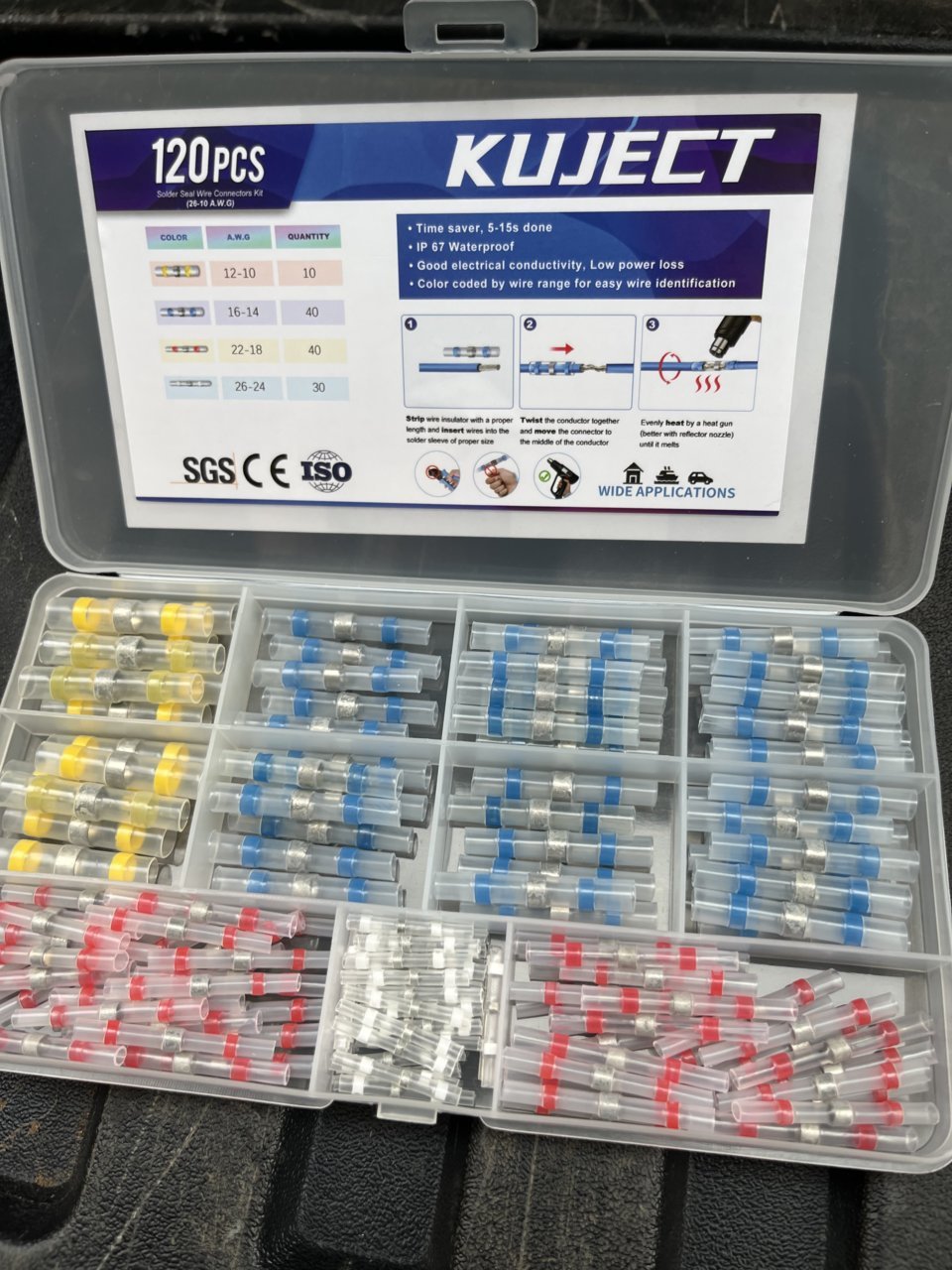

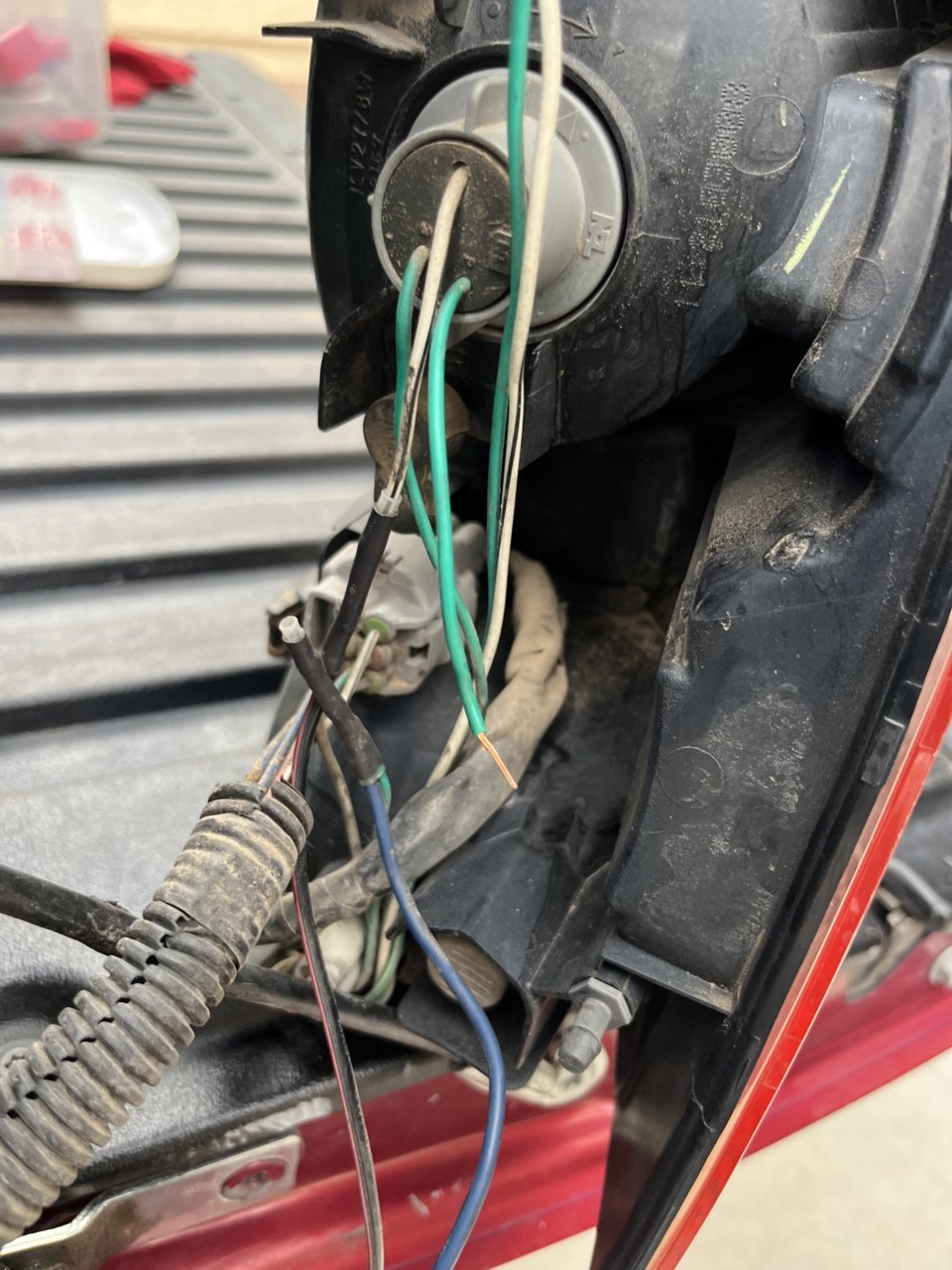

    Both driver & pass side brake lights were out. Only my LED camper brake light would show when brakes were applied. I also found these two less-than-ideal connections that I fixed with heat shrink solder tubes.
    I also replaced both tail light bulbs. I can’t tell if the bulbs were entirely to blame on the lack of brake light illumination here based on the wiring failures, but the $9.50 was well spent on fresh bulbs after examining these. Cheap insurance.
