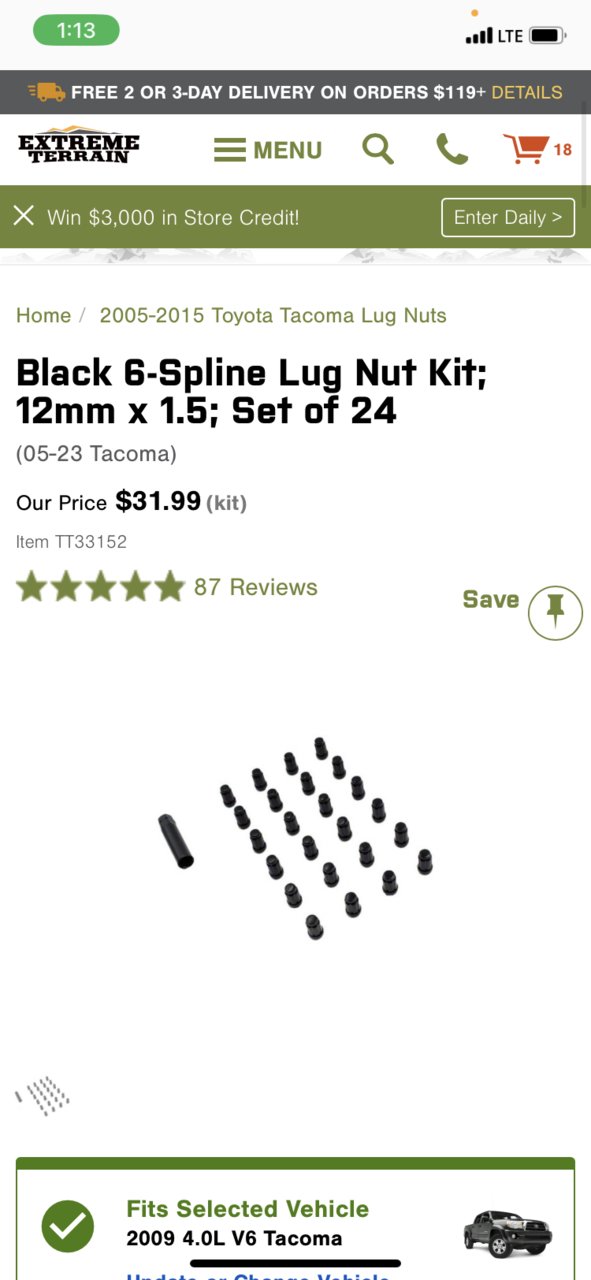

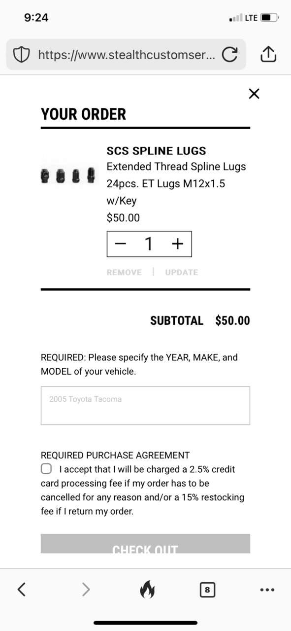

    Not sure if you've resolved this by now but if you have oem aluminum or many aftermarket wheels you need ET lug nuts (extended thread) I'm guessing that's what you mean by looking "different where they go into the rim". The other common style is just a conical/acorn seat lug nuts that sits against the wheel differently. Those are only for the oem steel wheels or some aftermarket ones. Amazon has sets of both versions in black or chrome for regular hex style, for splines I have heard good things about the gorilla brand.

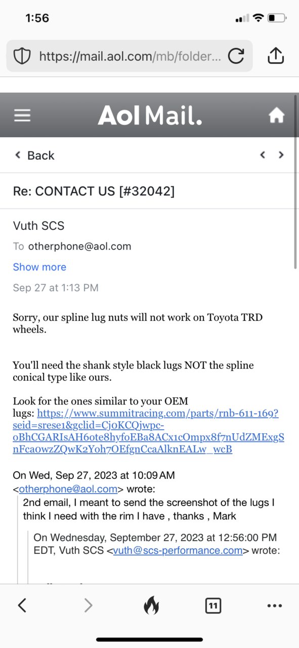

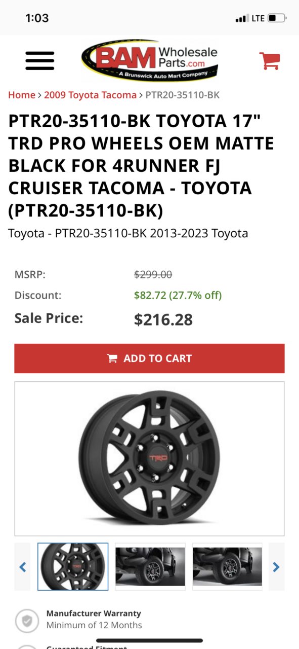

    They say they don’t make lug nuts for these rims

    Interesting, not sure why they wouldn't work with those wheels specifically

    Because the Toyota wheel is a mag seat wheel. You can not use a conical seat lug on them.

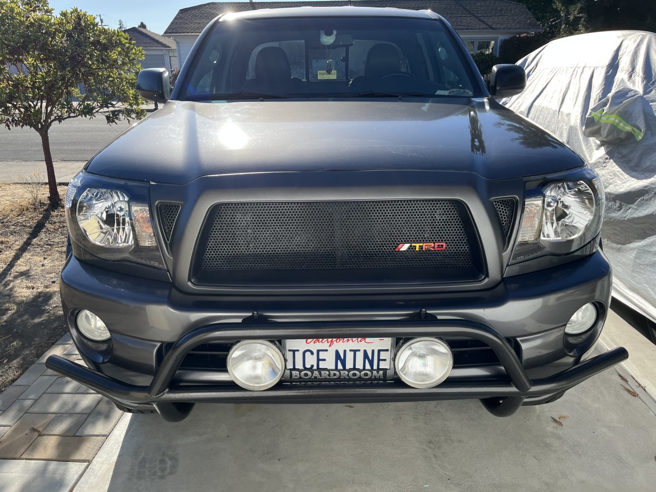

    Added a new Licence Plate frame.

    Cool frame, love the actual ICE NINE plates though!
