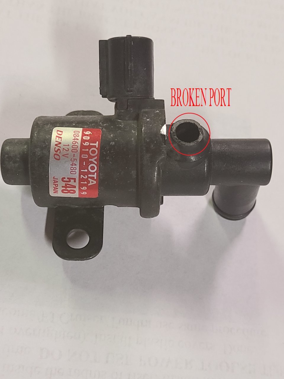

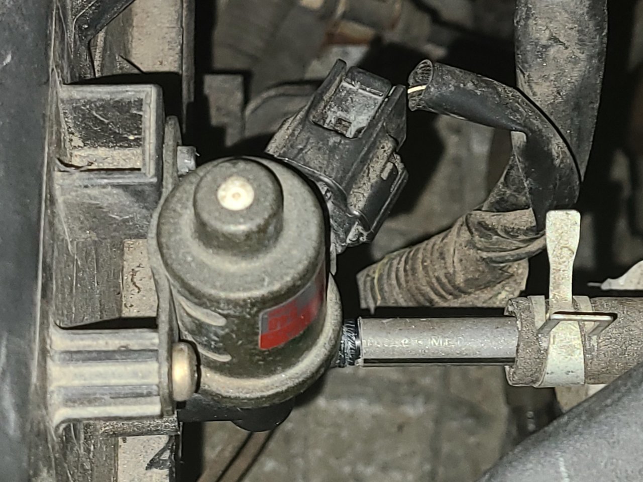

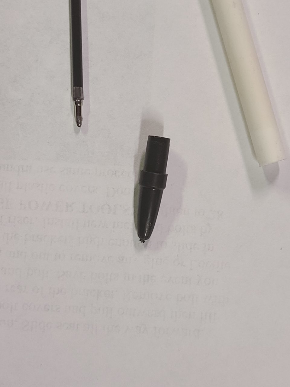

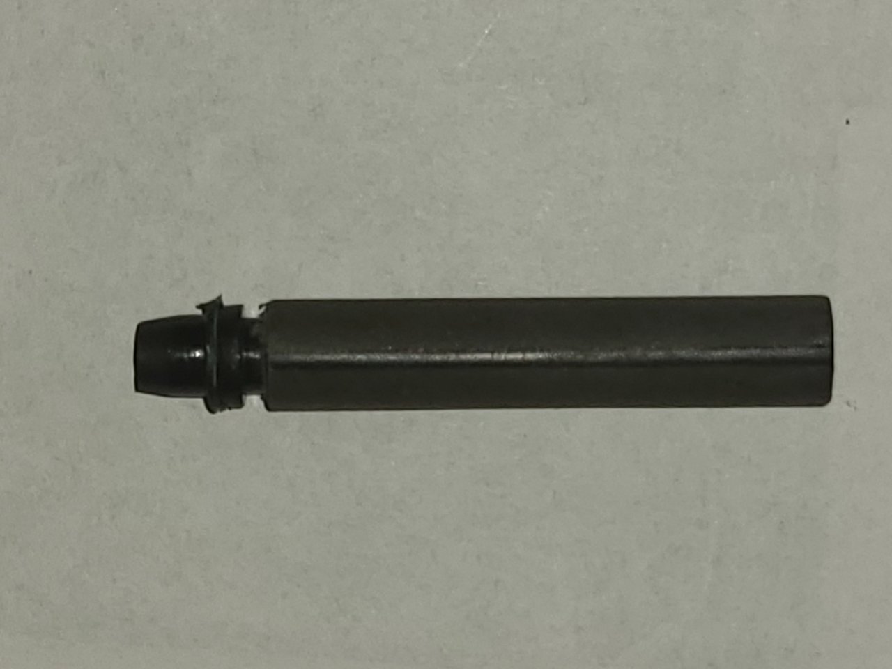

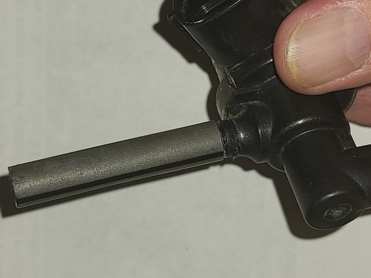

    I don't think I have seen this issue on any gen of the Tacoma but, just in case, this fix may save you a few bucks one day if you have a broken vacuum port. I was driving my 2003 Camry today and the CEL popped up. Ran ok. Got home, ran a scan, and had P0441 and P0442 for VSV faults (purge solenoid). Popped the hood to check the vacuum lines. Sure enough the vacuum port was snapped off at the base of the solenoid. Cheap part to replace from $35 on Amazon to $60 at local stores. Pulled it off and figured I would try to fix it. Long story short I fixed it free. Took an ink pen apart, removed the tip holder, turned the tip (on mill with lathe insert clamped in vise) for a press fit into vsv, cut a short piece of the pen body and superglued it together and into the vsv. Fixed and no codes. Saved a few $$$. MacGruber !!

    Idk if I trust super glue lol maybe epoxy it

    Probably didn't need glue or epoxy since I made it such a tight press fit. As long as it holds vacuum I will let it ride. If it fails tomorrow it only costs me one ink pen. Better than paying Autozone $60, or Toyota $110, since I can get a Dorman from Amazon for $34.

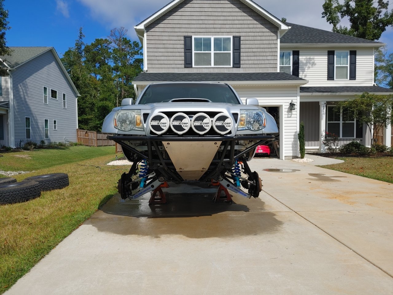

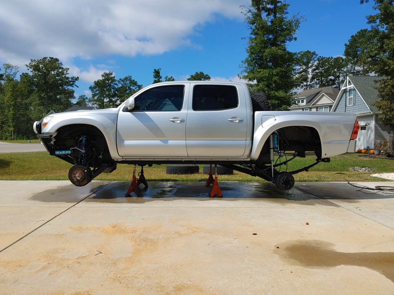

    Deep cleaning before she gets put away for the year. New engine and supercharger going in this winter. Hopefully these pics werent taken moments before disaster.

    Sick hovercraft ya got there :thumbsup:

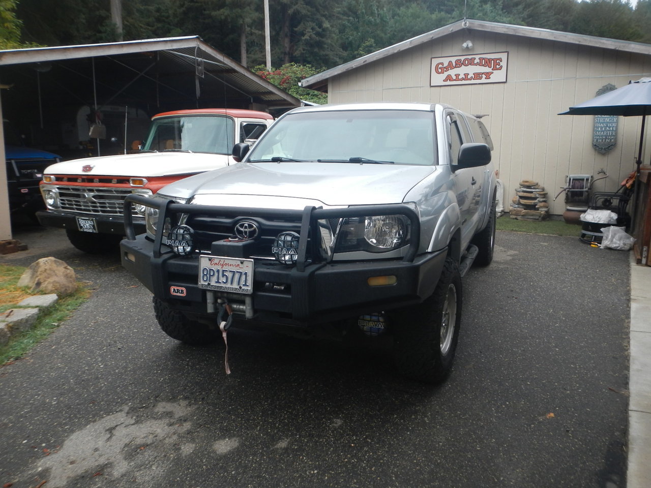

    what's the brand of that bumper ? me like it!

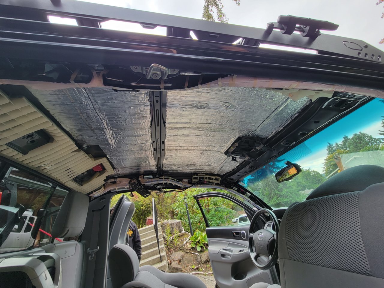

    Sound deadened my buddies roof. Makes a huge difference in sound in my opinion. Might just have to do mine now.

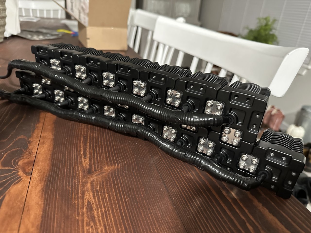

    Mounted some new lights today. eBay special that I took apart and remounted with send cut send brackets.
    same lights that extremeled seems to peddle at a massive markup.

    How long did it take?
    Was it difficult getting the headliner out without damaging it?
