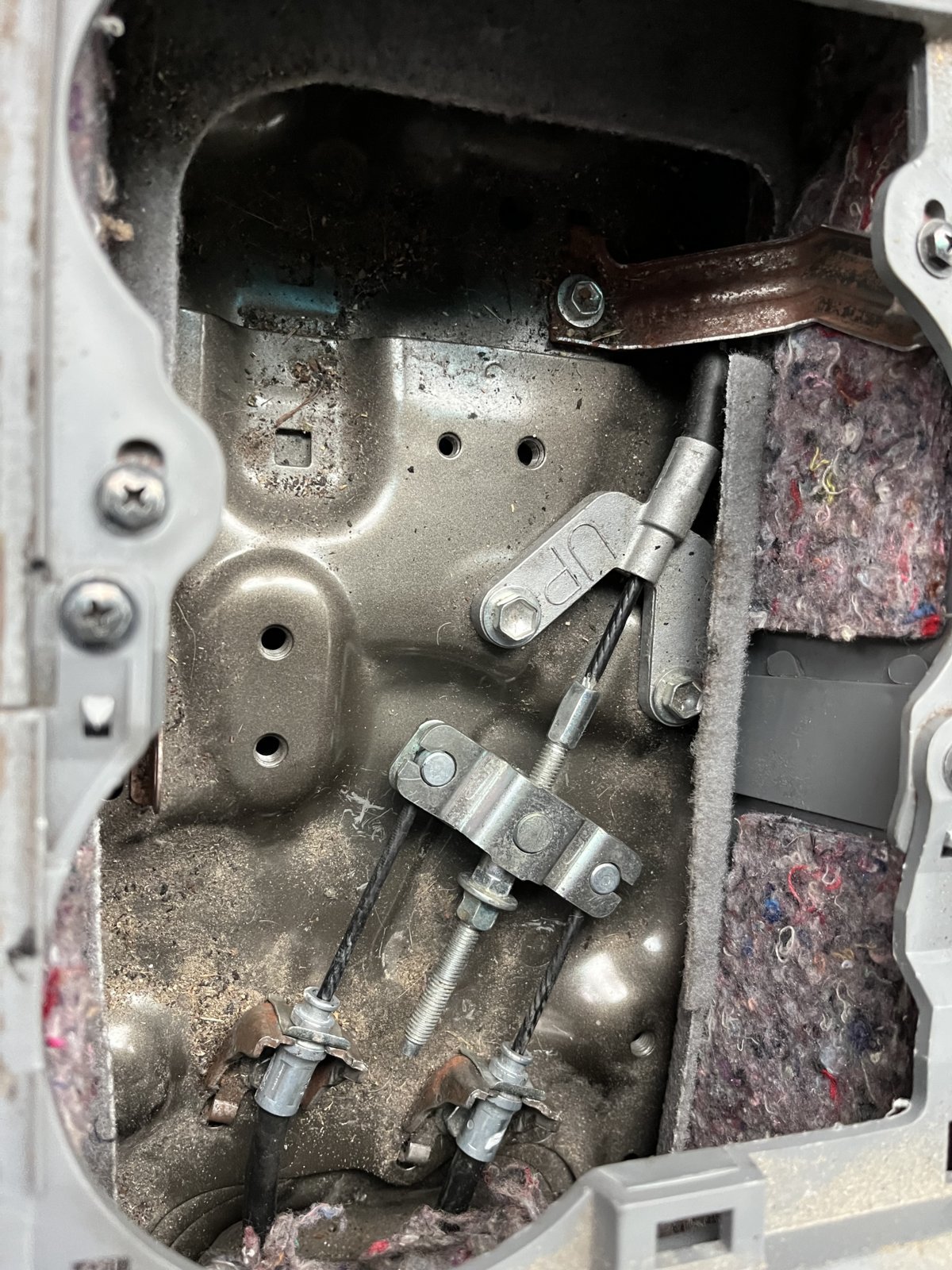

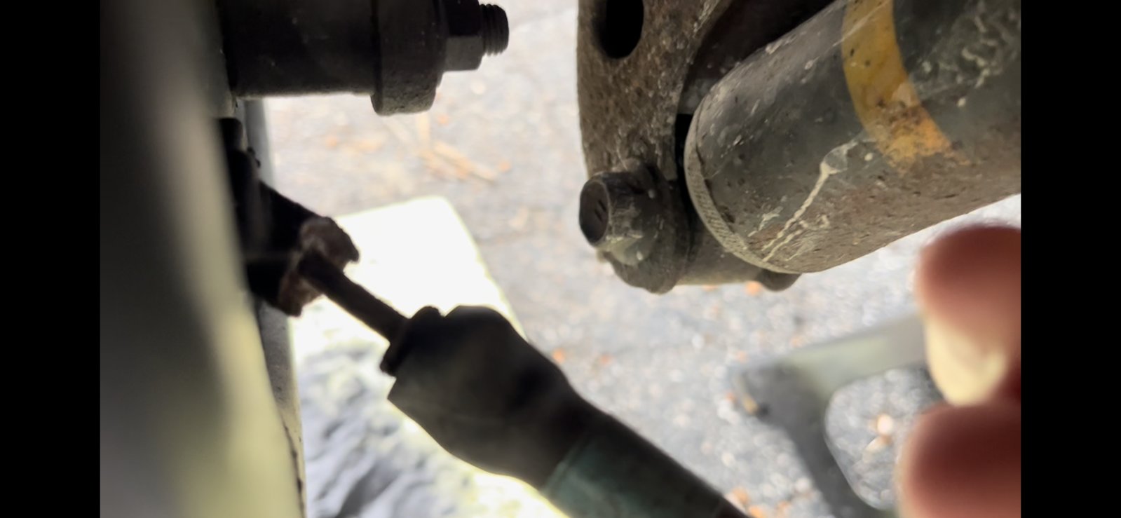

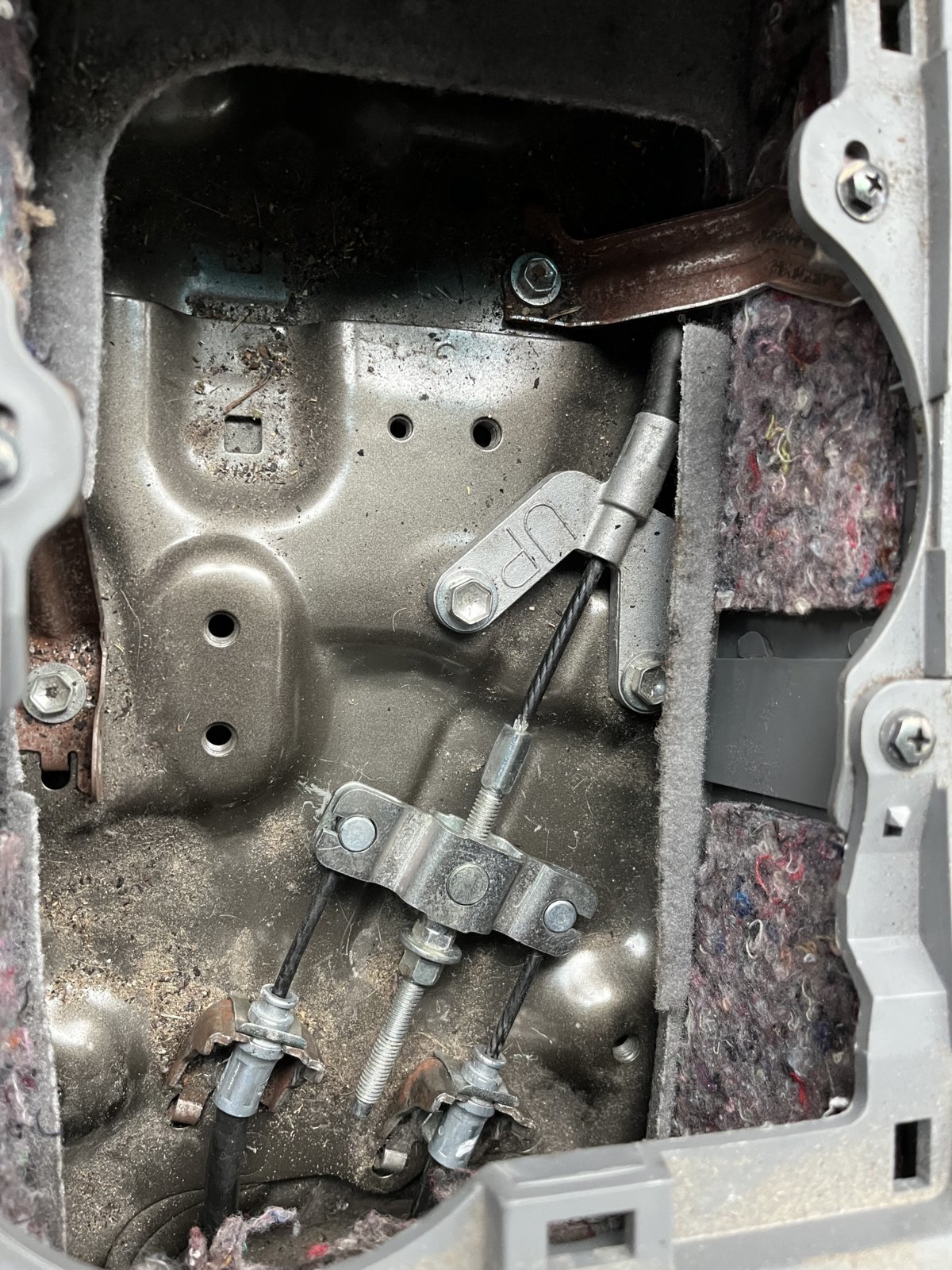

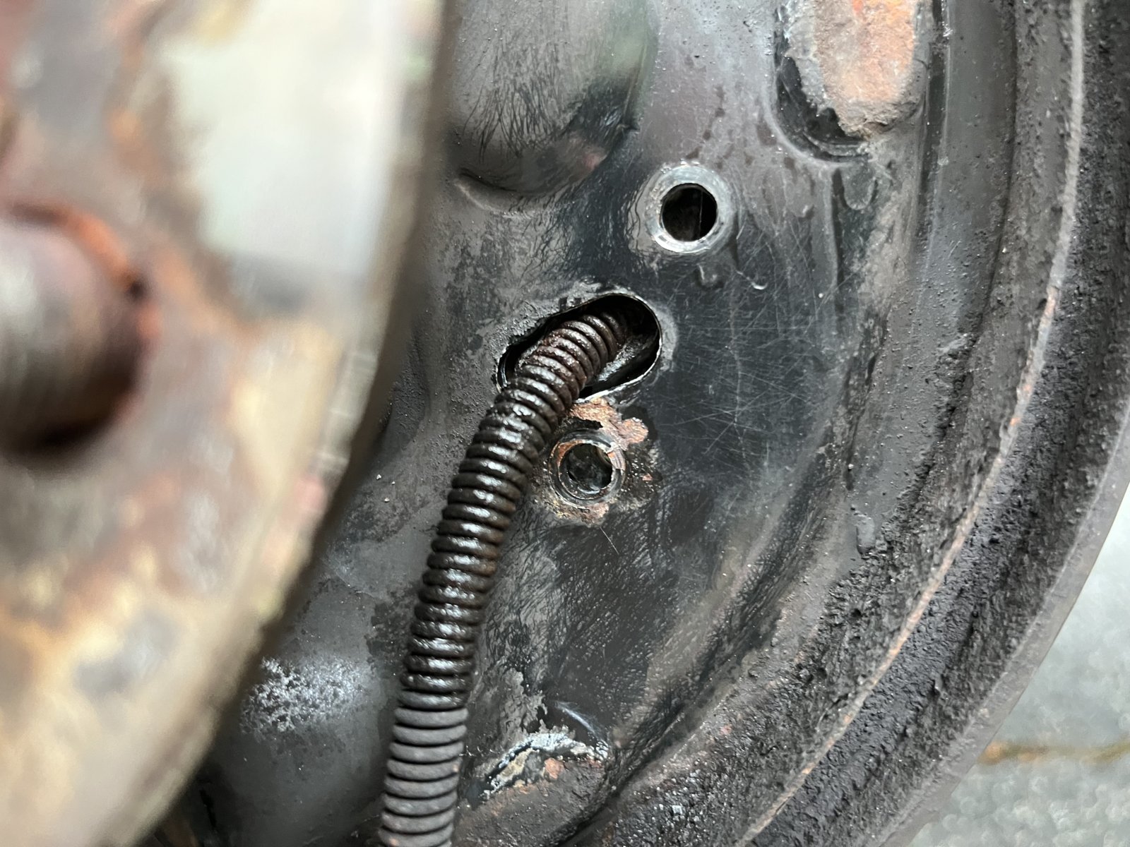

    I finally replaced my parking brake cable… It took me twice as long to do one side than the other because by the second side, I knew what I was doing… I did have to cut the red spring on the driver side, I had an extra one from the last time I did the drum brakes. I also was not able to attach the cable to the tight spot on top of the frame on the driver side because the bracket crumbled… I improvised a zip tie.
    The bolts, of course, crumbled. Luckily, I bought replacements and was glad to find that they are only threaded into the bracket and not the plate so when they snap, you can just punch them out.
    I had to get my Dremel out and cut the spring, because it would not remove. It was impossible. It had such a bent hook to it. It was not the OEM. It was an aftermarket one so maybe it's had too much of a hook on the end.
    I really didn't have to do much of an adjustment for the tensioner. I just sort of made sure everything was in the same spot.
    those things really split
    I made a video of how bad it was.
    https://www.youtube.com/watch?v=IwIMG4jfnkY

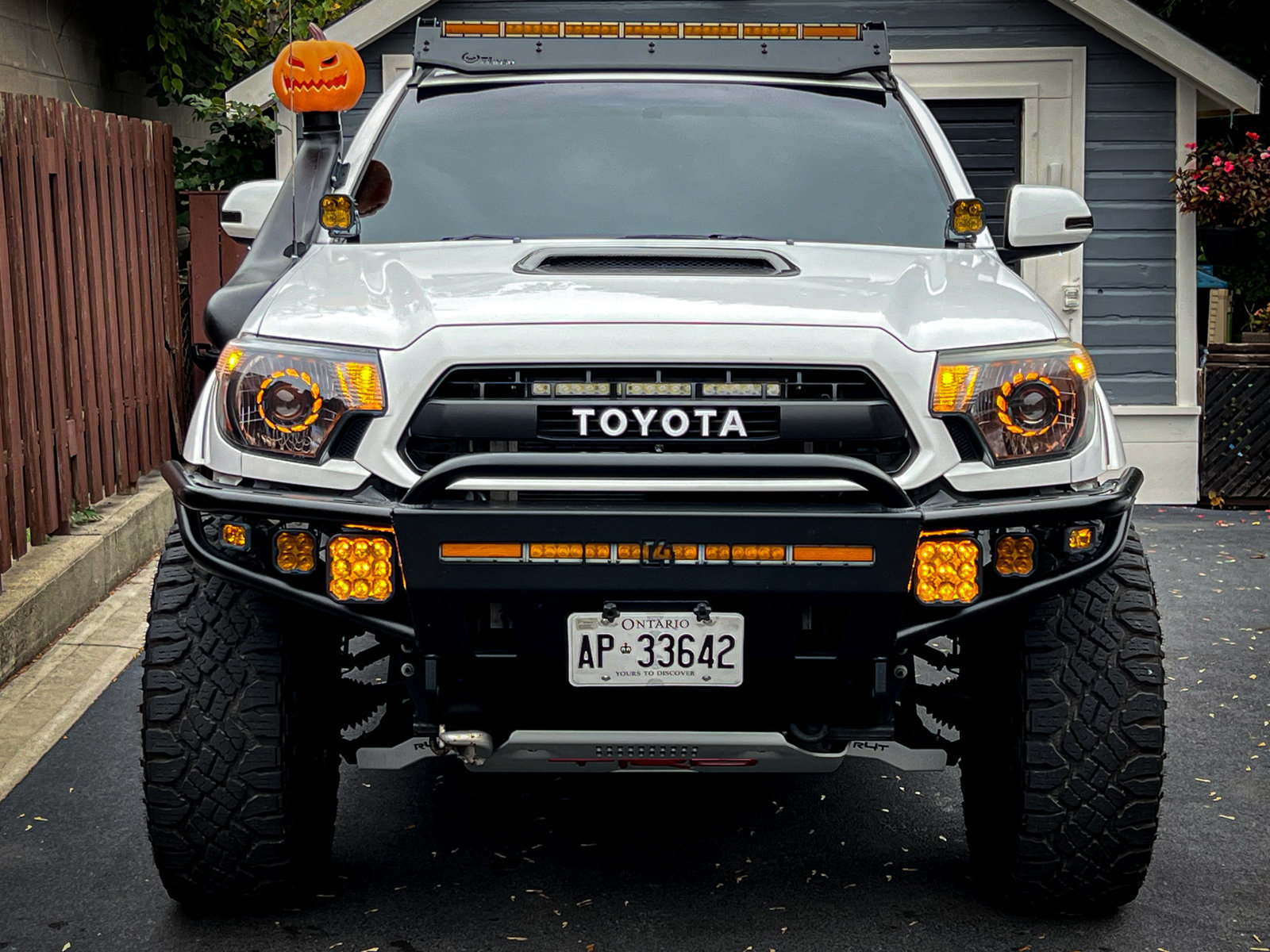

    Where did you get that amber light bar?

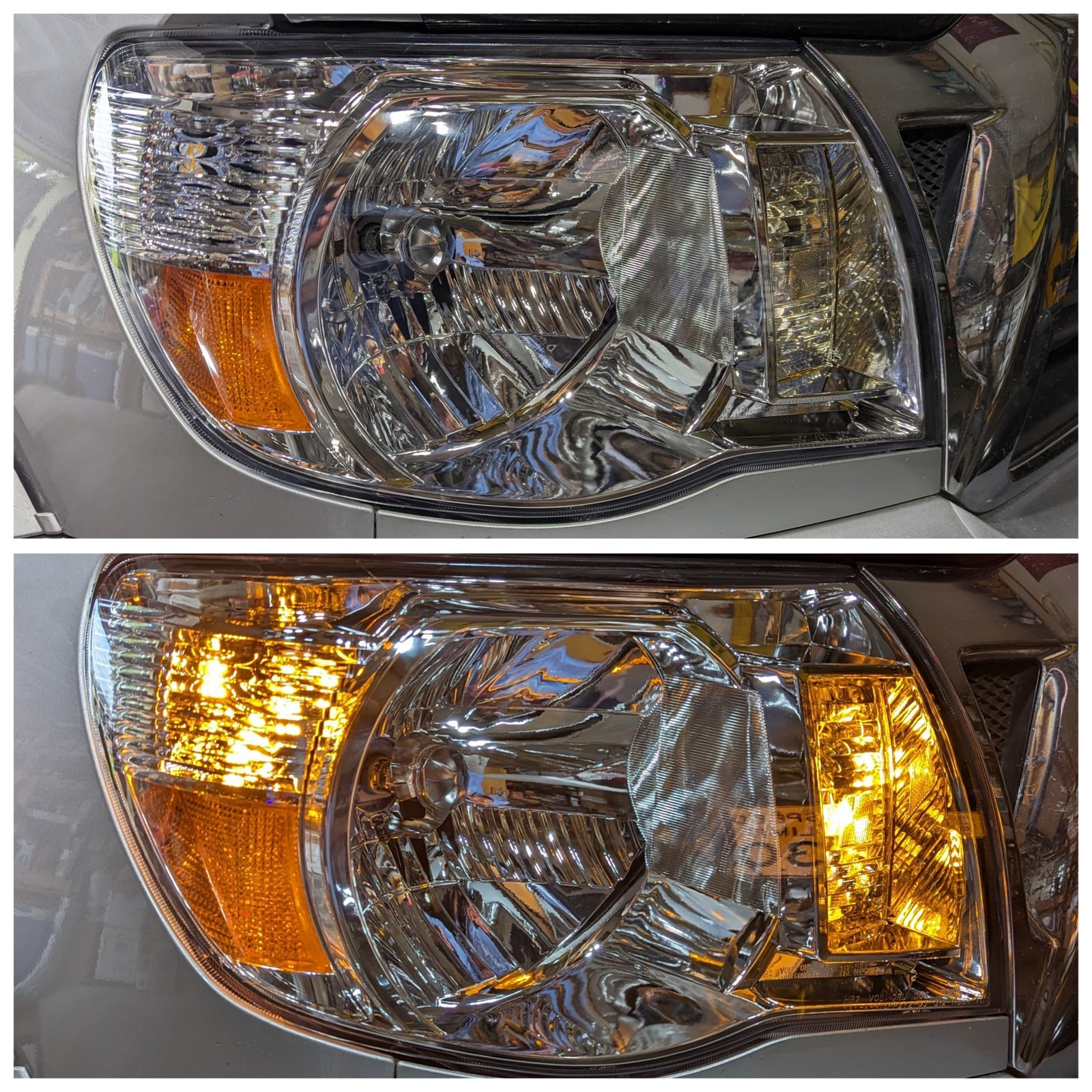

    Starting to gear up for an extended road trip back out to NM, AZ and UT in about a month. With that, on Friday I put in the headlight assemblies that I bought last January. I was pleasantly suprised when I checked to see what bulb they included for the headlight. Turned out to be the German Osram 85w bulbs. Of course I left them in. I did stick with my marker and turn signal bulbs as I changed them to LED when I did the side marker / turn signal / DRL mod a month ago. The new headlights definitely spruced up the front on my 07.
    Tomorrow, Monday, Oct 16th, the PS weather strips and seals for the front and access doors come in. Looking forward to that install and then the absence wind noise coming from the passenger side doors.

    Looks good. Did you remember to silicone the seams so they don't condensate inside.
  10. Oct 15, 2023 at 12:43 PM
    BlkDakDave
    BlkDakDave Well-Known Member
    Oct 20, 2012
    #89422
    1,120
    David
    CC TX
    07 AC PreRunner TRD/Off Road
    Sure did!

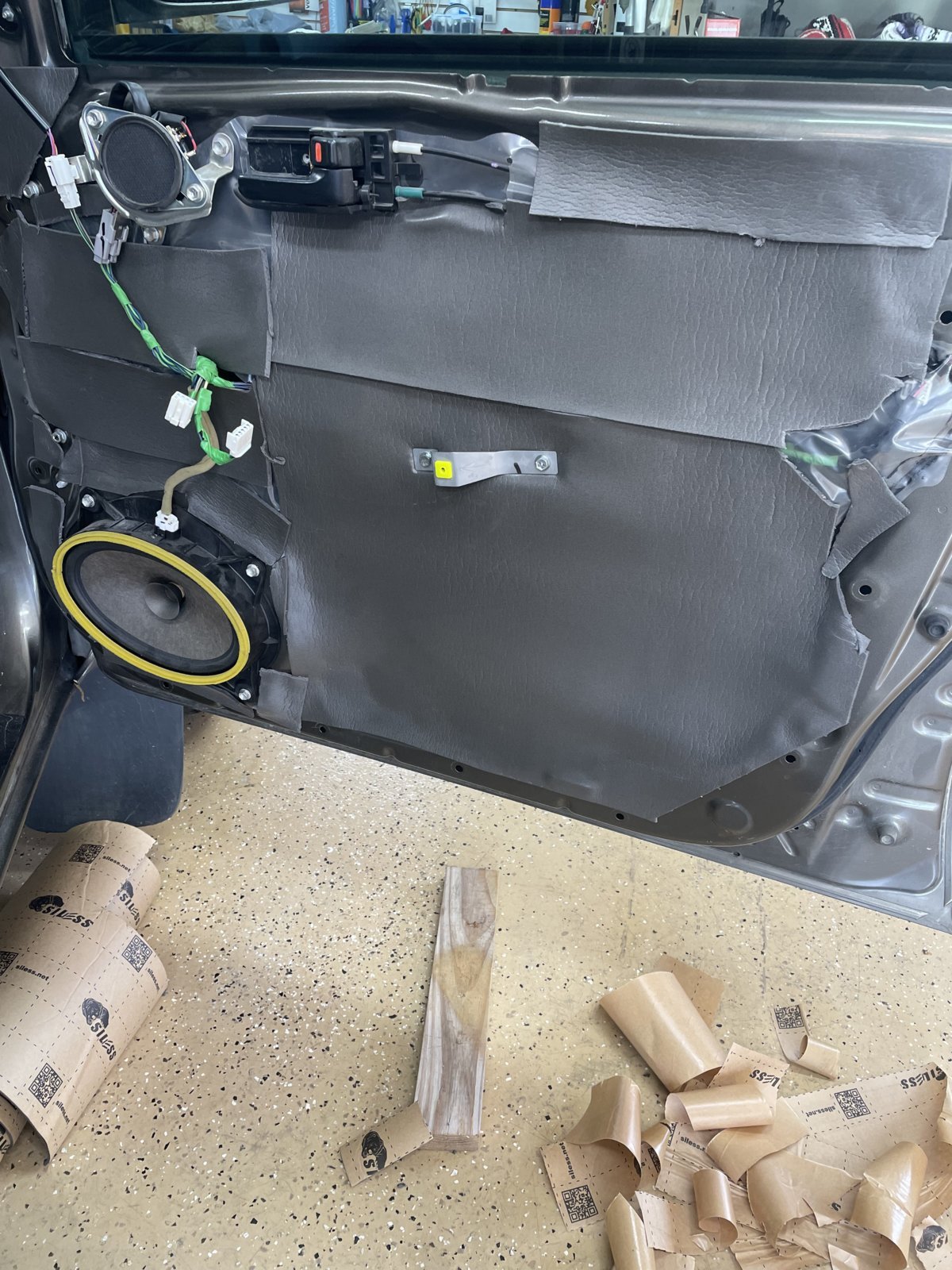

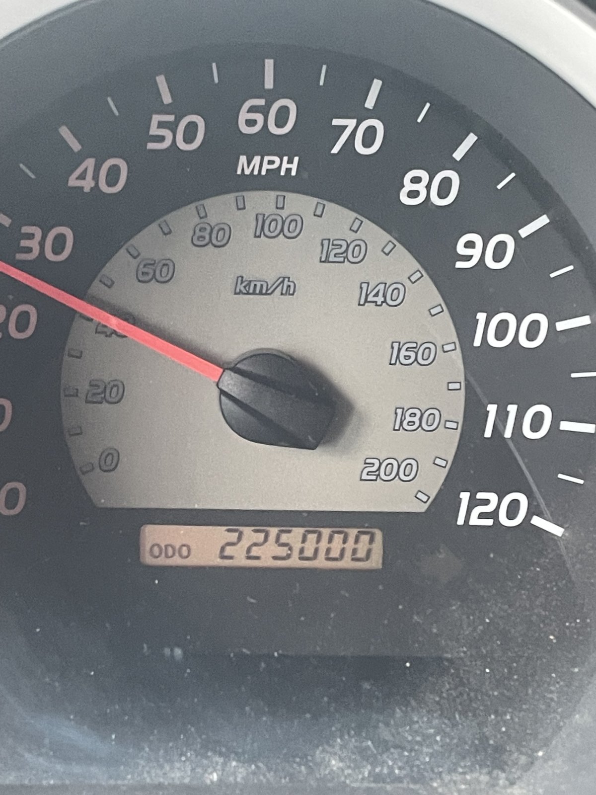

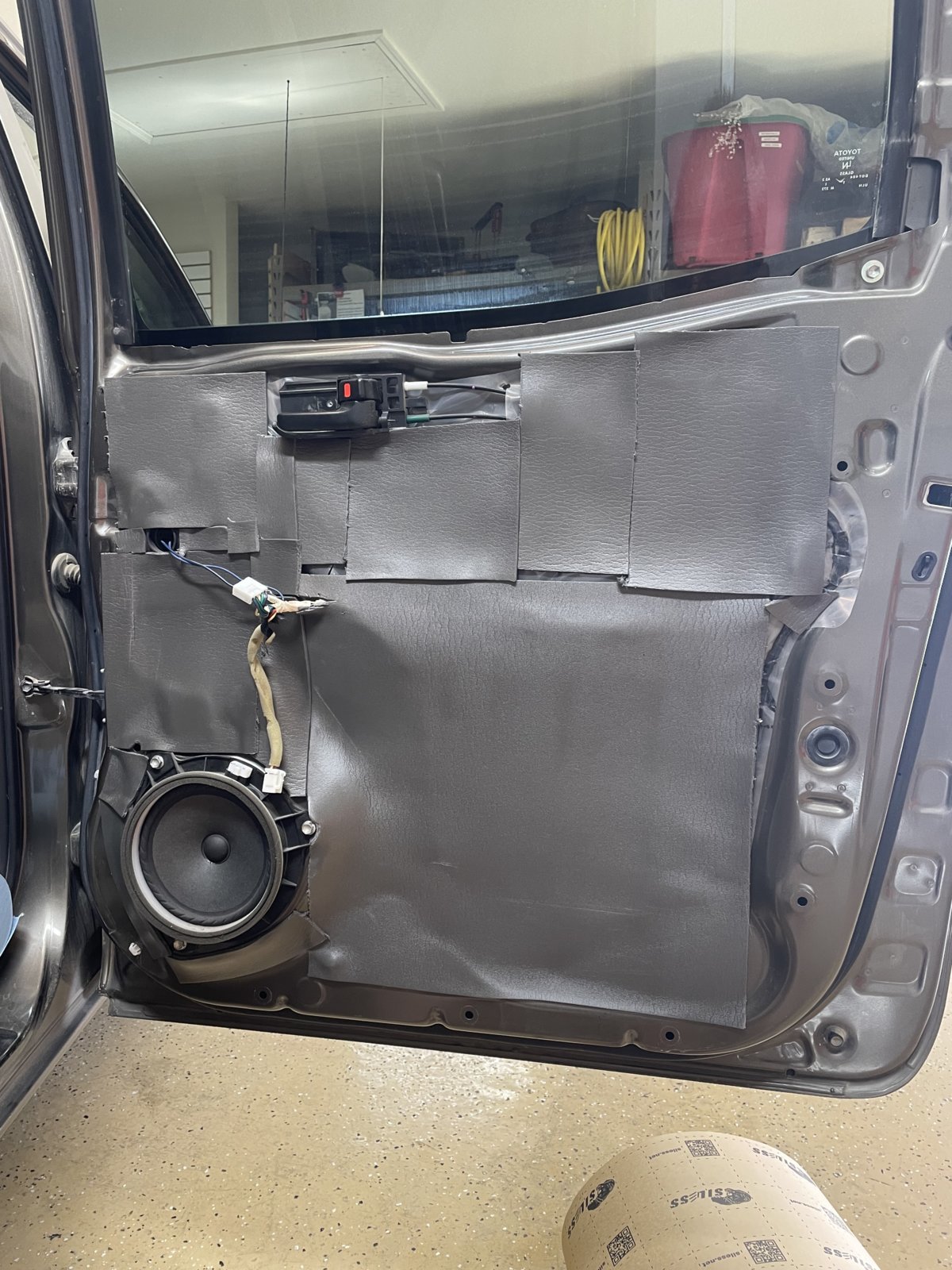

    IMG_2399.jpg IMG_2399.jpg IMG_2403.jpg IMG_2406.jpg Reached 225K on my 09. Finally sound proofed the doors. Next will be the floor and then the overhead. Make sure to have some spare clips since you will have one break per door at a minimum. Definitely make a difference. Radio sounds better also.

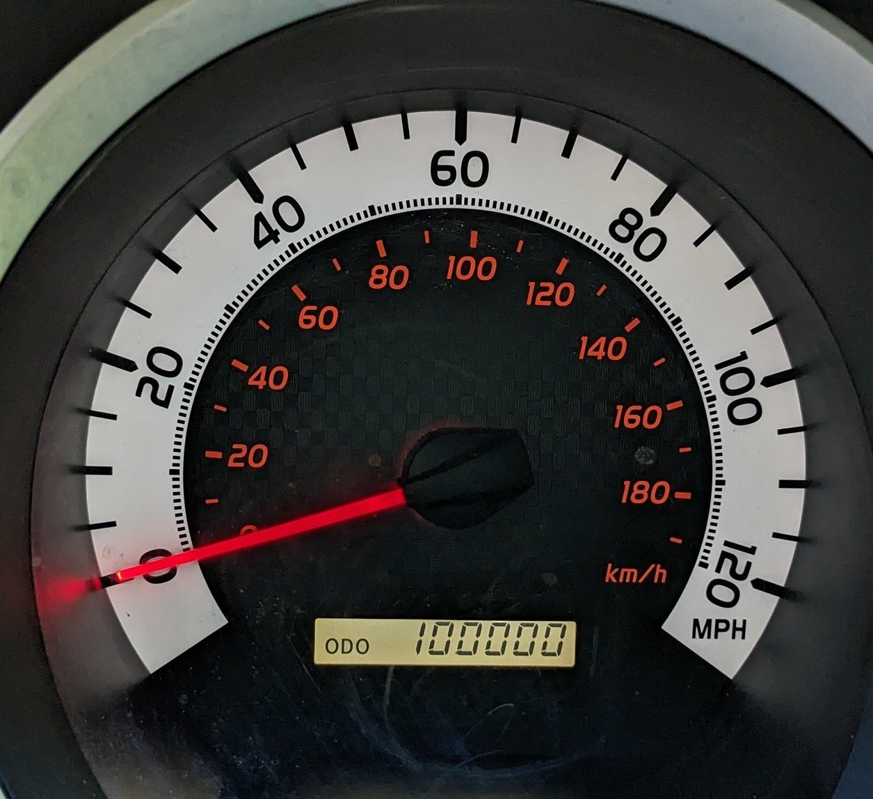

    I put the 100,000th mile on my 2014 today

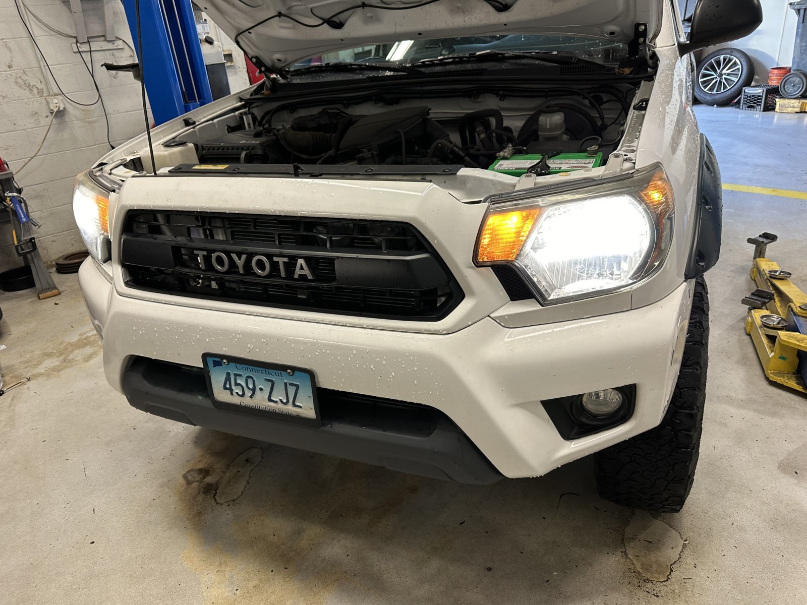

    New headlight bulbs.

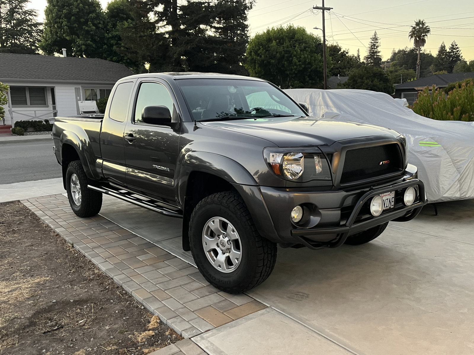

    Looks nice, I have been considering the same wheels.
