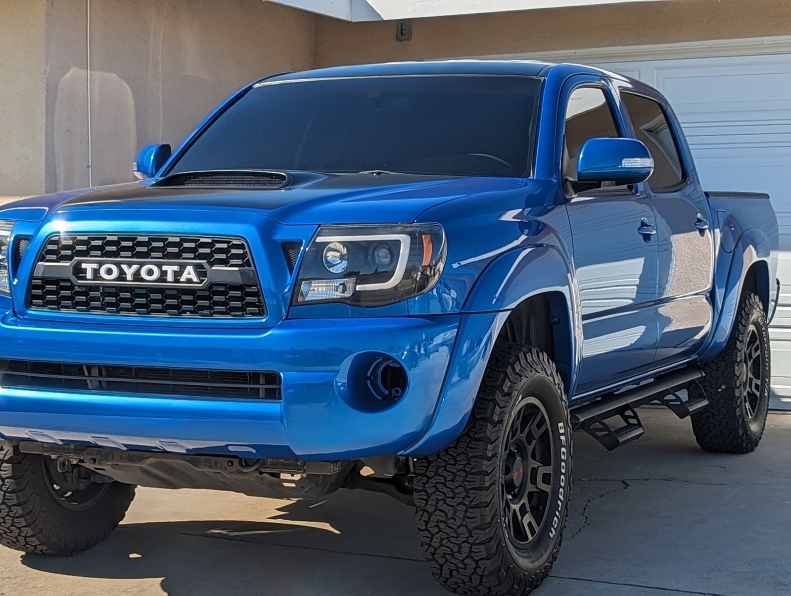

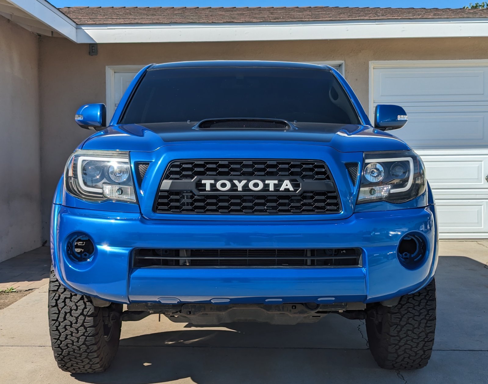

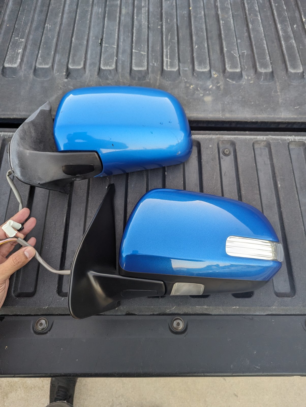

    Finally got around to swapping the mirrors. Some of the wiring I'm going to leave for a later project, as I don't have time, but at least everything is there. Still saving up for some diode dynamics fog lights and a nicer skid plate.

    So are those 4Runner mirror bodys on Tacoma mounts?

    :thumbsup:

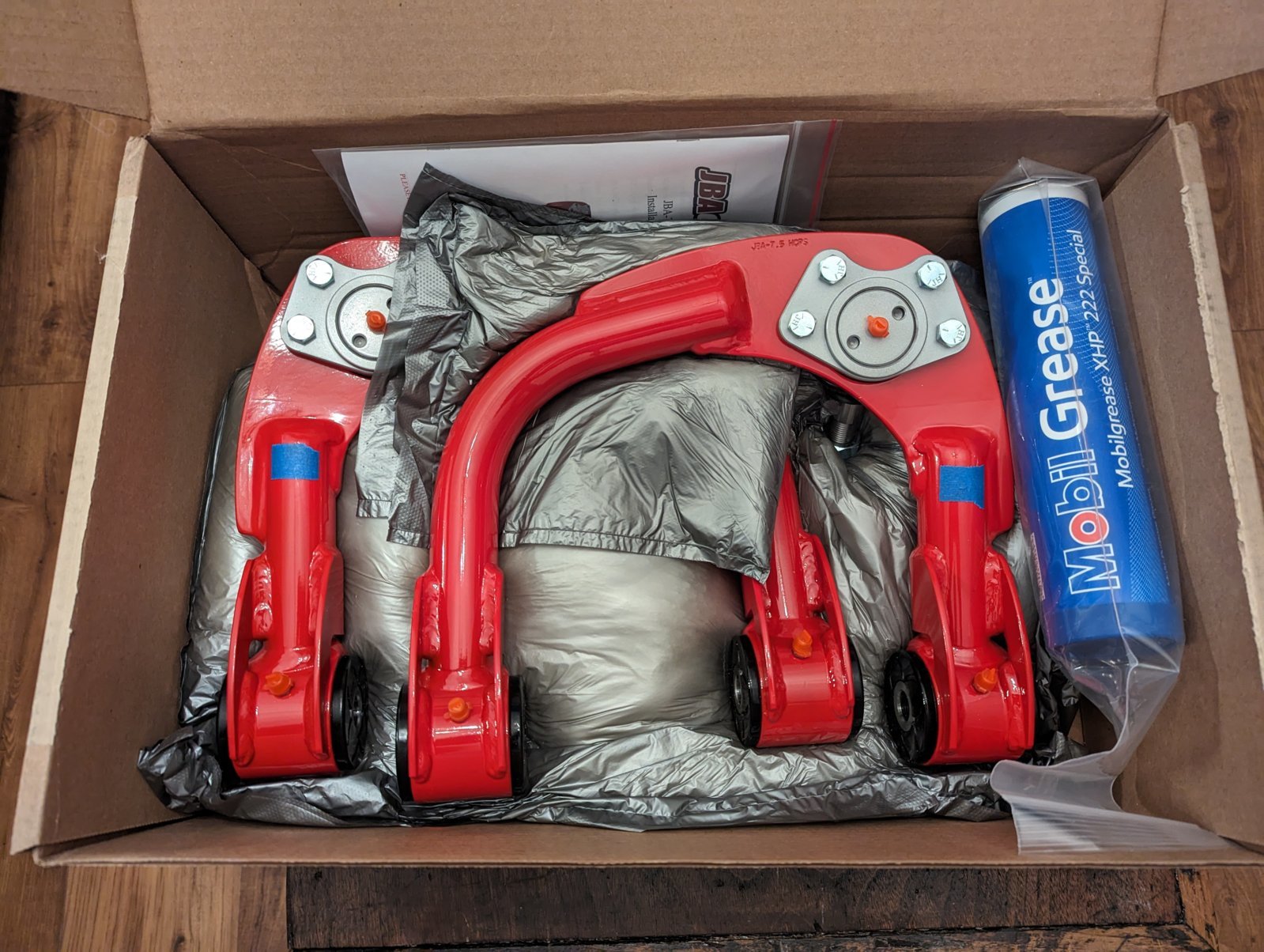

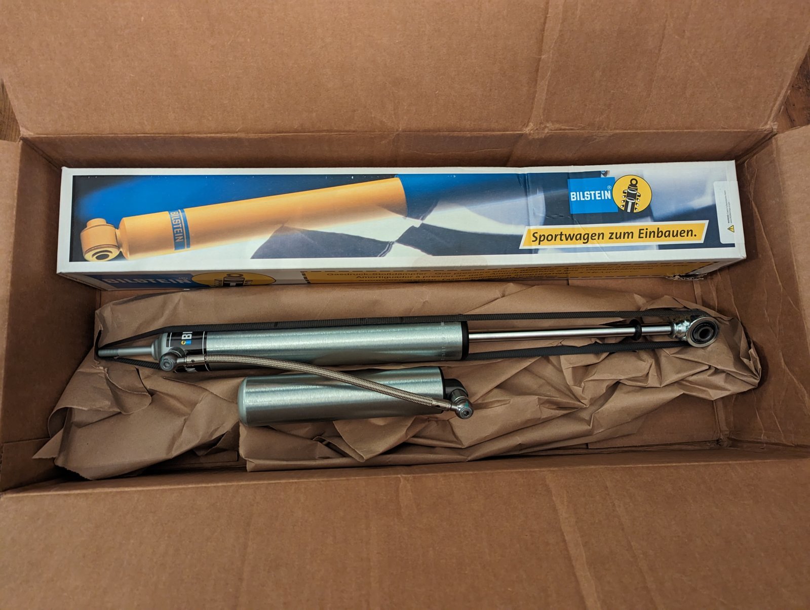

    JBA UCAs and Bilstein 5160s came today. I can't wait to get these put on soon. My first thought when I grabbed one of the UCAs out of the box was how massive they are. Second thought was the quality. These JBA HD UCAs are top notch and the customer service/emails that I received from the time of purchase to arrival was unmatched by anything that I've ever bought before. I'll update with pictures once installed.

    I'm looking at those control arms too, I can't decide if I need high caster, or standard caster though.
    What did you choose, and why?

    They're both high caster. One is just more heavy duty than the other.
    Edit: I should add there is a standard caster with standard frame build but I'm honestly not sure why someone would want that other than for aesthetics. I opted for the heavy-duty high caster because why not.

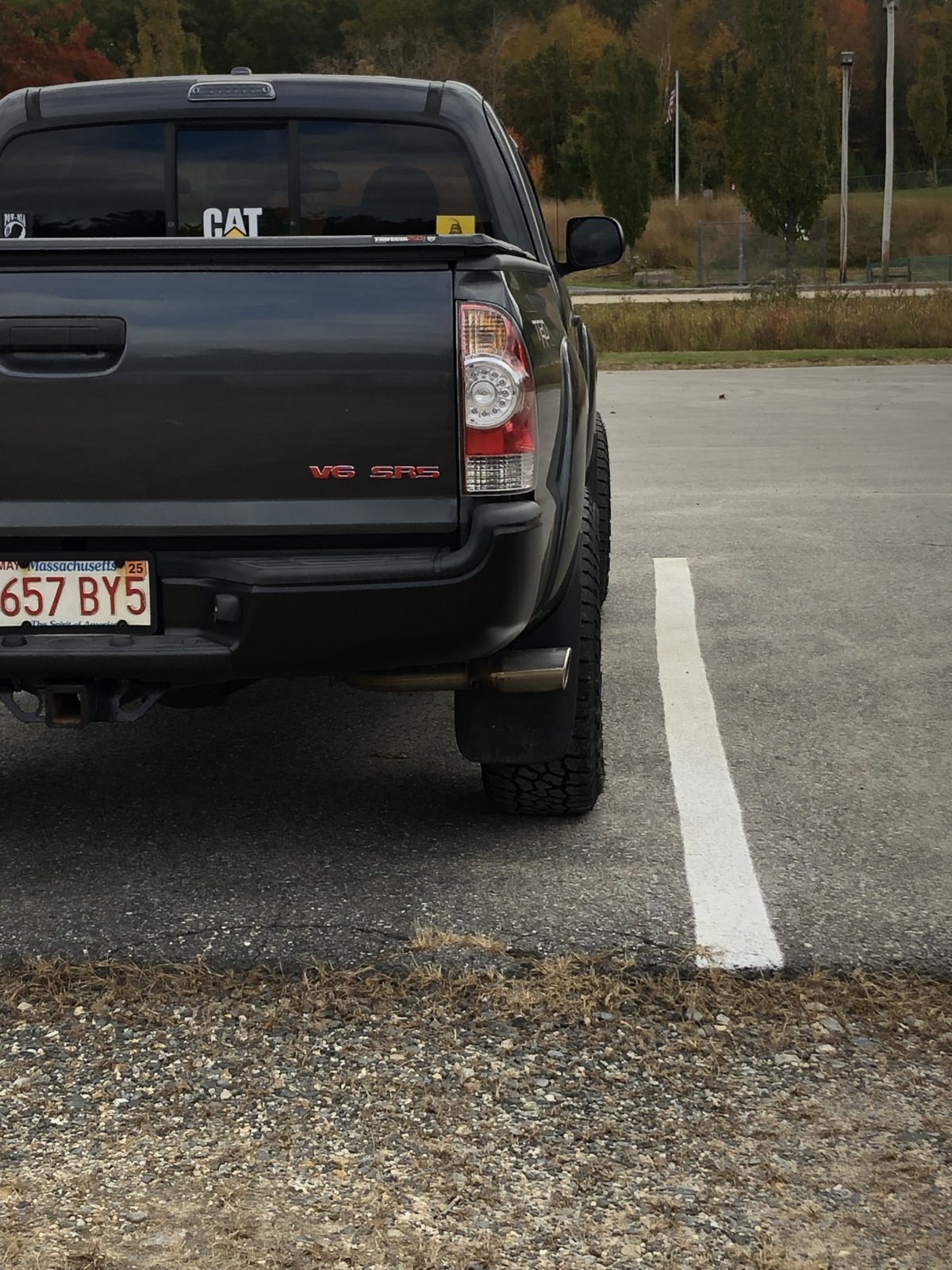

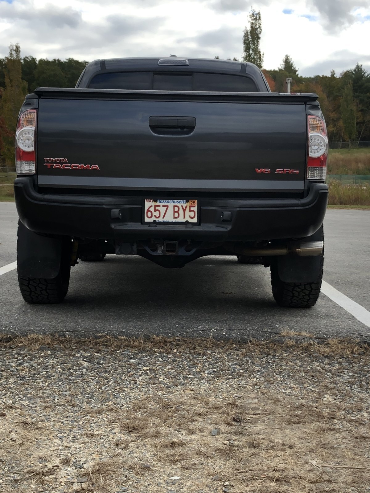

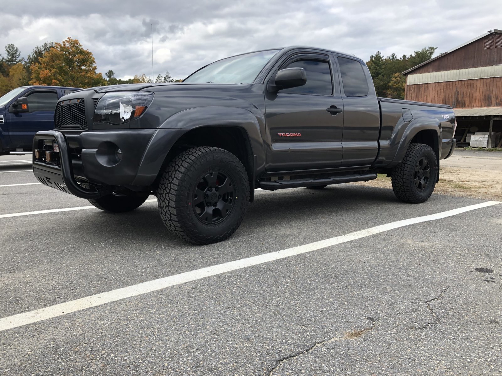

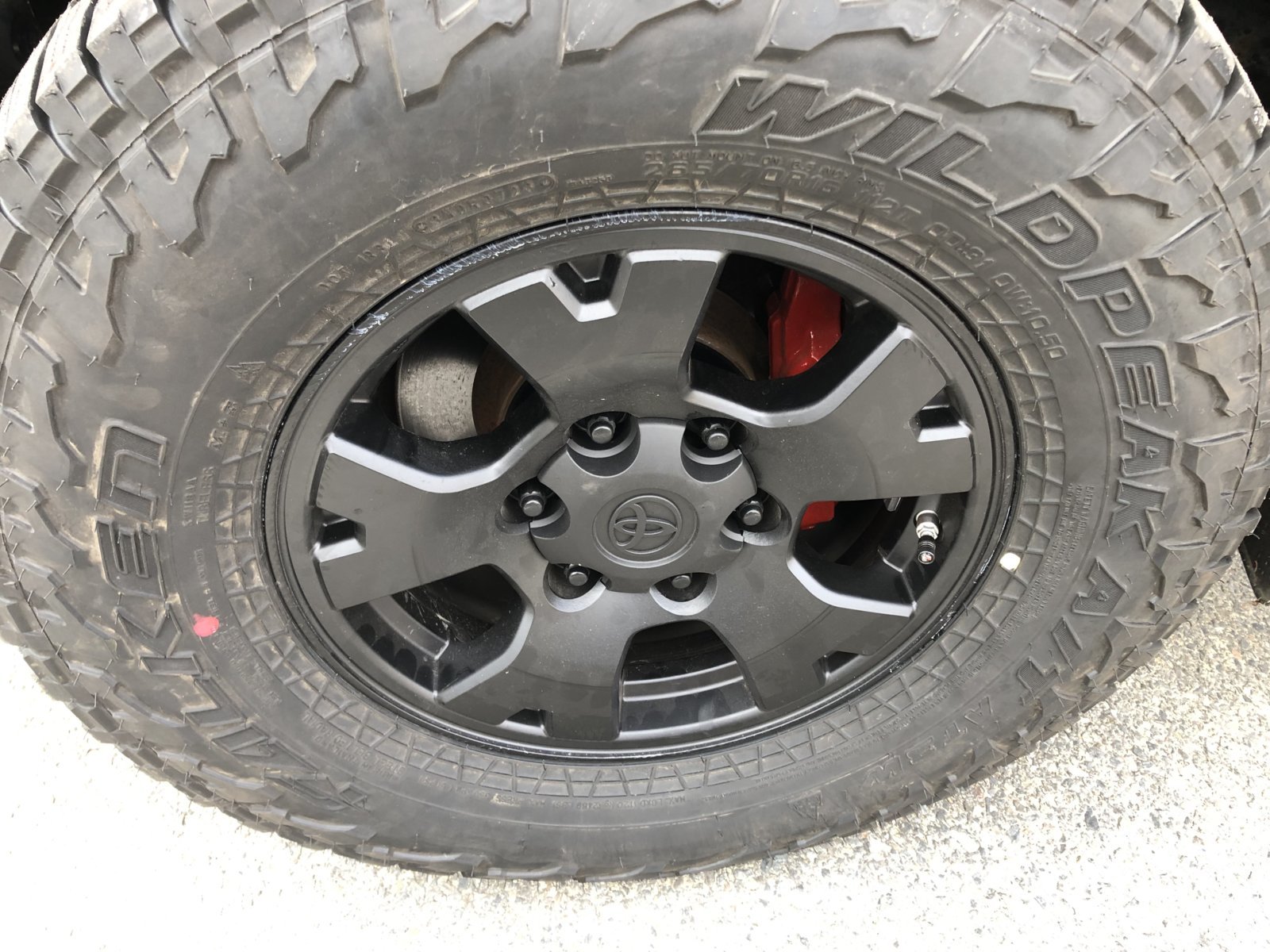

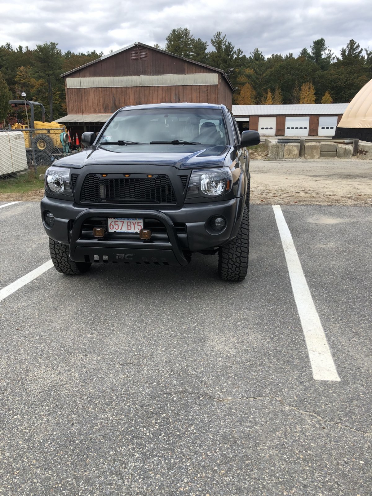

    Last two days: Spider trax 1.25” spacers, 31” Wildpeak at3w tires, new sway bar end links, sway bar drop kit, alignment and greased the drive shafts…
    The wheel spacers gave me more room between the inside wall of tires and UCAs (no rubbing on wheel well at full turn). Sway bar drop kit gave me more space between sway bar and coils. Tires are just past fenders/mud flaps and the stance looks way better with taller/wider rubber. Drives straight as an arrow and road noise from the more aggressive tread is minimal. Love this truck.
