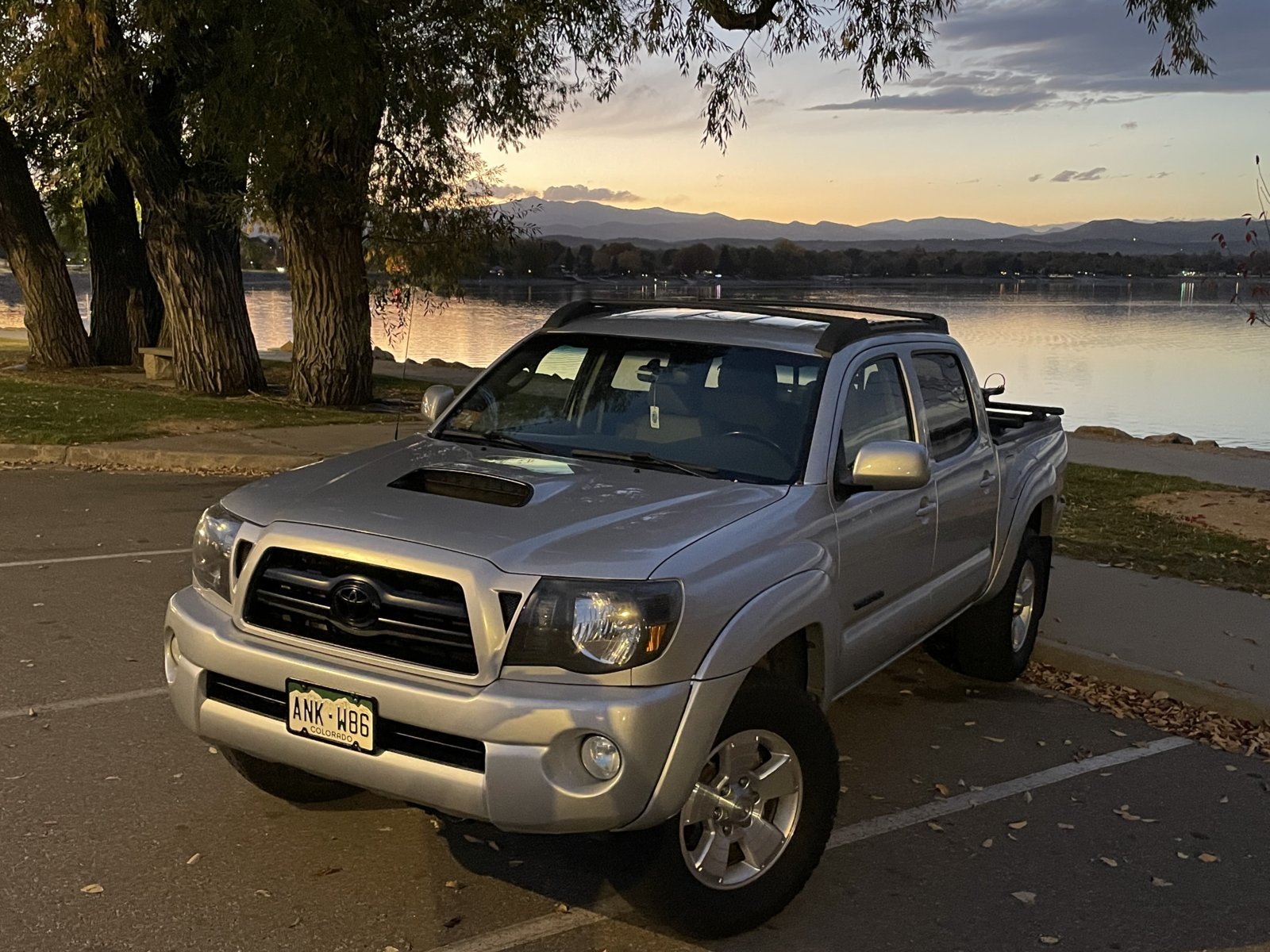

    Thanks, I just repainted the grill and front bits up front the other day to match the scoop which I did about a year ago. I pondered leaving the chrome badge or painting it black. Not sure if I made the right choice.

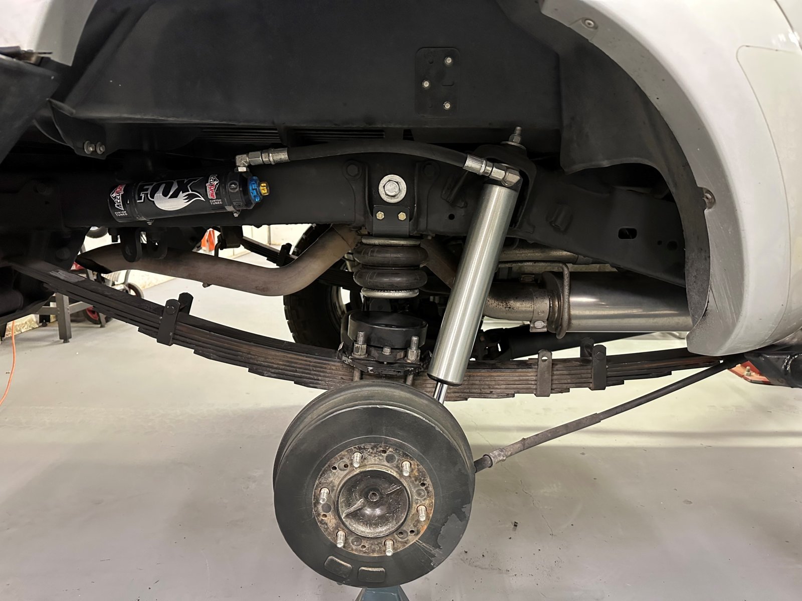

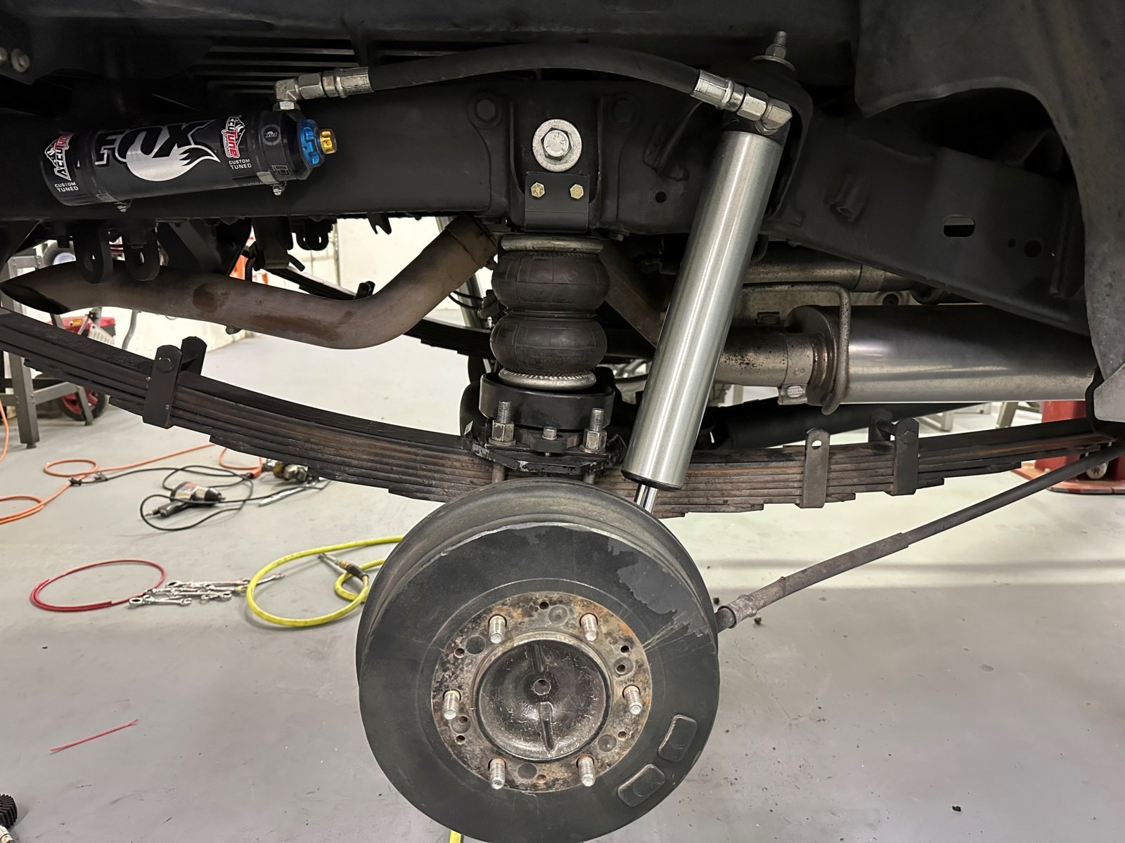

    I have been wanting to ubolt flip for a while but figured with my cradles it was a lost cause. What archive garage kit option did you pick to achieve this?
  11. Oct 24, 2023 at 10:12 AM
    dpf88101
    dpf88101 Well-Known Member
    Sep 21, 2020
    #341518
    359
    I have been running the stage four u bolt flip kit that had the durabump and a spacer.
    I took the durobump off and cut the ride rite brackets, so they sit on top of the flip kit bracket. Using the ubolt flip bracket as a template Marked and drilled the holes for my ubolts in the riderite bracket.
    I mounted the ride rite bracket on top of the ubolt flip bracket inserted the ubolts torqued all down to spec (80ft pounds). Trimmed the inboard ubolts once torqued so when the cradle is installed those nuts and bolts sit flush
    The hole to mount the cradle sits in-line perfect with the in board hole where the durobump was mounted -
    i Dremeled the cradle so it sits over the inboard ubolts and nuts then ran the bolt for the center of the cradle through the inboard hole for the durobump on the ubolt flip bracket.
    Once installed every thing lined up perfectly with the bag

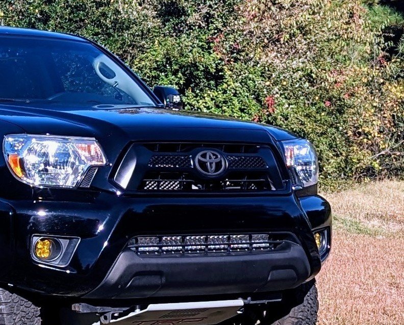

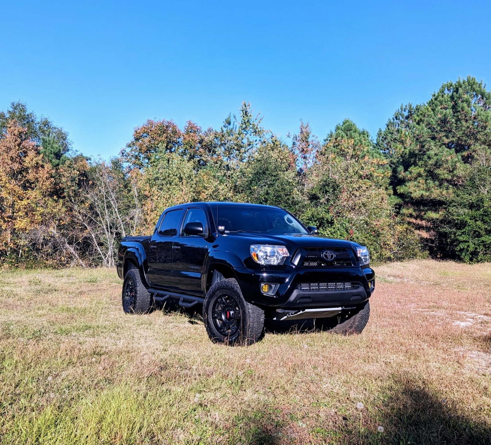

    Cleaned my MAF sensor today and also made a small cosmetic fix to my grille emblem. I plastidipped it a couple years ago and it's held up great, however it's gotten dull and didn't match the rest of the grille insert. It's pretty insignificant but it still bugged me. I decided to take it off today and spray paint it with satin black Krylon Fusion and now it matches beautifully. I might get a different grille insert in the future but this will do for now.
    Before and after pics.

    I just did the same thing two days ago. I had the scoop professionally painted a year ago. Two days ago I was visiting my buddy who is a professional painter and is the one who painted the scoop. I mentioned my grill needing it now. We ran down and bought a can of 2X in Canyon Black. He taped it up then scuffed it and sprayed it. I decided to just to shoot the chrome emblem black as well. We also did the lower valance insert and the small mesh triangles to match.
    Sorry, for a repeat on this a couple pages back.
    I’m wondering if I made the right choice painting the emblem black instead of leaving it chrome.
    I already blacked out all the chrome emblems around the truck so I figured this would match better.

    I don't think it looks bad at all. It'd definitely be an easy fix though to either replace the emblem or repaint it if you decided you didn't like it. Maybe color-matched or even an aluminum finish might look good too.

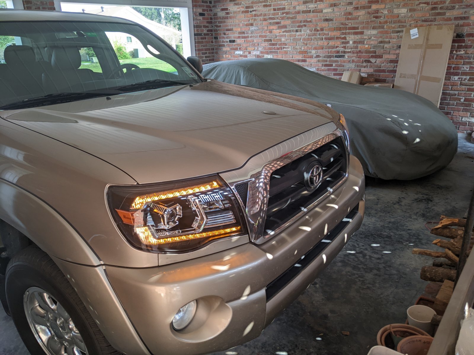

    Installed these really cool Alpha Rex Headlights on my 2007 Tacoma. The only weird thing going on is that: when I get in my truck and start it, the DRL are yellow and If I hit the unlock on my remote, then start the truck, the DRL are white. Attempted several times to contact tech support at Apha Rex but "nobody home"! Never heard of anyone being able to change DRL color except for doing a wiring change. Hope running the yellow DRL will not hurt anything, I really like them better than the white.

    Aluminum finish would look good, great idea. I’ll probably just leave it back though for awhile. Seems thats what most are doing these days.
