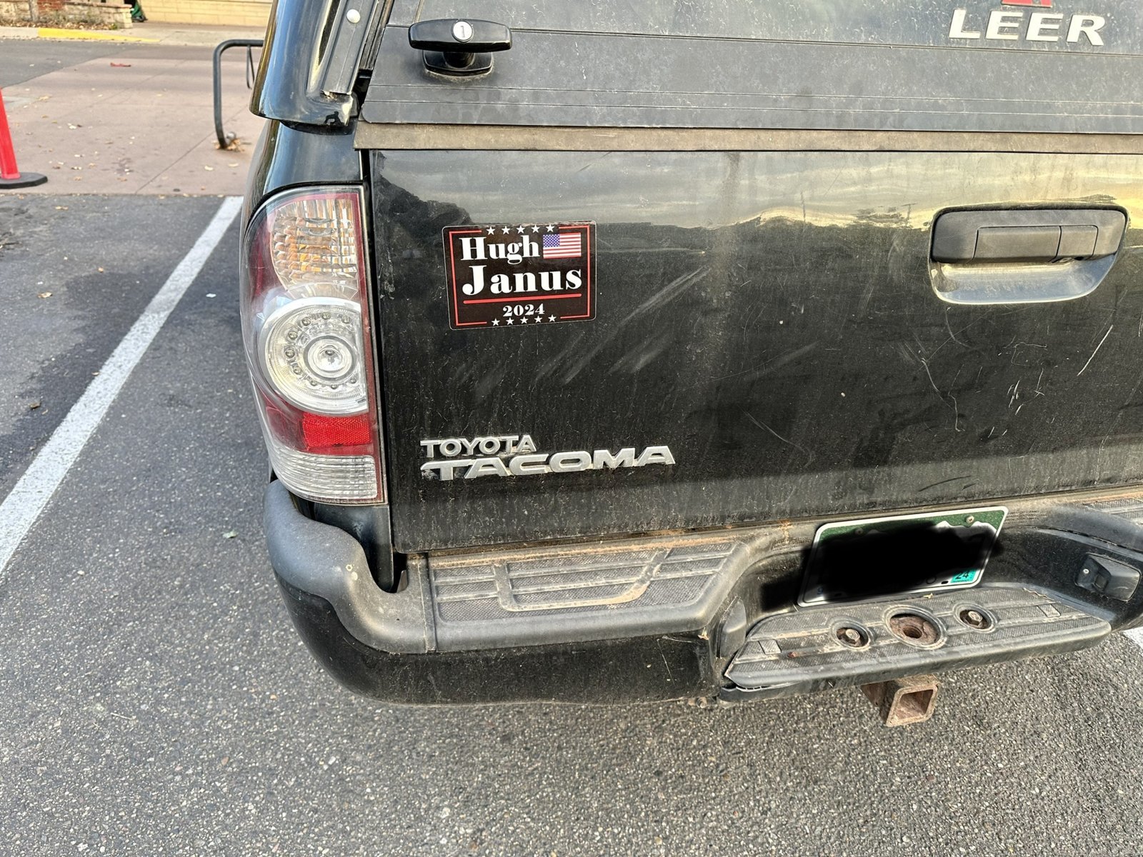

    Lmao reminds me of that scene in Hobbs and Shaw…Hugh Janus and ”Mike Okschmall”

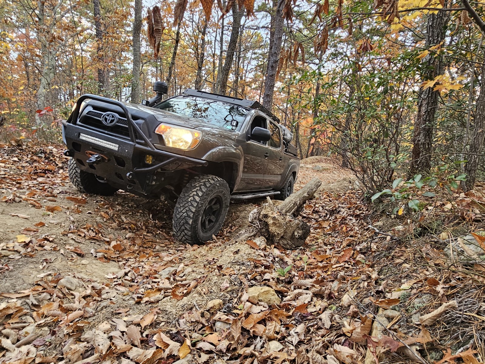

    Spent most of the day exploring Monongahela National Forest.

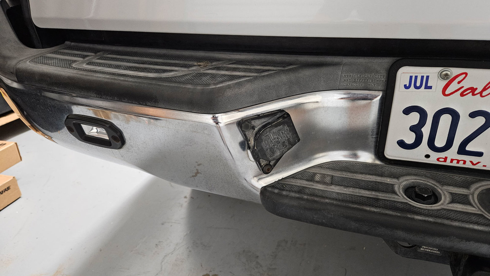

    Removed the left plate light and relocated the trailer plug.

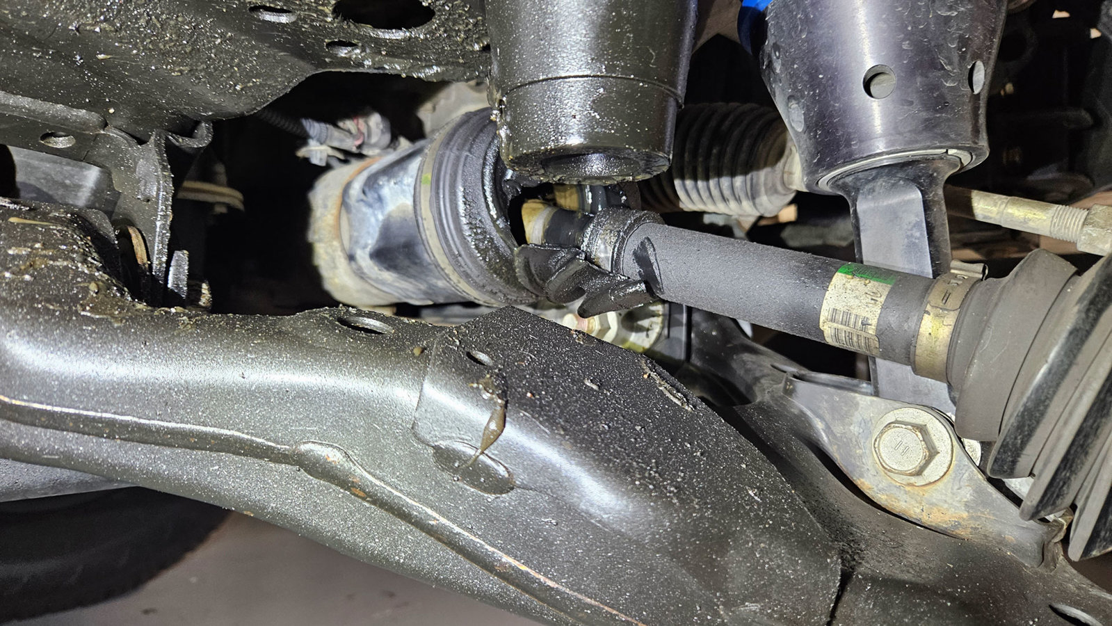

    Then dealt with this bullshit...
    Threw in a new CV I had in the garage and will reboot this one eventually.

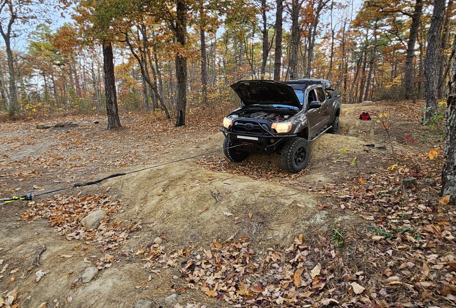

    Did the Big Levels 4x4 trail in George Washington National Forest. Got high centered in one spot and had to break out the winch.

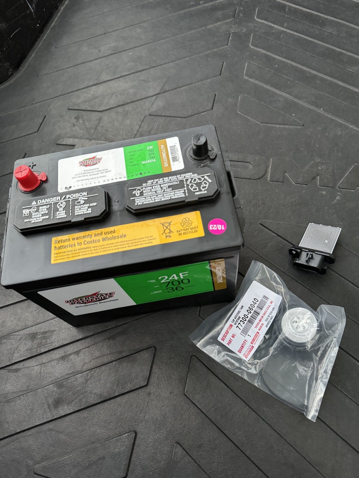

    New battery, gas cap and blower motor resistor because A/C only works on high setting.

    I’m still holding off on my inner boot fix…. I’ve read good and bad experiences with rebooting using the ‘cone’ to stretch the boot over the spider bearing - and I’m not buying the pneumatic tool which will get used maybe this one time. Also hard to justify buying/installing new cv axles because of one small tear on top of the inner boot…. For now I’ve cleaned the boot thoroughly and wrapped it with Gorilla tape. It’s held very well for two weeks so I’m hoping I can make it to spring and have my final decision on what to do. Too many horror stories involving aftermarket axles, so its going to be either the real Toyota Reboot kit (keeping the stock axles) or swap them both out for new Toyota axles which will be much more costly. Talked to a Toyota tech last week and he advised if I go the replacement route that I should do BOTH at the same time - thats like $700.- for parts and doing it myself. And thats not gonna happen before winter hits up here.

    ^You're supposed to remove the circlip and hammer the tripod bearing off the shaft. Stretching the boot that much is a no-no.
    The whole job is doable without even pulling the inner joint cup out of the diff. You don't need a fancy crimping tool either. Just get some stainless zip-ties or even large and small hose clamps.
    There's no time saved with doing both CV axles at the same time.

    Battery and blower resistor I've done. Any back story on the gas cap? Just curious.

    The old cap wasn’t getting that “click” and felt worn out. The resistor didn’t work for me, fan still only works on high.

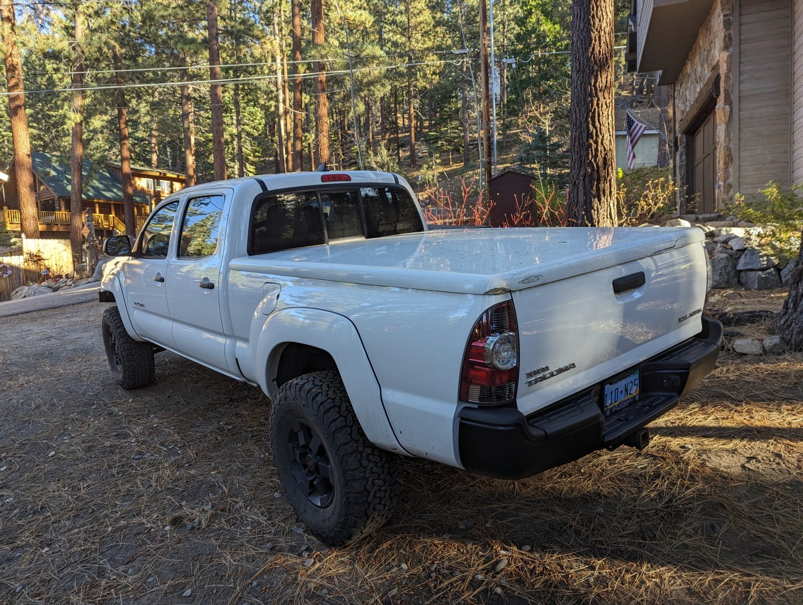

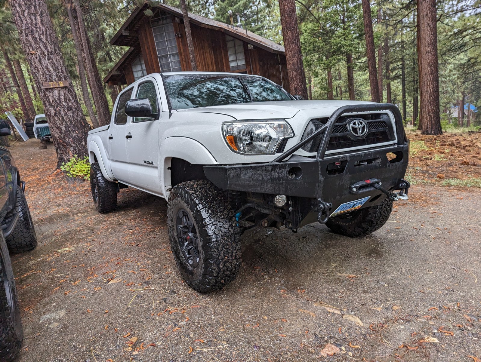

    Repainted and hammered out my dented chipped white bumper with bed liner to match the front bumper. Temp fix till I find the rear bumper I want.
    Before
    After
    Front

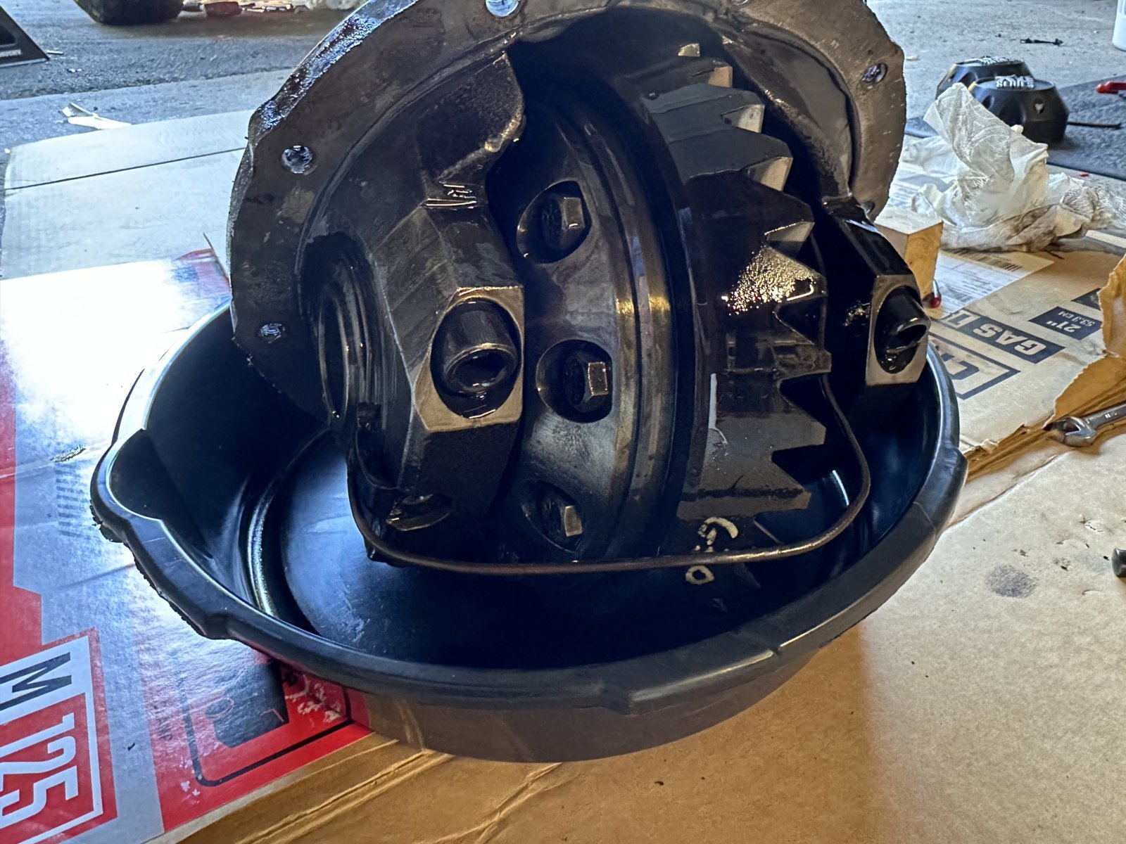

    Pulled the rear third-member to figure out why the ARB locker was leaking air. Copper line at the bulkhead was almost completely pinched shut. Either way I replaced the whole seal assembly and seals and upgraded to the newer bulkhead fitting and now it works again!
