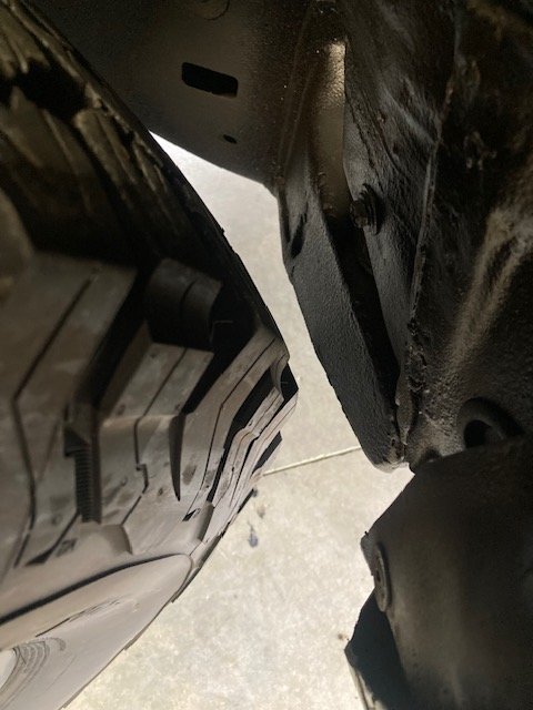

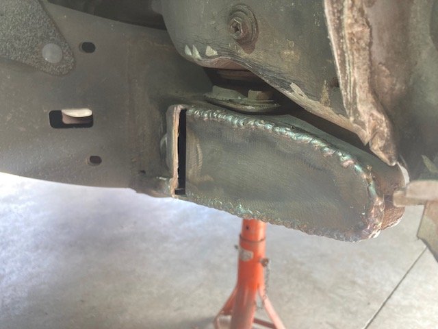

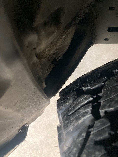

    This past weekend I did a cab mount chop and installed 3 degree axle shims. The mount gave me the clearance I was looking for, it rubbed at full lock, and the shims have significantly decreased my driveline vibes. The vibes moved from happening at 25 mph to around 15 mph and are much less noticeable; still need to replace my carrier bearing, hopefully that will eliminate them completely. Oh I did the "Ultimate Headlight Mod" a little while back as well, don't think I posted about it... it was an illuminating experience.

    Looks good, what mount did you end going with?

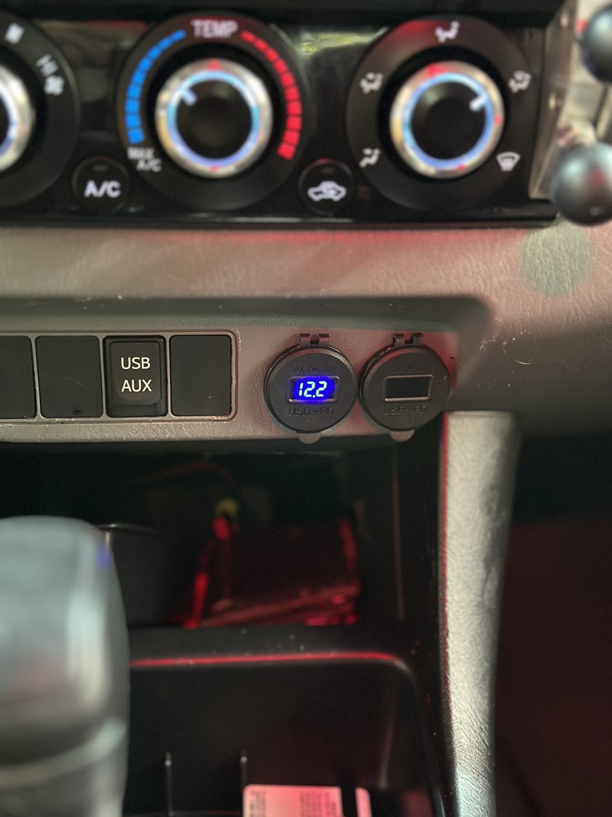

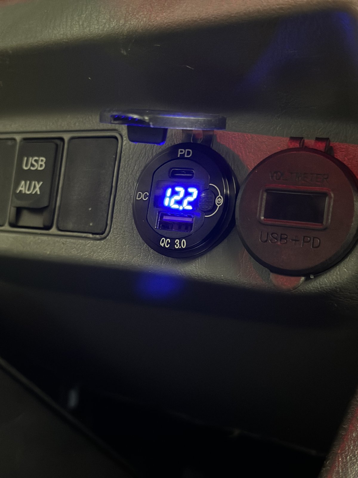

    Replaced the cigarette lighters with a voltmeter / usb charger. Will wire the second one up to a secondary battery when that comes in.

    I've thought about doing this to one of my outlets swapping one for the Dual USB with the volt meter. but haven't done that yet

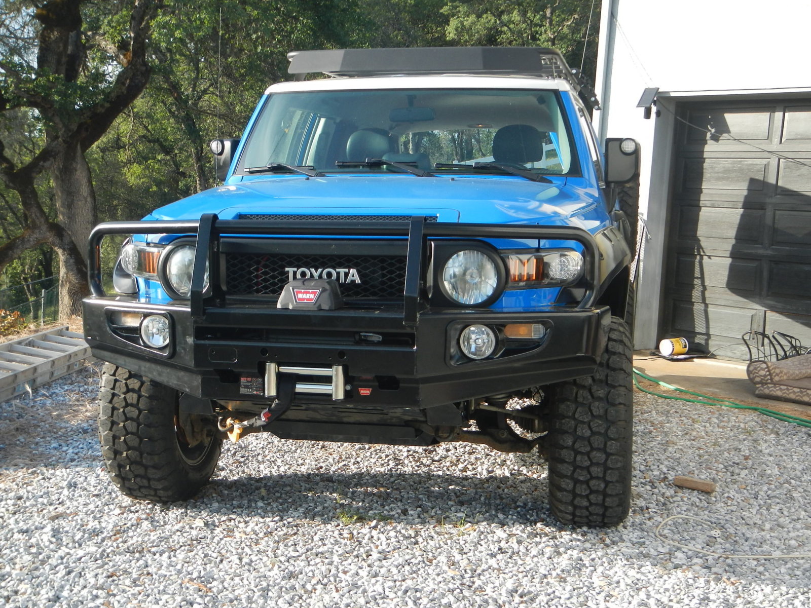

    The guys at Stellar Built in Sacramento fabricated everything to mount it up custom. I think there are some kits out there though…

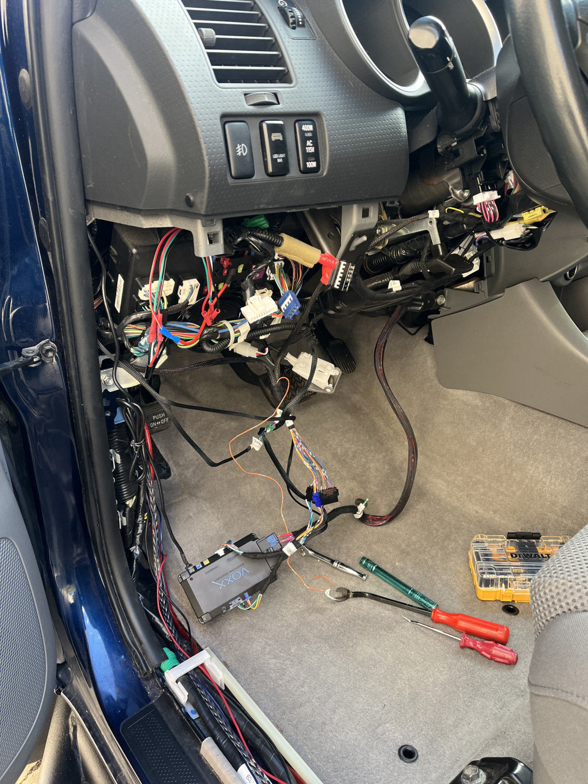

    Wired up turn signals and parking indicators while passing out Candy.

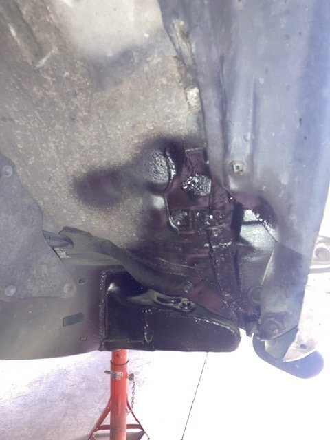

    That's not a typical sentiment!! What did you do to it?

    How many cans did you use?
