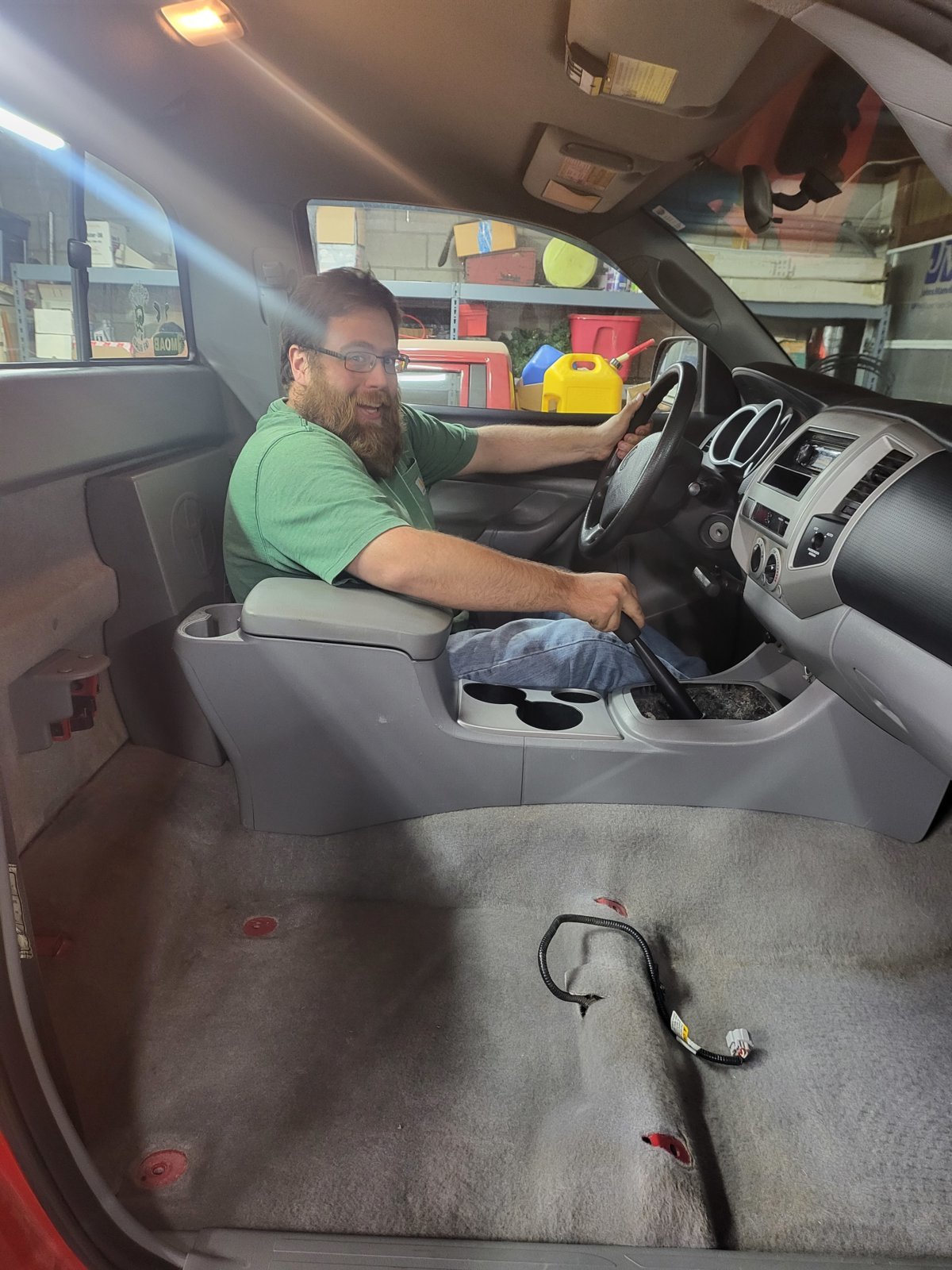

    Doing some deep cleaning

    Or your a basket ball player in search of more leg room :D

    I wish... I'm short, fat and sassy. I can pretend I'm tall though. Lol

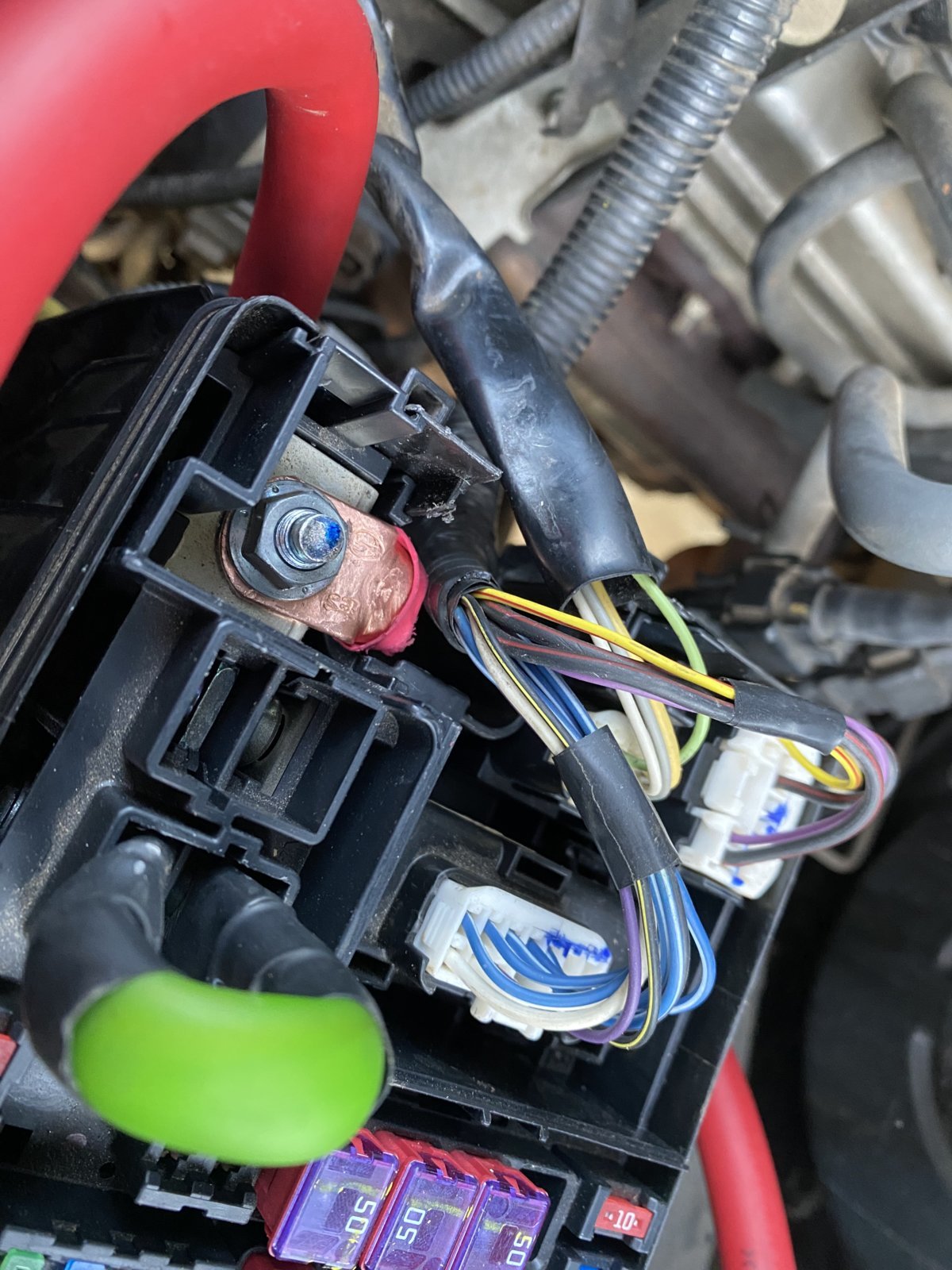

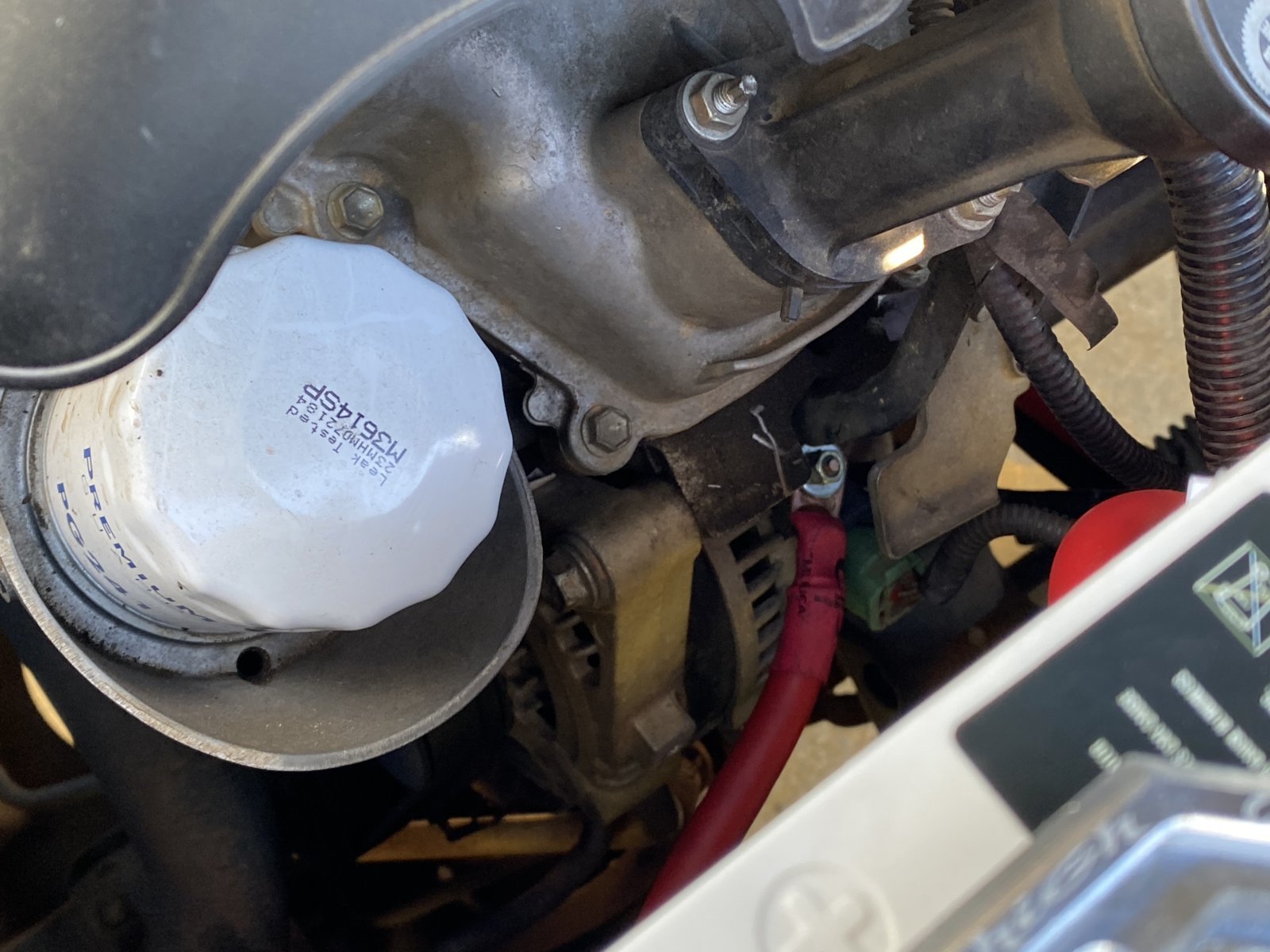

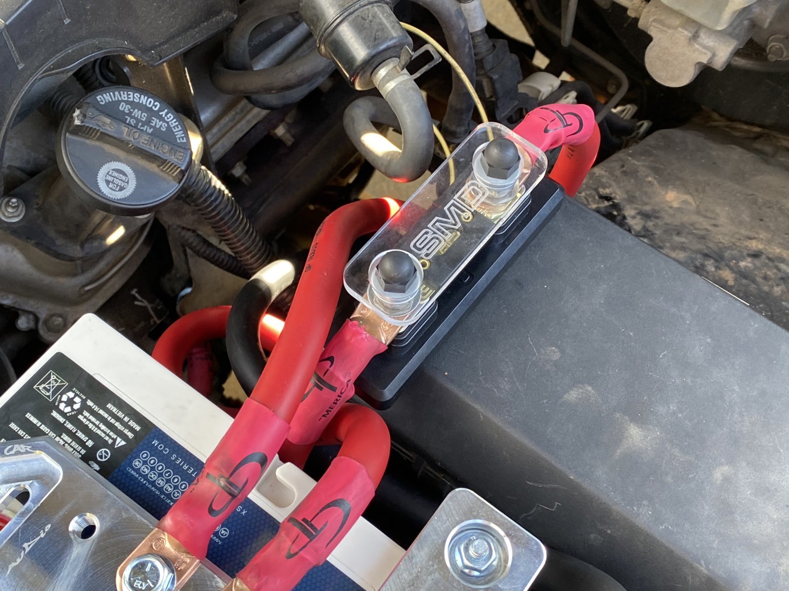

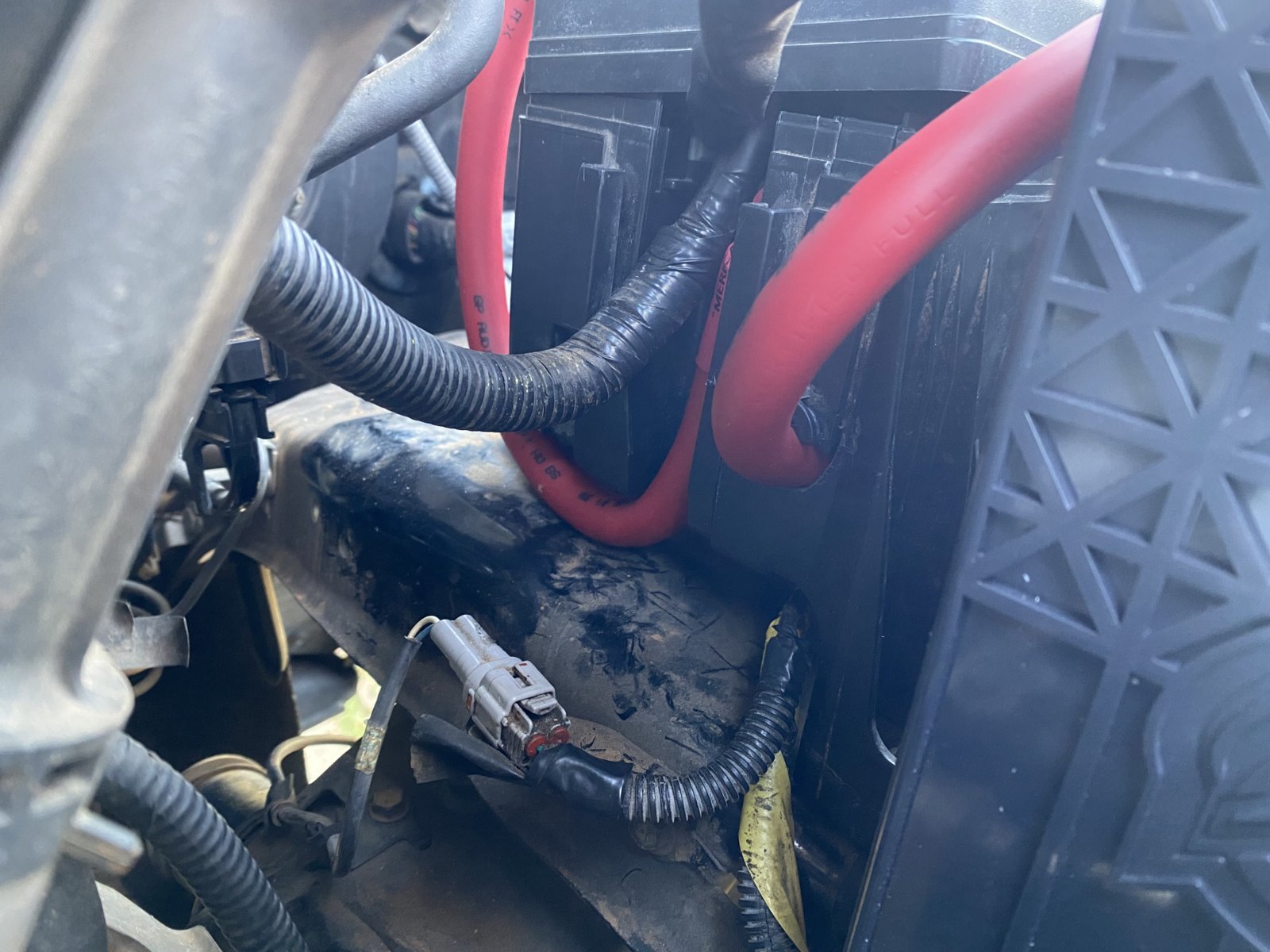

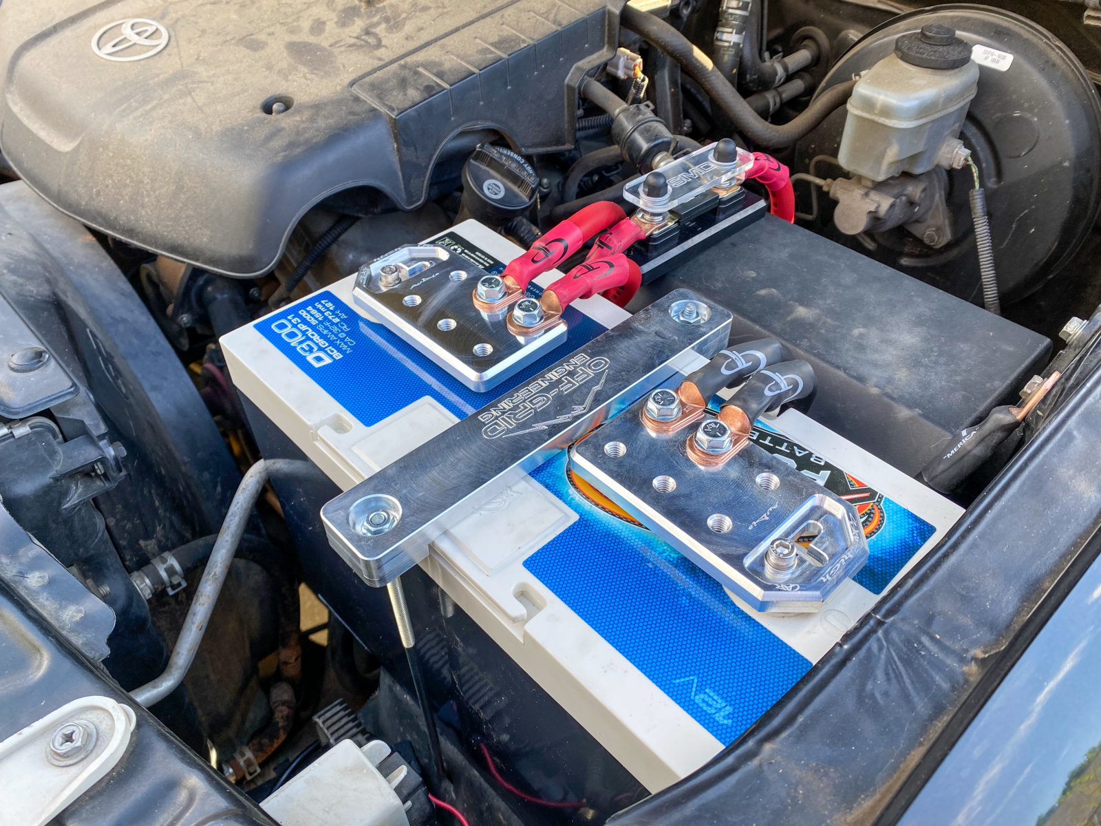

    Spent this weekend doing the Big 3 upgrade and throwing in the XS Power D3100. I’ve been putting this off for over a year now because I knew it would be hell. Spent a total of 12 hours on the install. F the fuse box clips…
    Now it’s time for the audio build. Full build thread coming soon on the A/V board.

    Have to ask... Whats the Big 3 Upgrade.??
    All i have done is install a Odyssey extreme 34R with modified original hold down and generic J clamps and a NOCO 5amp underhood battery charge/maintainer.

    cables between battery, fuse block, alternator and battery, chassis ground with 1/0 or larger cable

    ^This plus the starter wire as well. The upgrade is pretty much a preventative measure for when you are drawing a lot of power for stuff like extreme audio systems, lots of lights and equipment, or solar panel setups.
    I’m upgrading to a high output alternator (240 amps) soon so I have to do this mod or I could risk a fire from melted wires at high load. That’s also why I bypassed the stock alternator fuse with the green wire loop and mounted it on the fuse box lid.

    If you are upgrading your alt just run your power lead to the battery. It makes more sense to run a 1/0-2/0 lead to a fuse at the terminal where you can add on wires for accessory rather than running it to the factory fuse box and back out. The factory alt wire you just cut and run from its factory fuse box position to your battery terminal, and the tiny factory wire running from fuse box to battery you just cut and heat shrink as it’s no longer needed to charge the battery anymore.
    It’s the one thing about that diy thread on here that doesn’t make any sense, upgrading that small cable.

    So I read through many threads debating this. I was planning on bypassing the fuse box entirely and just fuse the run from the battery to the alt, but I saw a few cases where some guys were having issues when they did this. I wanted to maintain the factory routing just incase so I used that jumper (4awg green wire) and mounted that that fuse on the outside instead.
    I don’t think I’ll have any problems (knock on wood), but I will probably upgrade the jumper to 2awg in the future if I can find some really flexible wire.
    I have a big SMD 4 slot fuse holder for my 1/0 runs that will be going to the back of the truck and one of those will go to my relay/fuse panel that I will be installing next weekend. That will control all my accessories.
