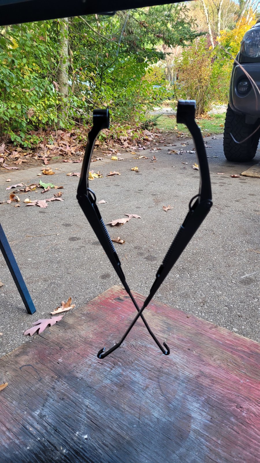

    Removed wiper arms, then sanded off corrision areas and repainted. 1st time they've been done in 14 years. There was a lot of leaf debris under the arm near the bolts that the vacuum dealt with.

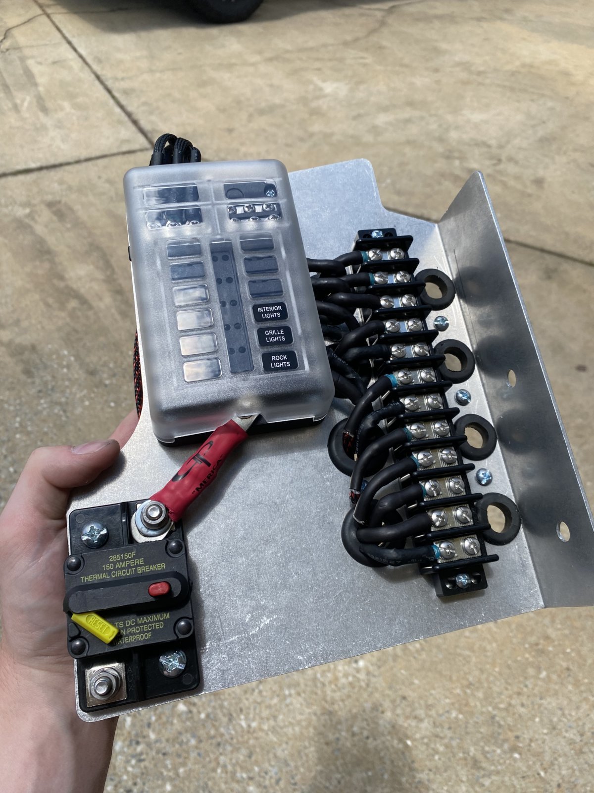

    I guess what I’m saying is if you are upgrade to a 200+ amp alt then don’t limit yourself to the 2awg that’s the largest you can fit in the box. I ran a mechman on my gx470 and routed my stuff the way I described so I didn’t need to worry about the choke point of the fuse box, the factory electronics won’t have a massive cable interjected, and the aftermarket fuse panel is easy to run straight from the battery terminal where it meets the line from the alt, which makes most sense given it’s the aftermarket stuff you want to feed more juice.

    Good point, so basically keep the input wire so the fuse box gets juice and and just scrap the output wire that goes to the alt and just do a direct lead. Everything is basically setup to do this, I will just have to cut up some more wire.
    I get my bonus in December and I’ll probably use some of that on the alt. I’ll redo the wiring then.
    Thank you for the input. I should have gone that route in the first place but live and learn.

    Bodenzord did a pretty good writeup on the connections, though his setup is more involved with the factory harness, and he relocated his alt-sense wire but I never did that part:
    http://www.bodenzord.com/archives/477
    essentially:
    Line from alternator —> fuse —> battery terminal
    Line from battery terminal —>fuse box
    The original short line that ran out the bottom of the the fuse box back to the battery in the OEM config isn’t needed anymore.
    If you wanted to leave it the way you have it, 2awg should on all accounts be fine for the upgraded alt potential amp output given it’s so short. But I like to keep the increased amps out of the OEM fuse box and fed with the fatter cable.

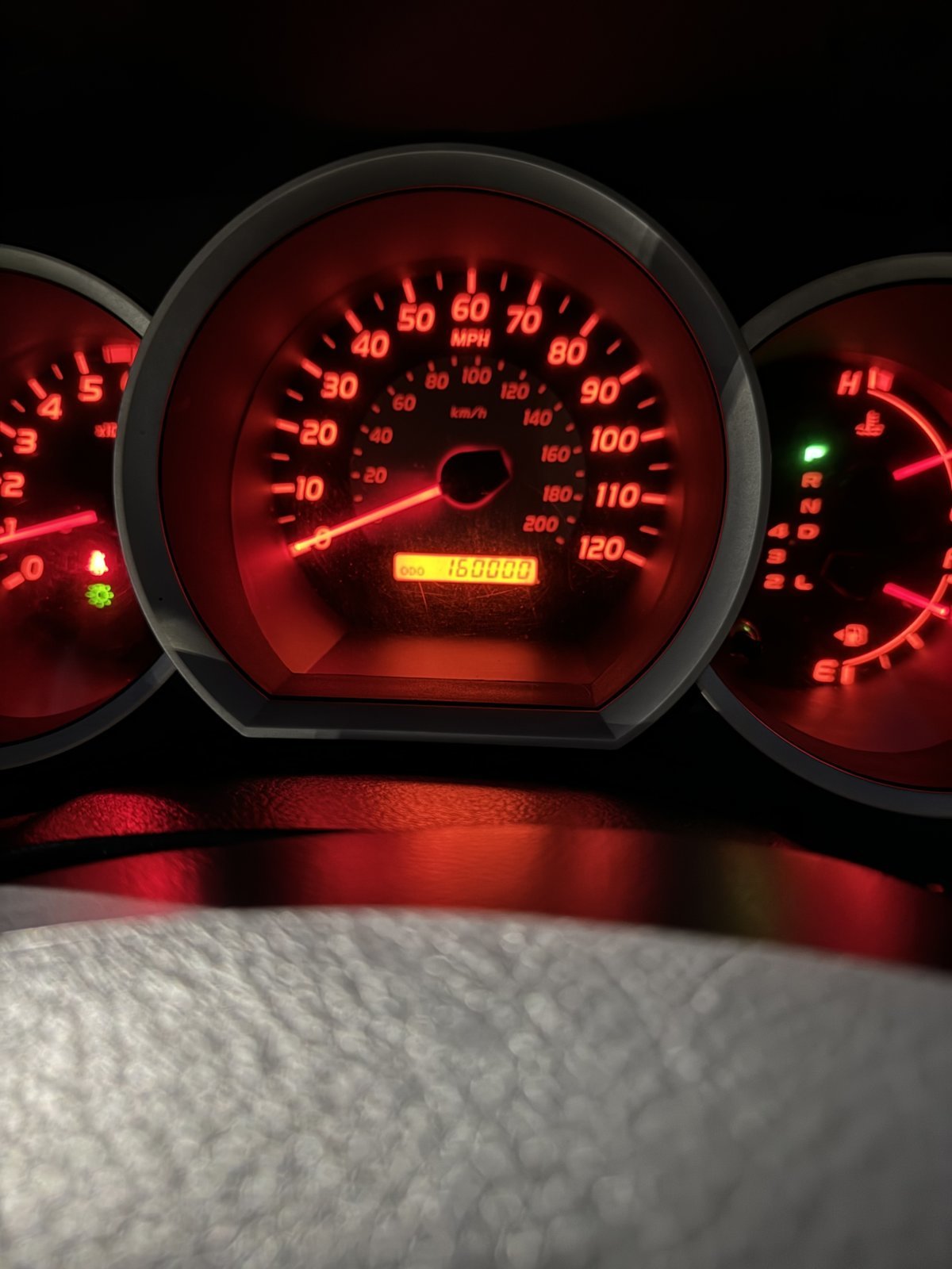

    Hit 160k.

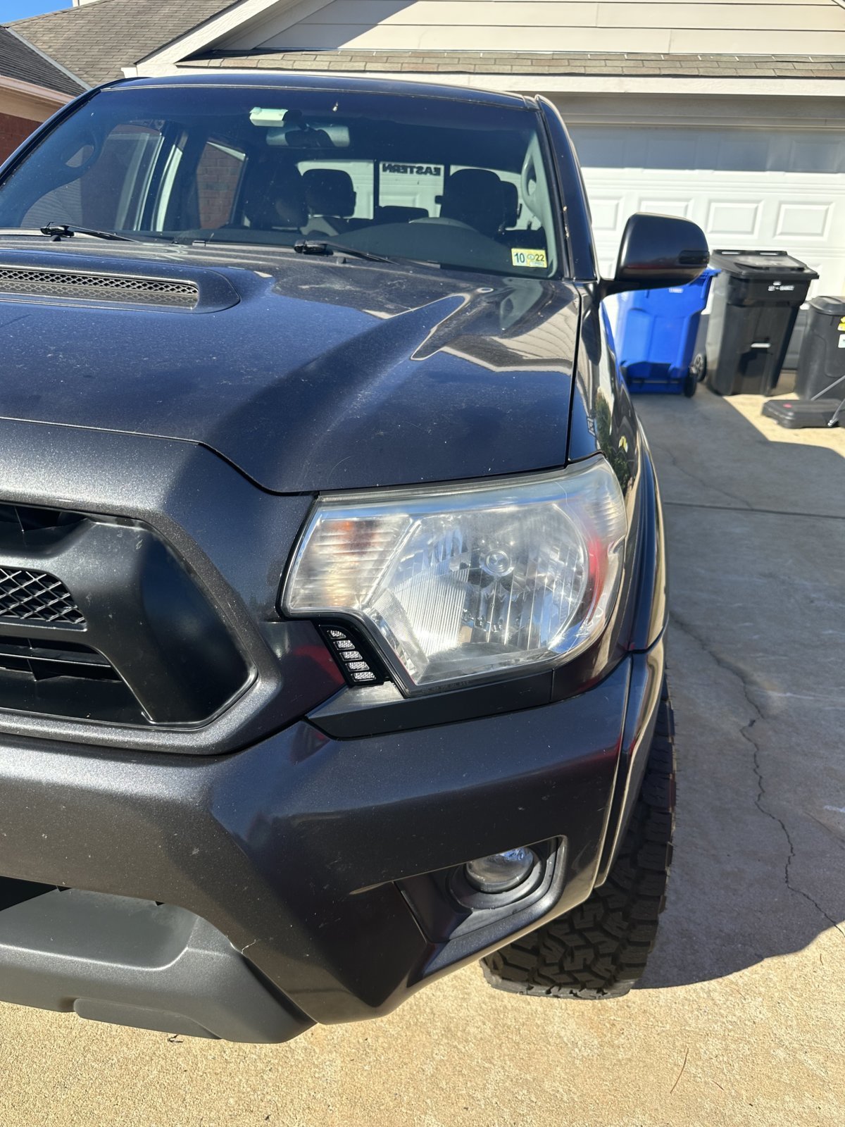

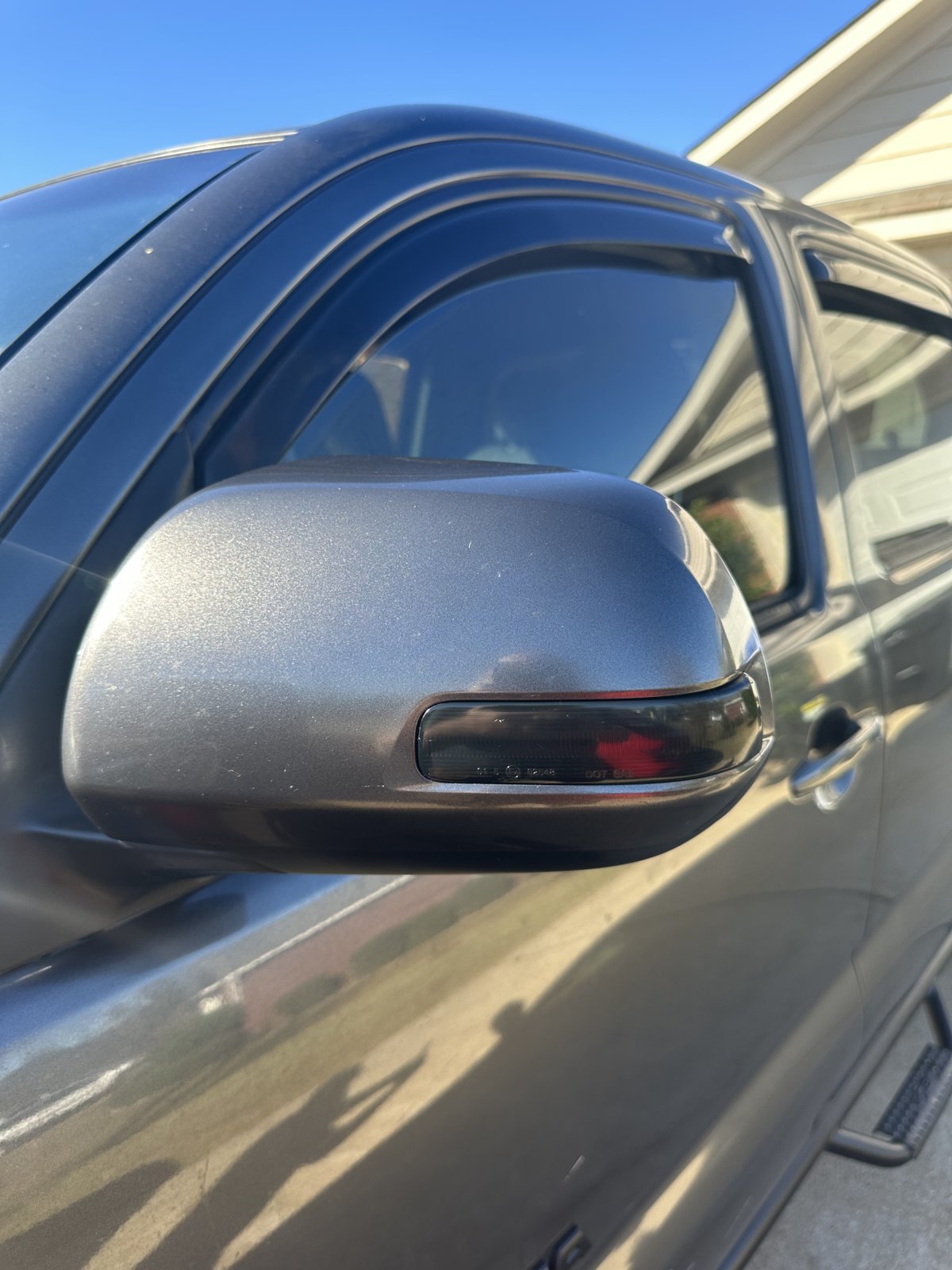

    I added smoked mirror turn signals and DRL’s where the fake vents were located.
    Looks cool! Will not let me upload video.
