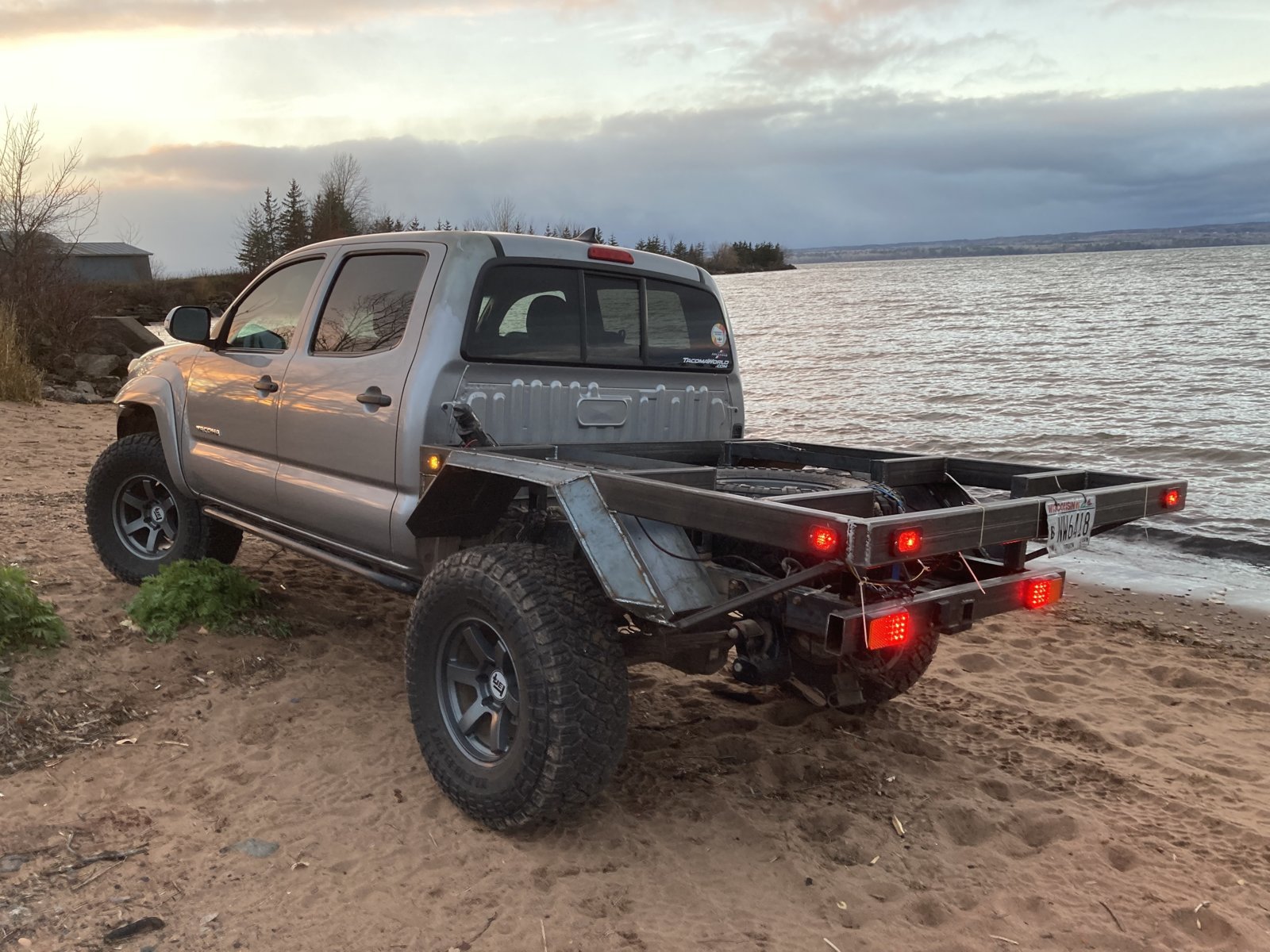

    Wired some Diode Dynamics flush mount lights in my new flatbed

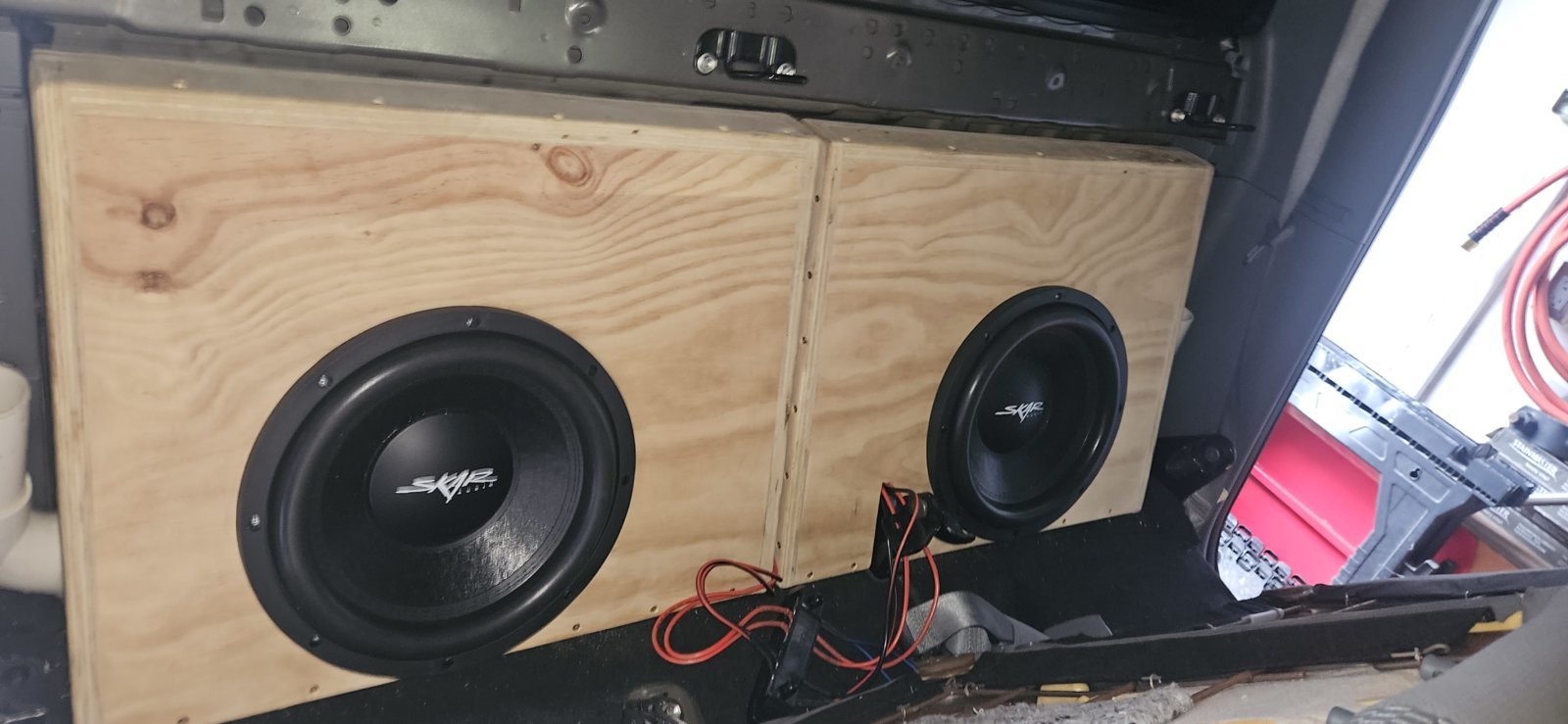

    Installed 2 shallow mount 12s running on a rockford fosgate punch 500x1 for the 8 hour drive to the mountains.

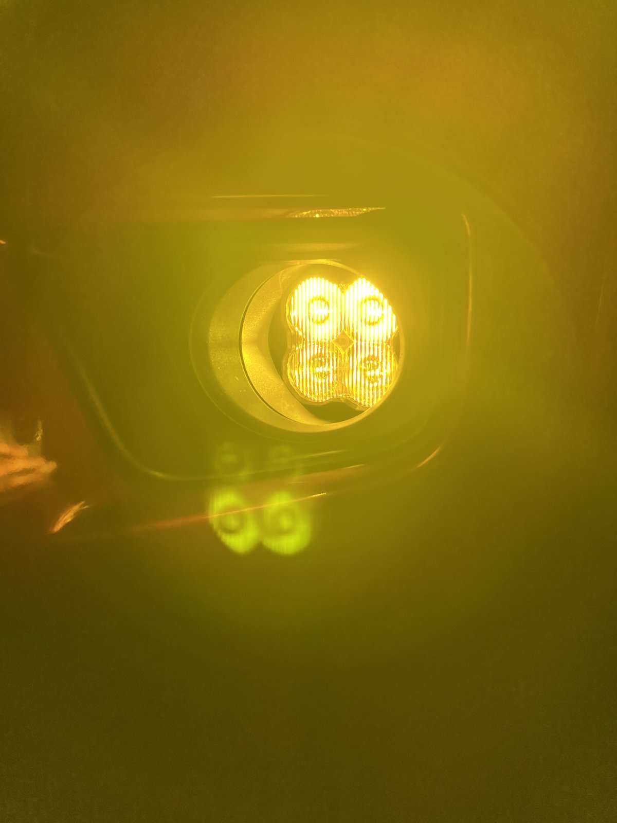

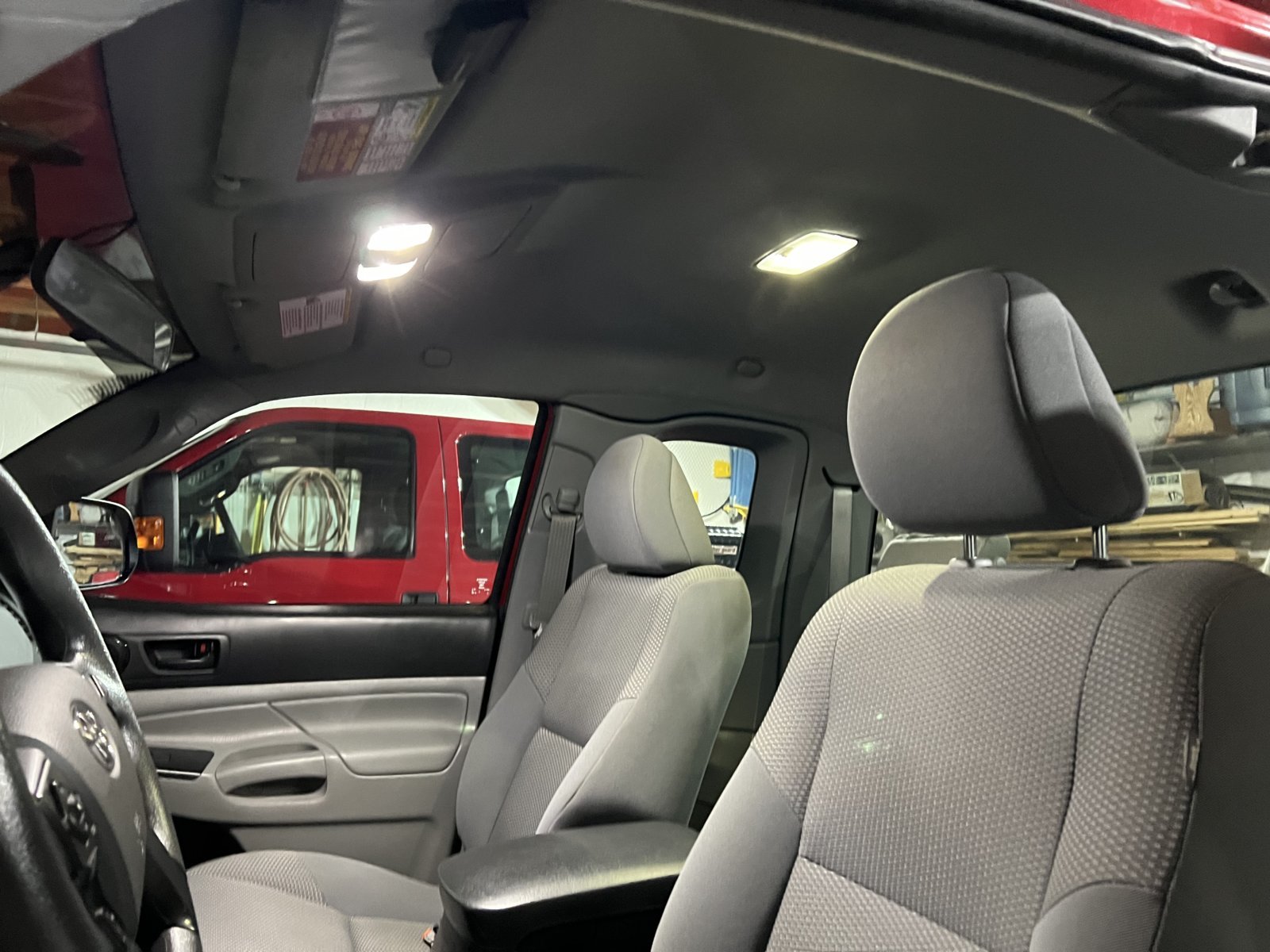

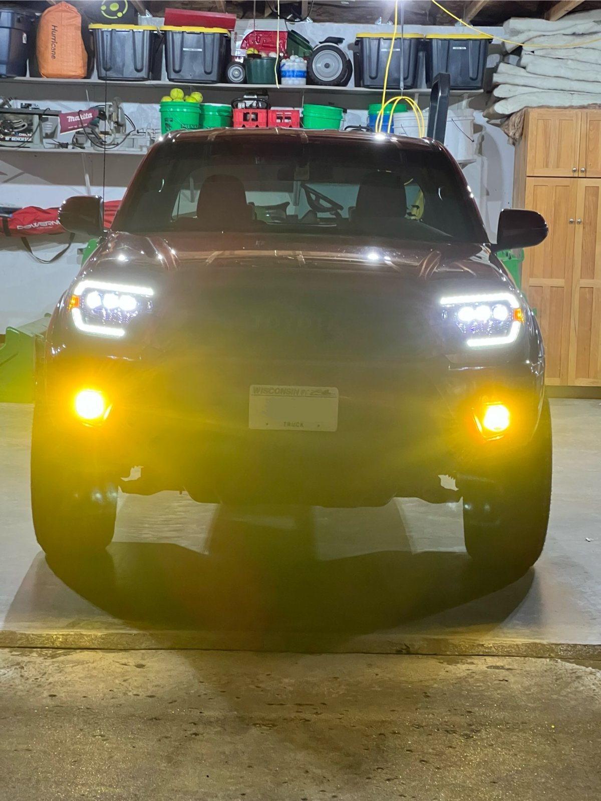

    I got my SS3 Pros today which I ordered two days ago shipping was super quick. I also changed out the interior light bulbs so now I can actually see the inside. Can’t wait to use the fogs in the snow and rain

    Those are nice looking head lights, who are made by?

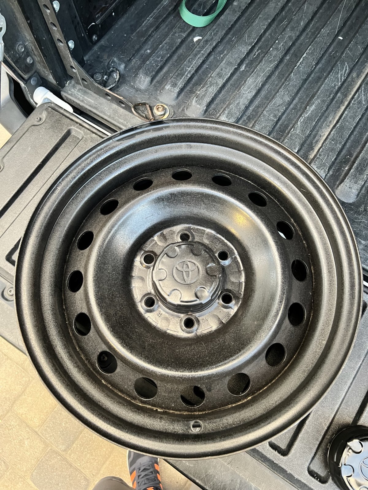

    Snagged a set of FJ steelies. Gonna strip em down and rattle can them

    They are made by alpharex, they’re the Luxx series headlights in alpha black. They are expensive but you get what you are paying for they are really good quality

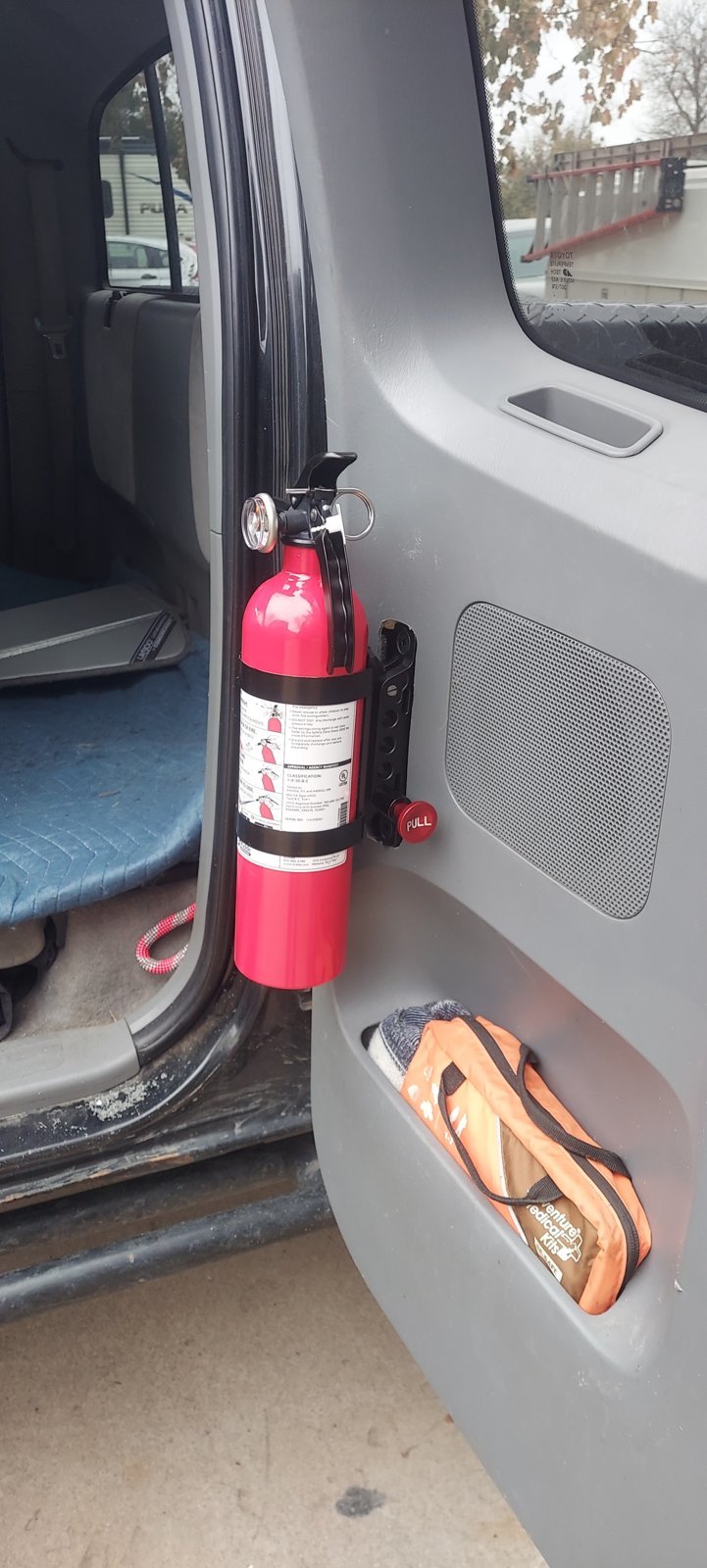

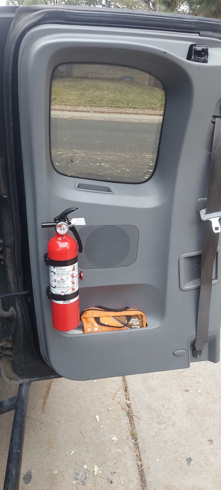

    Mounted a fire extinguisher to my access cab door. Made a 2-1/4" stand off with 1"×.120" square tubing and M8 nutserts mounted to the inner door structure. Cheap Amazon quick release mount and replaced the garbage hose clamps with slightly less garbage bolt style clamps. It's relatively sturdy but we'll see how it holds up.
