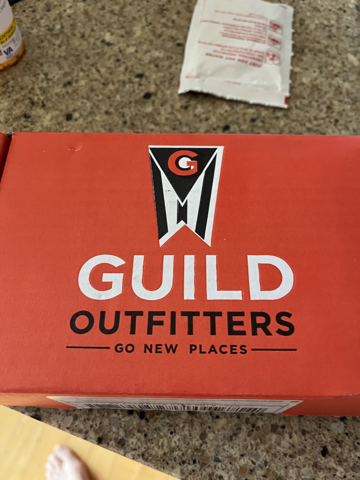

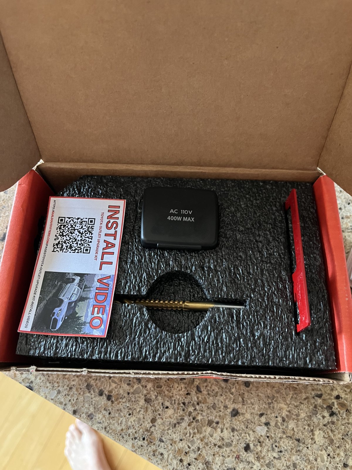

    Just got my guild plug set from the postman. Looking forward to install.

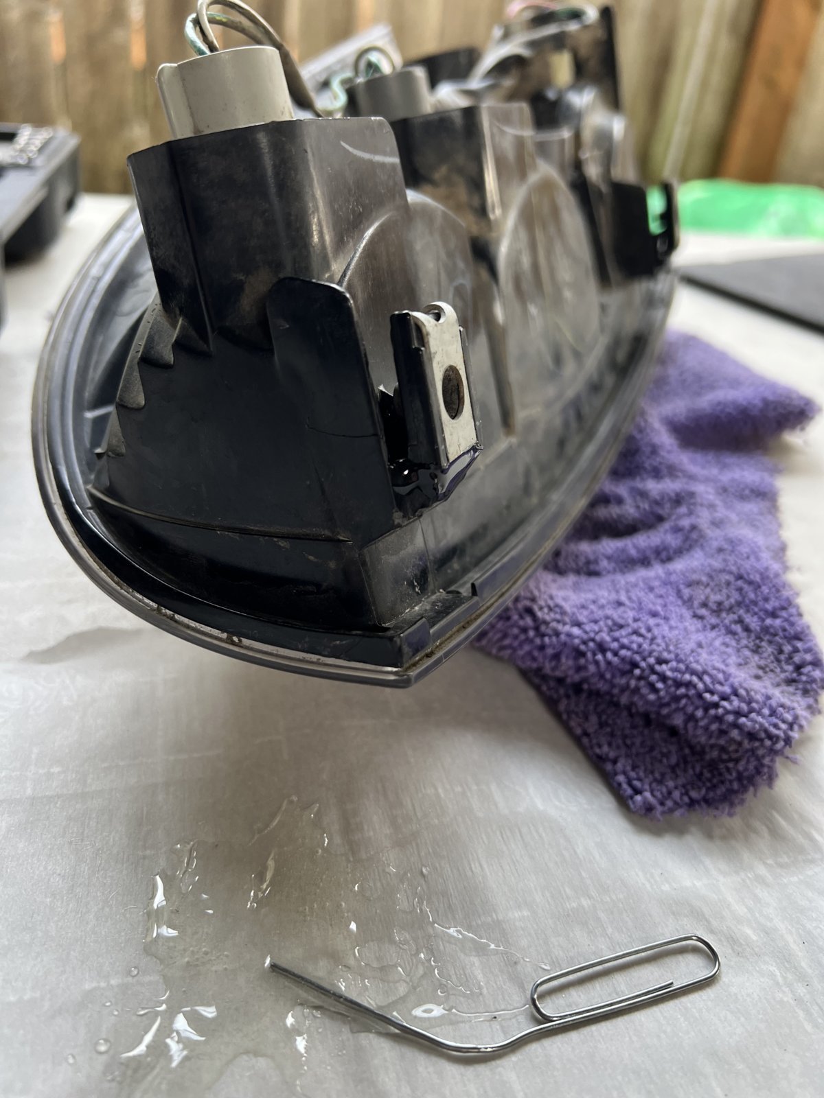

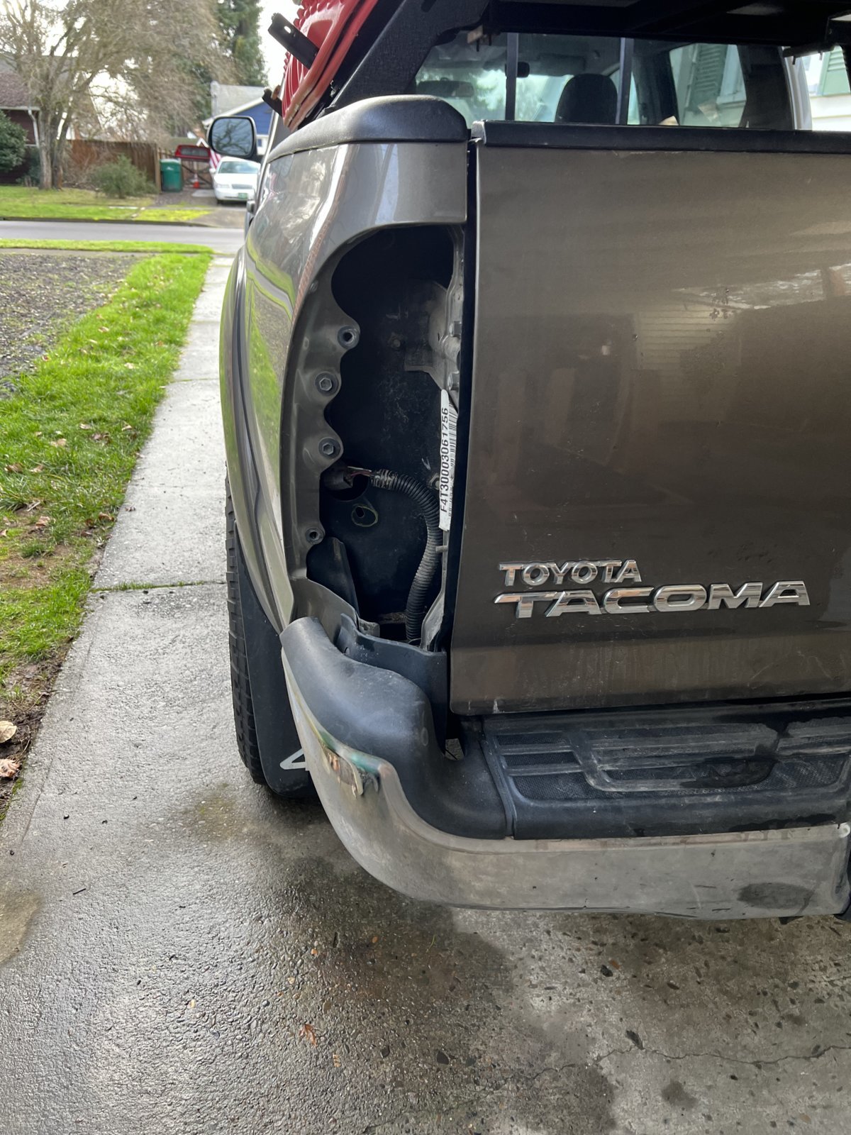

    Knik glacier 1, taillight 0

    Was curious what this was and now seeing it, I want it. My truck didn't come with an inverter so and always wanted something in the truck where I can power things when camping or maybe a portable air compressor.
    **nevermind. I would need an inverter. Adding this project to the growing list of future mods.

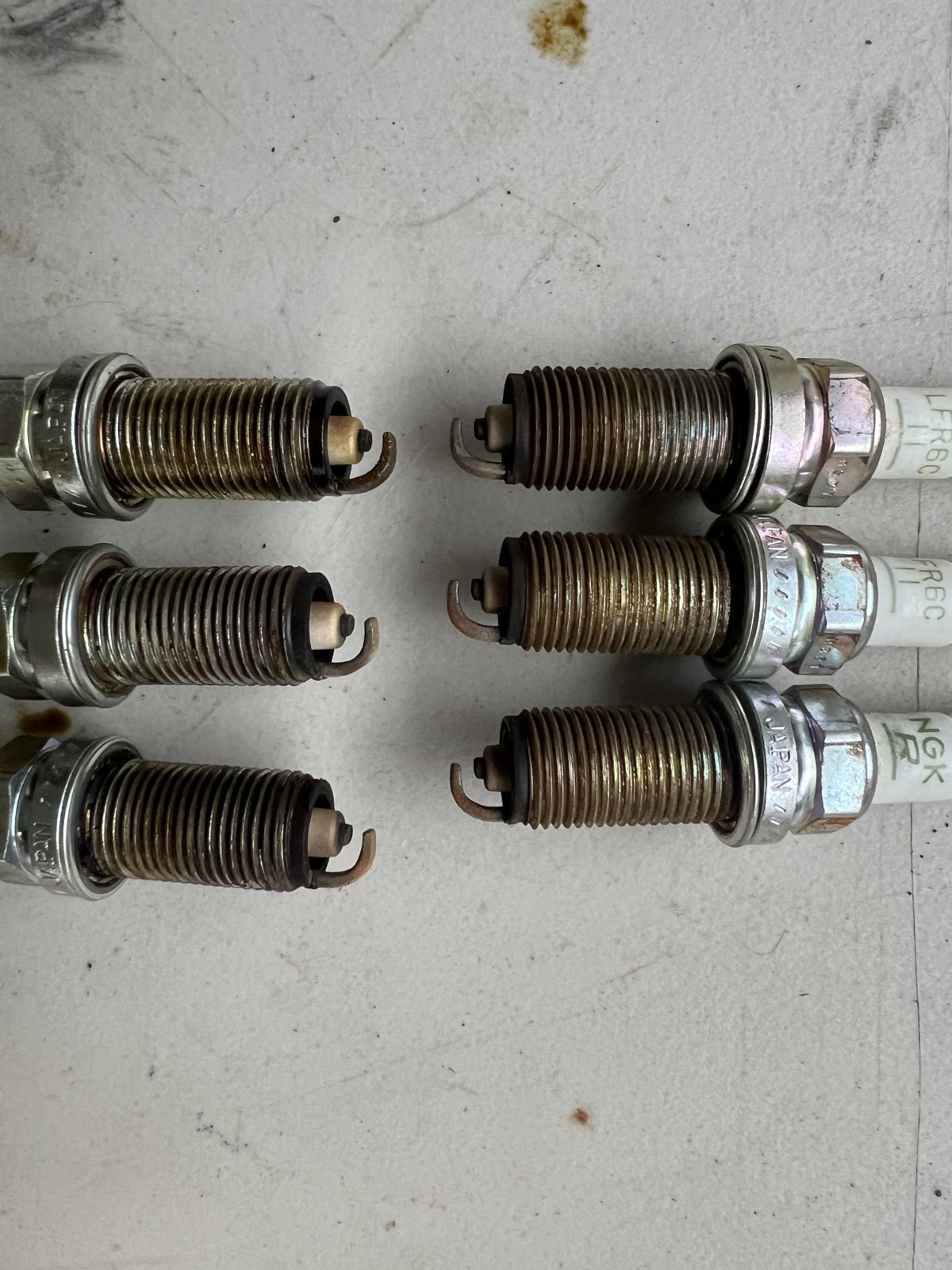

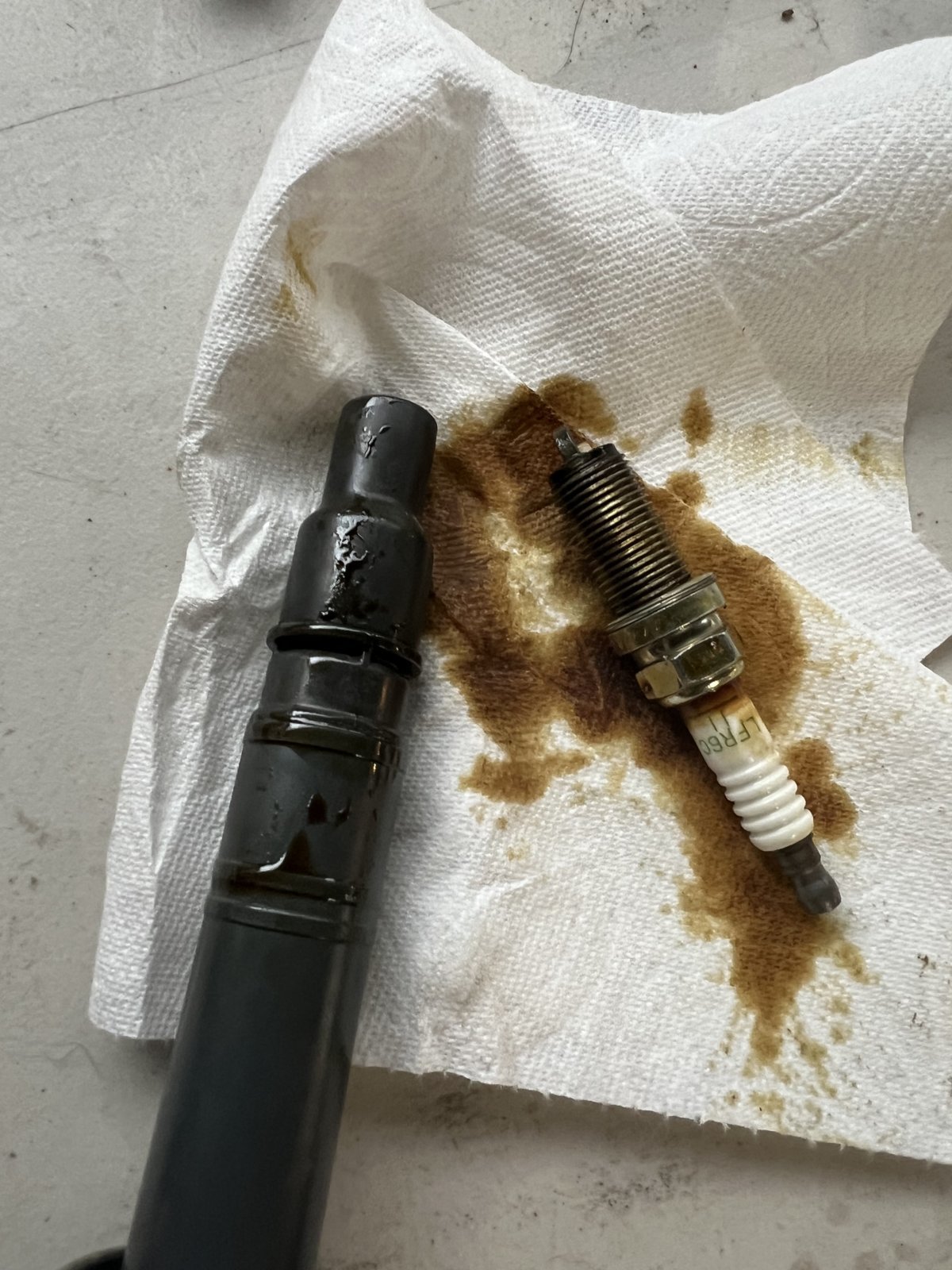

    changed my plugs.. driver side front had oil in it?? all the gaps were way out!!

    How many miles on those plugs?? I bet it runs better now.

    about 60K.. Just put them in, haven't drove anywhere yet.. lol

    You probably have a leaky valve cover gasket (it also seals around the plug wells). If that had been inside your cylinder you would have surely gotten a CEL for a misfire.
    edit: it also looks like the motor was running ever so slightly rich, which is normal for a factory tune. Mine looked like that at the second to last change. I got an aftermarket tune around 3 & 1/2 years ago. More power and better mpg. When I changed my plugs again last spring they looked better as well.

    No codes popped.. before or after.. I should check my oil level again since I just did an oil change..

    Yeah, that’s because it’s leaking down the well from the oil bathing your cams. You’ll not register such a small leak on the dip stick but it will eventually cause misfires either from fouling the coil or wicking down to the electrodes.

    well.. I know what I'll be doing soon.. fun fun.....
