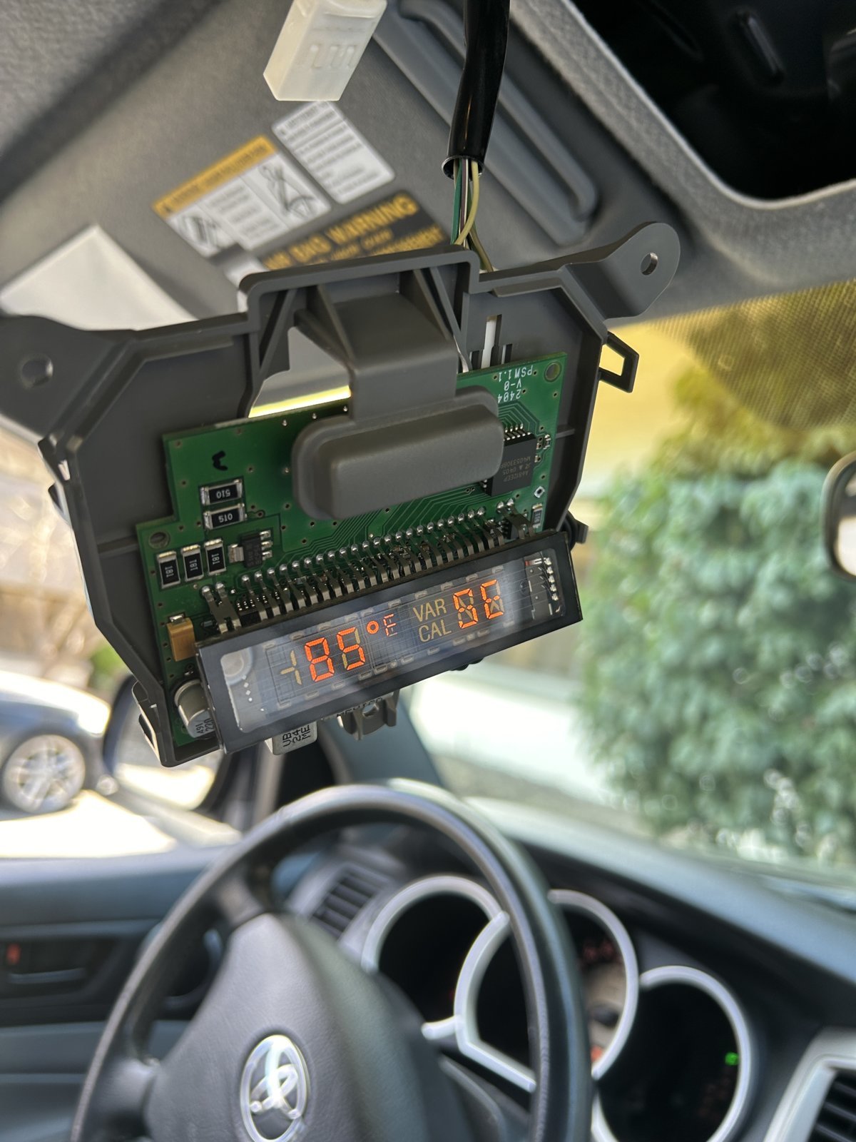

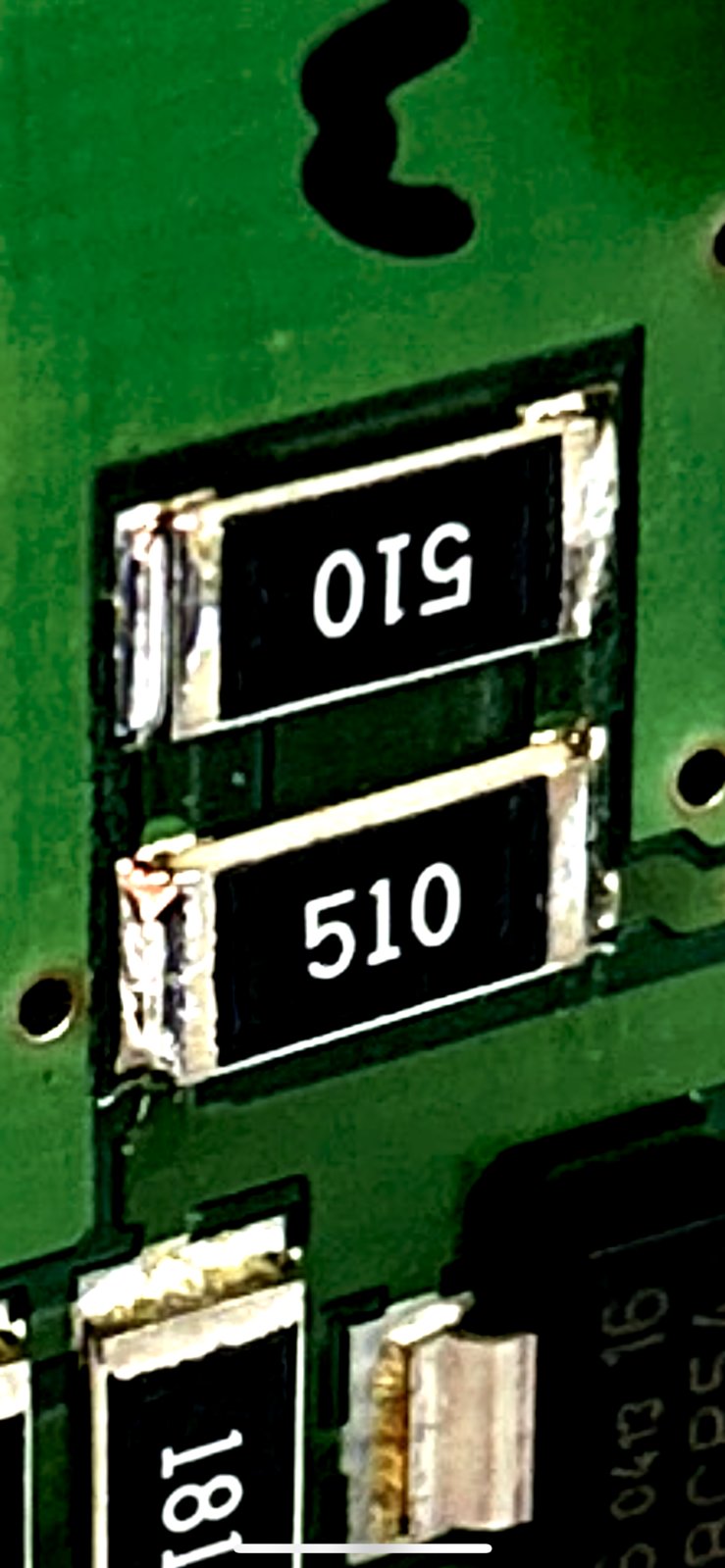

    Fixed my thermometer/compass yesterday! I saw a YT vid of a guy replacing the surface mount resistors with through-hole for the pair shown below, so I figured I’d look there first. Broken solder joint on one of them! Luckily we have all we need at my office, including a microscope. I’ve never done surface mount electronics before, but it was pretty easy with the microscope. Just hit the solder joints with some heat and a tiny bit more solder and the unit came right back to life. I hit both sides for each of them to be sure.

    Good job soldering the overhead thermometer!
