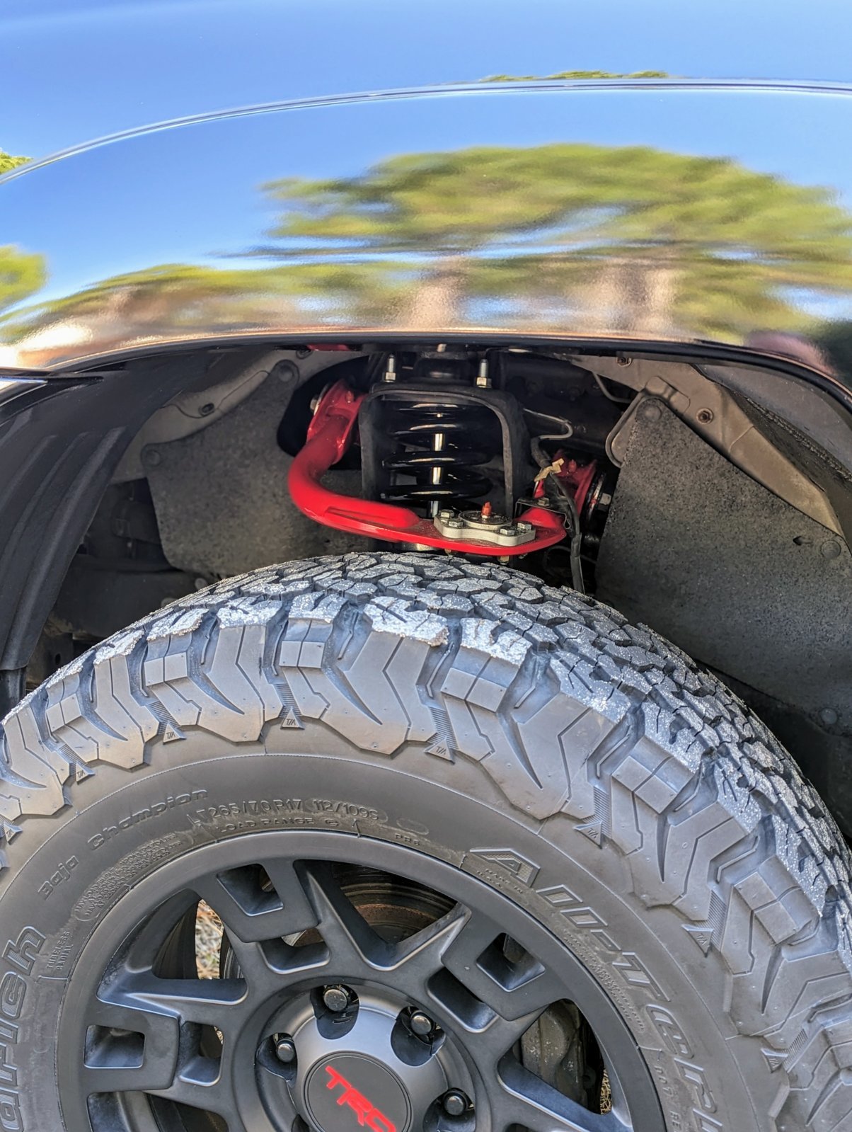

    Bilstein 6112s installed today. I swapped out my 5100s with 885 coils to these.

    How’s your assessment of the 6112? Big difference from the 5100?

    I've only got about 10 miles or so put on them so it's a bit early to tell, but they do seem to dampen much better and have an overall smoother ride than the 5100s. They still maintain that known Bilstein feel of tight highway handling which is nice too. I have mine on the #8/#10 clip settings which gives the truck approximately 2.25" of lift.

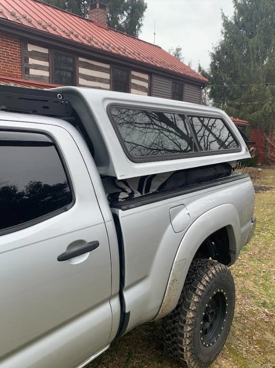

    Not really "to my 2nd Gen" but - 'with'.
    So I'm moving and because I am old, I have stuff. There's a full-size box spring in there, diagonally. I pulled the topper lift down snuggly so the cap is supported, essentially, on the box spring. Being about 6" elevated, the topper was rock-solid during a 40 mile trip. If it wasn't for the TopperLift I'd have needed to rent something. Trailer. Van. Friend's truck? Next I have to carry a queen size mattress set the same way. Then washer and dryer.

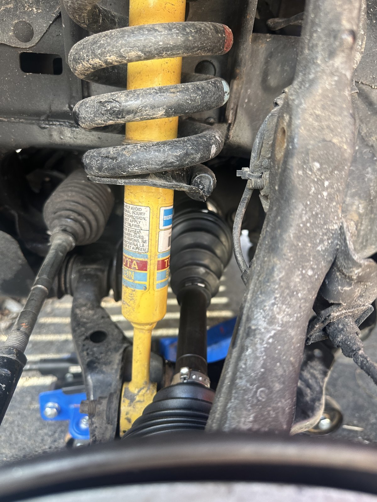

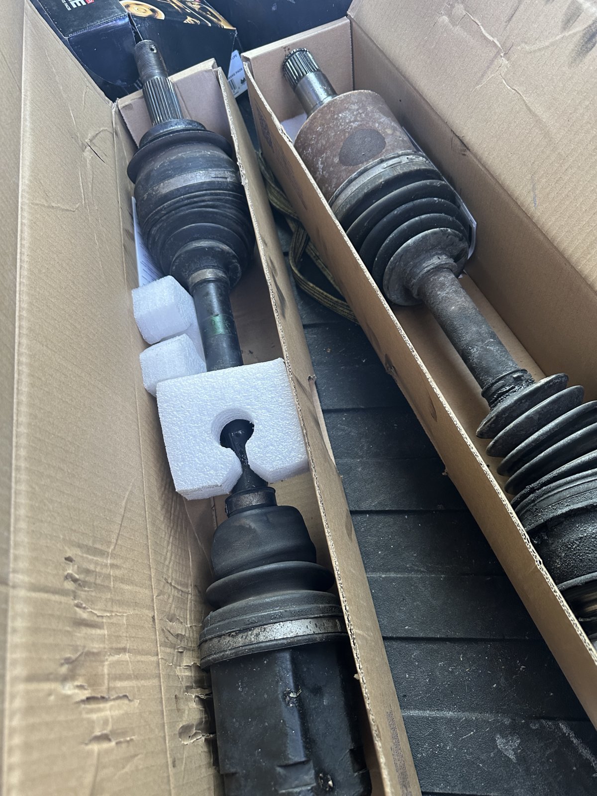

    IMG_7055.jpg IMG_7053.jpg Popped in that ECGS bushing and swapped out the front Cv axles/seals while I was down there :cheers:
    btw my passenger axle nut was probably torqued to ~25ft lbs when I popped it off…. I was preparing for a battle.

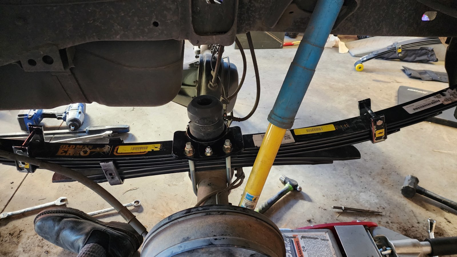

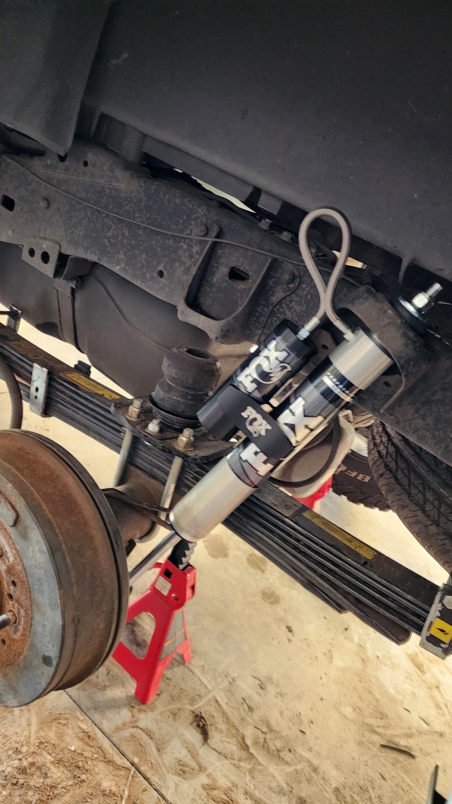

    Well wasn't today but this last weekend. had a funeral this week so late to the updates.
    New leafs, New bump stops and New Fox 2.0 shocks. I'll say those damn foxes are tight in the lower mounts. Got annoyed and took them to my grinder and removed a bit of the material off both sides of the bushing and finally slipped in. But was a pain for a bit. Just a little off both sides. but at one point i had my adjustable wrench out trying to open up the ears, tried a piece of box metal to square it up. hell even tried to use prybars and even my "alignment" point on my wrench. nothing worked well but hey they are way nicer then my old OEM leafs and my 2020 Bilstein 4600 take offs from a friends tacoma.
    oh an don't mind the 4600's I just didn't drop them both off when installing because I wanted something to help me align things just in case
