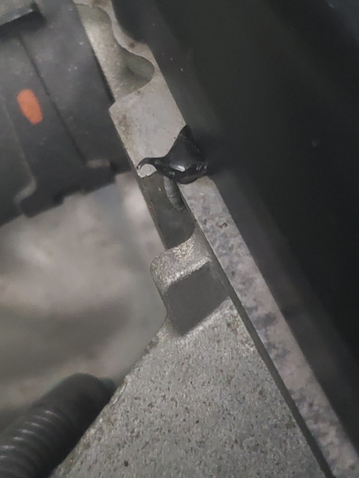

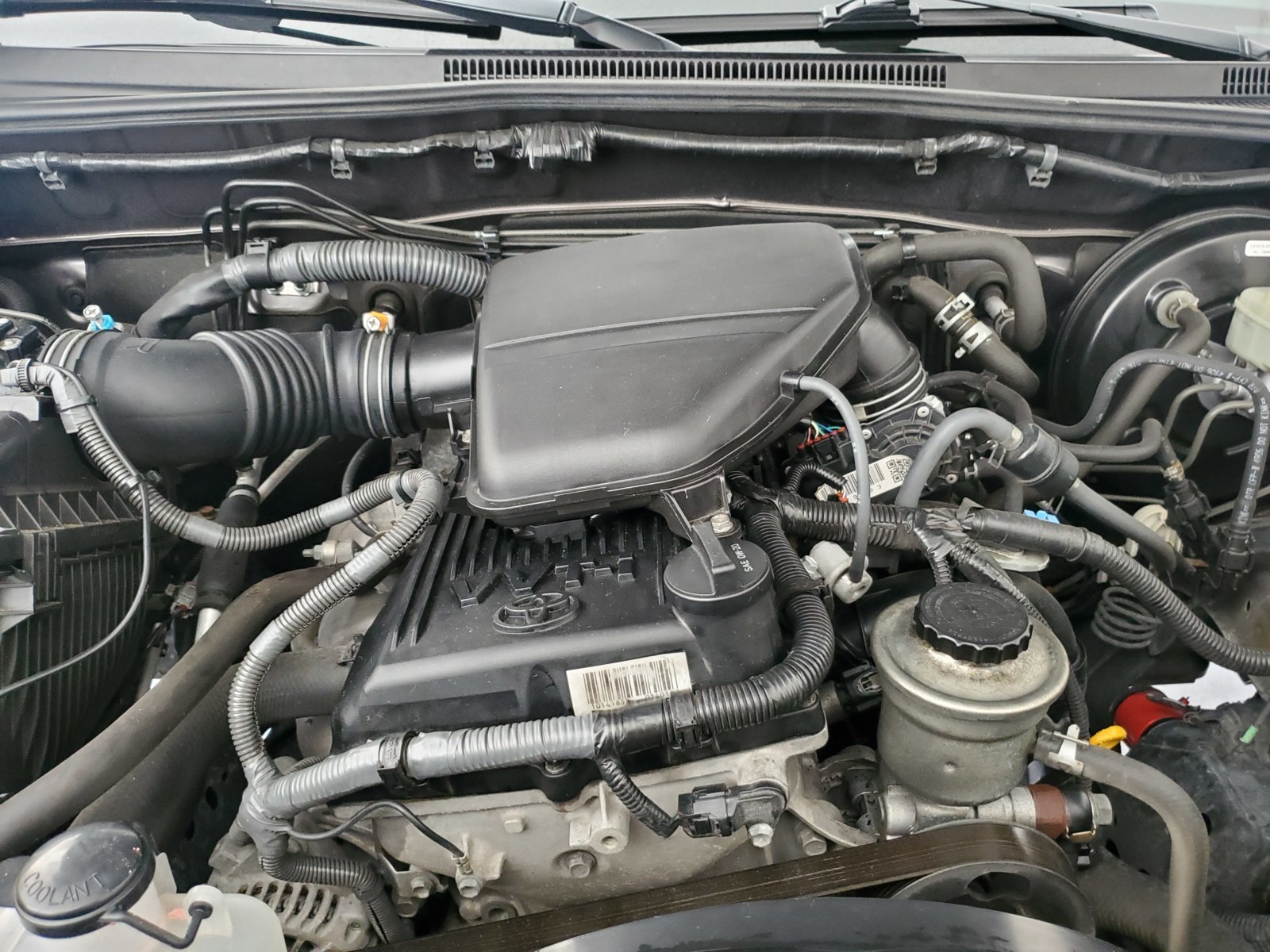

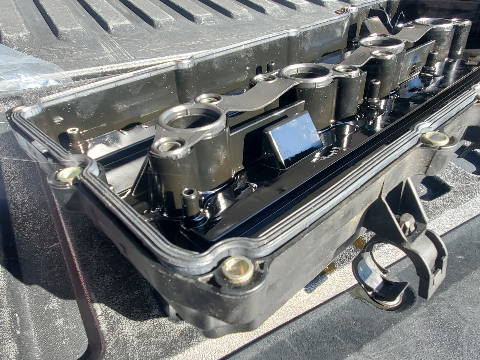

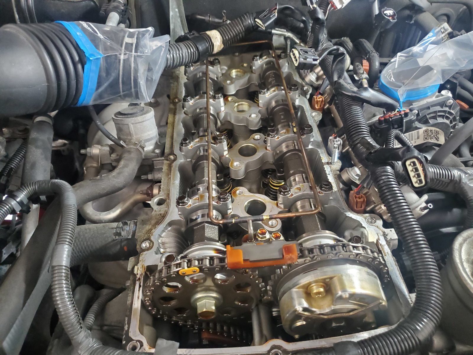

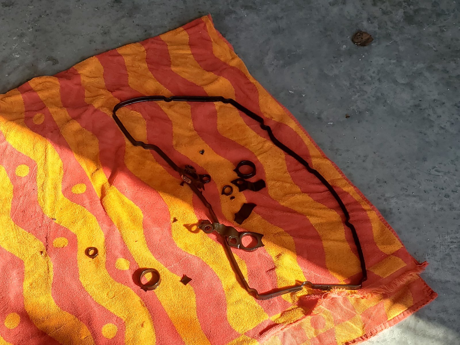

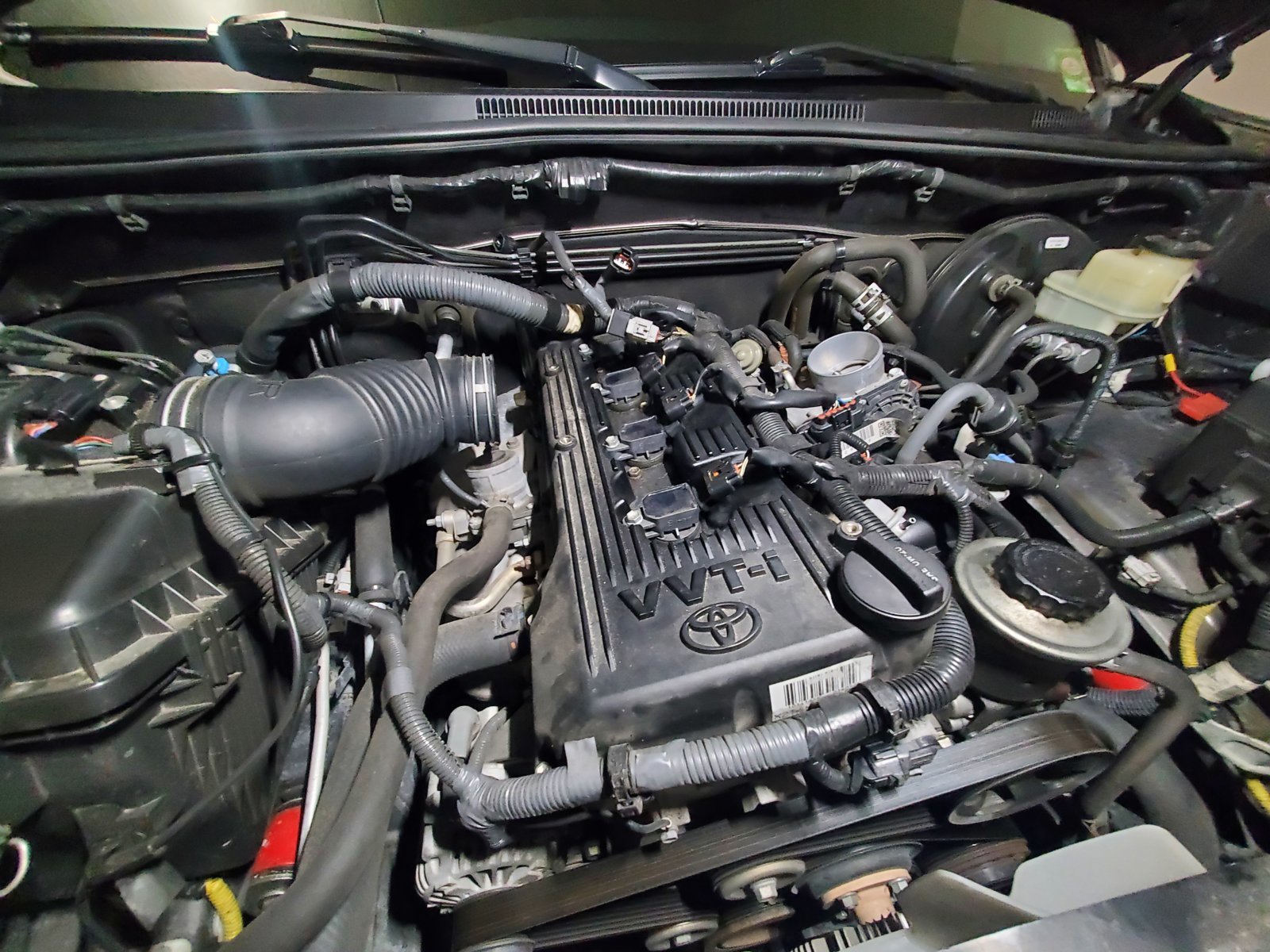

    Got tired of smelling burnt oil in the cab so i broke down and changed the valve cover gasket (which I'm sure was the cuplrit)
    Oem 2 pc gasket and yota 103 silicone
    The beginning. The dread. The air intake shit is overdone/over-engineered and a pita in it self
    What luck, the old gasket and cover was froze on. Few knocks w a hammer, the missuses hair dryer and plastic pry tools and it gave up thank god (and her ziplock bags which she don't need to know about either)
    Prying all this out was a test of patience
    Fresh rubbers
    Back on & cleaned up. Absolute pain in the ass the the wiring harness. Tomorrow morning after i let the 103 firm we'll see if she runs

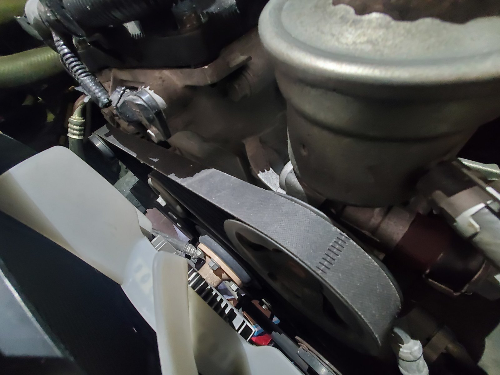

    On a roll today. Fig'd since the FIPG 103 is curing for the valve cover gasket i'd get the new belt on. Old one didn't look bad, few very minor cracks. It was a napa from the prev owner- threw an oem on it. Had to pull the skid to get the lower guide roller and then it was a breeze

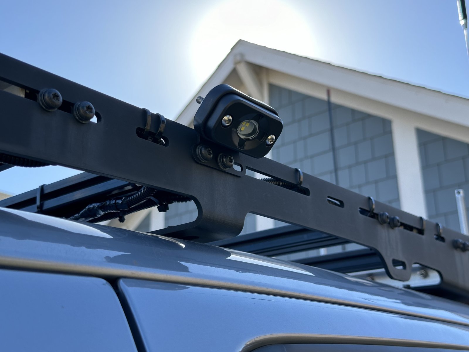

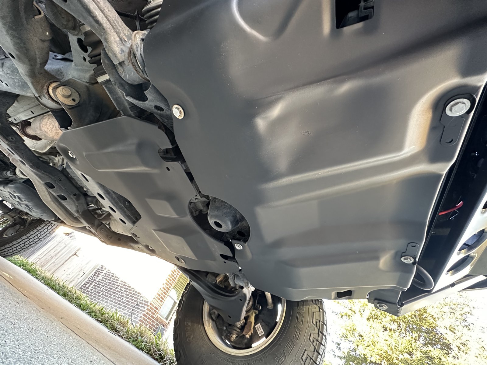

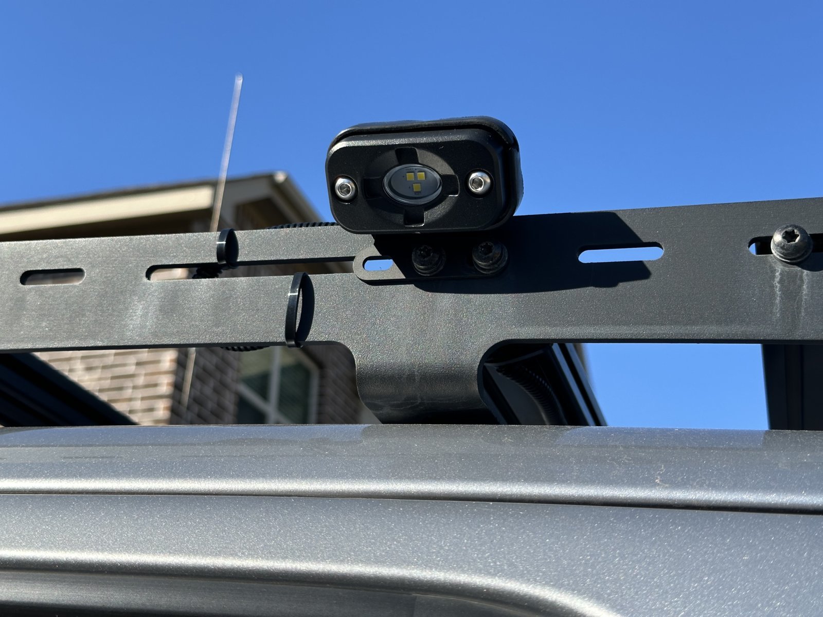

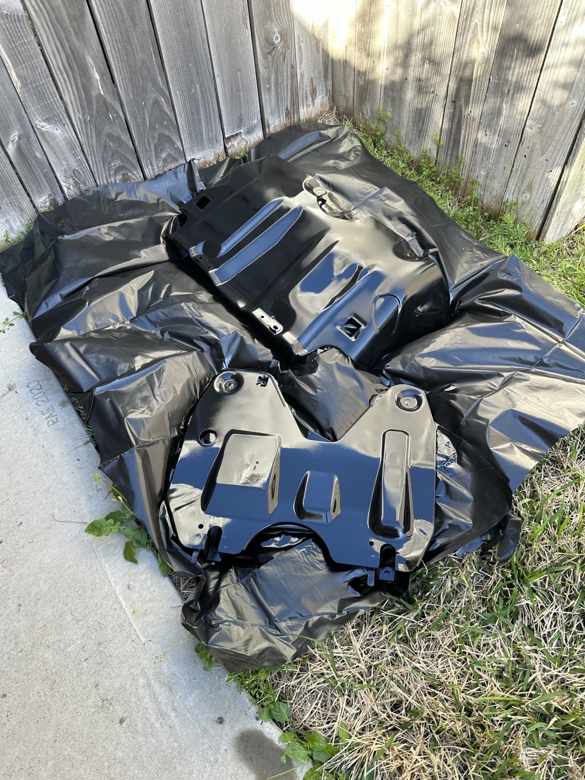

    Fresh coat of paint on the splash pans. While I was doing that I also sprayed some roof rack mounts by Moto bilt. While those were drying I installed a remote start in my wife’s 4runner. Once pans were back on I installed some
    Harbor freight rock lights on the prinsu.
    Everything wired with DT Connectors and in wire loom.

    Guards look great. I just had mine off today and was thinkin "man these look like crap i should paint em"
    I know its their job to get battle damage but itll certainly spruce the front end up at any
    rate.
    Lets see some pics when they're back on :taco:

    I should have takes a before picture. And I should have tried to hammer out that dent before painting. All good I did a lot today. They look newish and the rust is covered up.

    Damn that does look spiffy. Whatd you use?

    Looks like black paint.
    Sorry, had to do it

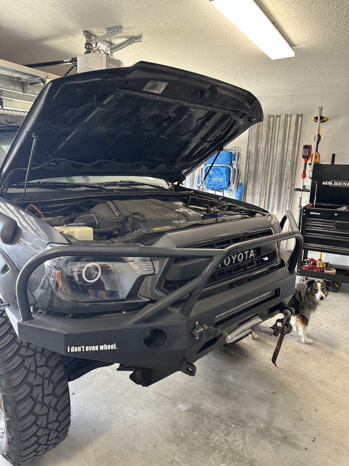

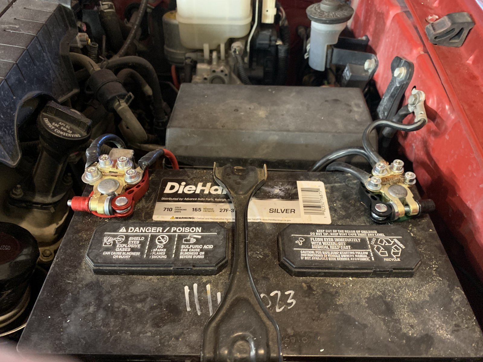

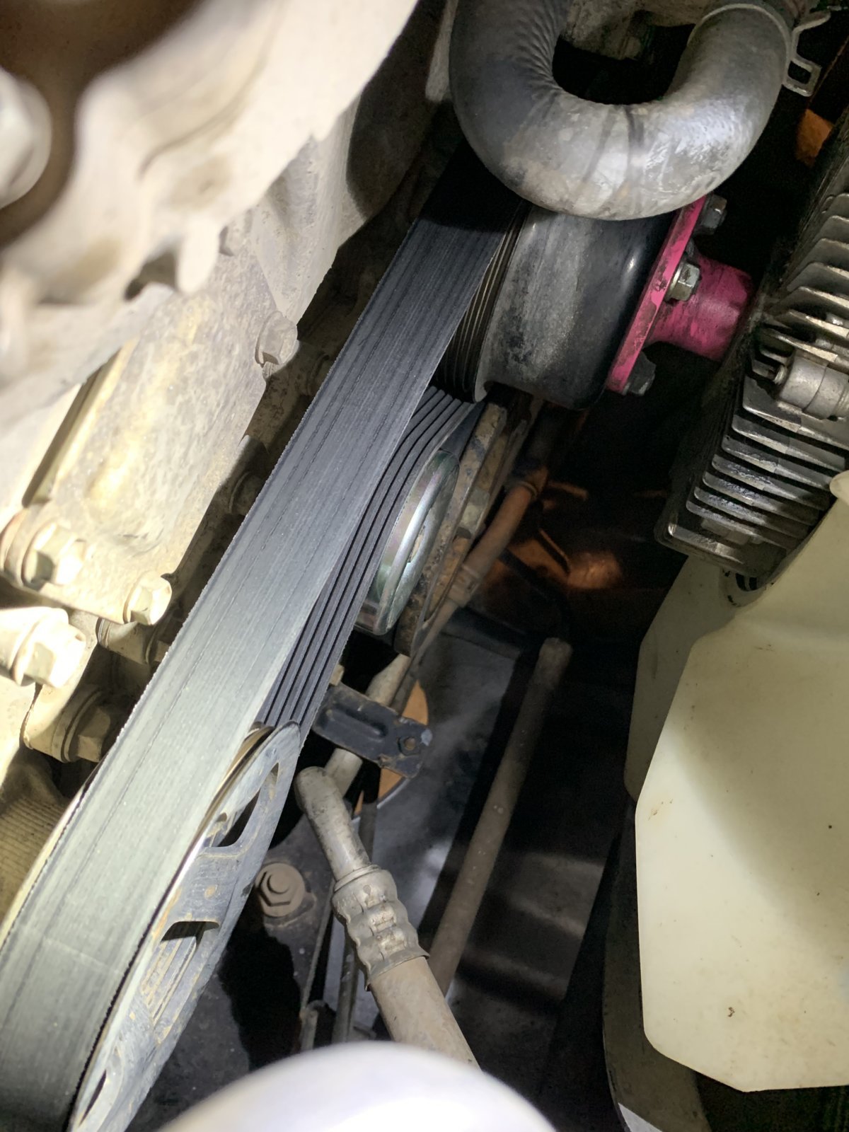

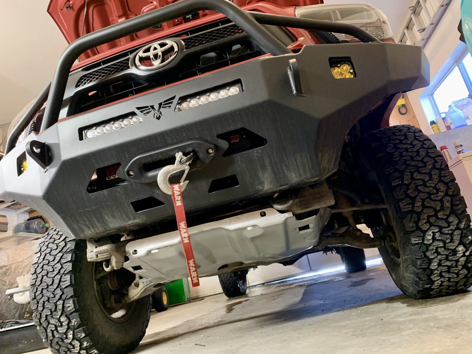

    Changed out the serpentine belt and 3 idler pulleys on my truck, replaced battery terminals with easy-levers and painted the front skid plate silver to match the light bar, stock TRD wheels and chrome emblems. IMG_9675.jpg IMG_9674.jpg IMG_9673.jpg
