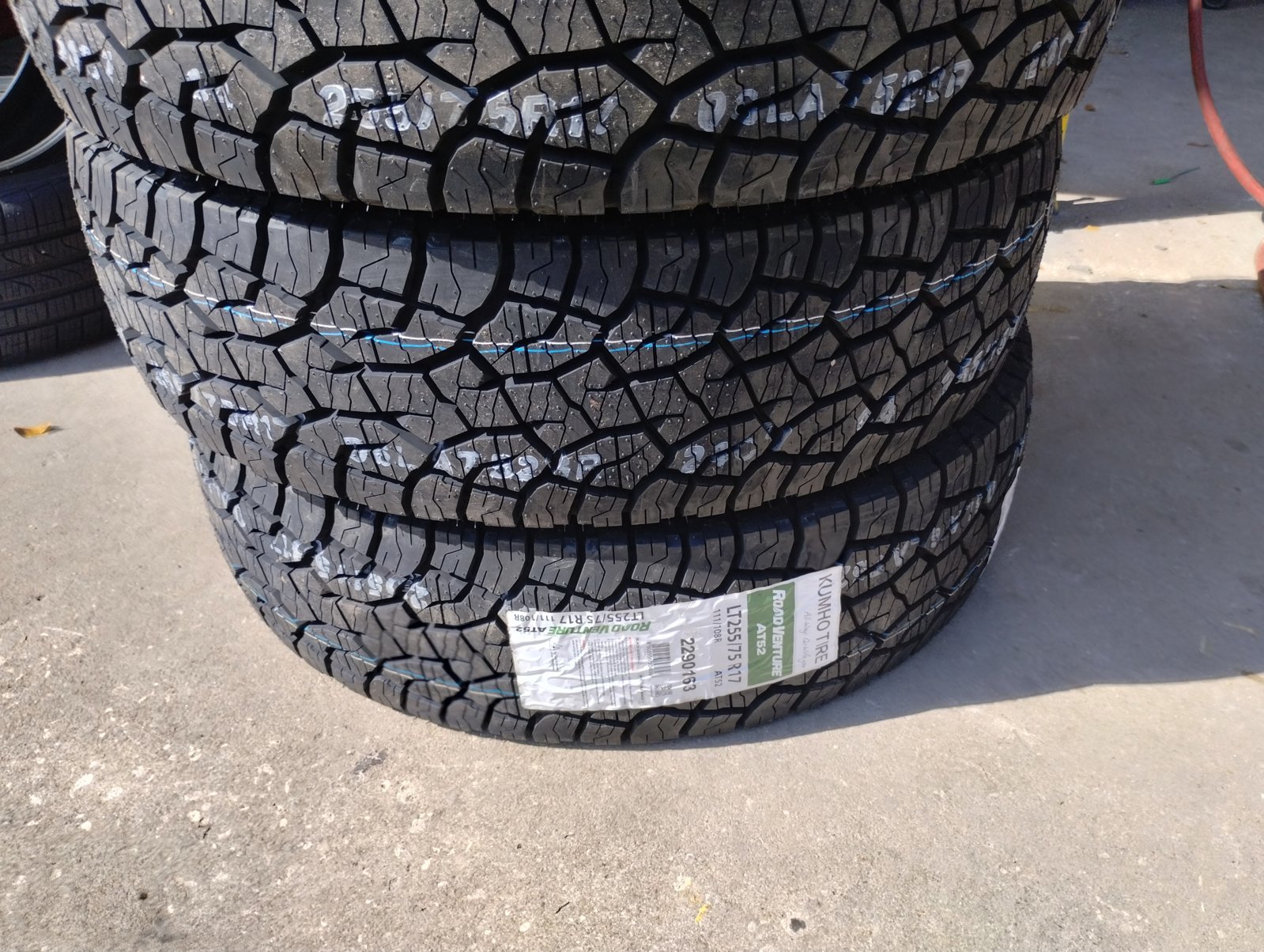

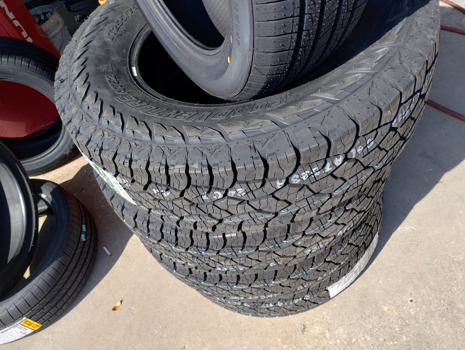

    I'm excited to run these Kumho Road Venture AT52's. 255/75/17LT.

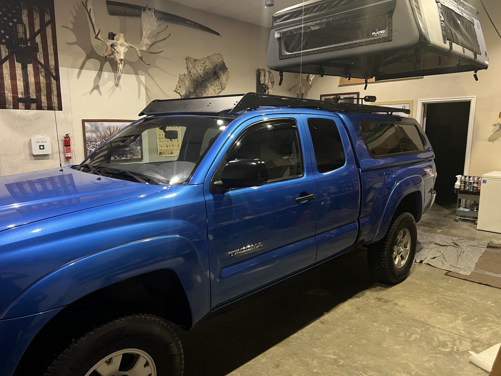

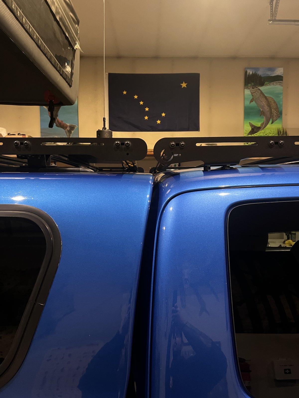

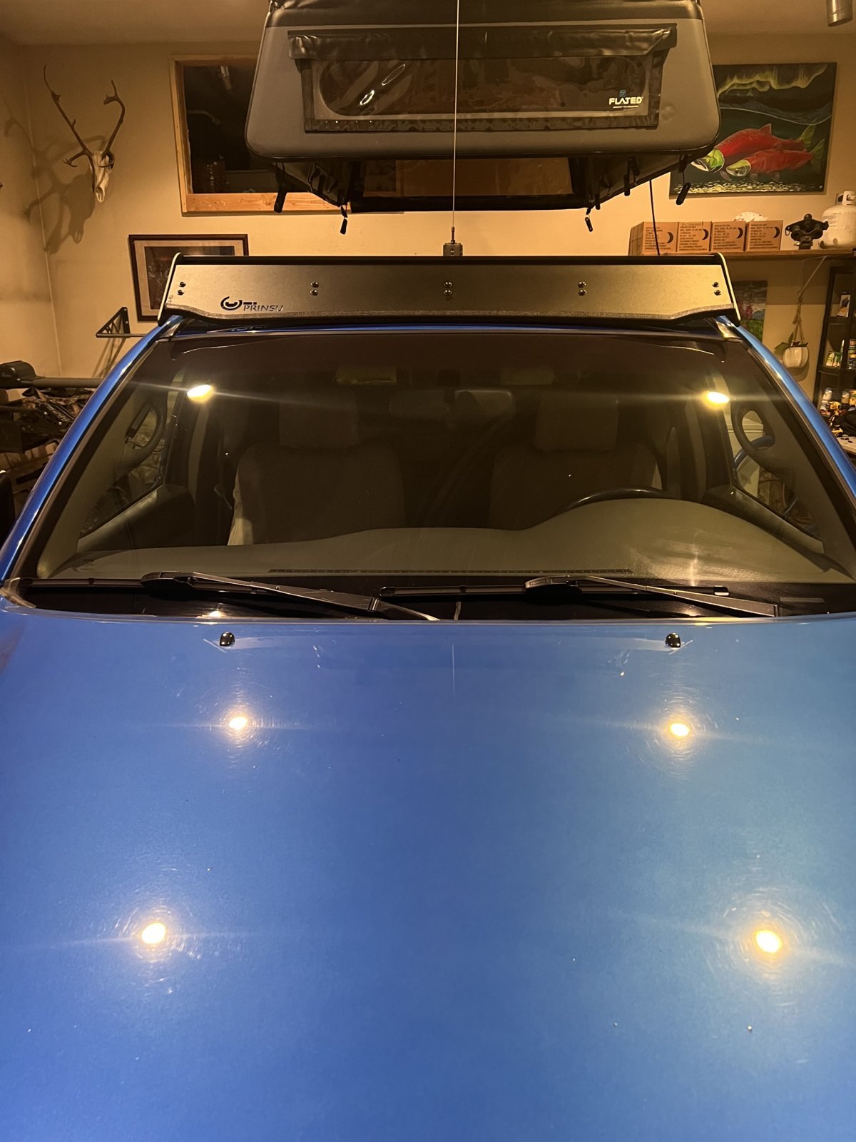

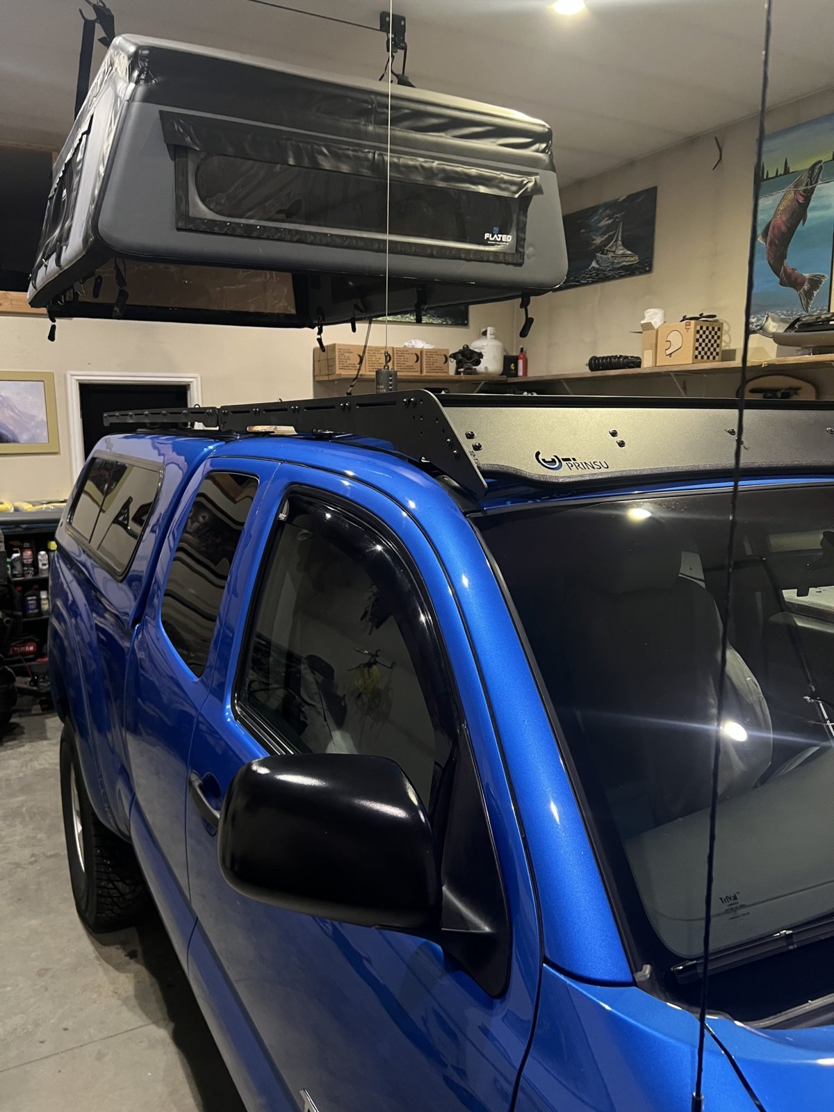

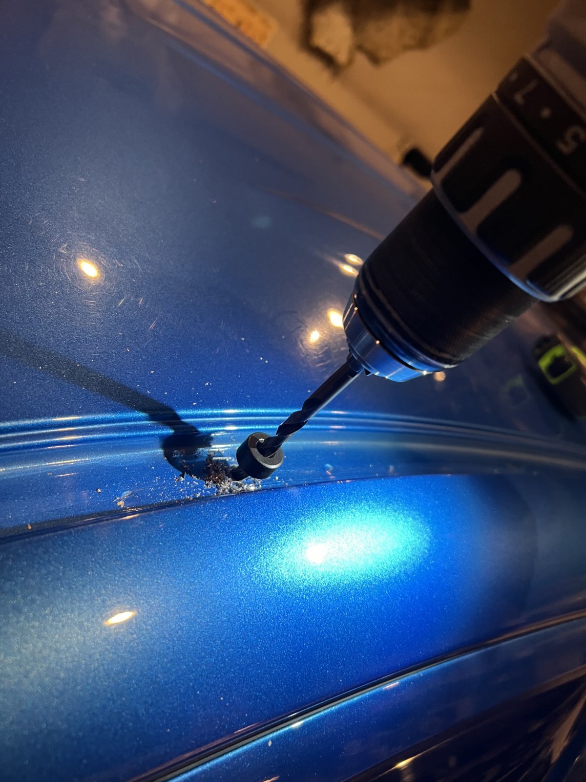

    Any trouble with the plus nuts? How about side curtain airbag clearance or drill bit issues when drilling? I've been thinking about putting one of these on my AC for years and every time I'm ready to pull the trigger I read (or probably re-read) some horror story.

    For the plus nuts i just went painfully slow, continuously checking so nothing was over torqued. i got lucky, my 06 doesn’t have any curtain airbags thankfully. but i used drill bit stop collars to ensure i wouldn’t go too deep. started at 1/8 and went up to 3/8. Nothing about this job was “hard” just tedious and high stakes. I used RTV after each step ensuring the whole setup was water tight. I think you should do it man. just take your time and it’ll be great!

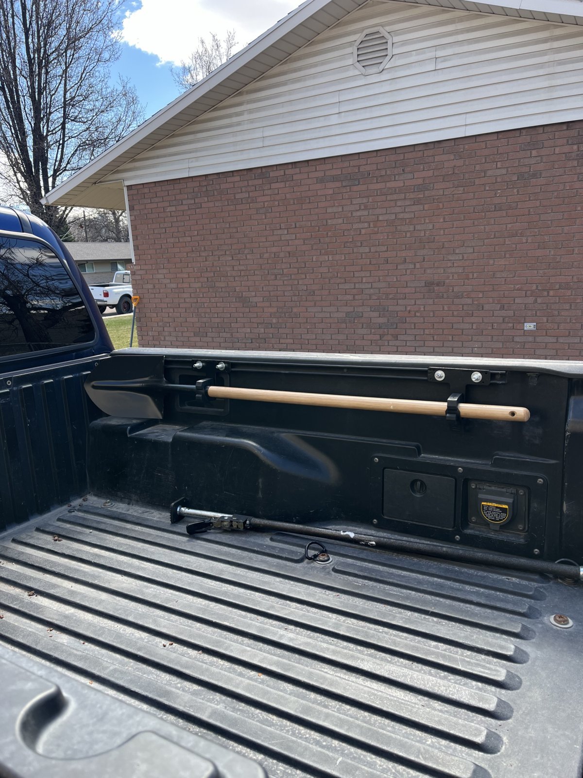

    Installed a shovel mount using quick fists

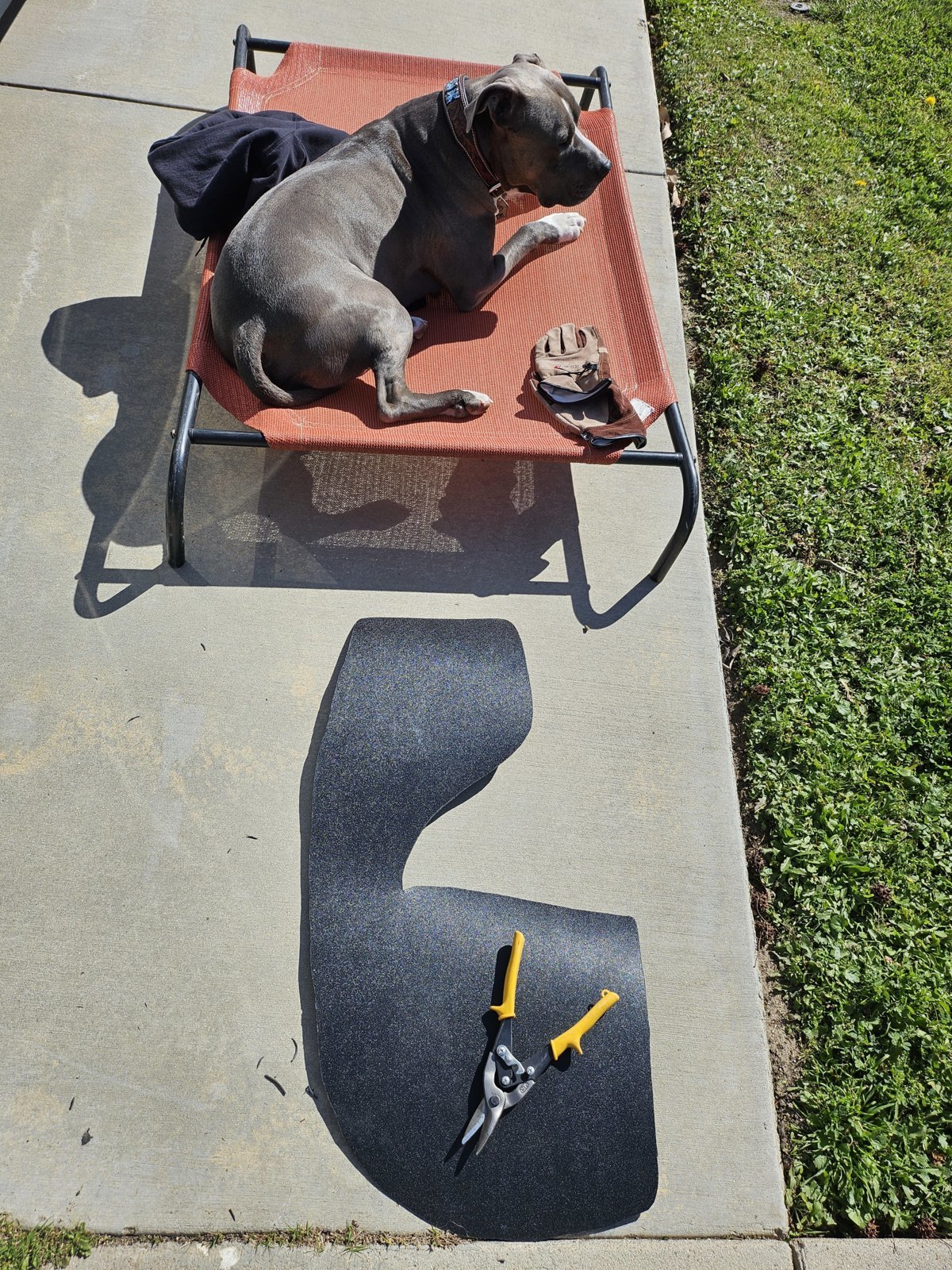

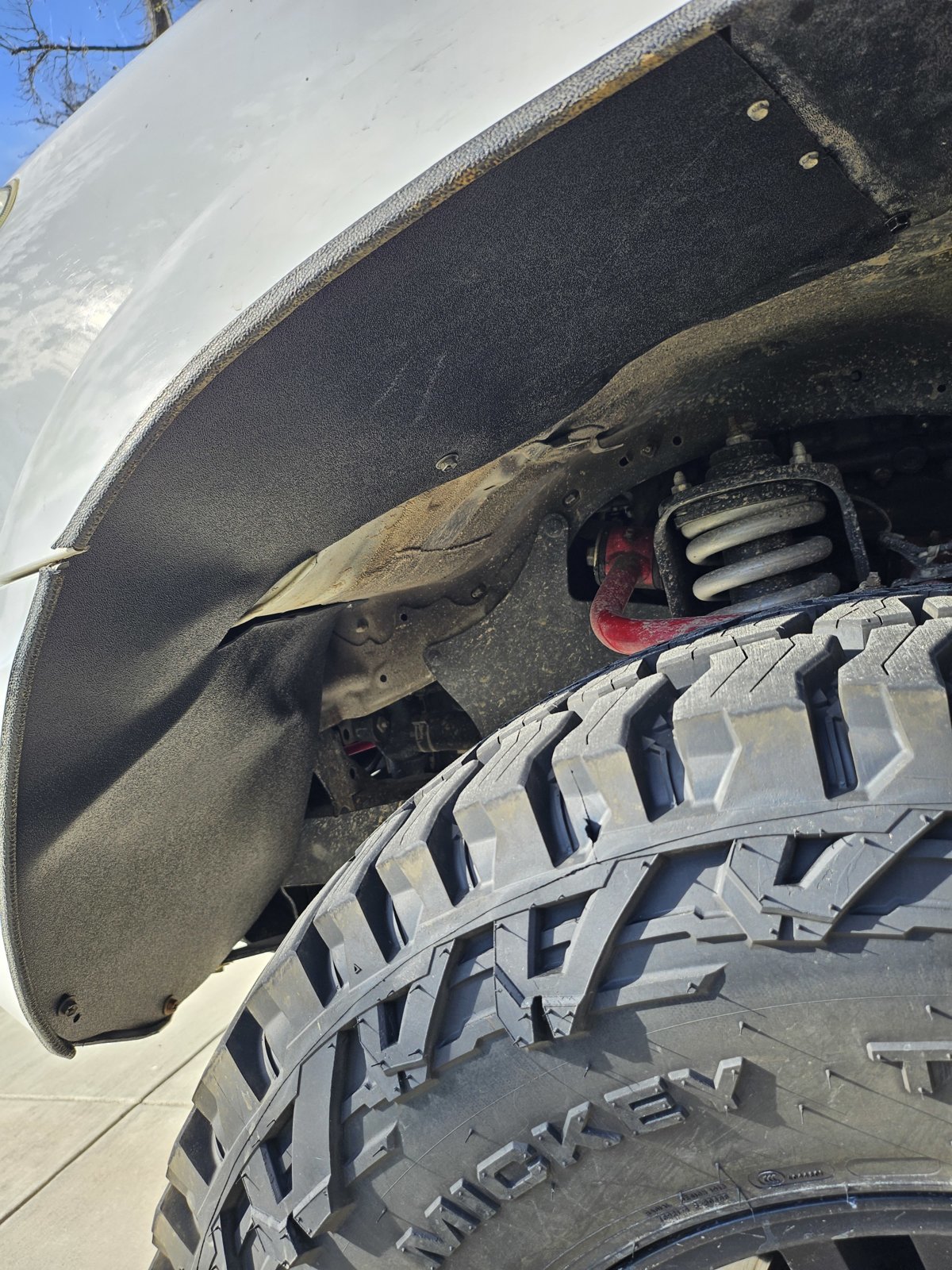

    Made a replacement fender liner. This is my 4th set I've made. The ABS gets pretty brittle in cold so they break snow wheeling. I've learned now to do each as 2 pieces so when it breaks I only have to replace the broken section but I've gotta find a better material to use.

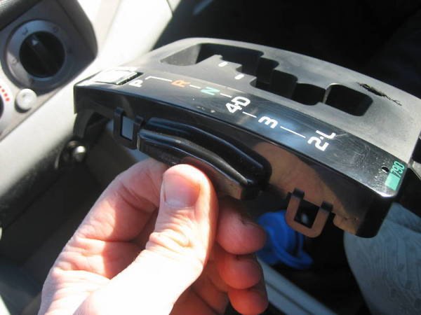

    Does anyone know the part number of the upper position indicator housing?
    thanks

    There’s nothing stamped into the back of it?
