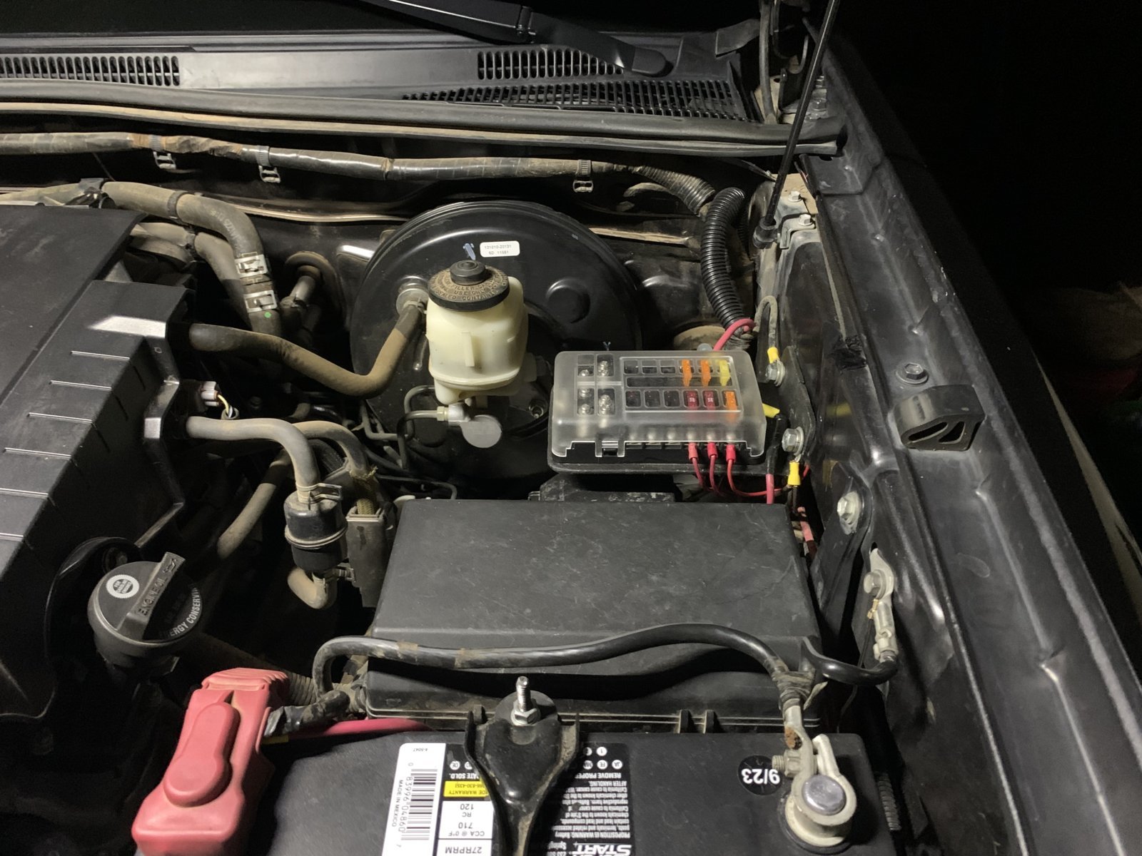

    Well I am glad I looked. I was wrong about the wire length. I must have made it shorter, originally, for the 2012. This wire is now around 5.5" inches long and I used a 5A fuse link although it has never blown a fuse after over 2 years of use. Note that the yellow wire, with the fuse link, is spliced with a pink wire to give it more length. The pink wire end has a long thin blade that is needed to seat down in the socket. I keep a bunch of old car connectors in my tool box and disassemble connectors to have extra bladed wires for such jobs. Pictures taken from driver side of truck. I need to remove and shrink wrap it and get rid of the electrical tape.

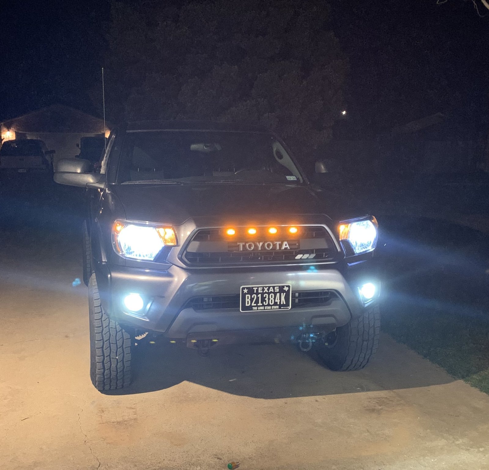

    Mine is a 2015 and they are just on when you press the fog light switch regardless of any thing else. Here is the post I used…https://www.tacomaworld.com/threads...no-splicing-no-bending-100-reversible.309407/

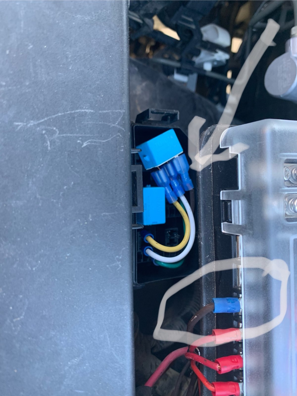

    IMG_3797.jpg Here is a picture of how mine looks at the box, and the brown “Hot” wire you can see also hooking to my fuse box, the same wire.
    You can see how I did it on my 2015 SR5, here is the relay and the brown “power” wire you can also see it plugging into my fuse box, same wire!

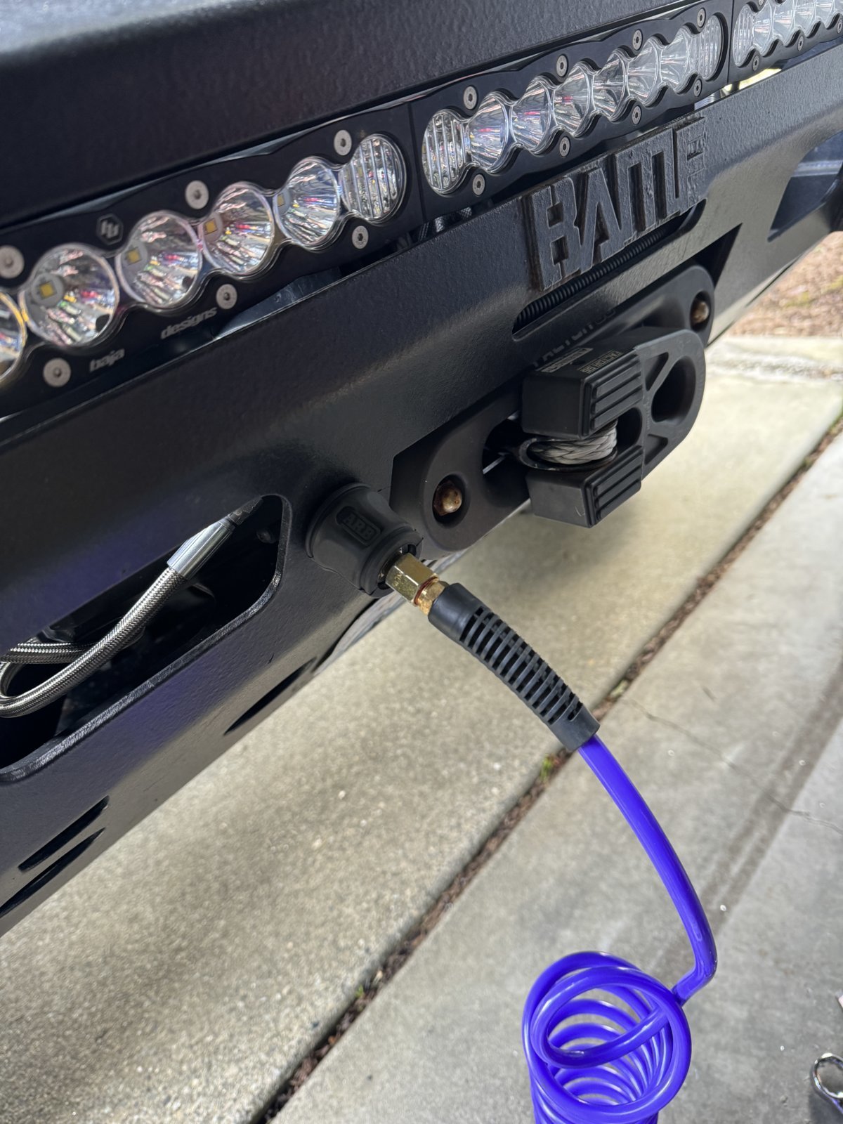

    Extended my air compressor to a coupler mounted to the bumper. No more needing to open the hood to air up.
