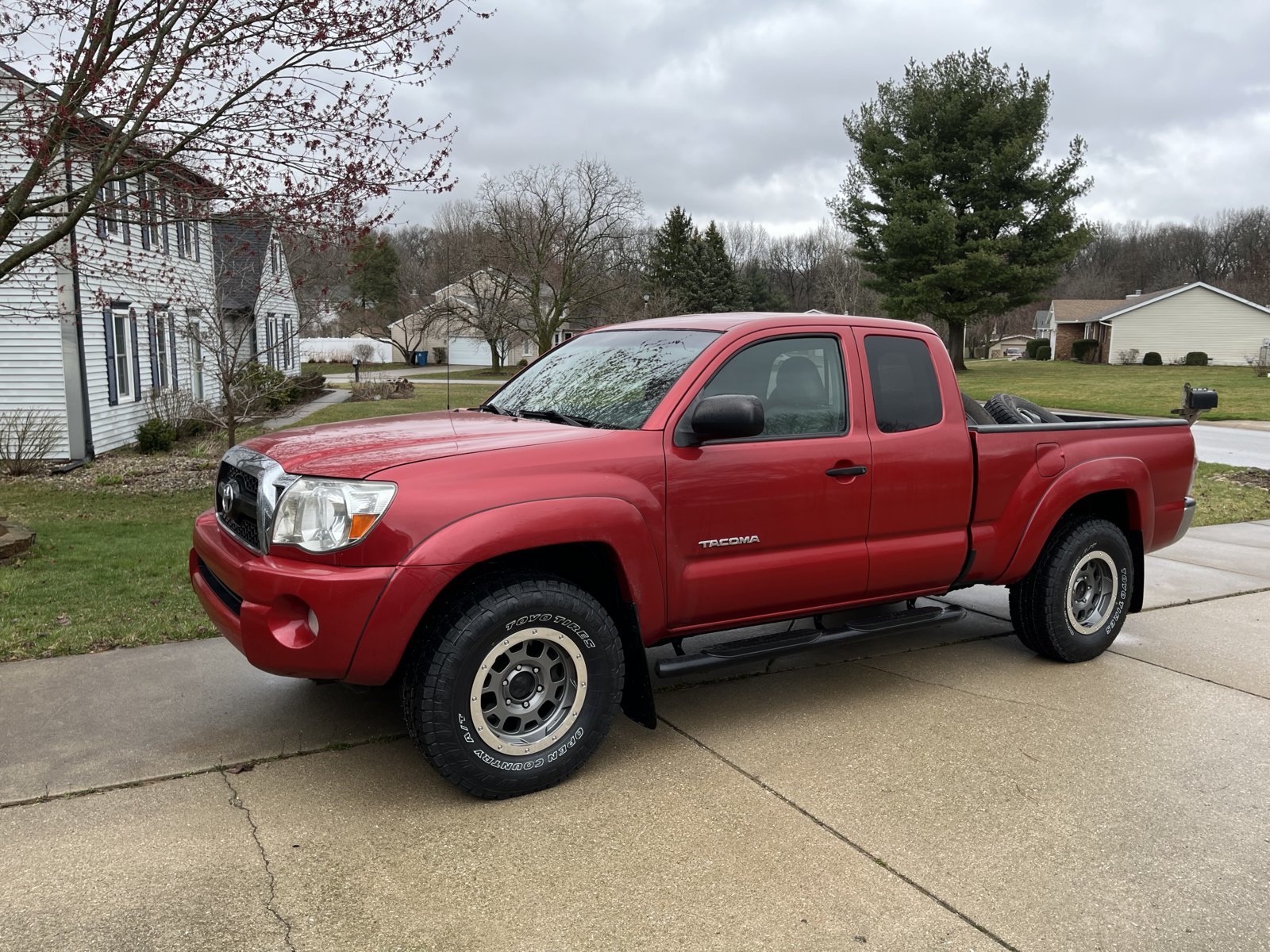

    Finally broke down and bought the 2011 paint matched grill

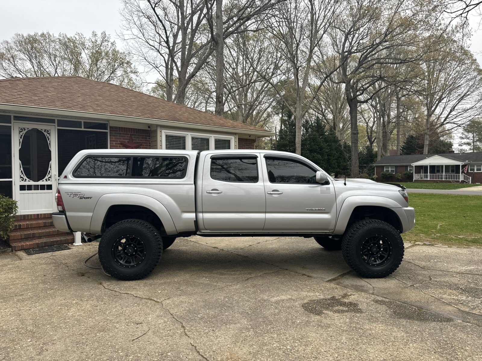

    IMG_1964.jpgBumped up from worn out 285s to 35s today. I’m loving the new stance.

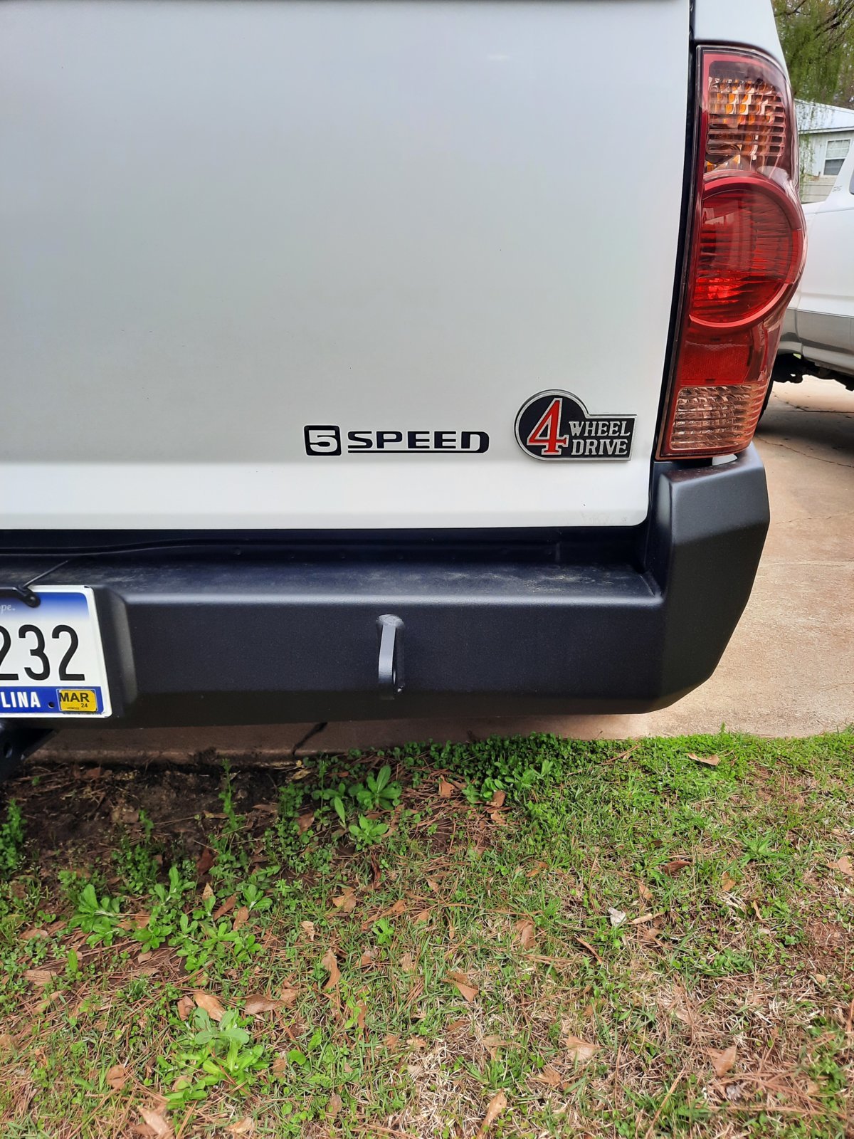

    5 speed sticker for the tailgate.

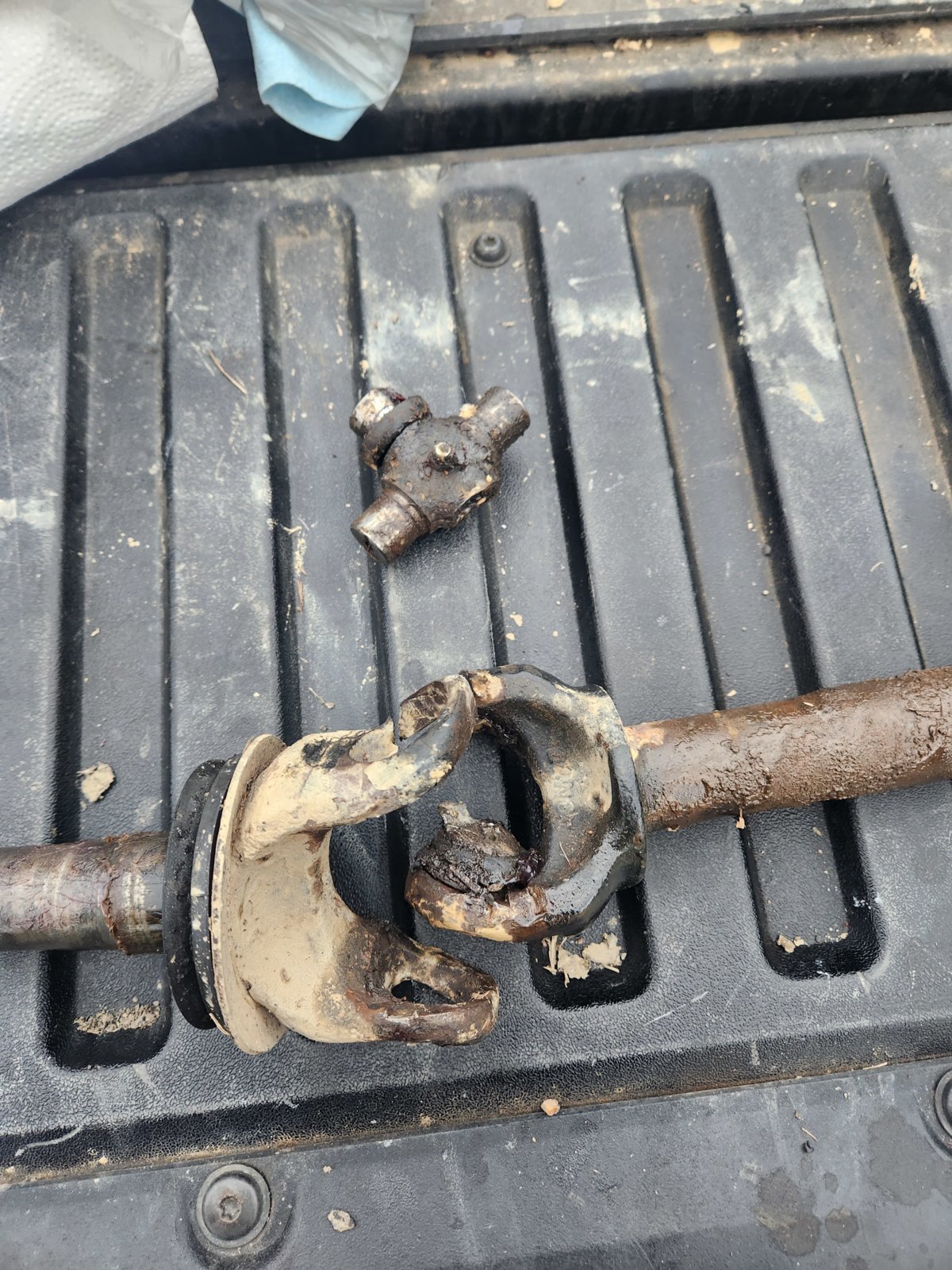

    Had an oopsie
