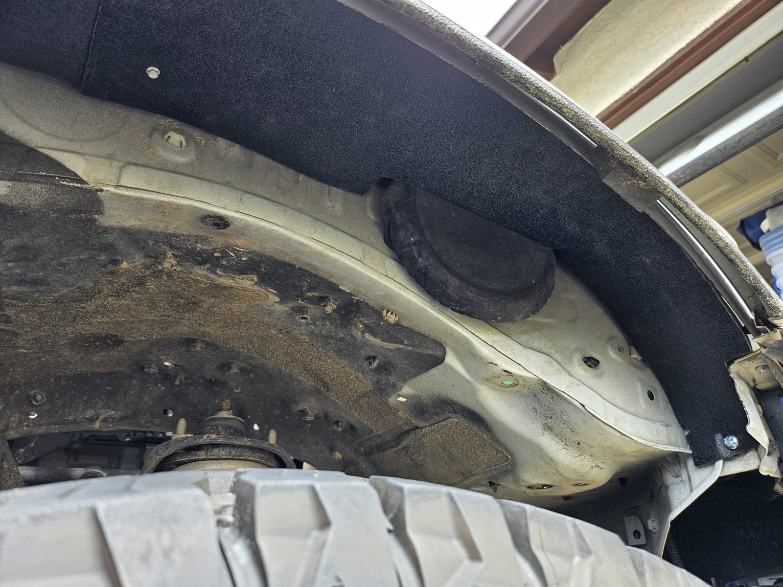

    that looks amazing. How?
    What material? Did you just fine existing holes to use to put screws to secure?

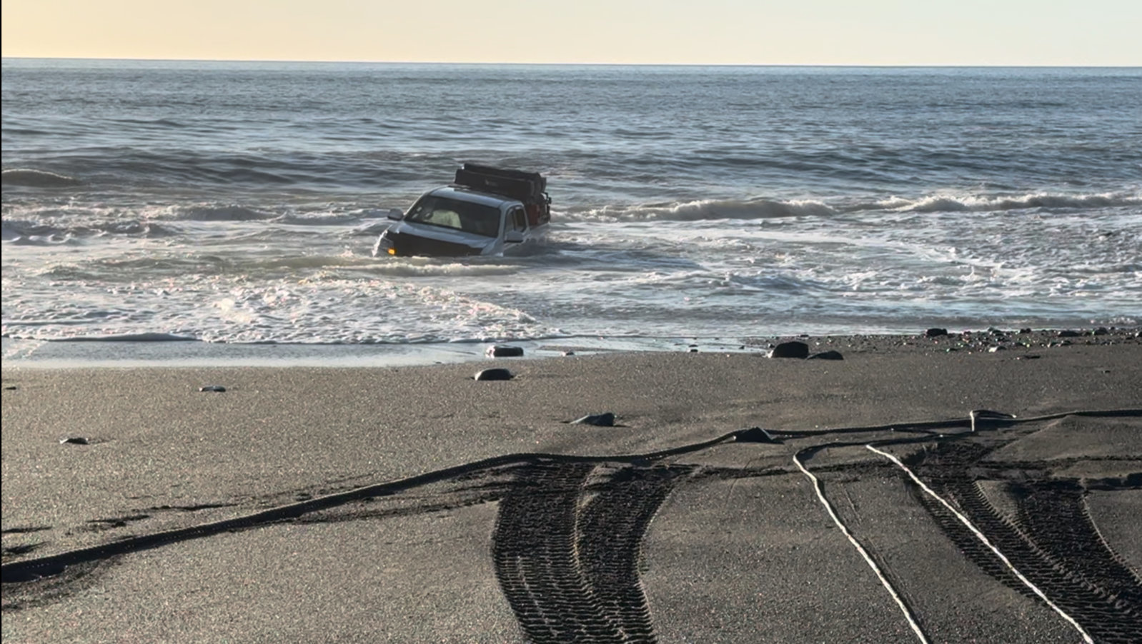

    After having 2 vehicles and all the contents of my house submerged in salt water during Katrina that truck is done for, someone will probably fix it his ins will total it out, beware of a white colorado with a salvage title.
    What I observed during that event (katrina) was anything with a battery power exposed to salt water will start instantly corroding all the electrical contacts, the galvanic corrosion between electrified contacts it's surprisingly fast and extremely destructive.

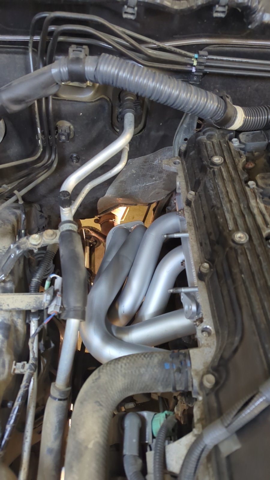

    Installed a lce long tube header on my 2.7 Tacoma on my birthday over the weekend

    noticeable difference?

    I haven't gotten a chance to really drive her around yet. On the freeway home from installing it I definitely noticed more power and ease going up a couple hills that she normally lacks power to keep at freeway speed without stomping on my gas.

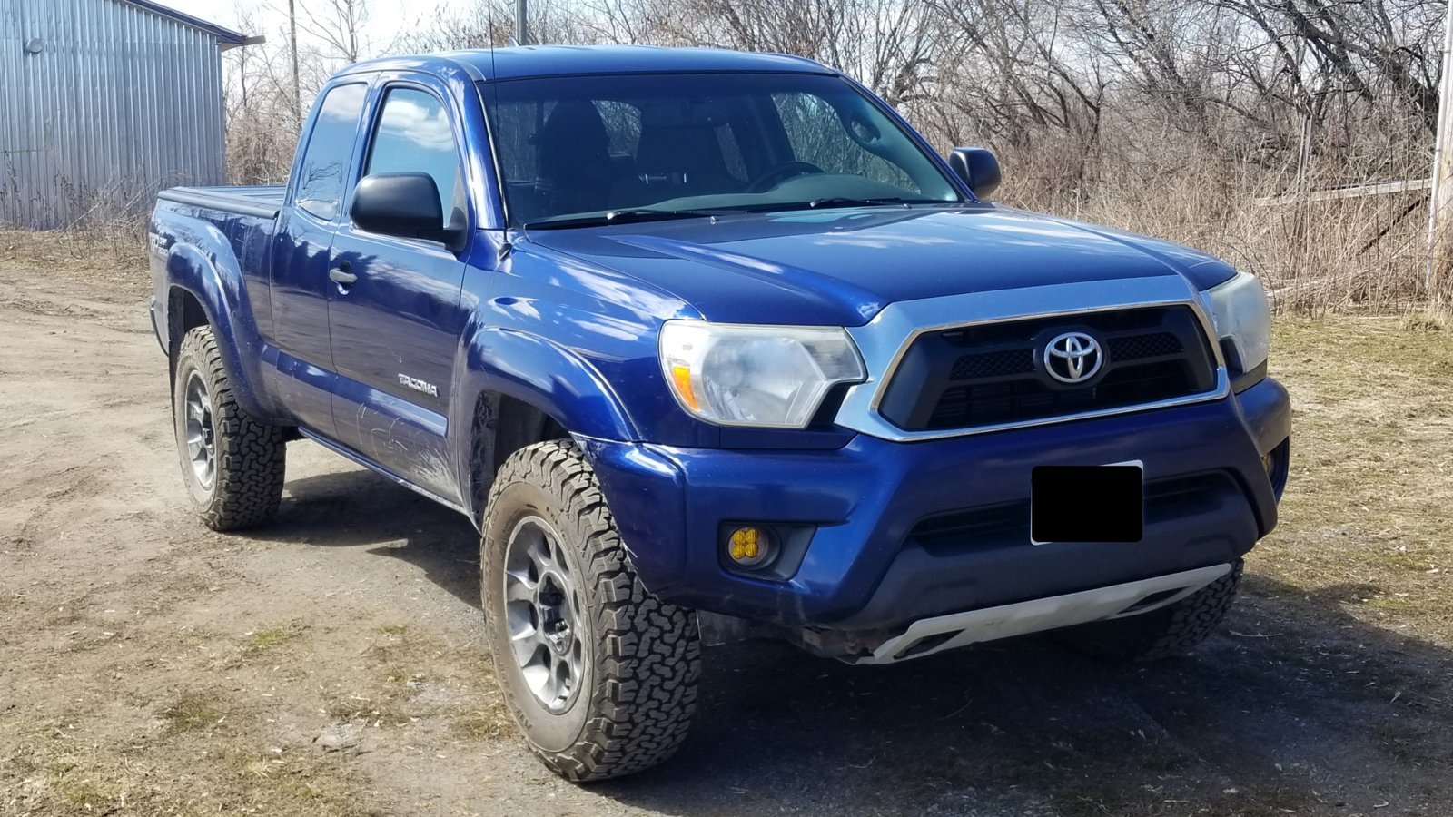

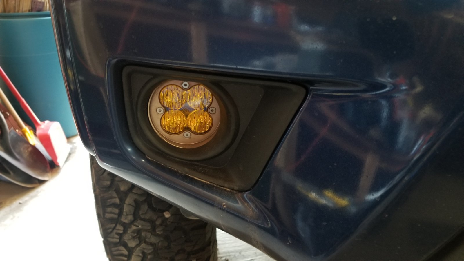

    Hey @SSX999,
    That Blue on the truck is one of my favorites! If you need Those adapters shoot me a PM and I can help you out.

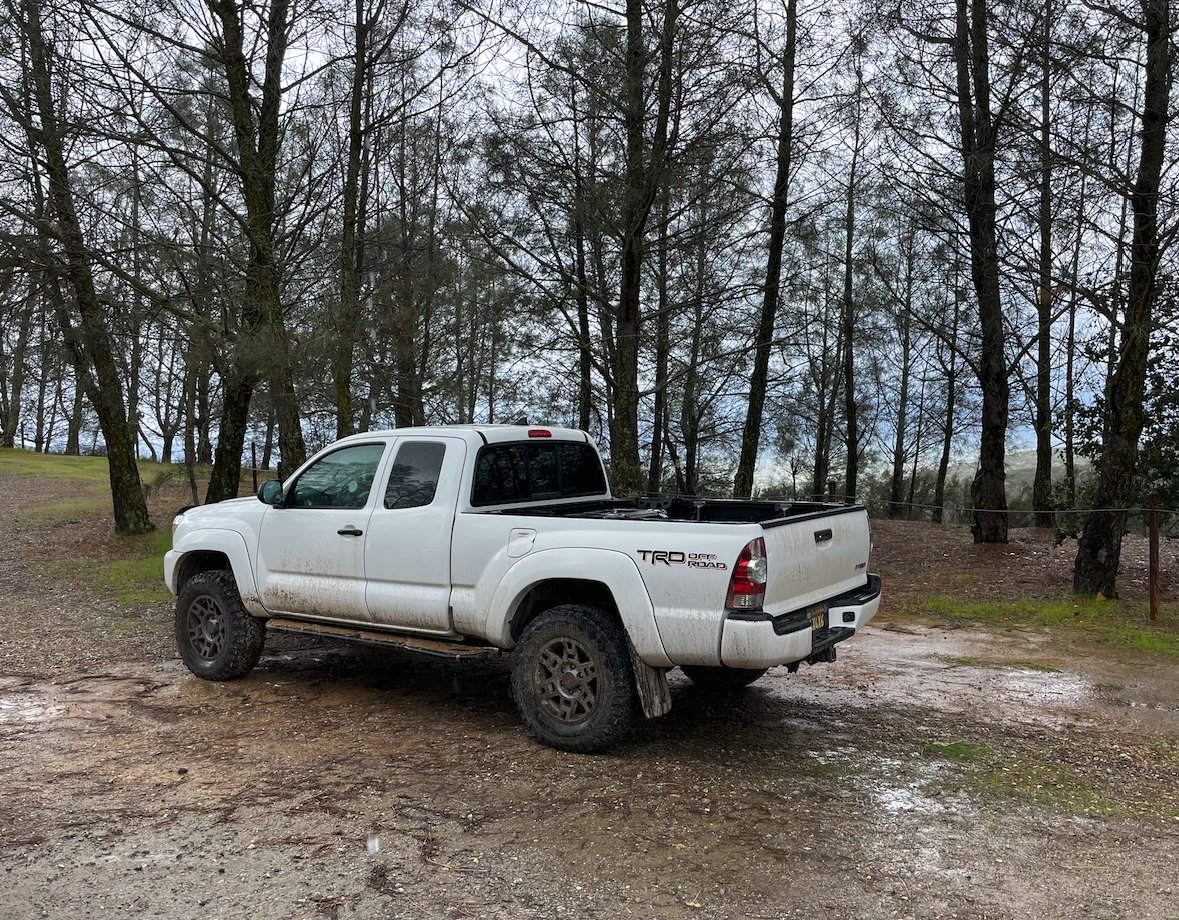

    got her real dirty in the rain.

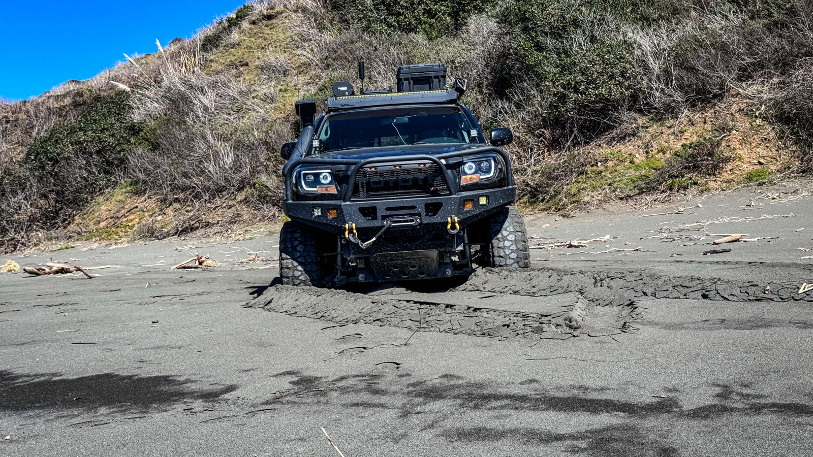

    Damn that sucks. We missed it. Saw the aftermath and thought about how dragging that truck out through the rutted trail will suck.

    I made a template out of cardboard. Then traced it out on sheets of ABS, and cut out with some tin snips. I used existing holes, front and back ends. In the center I used an existing hole to mount an L- bracket amd mounted the liner to the bracket. I cut it so it'd fit snug so it stays put pretty well.
    I've considered both the snorkle or the cowl relocate. I'm more inclined to do the cowl.

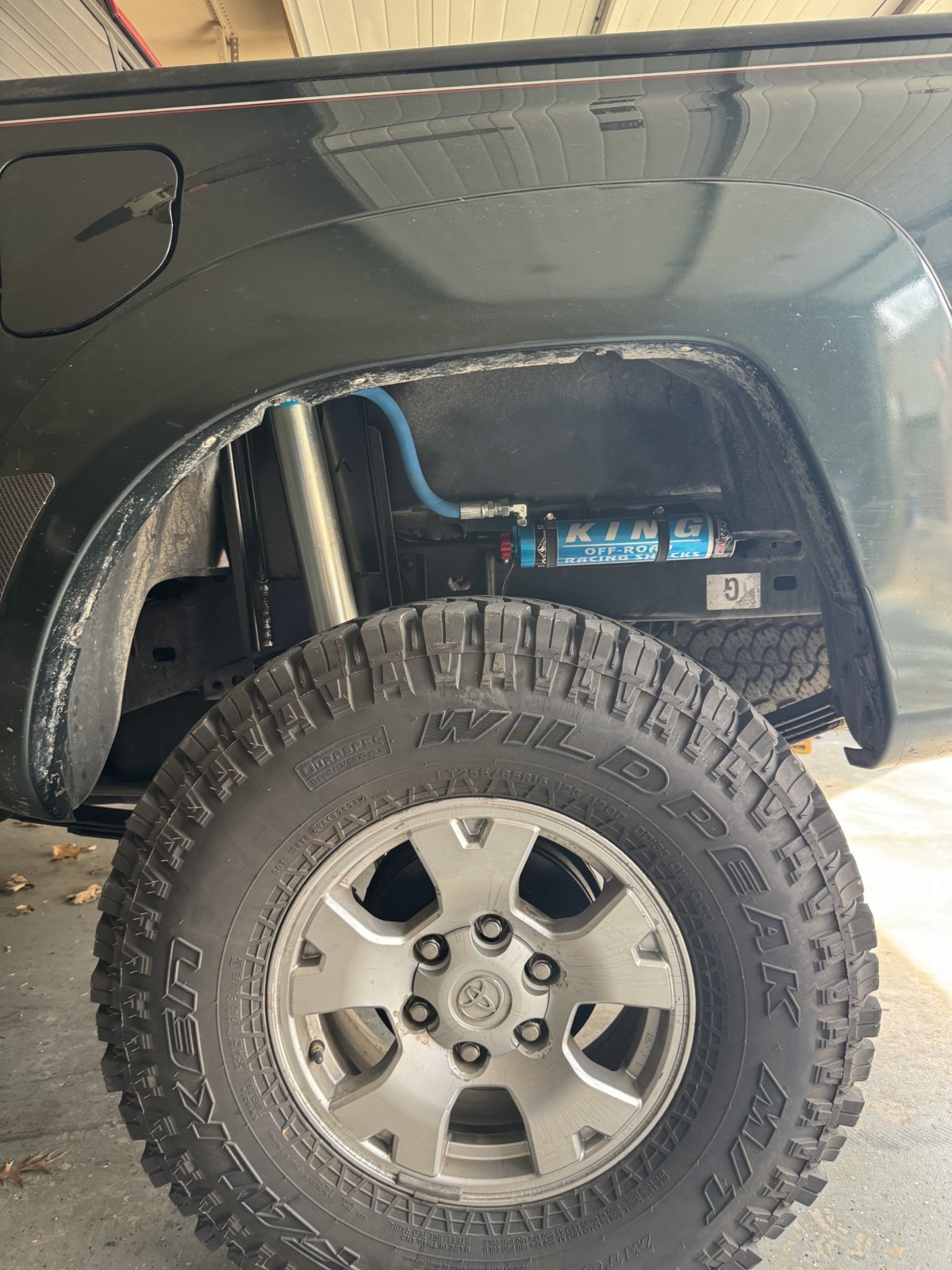

    Dobinson IMS shocks and coils, SPC upper control arms. Archive garage rear shock relocation kit with king 2.5x12 smoothies with adjusters and archive medium duty leaf pack.
    Got my shock relocation on Friday she rides so smoothhhh

    I may need to get one. My 2.7L truck hates the hills.

    You wouldn't be disappointed, drove several windy hills and freeway long grades yesterday. Definitely quite a bit more pep in her step

    Nice looking white even when dirty!

    looks like tall skinny 33”
    Did you have to add spacers to clear the relocate on compression?
