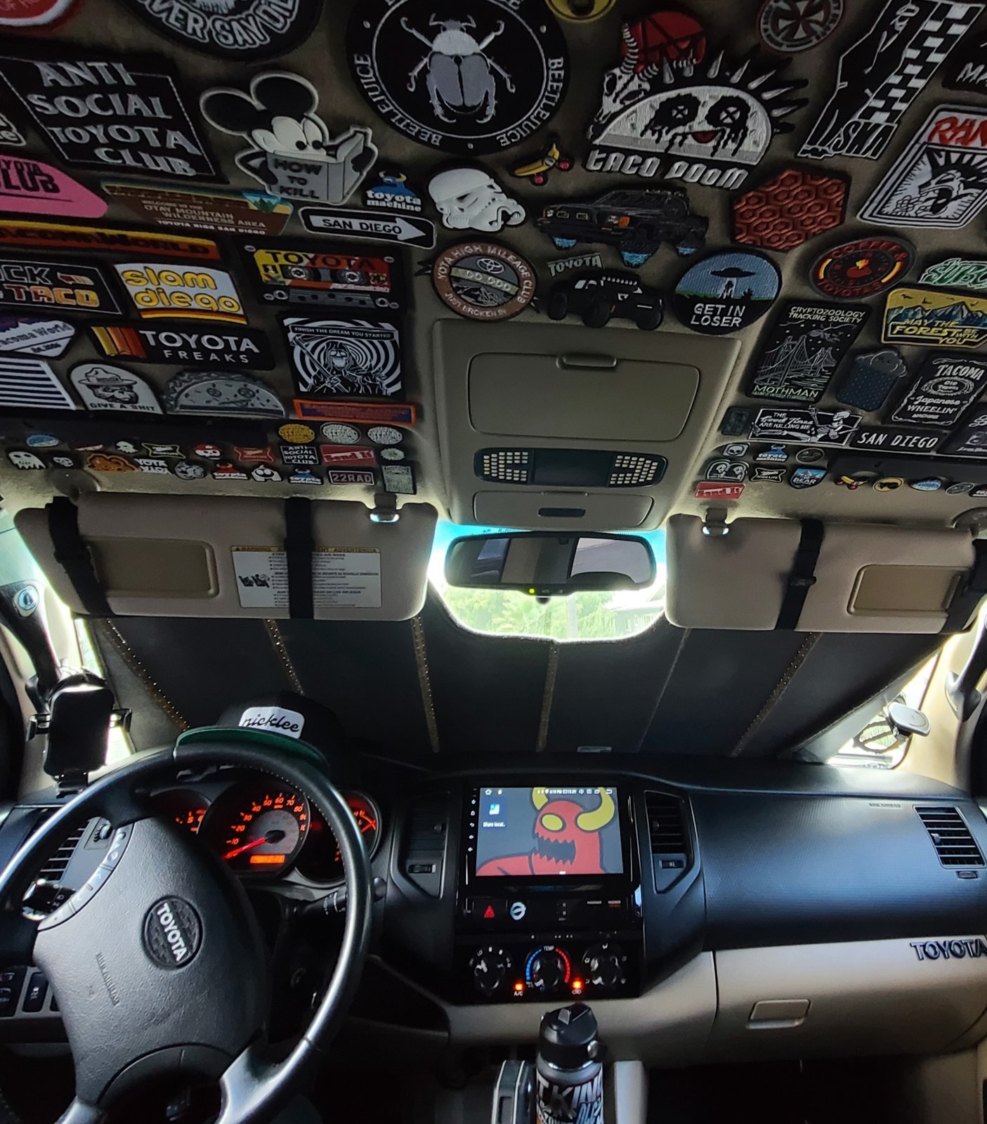

    Changed the wallpaper

    is it cheaper to full patch the headliner
    Or wrap it in black suede lol

    Definitely black suede. But I'd still slap a bunch of patches up there :laugh:

    honestly don’t even know if patch would stick onto black suede the same way it does stock whatever fuzzy carpet type stuff they used.
    apparently there’s complaints about 3rd gen headliner not accepting patches being slapped on due to the different fabric.

    Never tried it and I can't guarantee it, but I feel like suede might get along with the hooks. When it comes to 3rds gens, alot of owners report back to me that they only have issues with some patches. They're able to get most of them up and stay there. You definitely have to work a little harder to get em up there vs the ease of a 2nd gen headliner

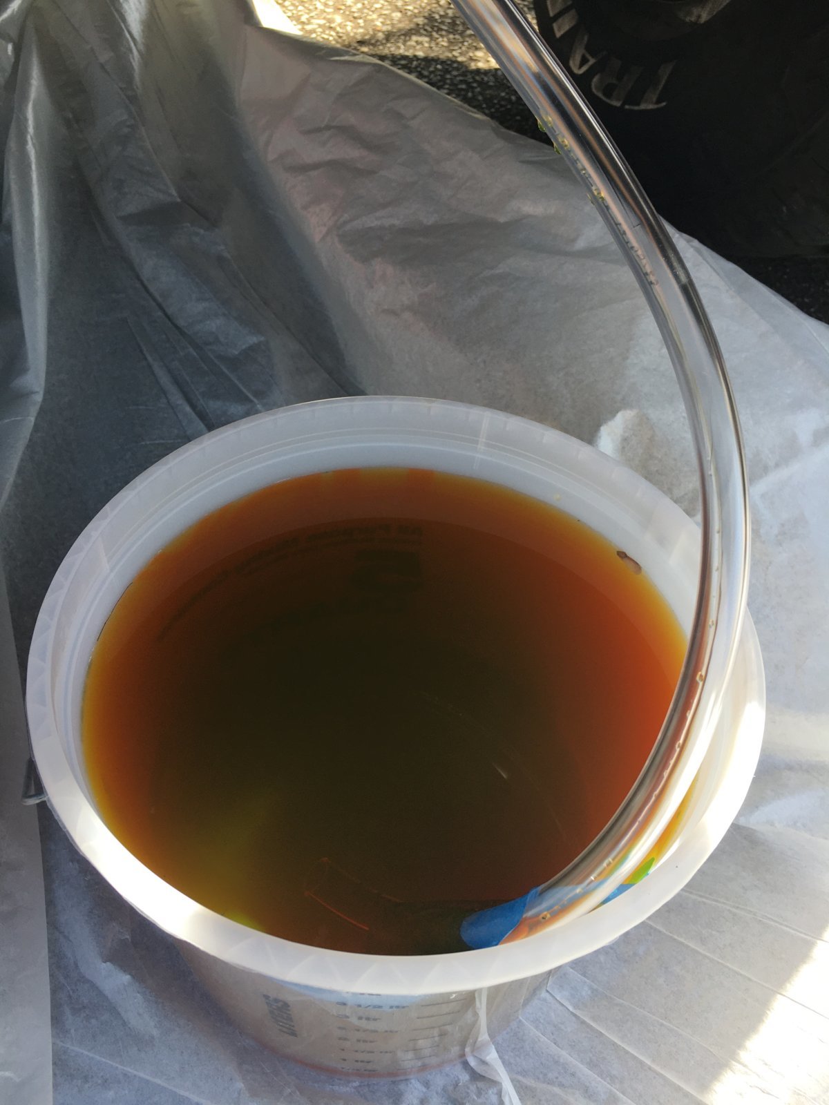

    Today I Discovered that I need to do a full coolant flush in the truck I purchased last week. Green + brown = bad.

    green?
    i hope you're not putting green in it
    typically toyota coolant is pink
    (of course maybe they have a green universal now IDK)
    [EDIT, well hell i don't know now. i tried finding a definative answer and literally it was 50/50, mixing is ok, mixing is bad]

    No, the previous owner did. I just bought it a week or so ago and have put about 200 miles on since, i’m sure they “topped it up for the sale” or whatever.
    Distilled rad and block flush now, then will replace with pink Peak.

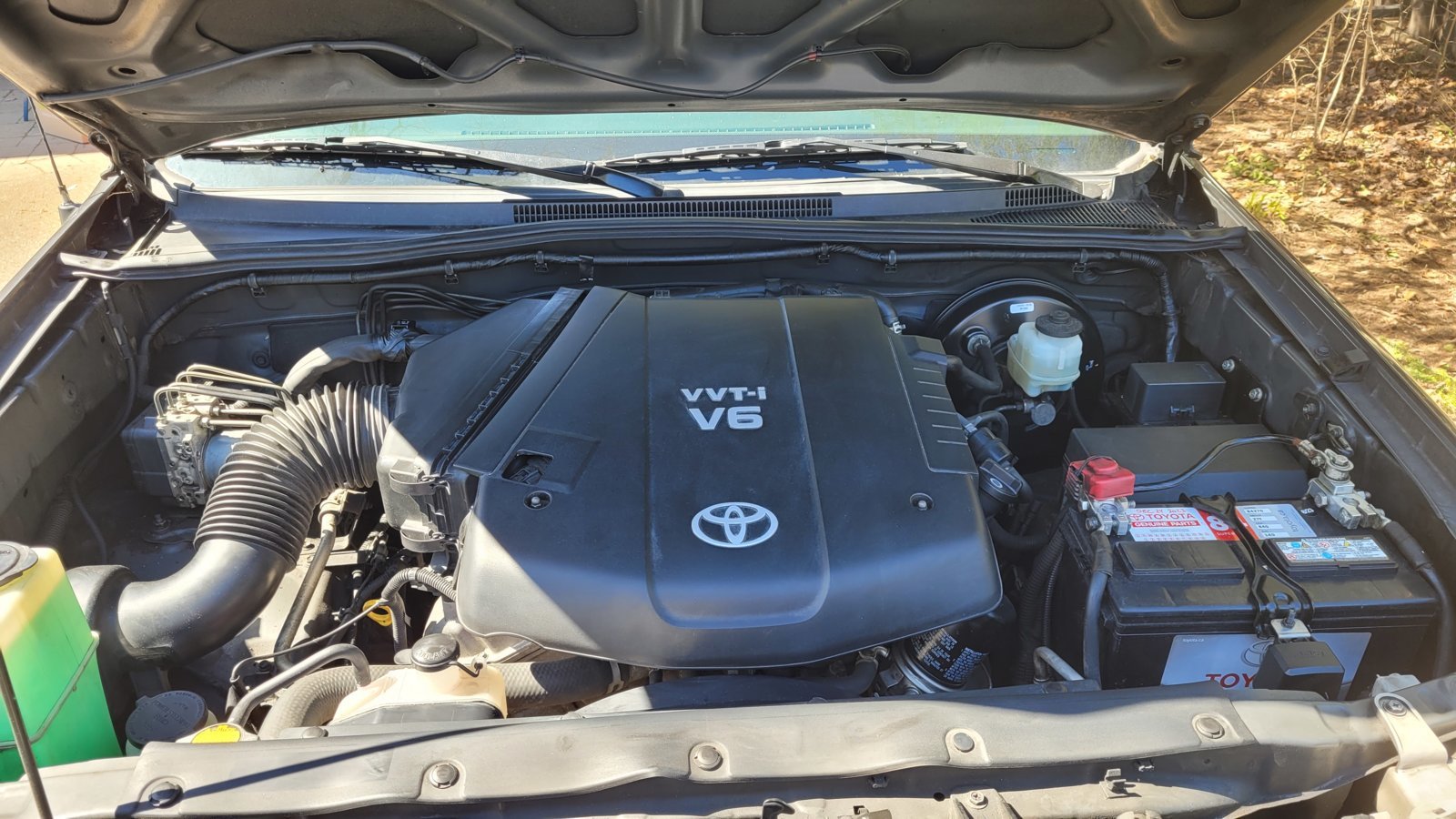

    Waiting for a buddy to come over to change from winter to summer tires.... so cleaned up the engine bay a bit.

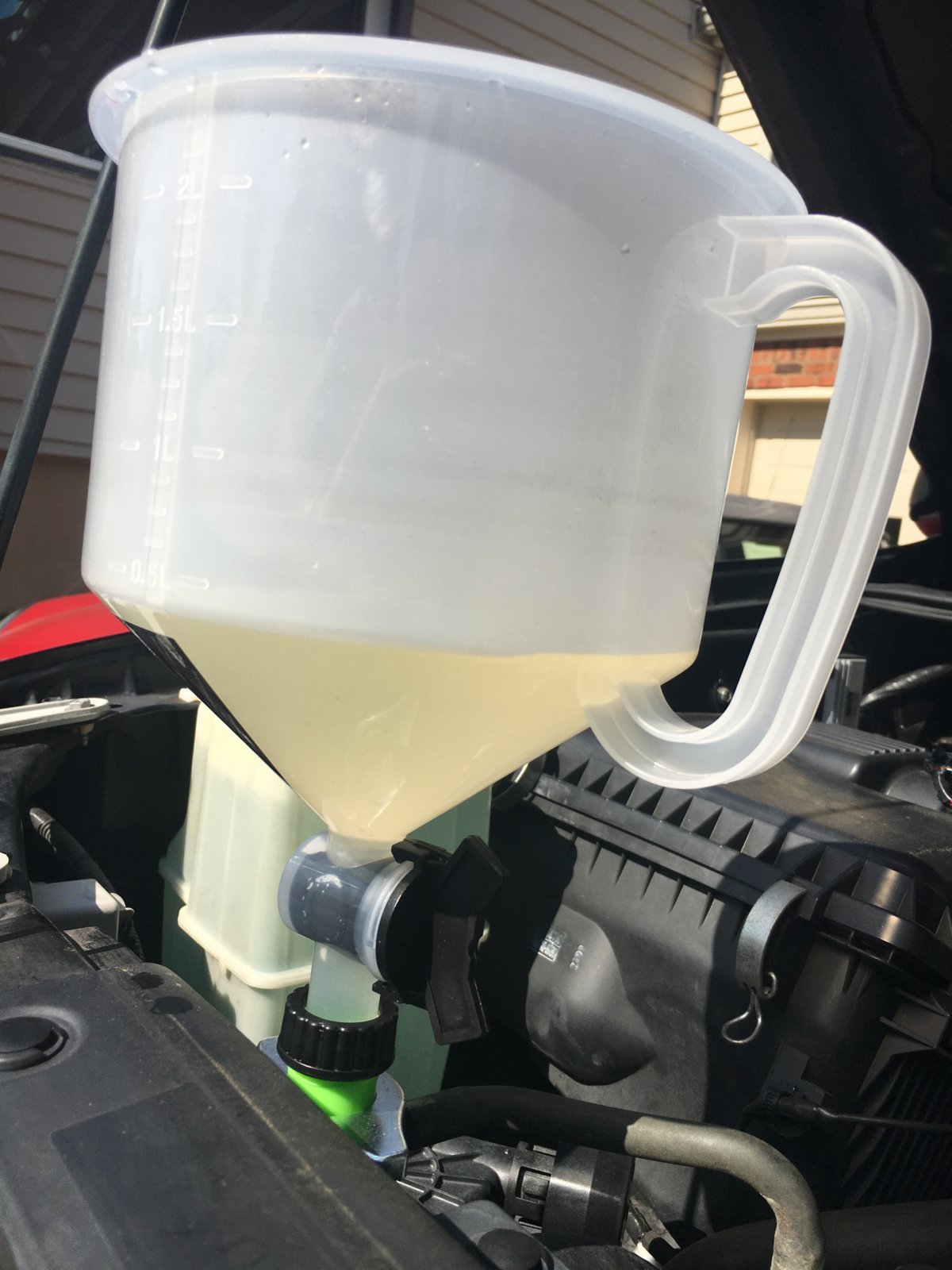

    Think i’m calling it quits after round 3 of distilled.

    I think I ran like 6-8 gal of distilled water thru mine before the discharge was almost clear. As long as your waiting for the thermostat to open, running your heater to get full circulation and what comes out of the drain is clear or nearly clear - you should be all set. You’ve got the right setup with that funnel system to ‘burp’ the air out.

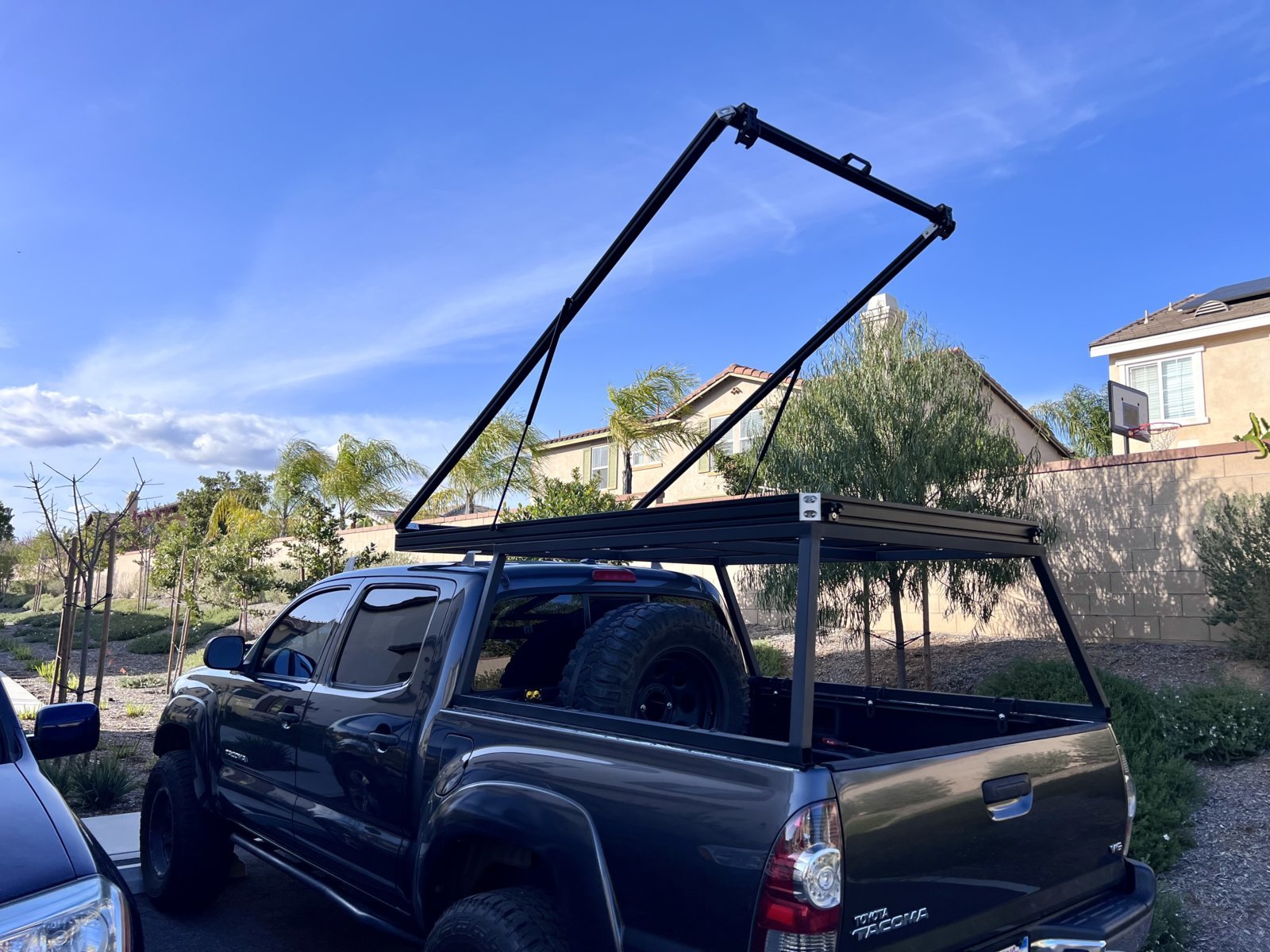

    We’re making progress!

    I was about 6.75 gallons of distilled. I did drain the block each time as well, definitely didn’t think I could get all of it out from the bottom of the block but it came out looking pretty clear at the end (not perfect though but good enough for me).
    I did not have any concentrate handy, so did all 50/50. I’ll pick up a quart or so of concentrate this week, drain just a quart or so from the rad, and top off with concentrate. I’m sure there was about 2qts of mostly water in there prior to coolant fill.
