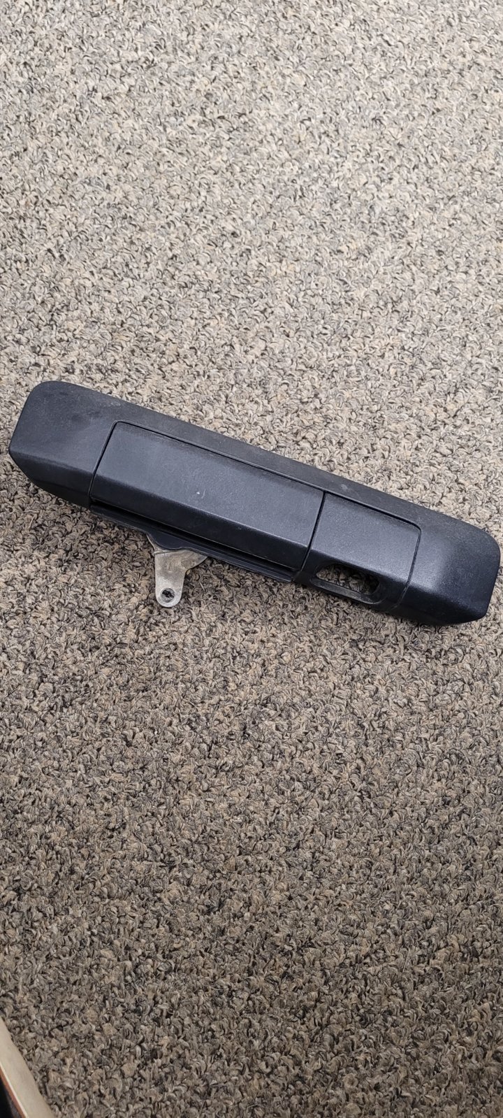

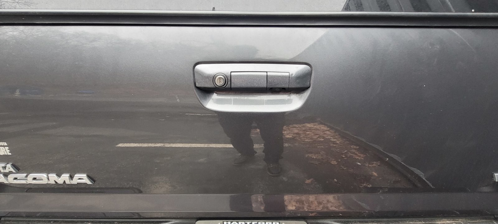

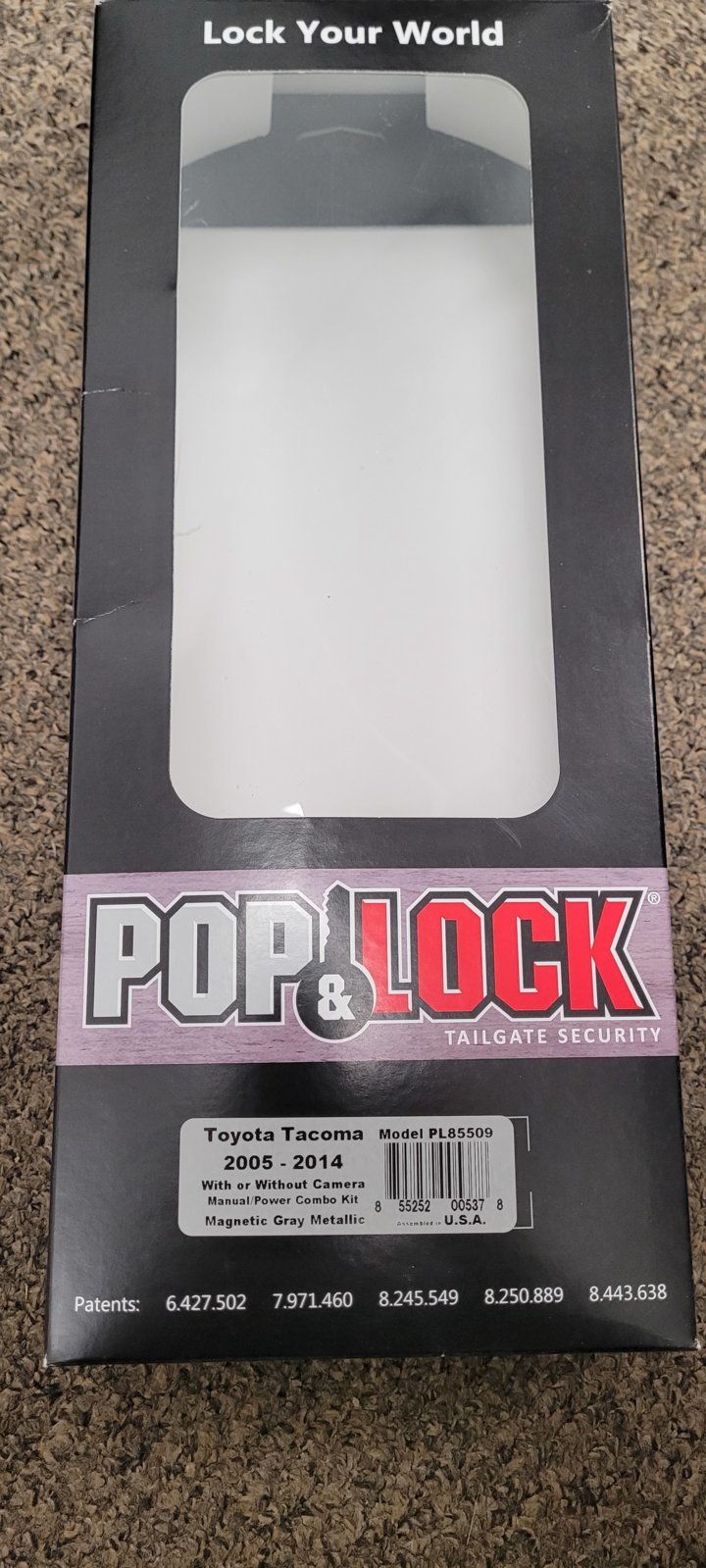

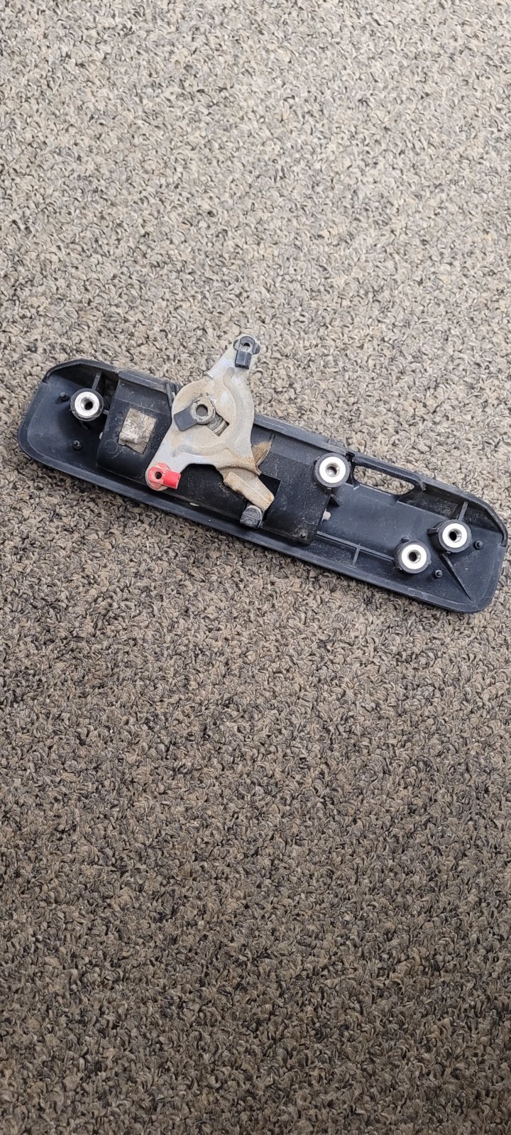

    Very nice, Pop & Lock was my 2nd mod after installing the bakflip, although I only got the one with the manual key lock, i just ordered the add on power lock as I quickly learned it was a hassle having to grab the key everytime I needed to get the stroller out.

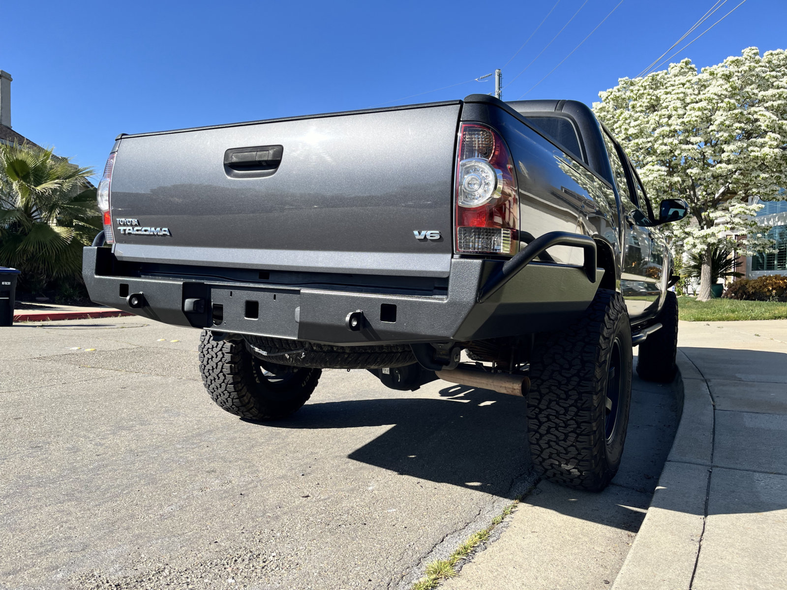

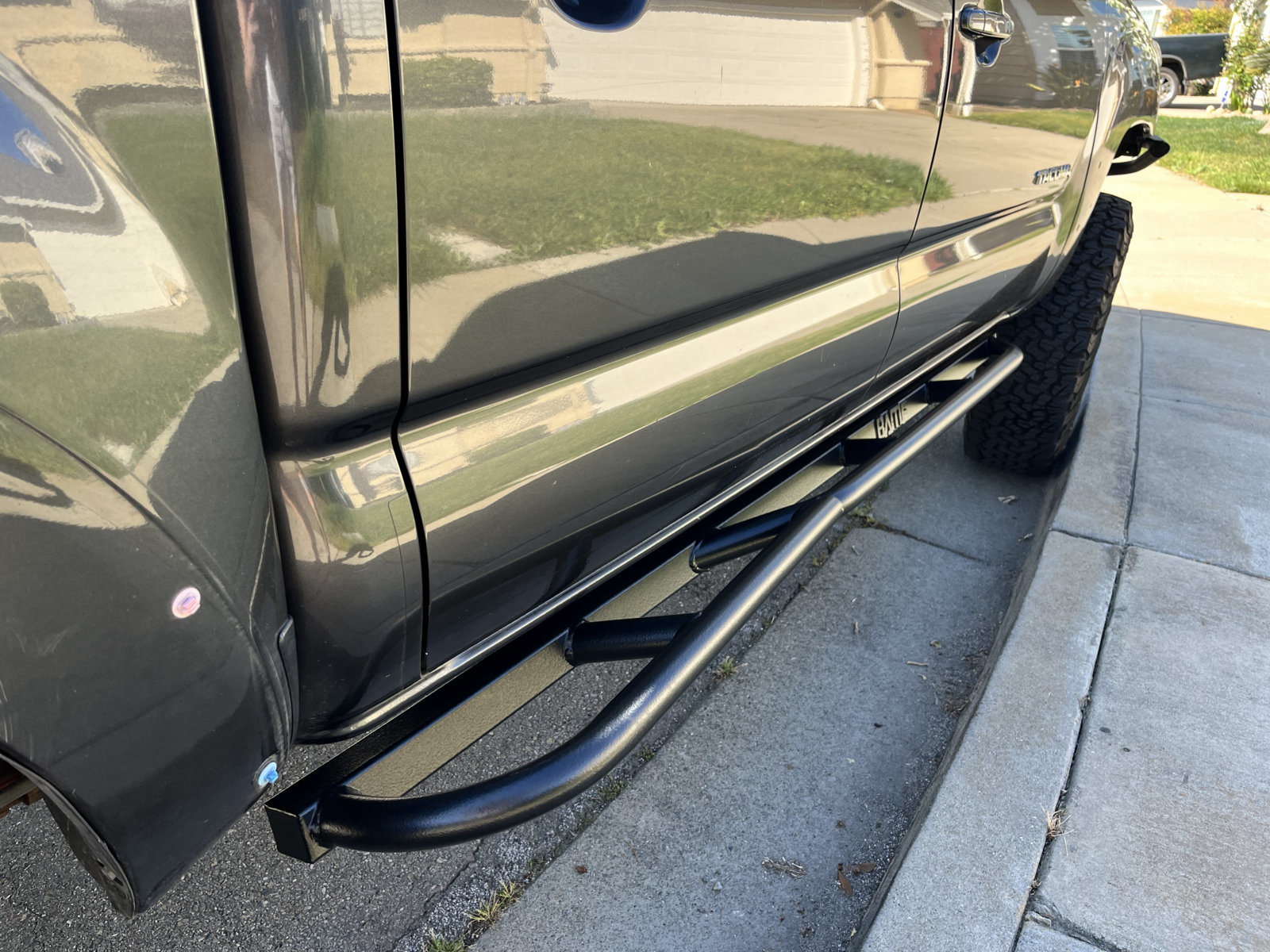

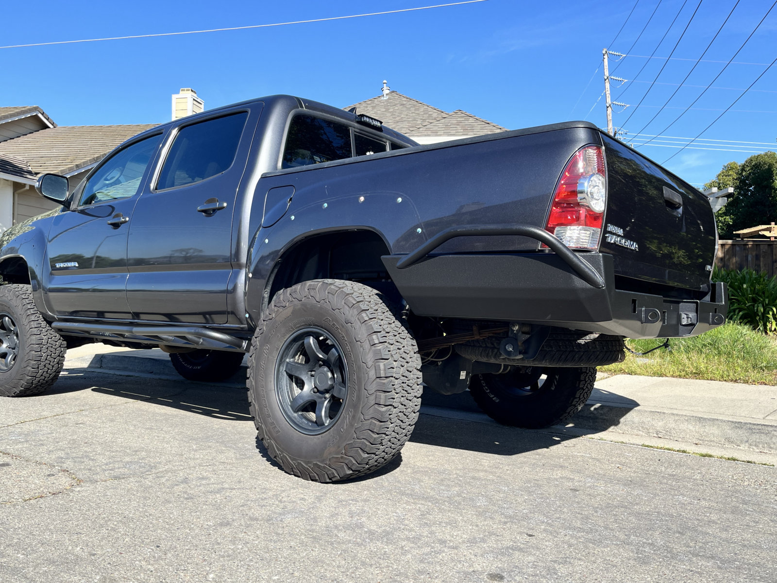

    Nearly blew out my back dropping in BAMF sliders and rear hc bumper solo. Trying to decide what to do with the spare.IMG_1665.HEIC.jpg IMG_1663.HEIC.jpg IMG_1664.HEIC.jpg

    found my sliders easier to take on/off laying on the floor
    brace up with my knee
    final assembly jack up at center
    than when I did it on a lift
    HC rear well that was just tricky to get straight. IDK if it's straight now.
    spare? Well, you can:
    -run it stock
    -roof rack (probably not a good idea)
    -tiregate
    -swingout(s)
    -mount in bed in my case not an option have sleeping platform
    -run no spare, have patch kit. Don't know if this is smart
    -figure out how to run it on the hood like old Land Rovers do and see even less
    -make a bed rack that lets spare mount at the rear which is higher up more out of the way than a swing out and potentially the same cost as one. Could be easy to make, clear a topper, and give left/right/top mounting surfaces.
    Archive hammer hangers w/ crosstube might block the spare
    Dirt King came out with hangers that claim their crosstubes are out of the way and don't block spare but I imagine it does not compare to Archive
    here's some info in case you're going down this route
    the fender delete
    -those holes can be made to look nice with engine bay dressup bolts
    -lights can be added. I bored out some to put side markers. Might bore out some more to put side turn signals
    fiberglass or bushwackers are probably better and the same can be done, but am not about to spend that kind of large money right now for 0 reason.
    first time I'm seeming that third brake mounted on a 2nd gen
    got any more pics of it in action or night shots?
    might as well chop that exhaust now that there's an HC

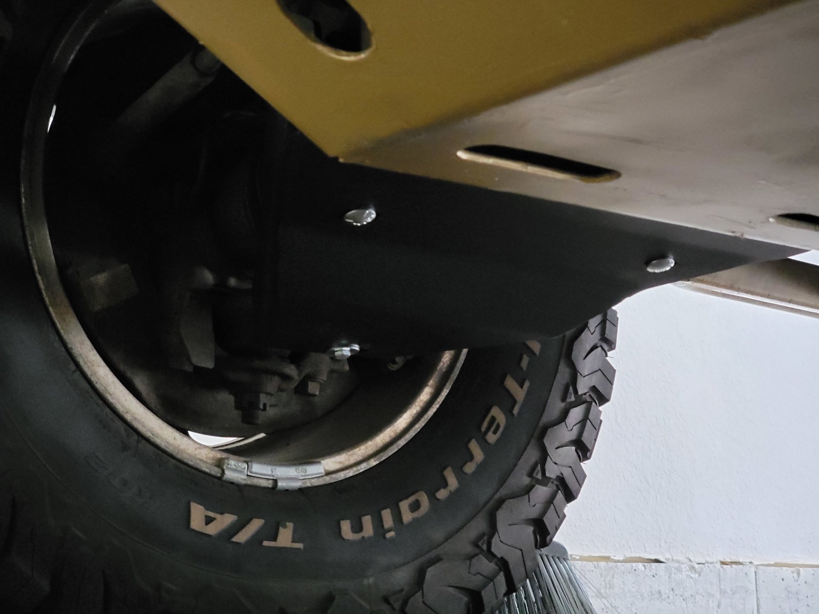

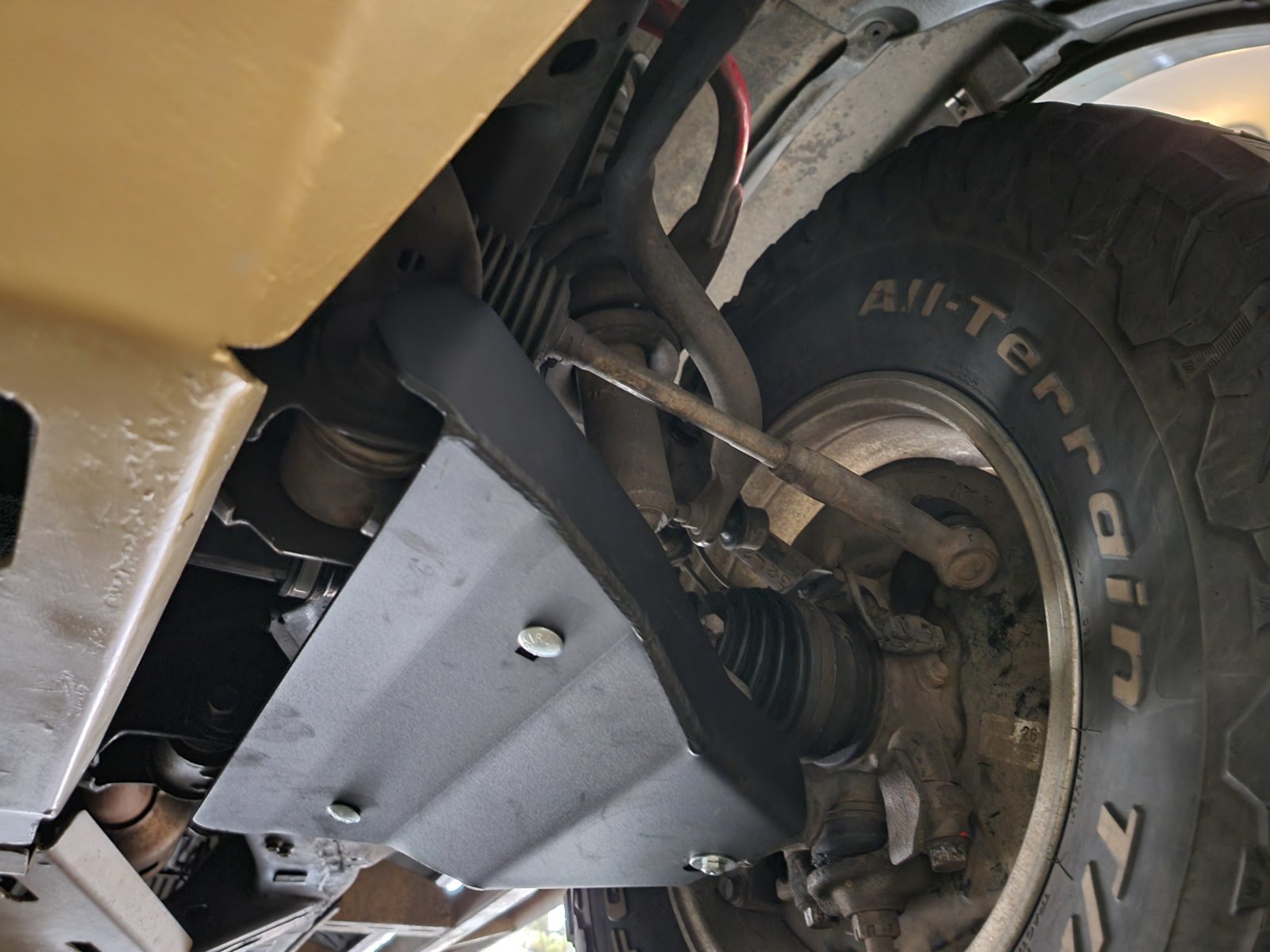

    Added some armor.

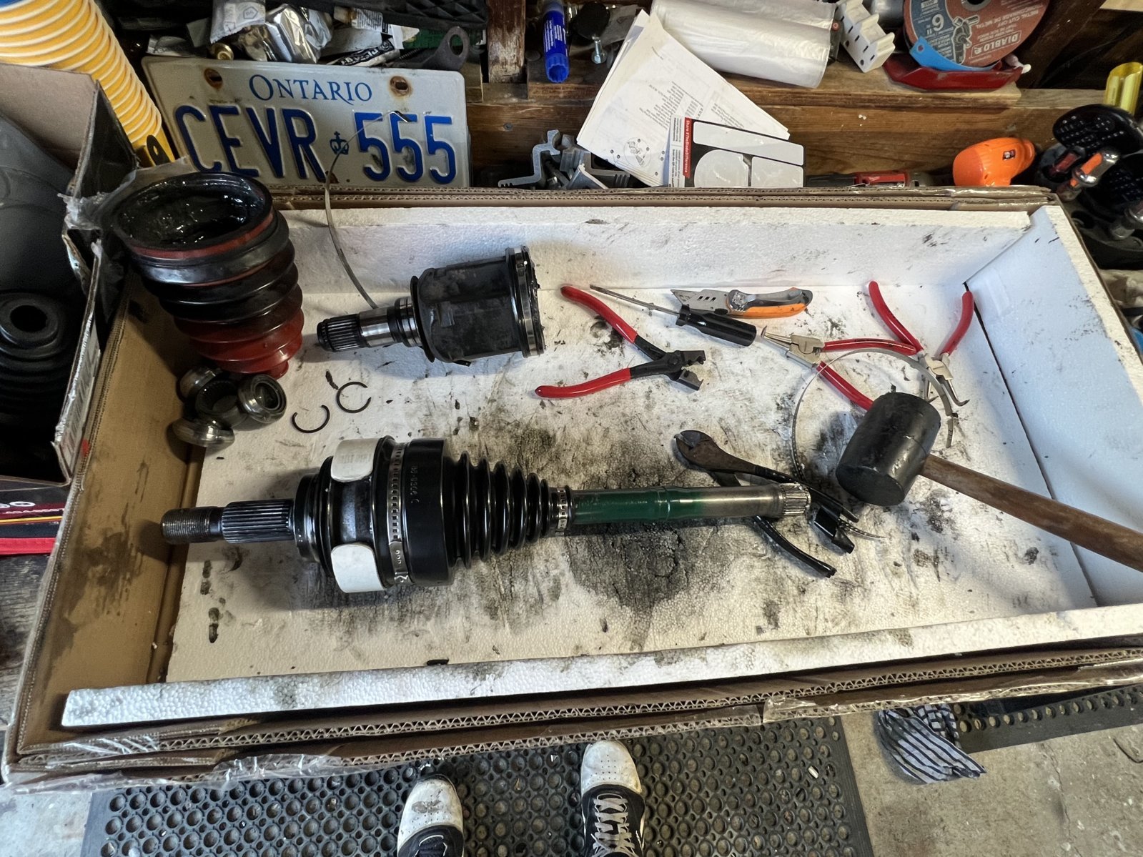

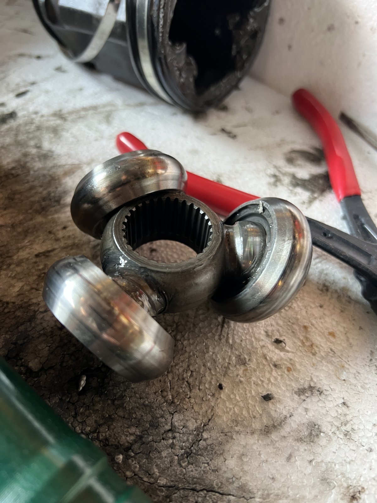

    Got a link for the boots?
    I find it the same price of just getting a new axel. 4WA here in Edmonton warranties the "World Parts" ones for life. And I have a mechanic that charges me $60/hr for 1 hour to replace it. Drop it off at his shop/garage, have supper at home, then go pick it up. So easy and very reasonably priced haha

    why?
    LCA skid is said to cause internal rust by plugging drain holes. The LCA can be welded to strengthen it
    bolt on diff skid reduces clearance and $300 vs weld on $50 trailgear

    I didn't want permanent, I treat my undercarriage annually with fluid film. And I have already hit both a-arm and rear diff off-road. I plan on getting bigger tires and that will negate the slight loss in clearance.

    hopefully the LCA doesn’t rust I guess. Or fluid film inside before skid. Water might be able to get in but not drain out the bottom. Then again a hole could be added.

    BAMF diff skid is minimal- total loss of ground clearance of no more then 5/16".
