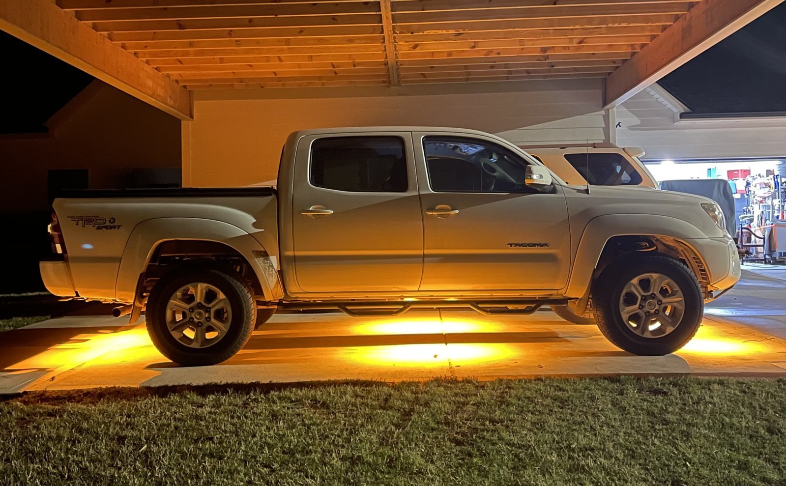

    Don’t have a Mall where I live but I added some Mall crawler lights just in case they build a Mall here one dayIMG_0559.jpg

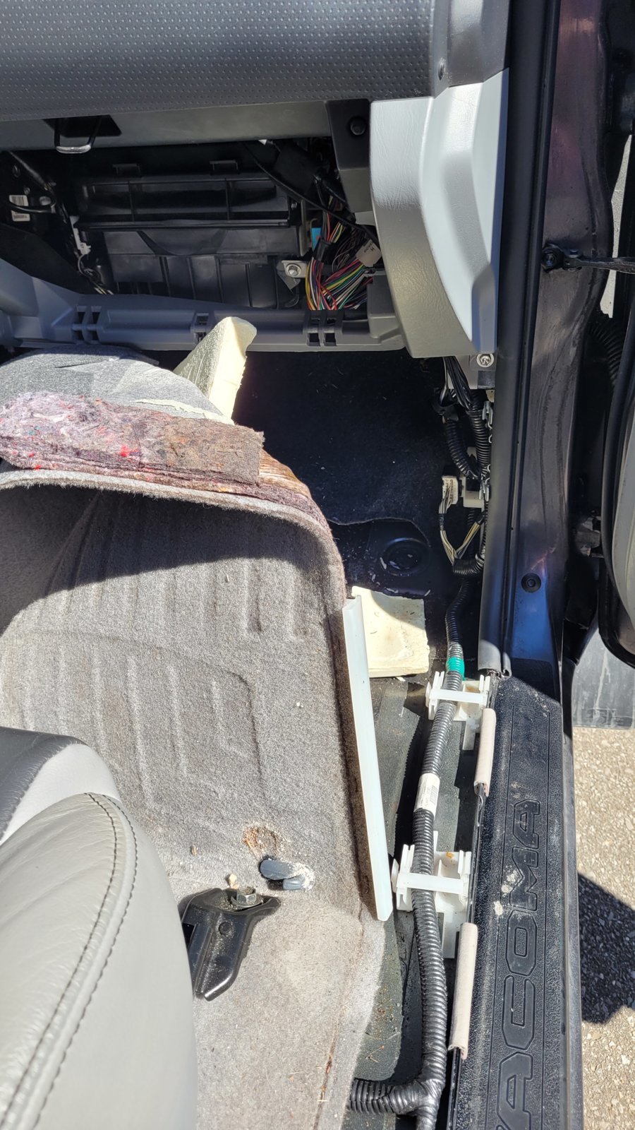

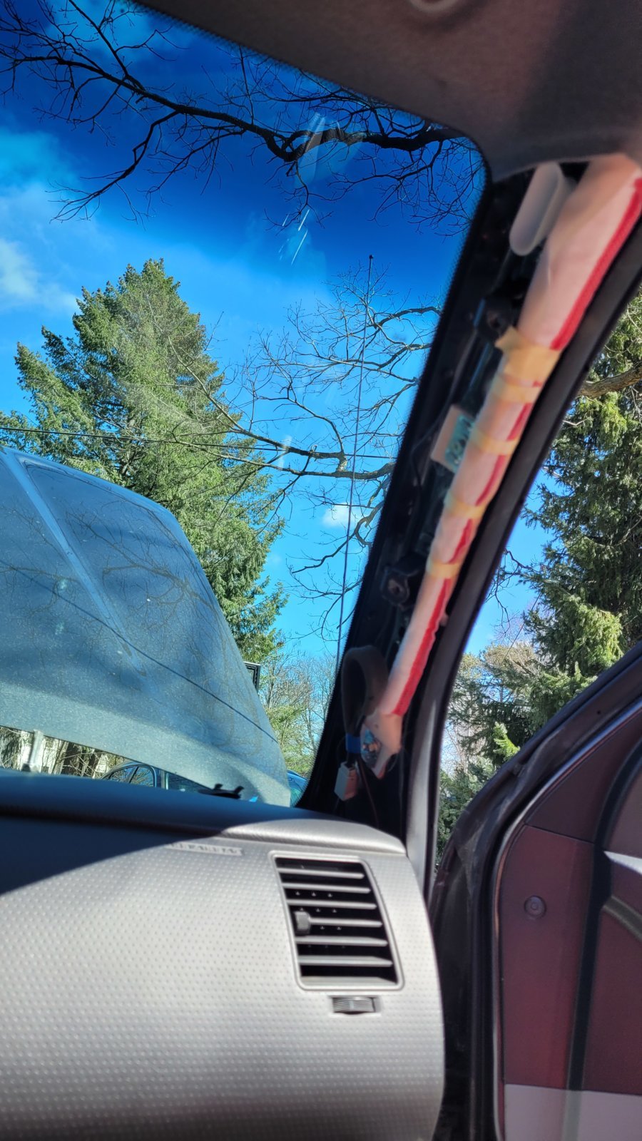

    Trying to track down source of wet passenger carpet. Cabin air filter dry. Pillar dry (I have a factory roof rack). Drain running from cowl to lower rear of front 1/4 panel pretty clear. Truck has sat for the past week, rained a lot, and did not run, so nothing to do with A/C drain.

    1. there’s probably a TSB to replace your cowl. It’s $400. I’m gonna use tape.
    2. pic shows you don’t have a shield over the HVAC duct to redirect water. Folks generally DIYd that until PELE recently came out with a bolt on 3D printed kit
    if you don’t already have that taken care of to rule out and address known problem areas kind of pointless to skip into interior tear down diag.
    Especially if the truck doesn’t have other potential suspects added like snorkel drilled holes. I painted mine but should probably go back, redo it. Abrade, POR15>paint, then put new rivets lathered in silicone.
    beyond that I’ve *heard* the thin metal around the HVAC intake can develop cracks that let water in, to be fixed by lathering seam sealer. But don’t know how that would be tested/confirmed and find exact area of crack IF that is even the case.

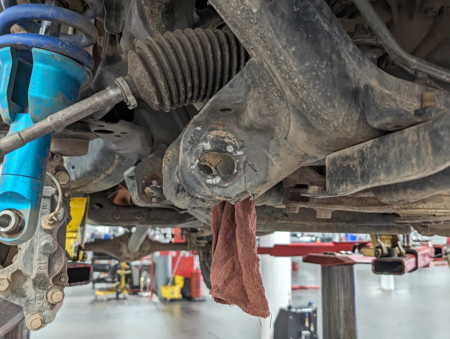

    Welded up some total chaos alignment tabs today so I can continue to bouncing off of rocks

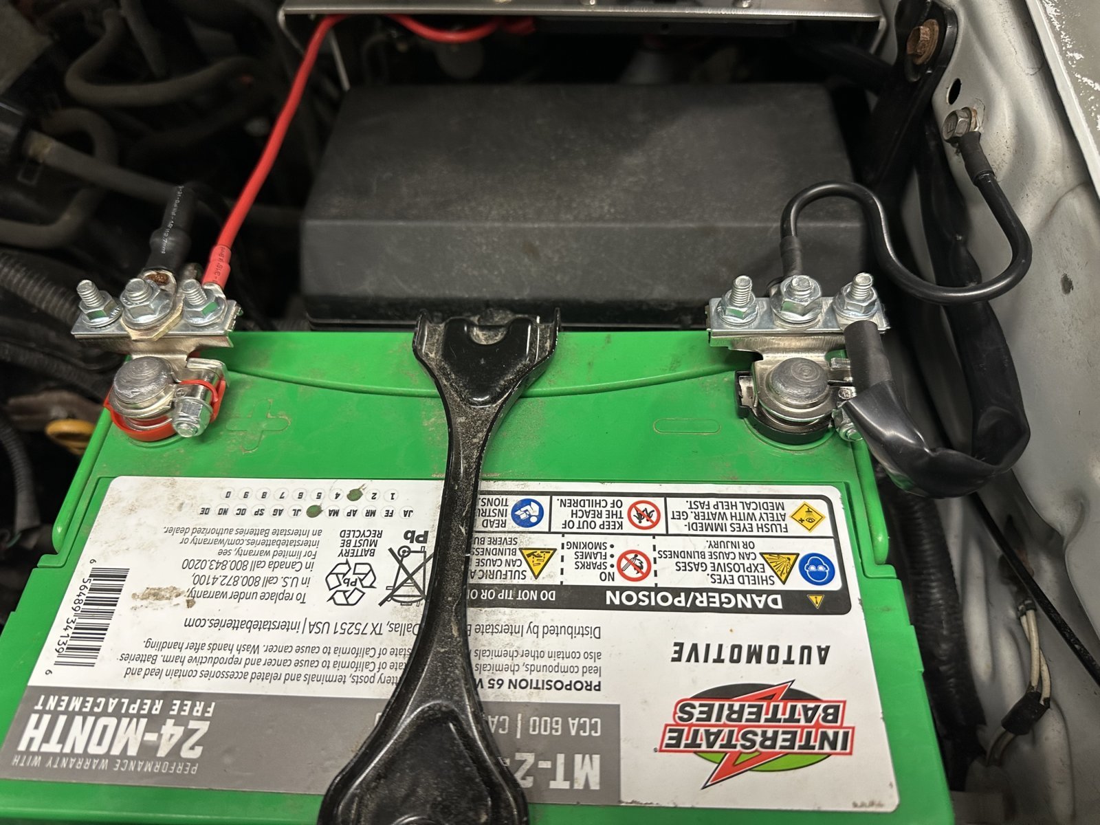

    Finished my battery terminals/posts. I may trim down the positive a little so it looks better.

    I have to do this soon. I have the TC gear all welded up, just need to have them burned on. Did you do this yourself or have someone else weld them?

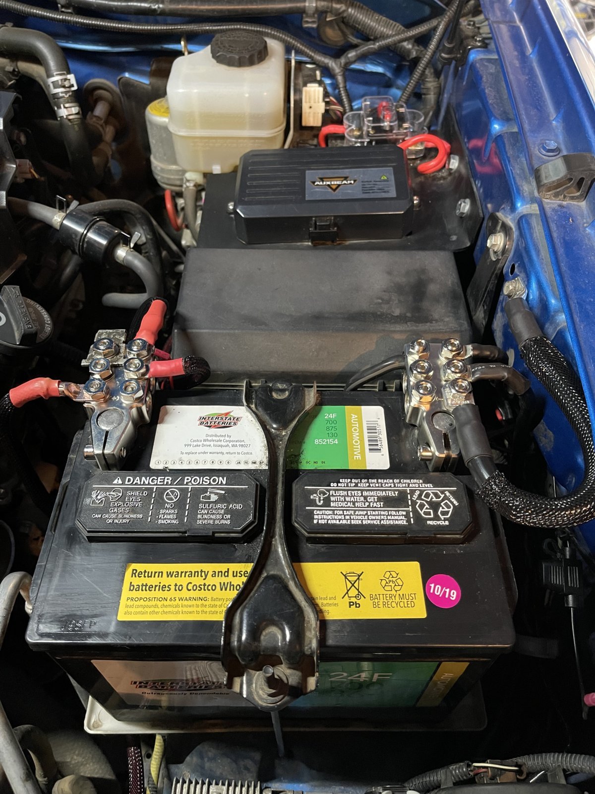

    New battery terminals and 0awg ground
