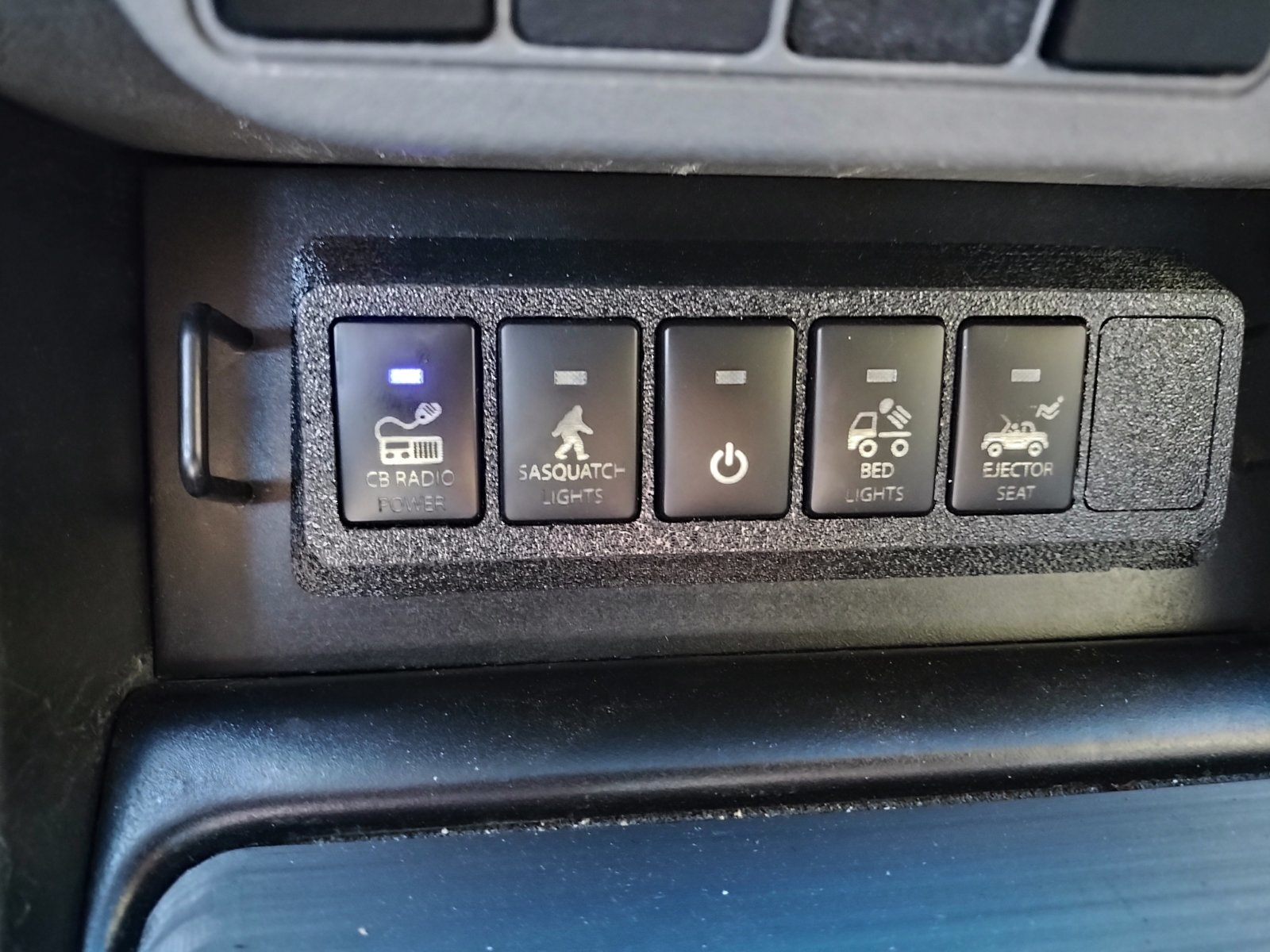

    laser engraved my switch covers last night... installed in a 3d printed housing to replace the older style rocker switchesIMG_20240419_110039026.jpg

    you spelled ejecto seato wrong

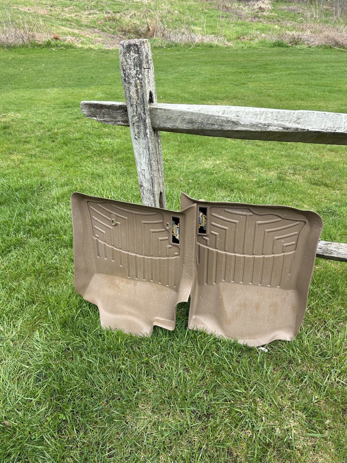

    Congratulations ! Looks like mine - Stops stuff from moving around - nice.

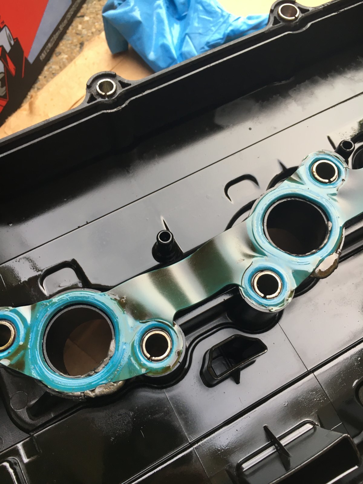

    Well now I know why cylinders had some milkshake. A previous owner used a generic gasket and applied rtv everywhere, but did a pretty awful job.

    All buttoned up and tools put away. For anybody who wants to try this out, go for it! it was my first time and took me about 5 hours including set up and clean up. Not too difficult.
    Notes for first timers with a 2.7l:
    Done in the driveway, no jacks or anything required obv. A small 3 step ladder was mandatory for me to get to the back of the cover.
    I did not use any power tools. I did use a name brand calibrated torque wrench.
    Cleaning off all the silicone on the cover took awhile. Cleaning the mating surface on the engine also took awhile.
    The 12mm bolt holding the pipe bracket on the back side of the block SUCKS without a long extension and a flex head ratchet, which I did not have handy. I crawled up into the truck to do it. I recommend loosening this FIRST so you can rest your weight on the cover if you need to crawl in there.
    Two plastic tabs broke: one click tab on the secondary air pump thing, and one of the clips that holds the harness on the front if the cover. Sucks but hey it’s an 18 year old truck.
    The factory service manual download I had was 80 in/lbs. use a torque wrench.
    i used permatex ultra black for the two rtv locations, so I haven’t fired up the truck yet while I wait for it to cure. Hope it turns out well tomorrow!
    note to myself: i forgot to tighten the clamps on the large intake hoses, make sure to do that tomorrow.

    I learned back in the day (Toyota 20R engine) that over tightening valve cover bolts leads to them leaking.

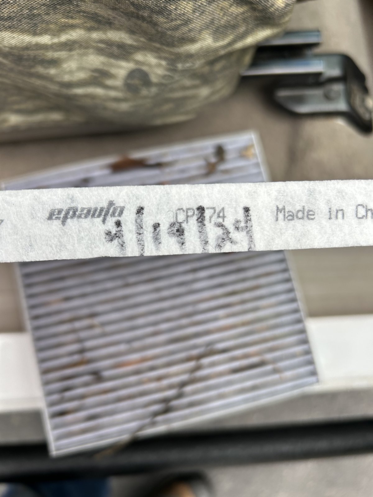

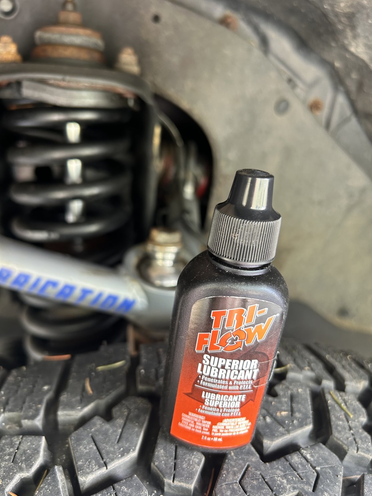

    Did some cleaning and rust proofing . Krown
    Changed cabin filter and lubed uni-balls

    TRI-FLOW is some good stuff, plus it smells good!

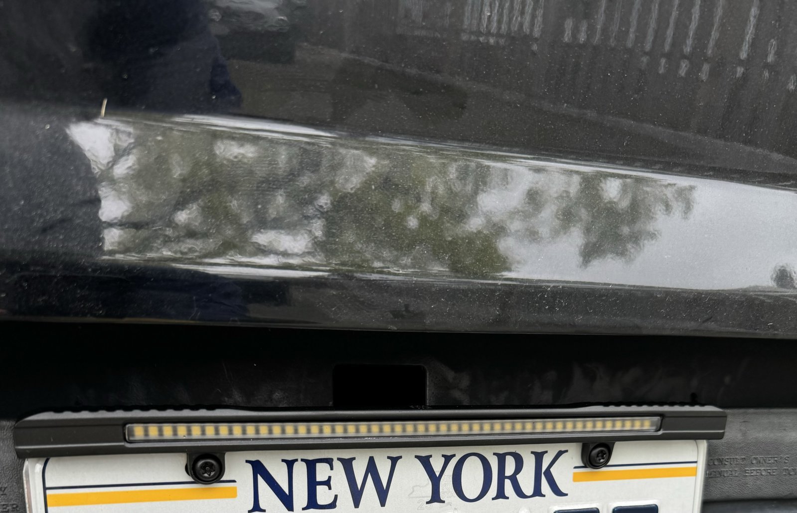

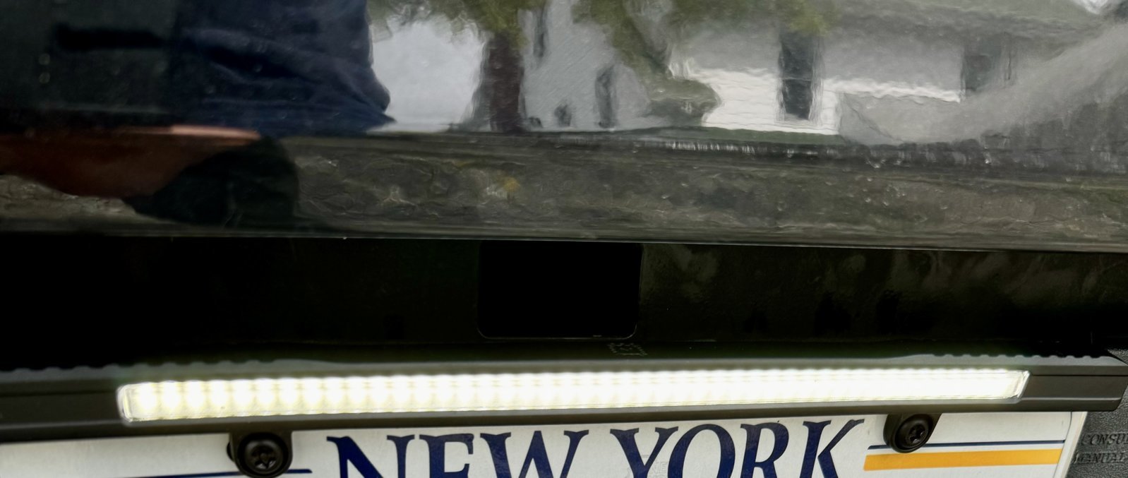

    The tailgate mod

    Valve cover gasket seems a-ok. Had the truck about 3 weeks and on Saturdays have knocked out:

    Yes ,the smell :wink:

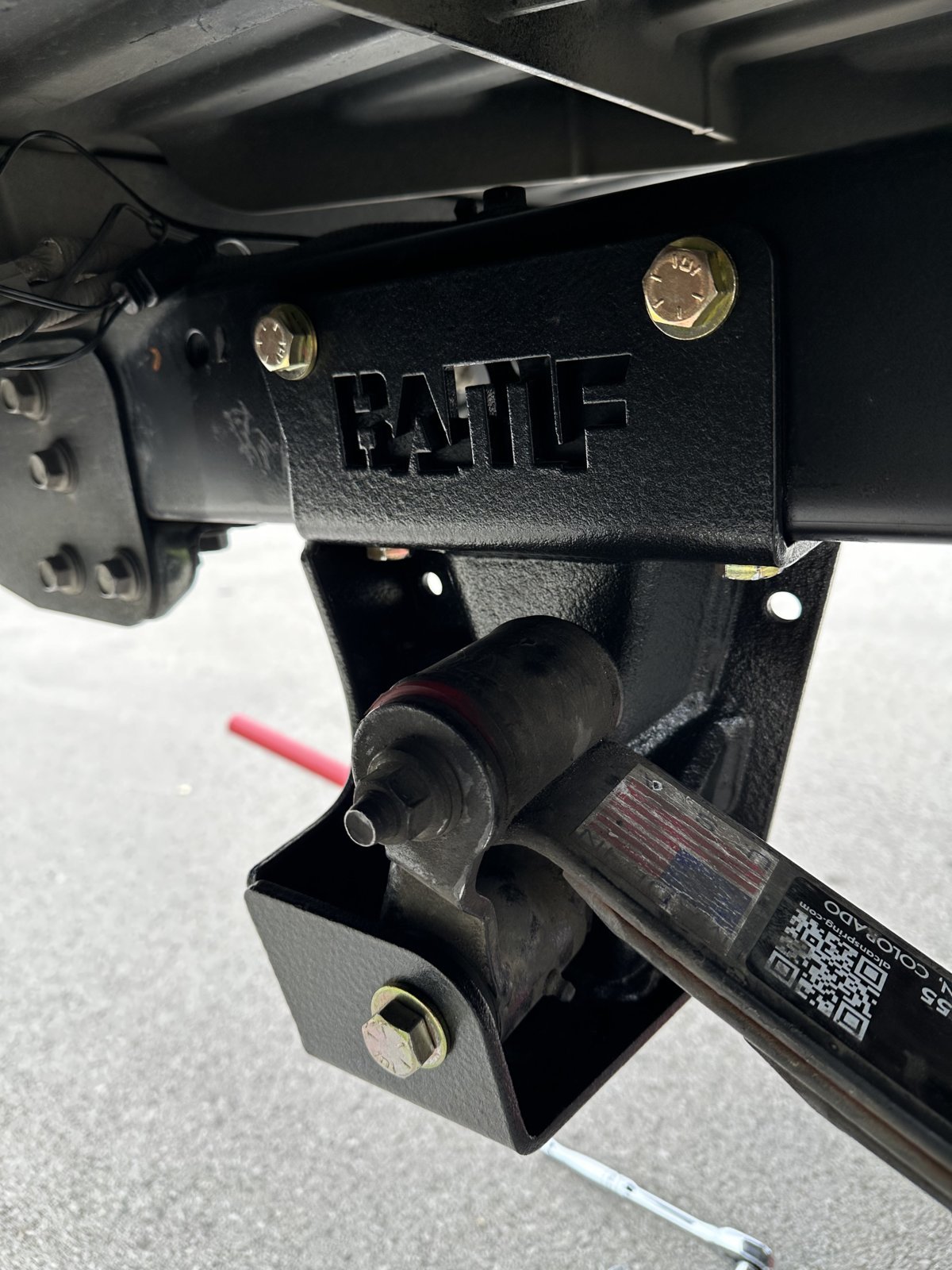

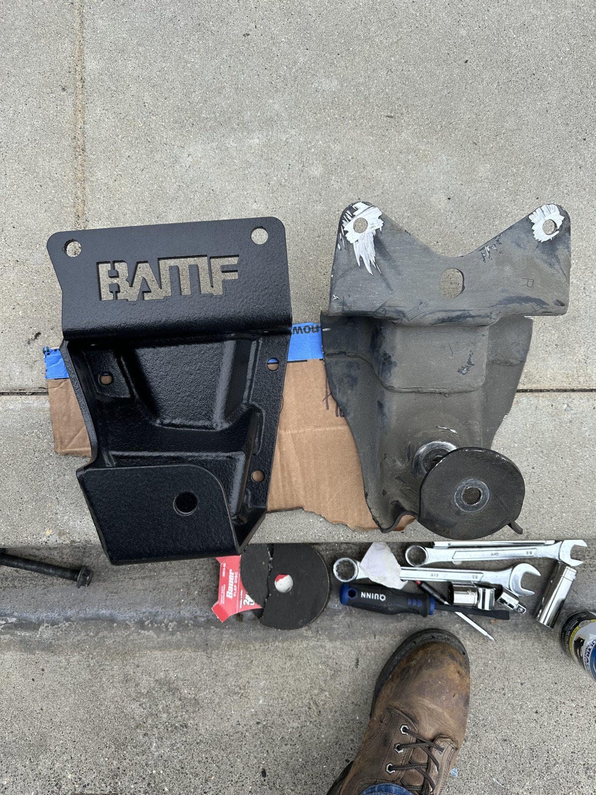

    Knocked out some BAMF hangers today. These things are solid!
