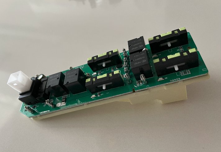

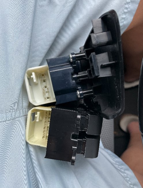

    unfortunately the Amazon 4-gang auto switch is not compatible with access cabs. none of the buttons work. here are some photos.
    the switches are not individually packaged, they are soldered onto the PCB and the pins are integral to the PCB, and actually lock the PCB to the plastic base using vertical locking towers that lead to the connector harness. it's all one giant integrated unit.
    interestingly, the switch rockers are just caps with a lever arm, the actual component that the switch moves is some kind of sliding variable resistance piece. there must be a logic IC somewhere - or maybe those boxes are smart relays with integrated power logic?
    all the pins present in the access cab unit are in the double cab unit but there are far more pins in the double cab unit, including smaller ones that don't seem to have a matching socket in the access cab body harness connector, but i'm not sure if they slide into the same thing, they might double up.
    anyone have any idea if you can desolder a switch and relay from this one and stick it in the 2nd position in the access cab stock unit? i didn't try to remove the pcb from the plastic base as i didn't want to damage anything.

    I've ordered all the parts to de-pin and re-pin the harness from 05-11 into 12-15 auto switches double cab. Read thru these thread:
    https://www.tacomaworld.com/threads/how-to-2012-power-window-switches-in-2005-2011-trucks.360738/
    bradforj posted info to buy a camry master harness, cut, de-pin and re-pin to work into a 05-11 access cab. See post 25 & 27.

    btw just for clarity, i have a gen 2.5 (2015) and the body connector fits into the tundra switch unit connector. it just doesn't work... seems like the above thread is a connector upgrade for 2.0 to 2.5 body style.

    Ohh... Maybe you can just just re-pin the connector then. Send bradforj a PM

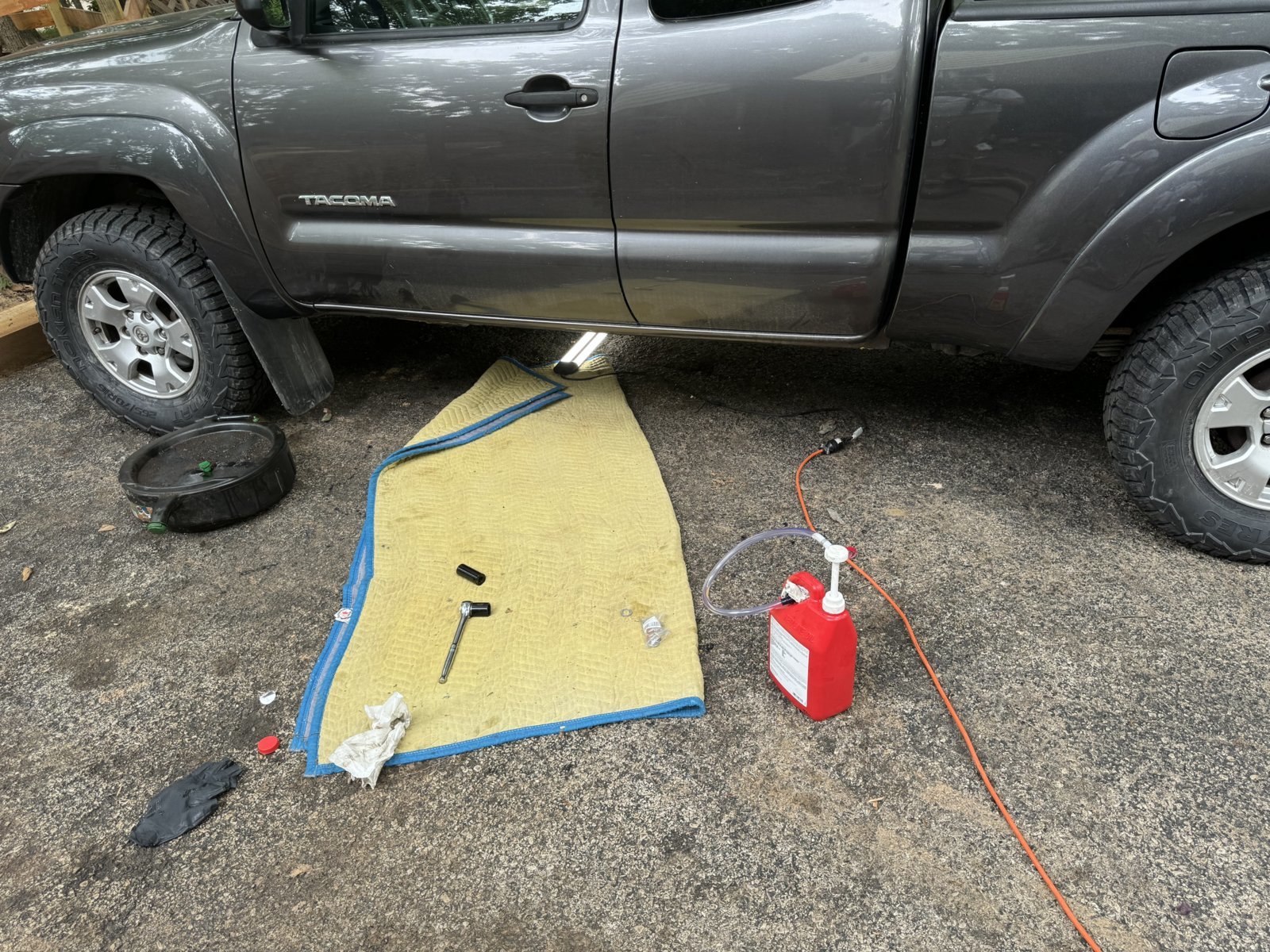

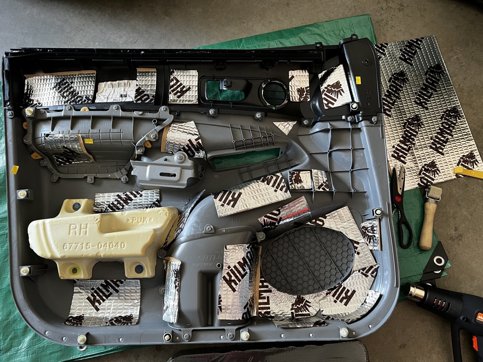

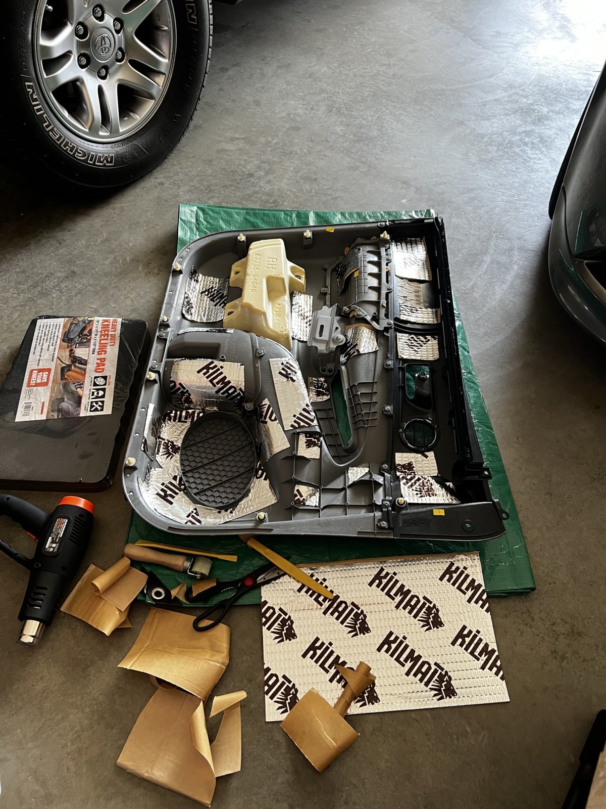

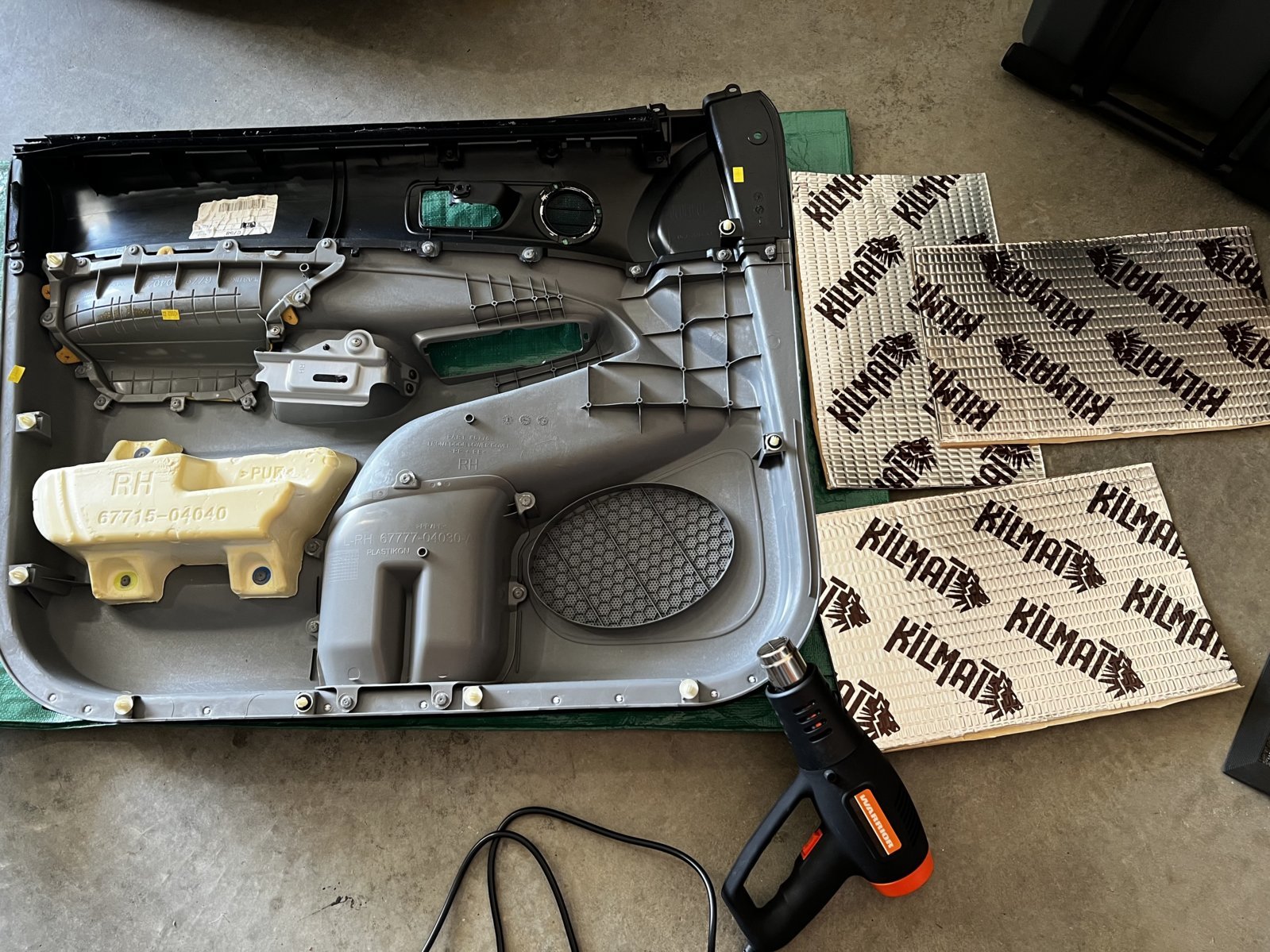

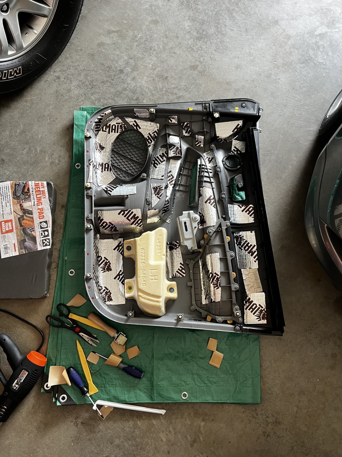

    Decided to do some sound deadening on my door cards this past weekend. I think it should cut out any rattles when I replace the speakers soon. I already did the actual doors which made a huge diff in sound with the stock speakers running off a solid Kenwood Excelon radio
