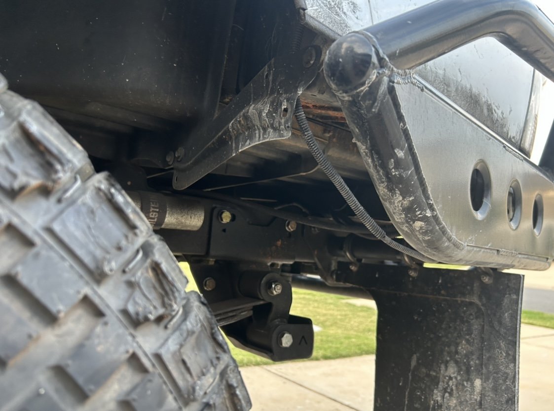

    2.5" OME lift, Fox 2.5 coil overs, all pro expo leafs, ubolt flip kit w/ upgraded bump stops, 1.25" wheel spacers, 16" Bronze KMC Impact OL wheels, 295/75/r16 Nitto grapplers, beige Softopper, Brute force front bumper w/smittybilt winch, RCI rear bumper, caliraised rock sliders, TRD IFS skid plate custom swingout tailgate w/spare tire mount, TC bed stiffeners, Magnum force CAI, KC spotlights, tacomabeast headlights, rear seat molle panel odds and ends, hi lift, MESO interior lights, and a fuck load of patches… more planned for later.
    Sir that’s a damn tree :broccoli:

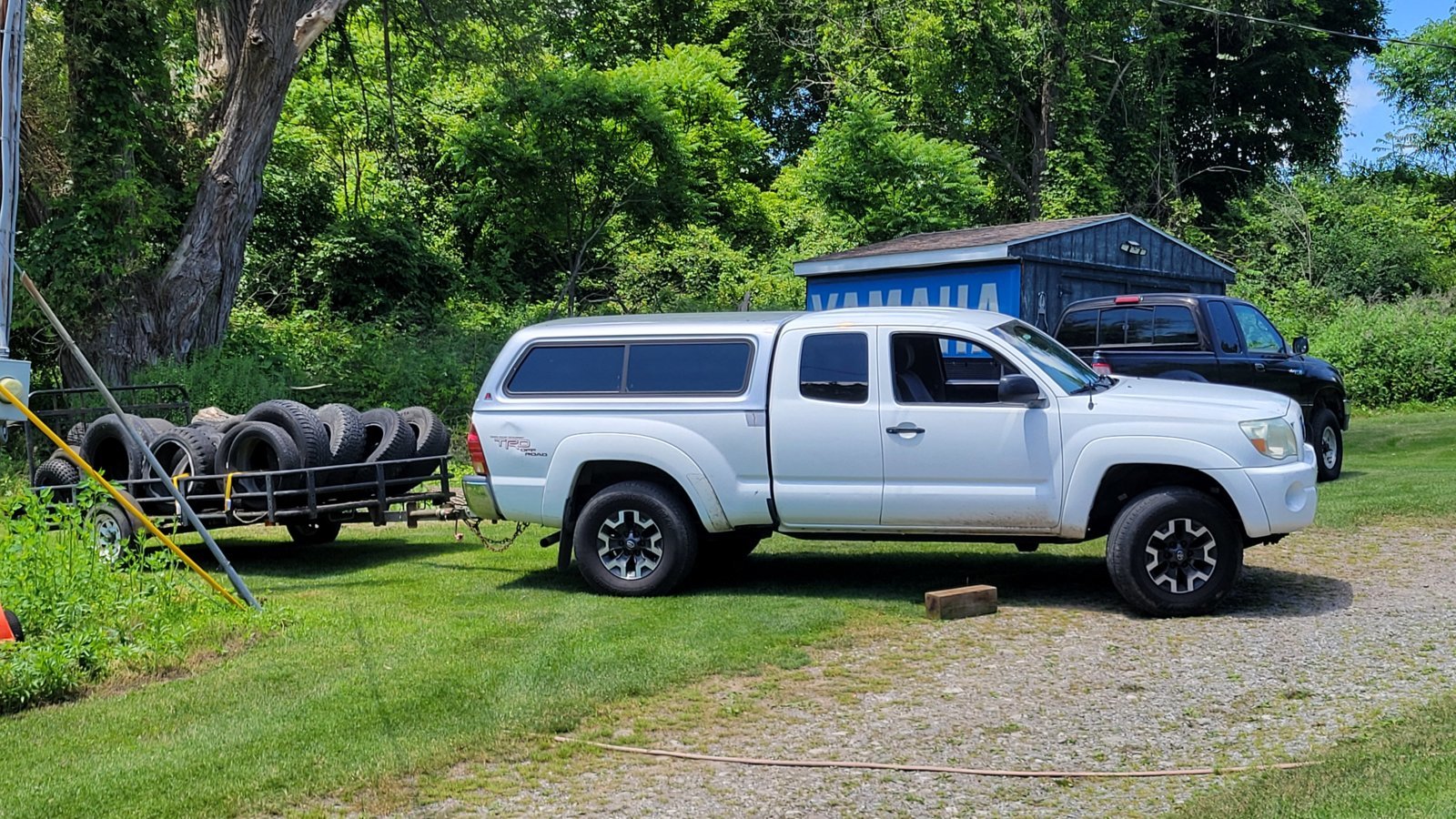

    you know, my wife once found a broken "stick" like this under her car it punctured the rear coolant hose and punched a hole through the plastic protective panel, now that stick was in the road under some snow and she likely hit it at at least 45mph but it had to go to the dealer ship and that wasn't cool on my weekend to get parts that weren't readily available yet, on a new car

    I did not see any damage :thumbsup:but I can’t really see on top of the gas tank where I yanked this thing out from .:fingerscrossed: Taking the camper to the beach about a 3 hour drive Monday so I will be crawling under there again and double checking before Monday .

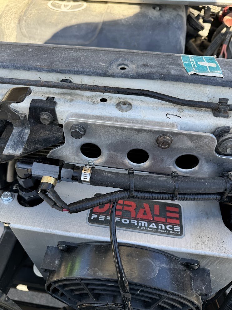

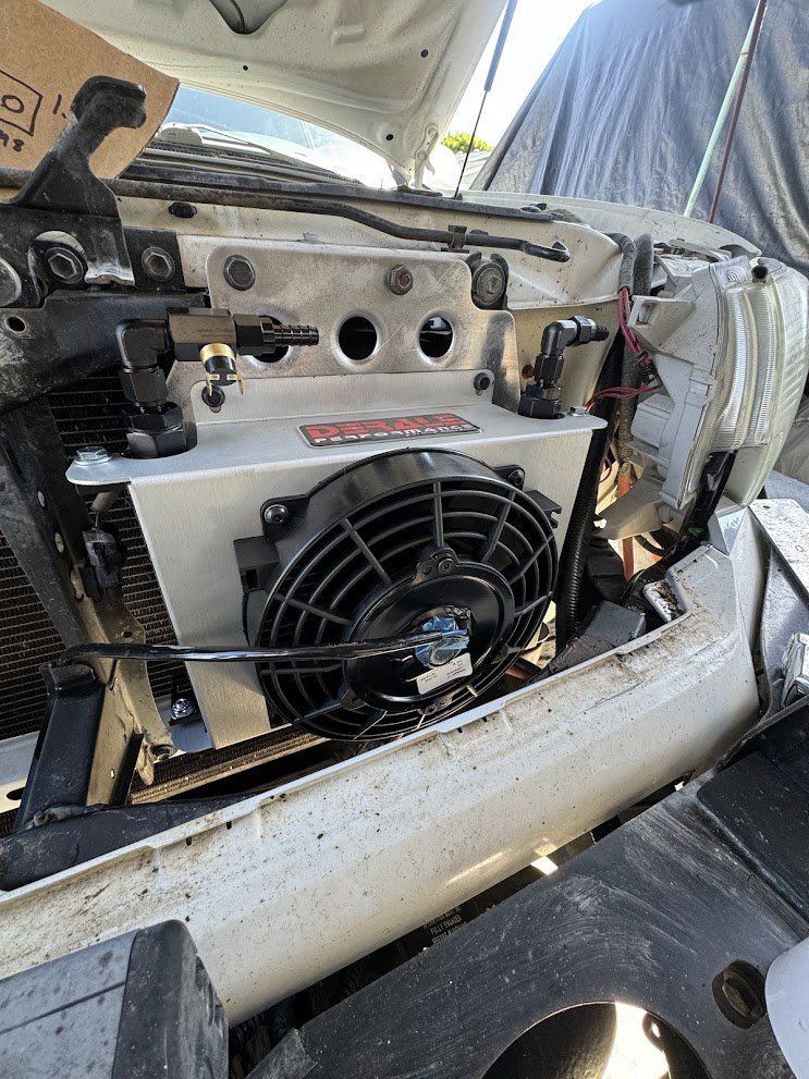

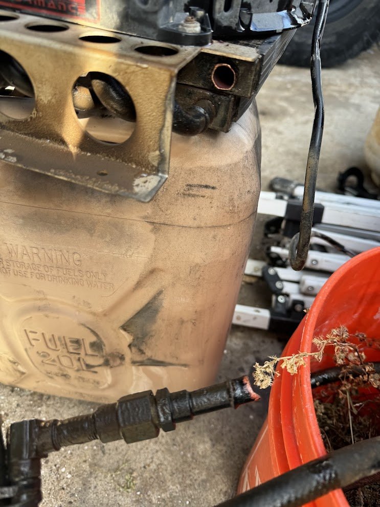

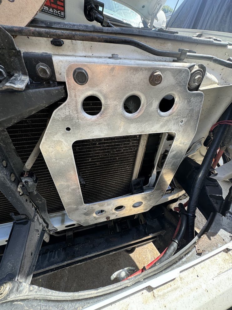

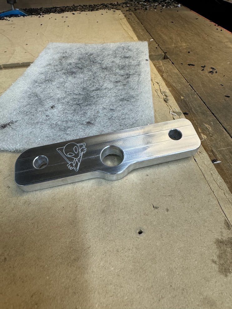

    broke my old trans cooler with to much washboard roads so beefed it up and made a new bracket and larger cooler.
    whipped up a bracket
    then the new larger cooler with temp switch and fan
    spacer bracket lol
    then installed. turned out well and should hold up better then the old style i had.
    and the old failure. copper tube broke (and guess a leak lol)

    Clean work there!!! :thumbsup:

    where did you put your horns? but that is absolutely amazing! been thinking about a larger trans cooler

    dont have a pic, but have dual hella horns on the other side lol

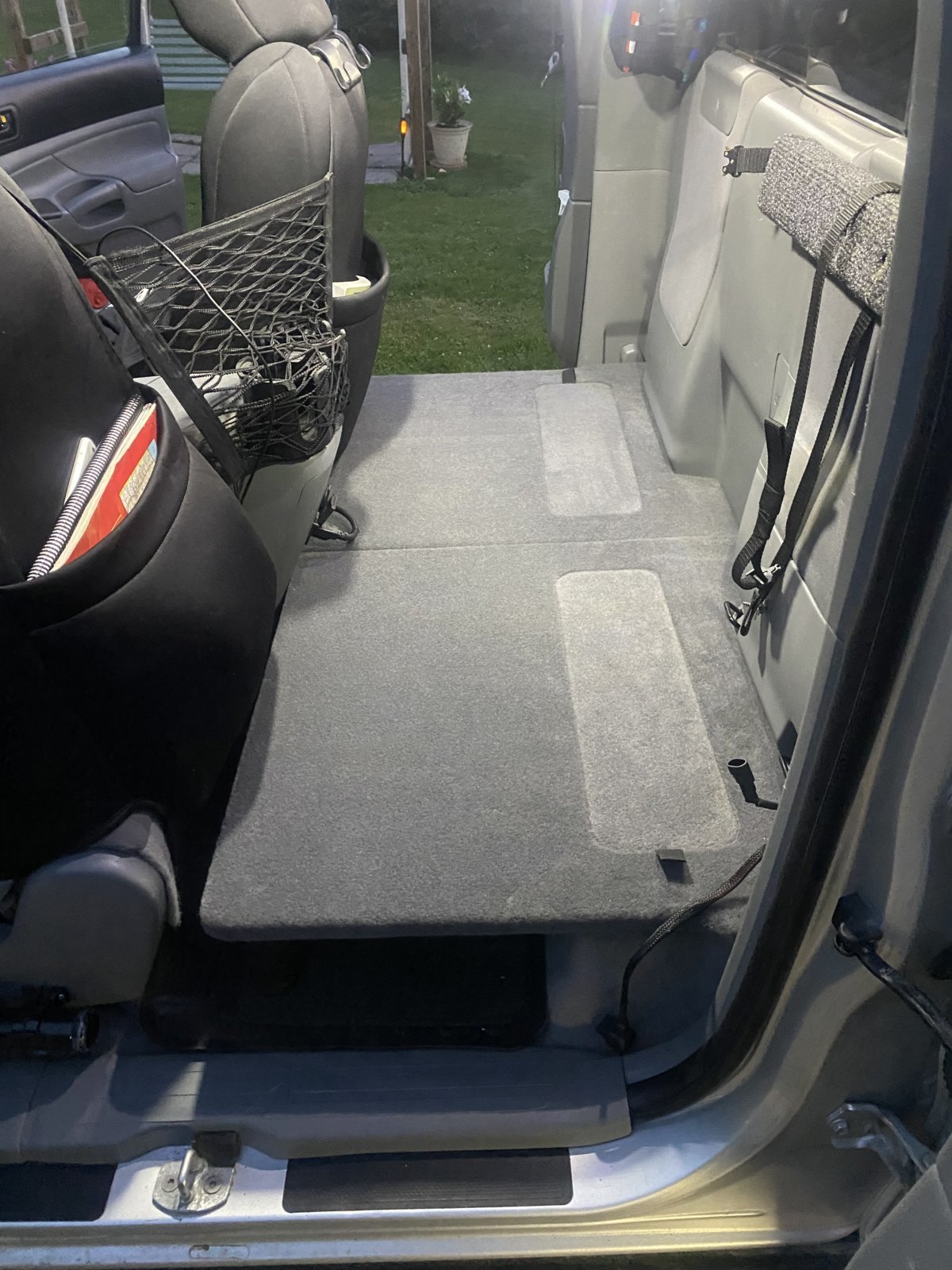

    Finished the floor
    I need to find a piece of carpet or rubber mat to put over it now.
    The old one is cut for a cargo net I’m not putting back in.

    is that for manual or auto?
    debating trying to put a cooler on my manual if even possible…
    Potentially make the system more durable and add capacity - stock RA60F seems to have tiny gear oil quantity for hard use

    auto, you really dont need them on a manual. nothing slipping in a manual to heat the oil that hot.

    Any more details on how you supported it and what you took out? Looks like the seat bottoms are out?
    very clean job!

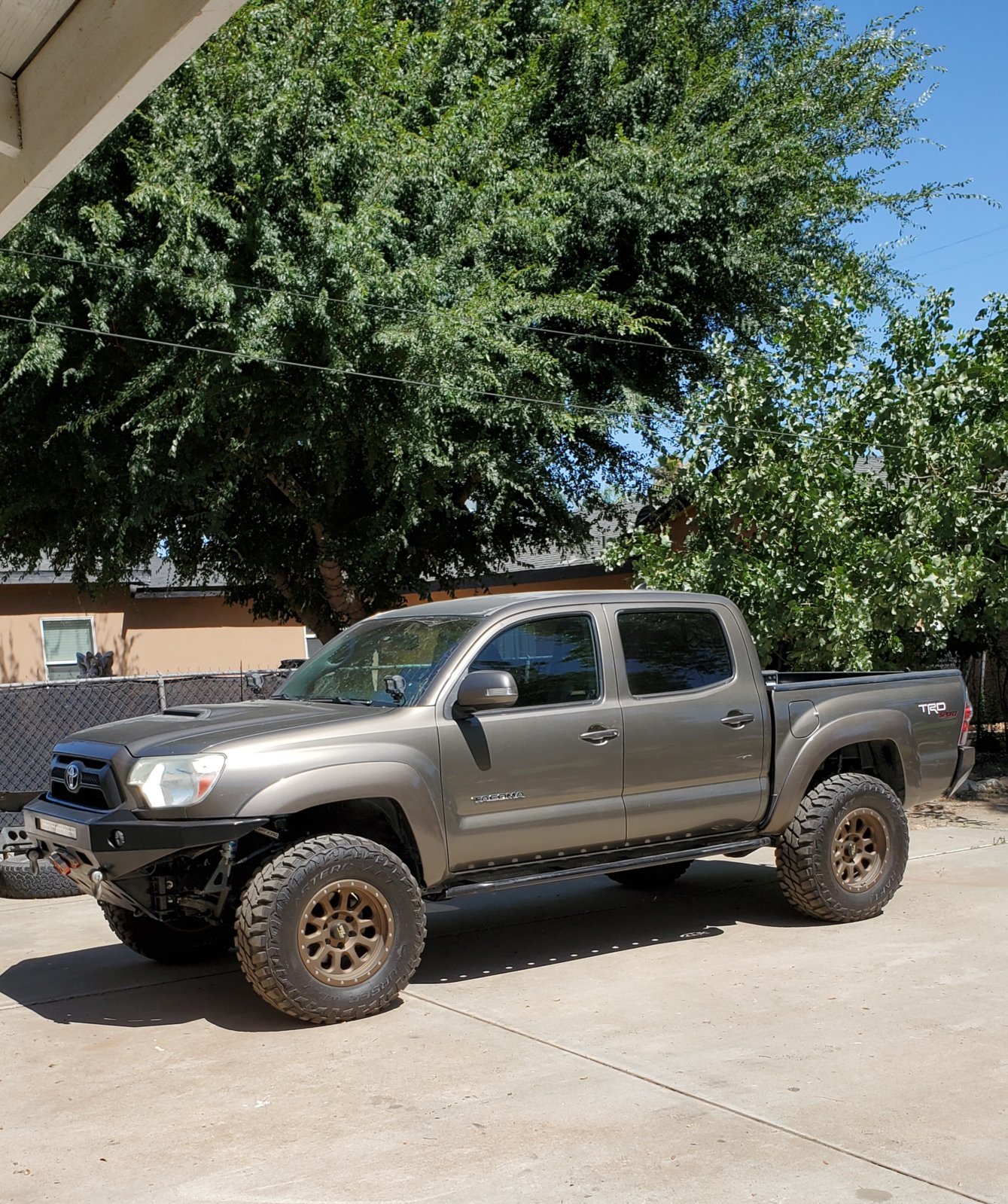

    70K today, purchased this 2012 in October of 2011 with 3 miles on it. 300 miles later I lifted it with a Fox suspension kit. Running Kings now and ARB lockers.
    Never had a problem with it and plan on keeping it until it dies.

    Bought mine in July of 12. But you have half the miles that I have. Hahahaha. Truck looks great. How do you like the ARB lockers?

    Never had a problem with them. Really only use them when I have to, truck does great in Moab all by itself.
