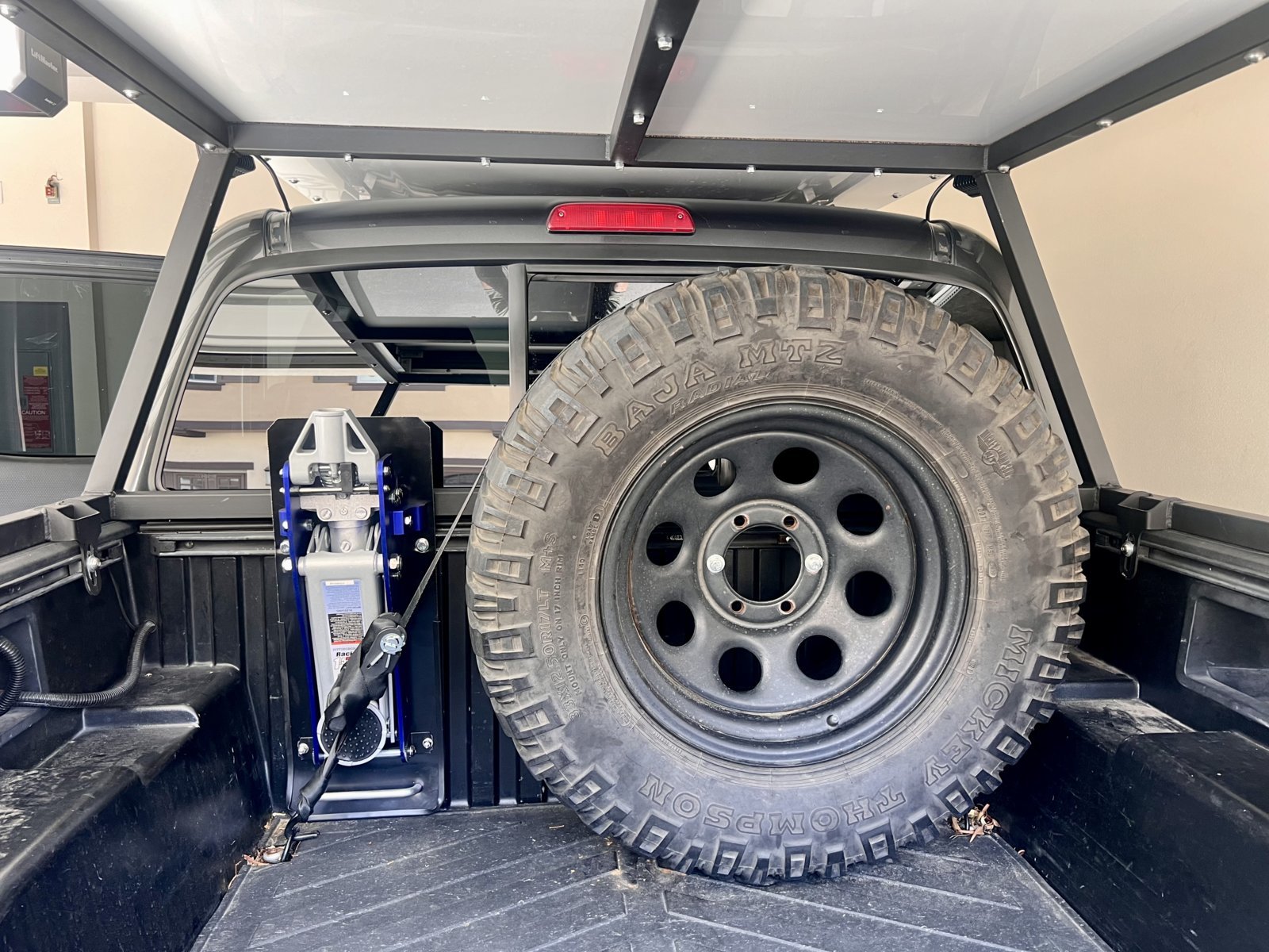

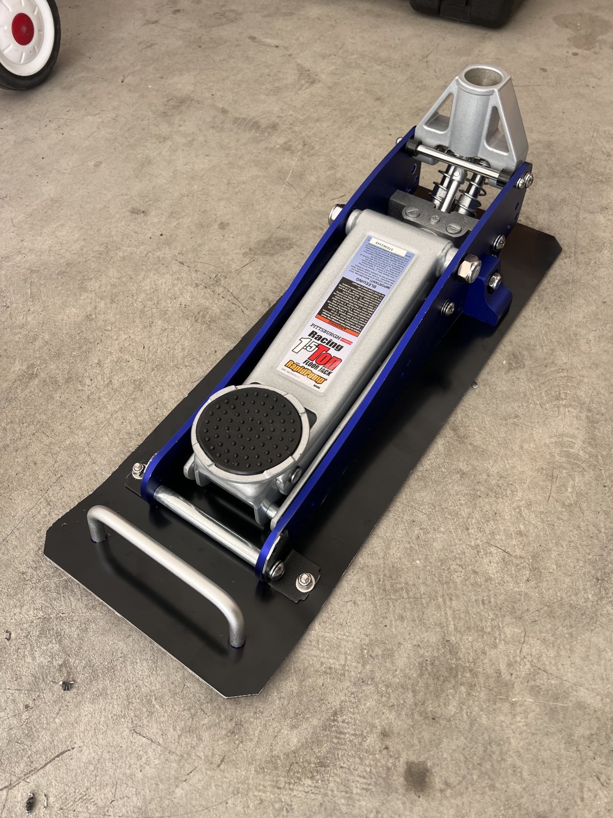

    Ditched the hi-lift jack and made a simple skid for a cheap harbor freg floor jack. Gonna put some quick fists on the sides to hold the jack handles just like Overland Under Budget did

    1.5 ton jack for the Tacoma? Seems unsafe to me imo.

    It’s just for changing flats or trail fixes. And you’re only lifting one corner of the truck at a time for trial repairs. A Tacoma weighs roughly 4,000 lbs and even jacking up “half” the truck would only be 2,000 lbs in theory

    I have that exact jack, but with wheels. Never thought of doing what you did. That’s a cool idea! I’m gonna give it a try.
    Edit: As for being able to lift the truck, I’ve had mine for a couple of years. Never had an issue lifting mine.

    Jacks just go into bypass if you overload them, nothing unsafe about it

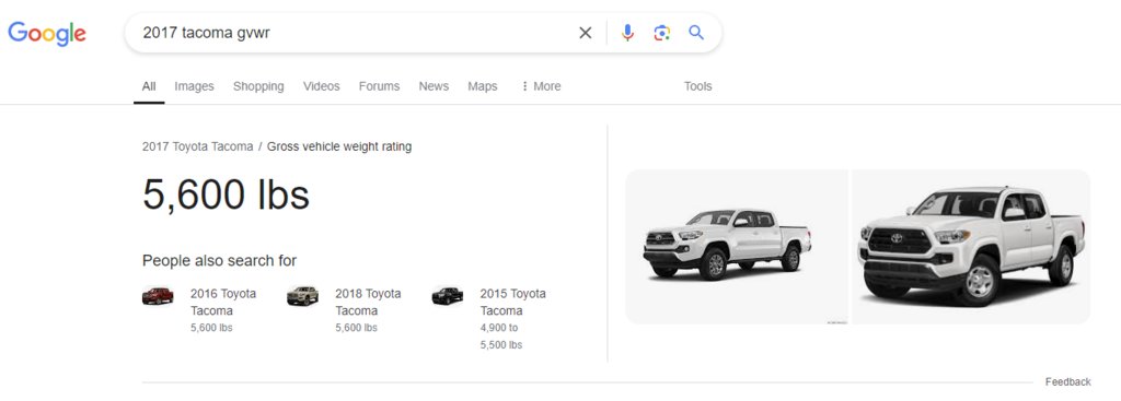

    Your theory has the vehicle empty. My Tacoma weighs ~5500 lbs with all the gear we carry; topper, RTT, camping gear, etc., etc.
    Ever had your truck on the scales? Weigh the axles independently. The front will weight much more than the back, when the bed is empty. Could well be the opposite depending on what you have in the bed. And this does not begin to take into account modifications, like bumpers, winches, roof racks, topper, etc., etc.
    But, it could be that your truck is bare bones and you never, ever have anything in your truck.

    Oof, time for a bigger truck. Doubling the payload seems like a horrible idea to me.

    This doesn't directly translate to how the weight transfers through the suspension. Yes, if you were trying to lift the entire vehicle from the CoG it would overload but the jack shown above would not have an issue lifting a corner of your rig for a tire change. This jack wouldn't even reach the frame rail or cross-member on its own either so that would kind of be its main purpose.

    I understand for your vehicle you’ll need a different application like a 3 ton jack, but this is why I got it for MY truck. I’ve only got a Ripcord DIY wedge camper (275 lbs.), sliders, front skid and some basic recovery gear so I’d say I’m only several hundred pounds over stock.
    And to reallifedog’s point, I do have to use a block of wood or eventually get a jack extension post like Pro Eagle sells since this only has a max height of about 14”

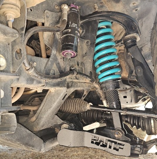

    Installed BAMF LCA skids.

    Do you have your spare tire mounted by those two bolts and with track nuts in the rail? You have a ratchet strap holding it as well. Do you think the bolts would hold it alone? Currently I either leave my spare laying flat or I have it strapped from side to side sitting upright

    You got it! It’s just some bed rail t-nuts and I think 3/8” bolts and the length will depend on your tires size/offset. Someone else on here did it this way and said it’s been solid for them. I think just the bolts would be fine for daily driving but the minute you hit any trails or dirt it would start flexing more than I’d be comfortable with so I added the ratchet strap too
