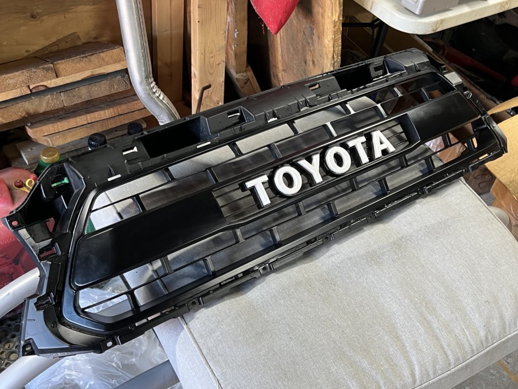

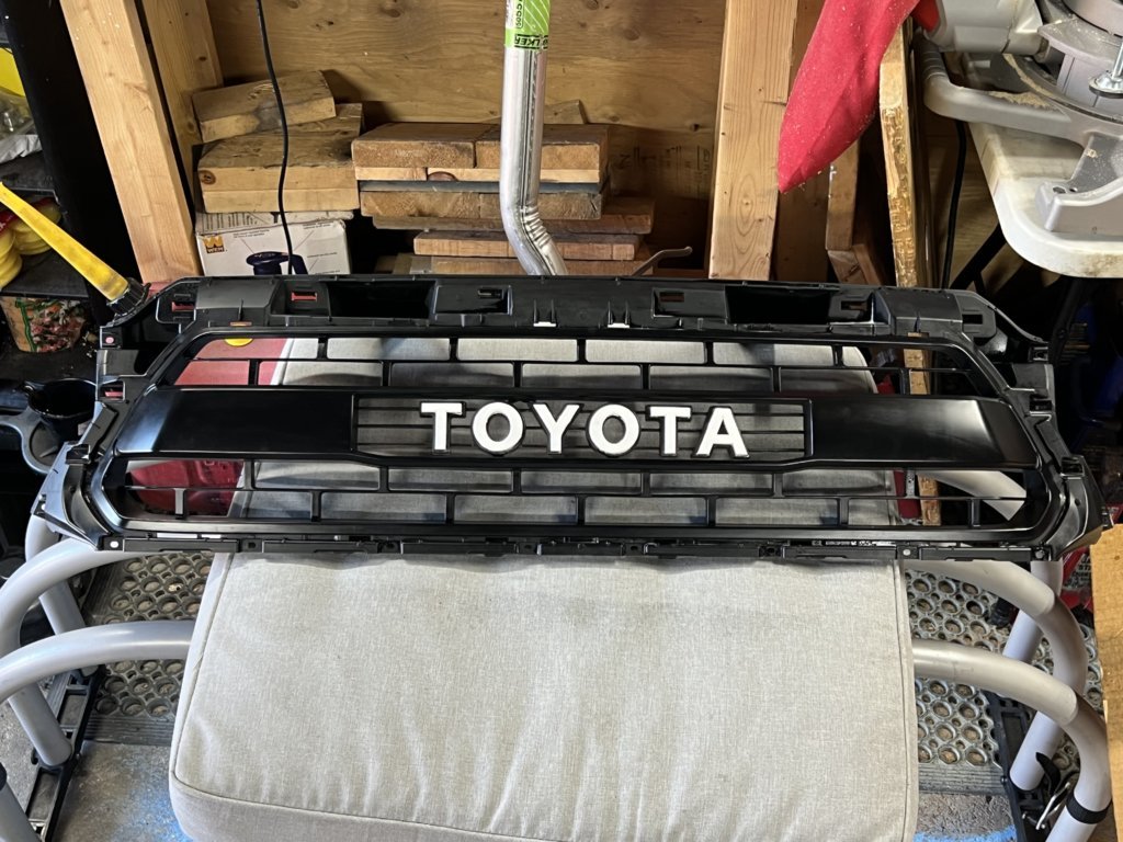

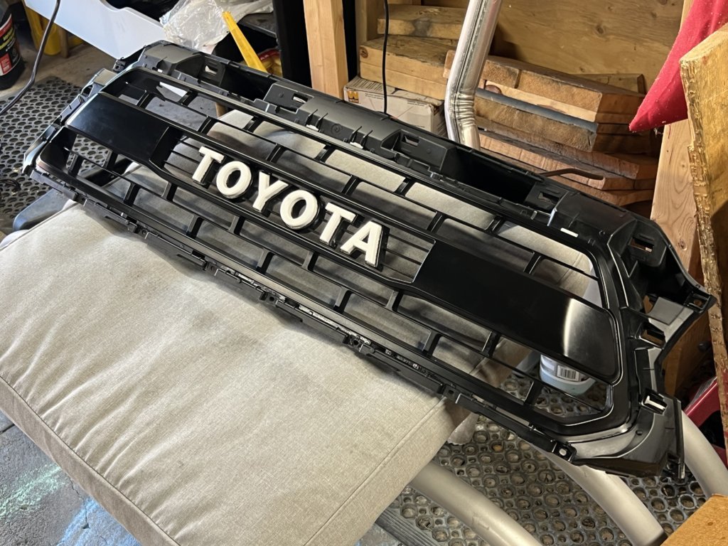

    I’d take your old pro-style grill off your hands if you’re able to ship… :cool:

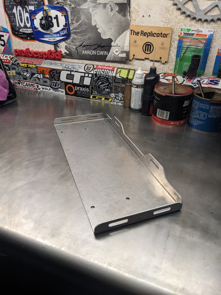

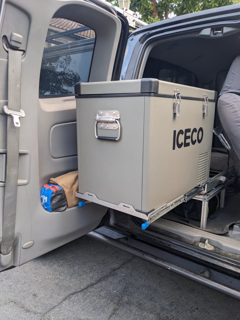

    Made this slide out mount for my fridge last Friday. Whipped up these little mounting trays for fridge to sit on this morning. An hour between design, cut, and bend. Much nicer than the plywood piece I had originally.

    It’s available. :D

    I’ll DM you!

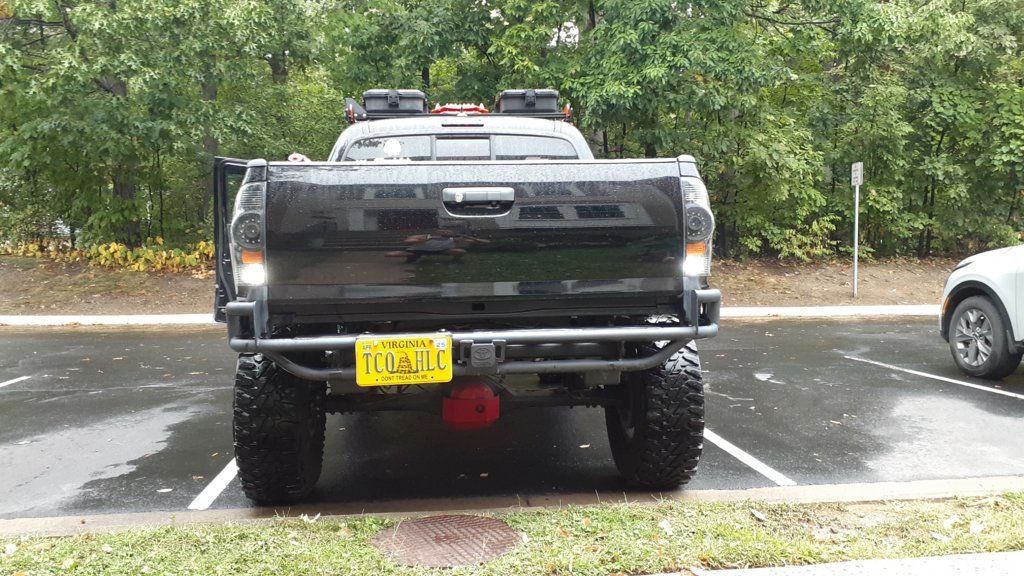

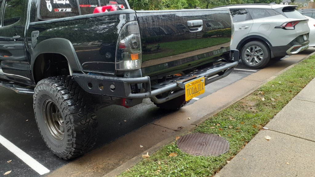

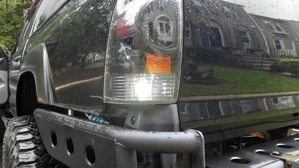

    Swapped in some new led reverse bulbs. So much brighter than the stock ones.

    Which ones did you get? I got some off of Amazon but they weren't that much better than stock. I'd like something brighter

    These were Amazon too but are mini projectors so nice and bright:
    Newest 12-24V Super Bright 194 912 921 168 175 2825 W5W T10 LED Bulbs with Projectors for Side Marker Cargo High Mount 3rd Brake Lights, Xenon White

    when did you go back to black??

    After my accident Jan of last year. Had to unwrap both driver side doors so they could paint.

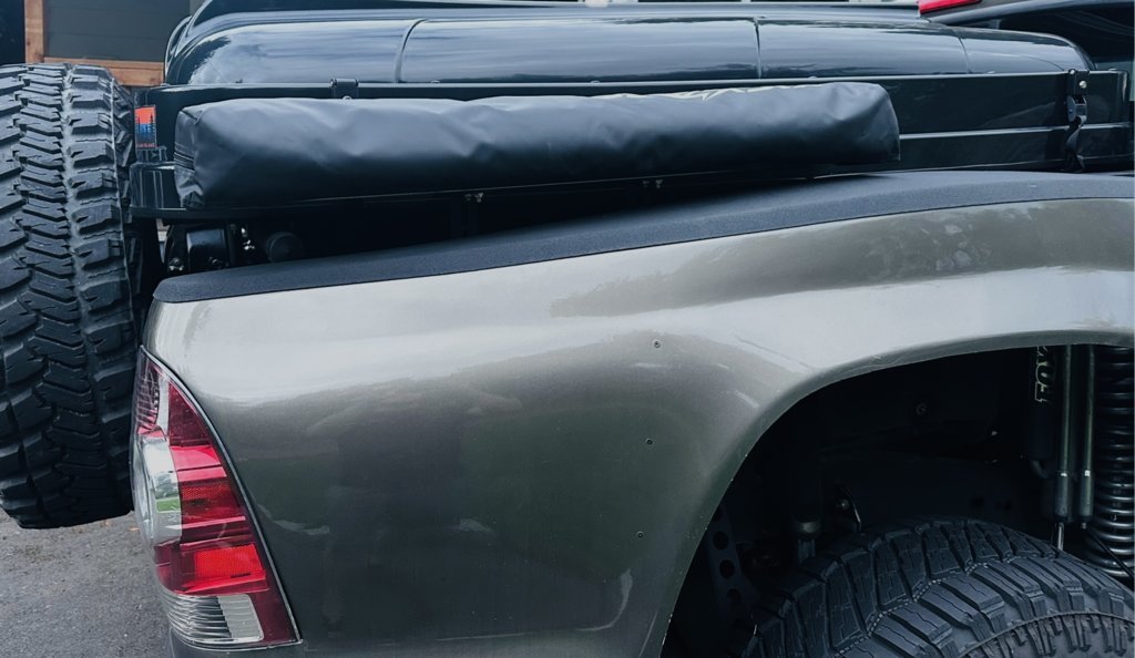

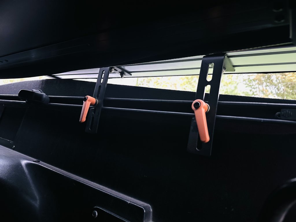

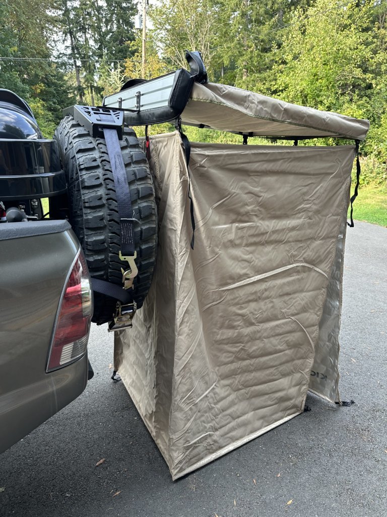

    Devised a simple rail mount setup for shower awning. Shower awning just gets stowed to rail when not in use, then quick mounted to spare tire whenever actually needed. Cut gaps in awning mount to allow adjusting knobs to just slide in place, then just tighten down to rail T-nuts.

    Is it just me or is your bed side angled down?

    I thought the same thing but then realized it's probably long travel so it's got humps for the wheels.

    Trailing arms and bypasses + shower tent is a power move

    Looks like he's running fiberglass fenders and bedsides for clearance

    Yep, trophy truck style fiberglass flares

    Ole girl looks good black again :thumbsup:

    Got ya. Any pics of the while thing?
