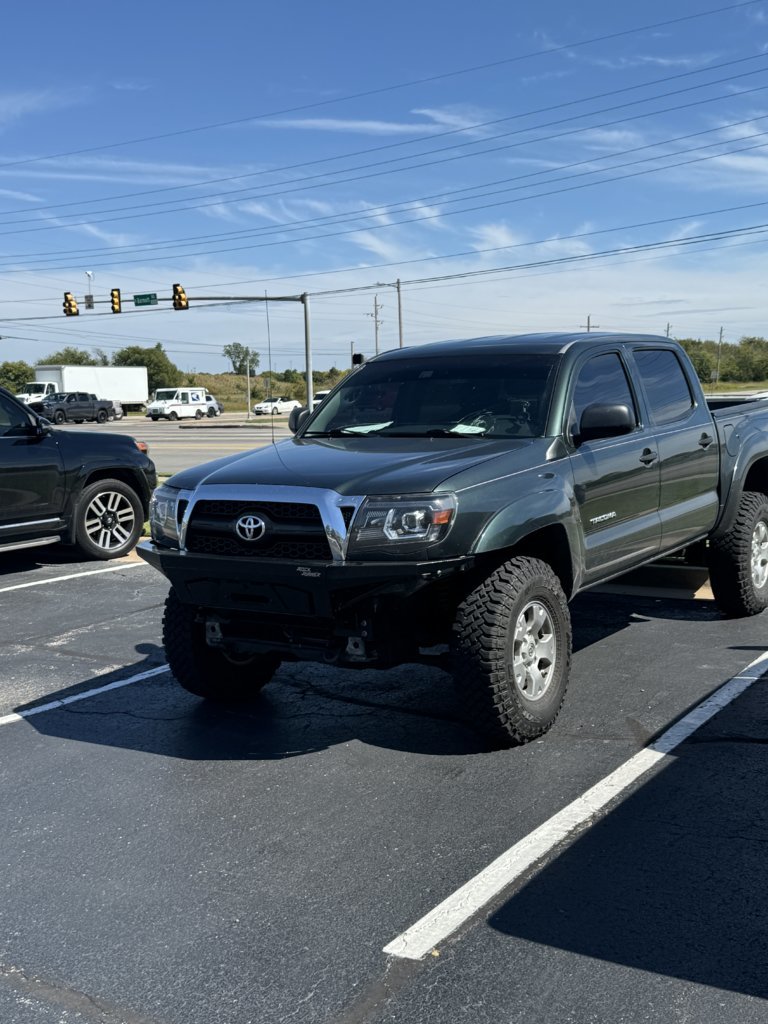

    Finally got my c4 rock runner bumper put on. Still have a few things I need to adjust and will be coating the frame.

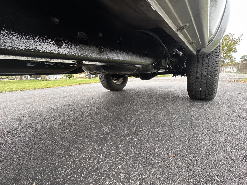

    Rotated tires, oil change, and fluid film. All set for her 9th Pennsylvania winter.

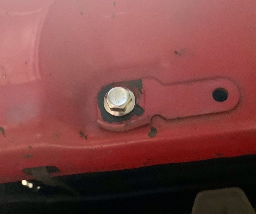

    You need to locate the bolts. I had to order mine. 10x1.25 metric socket cap bolt 12.9 rated. Got them at bolt depot onlineIMG_2160.jpg

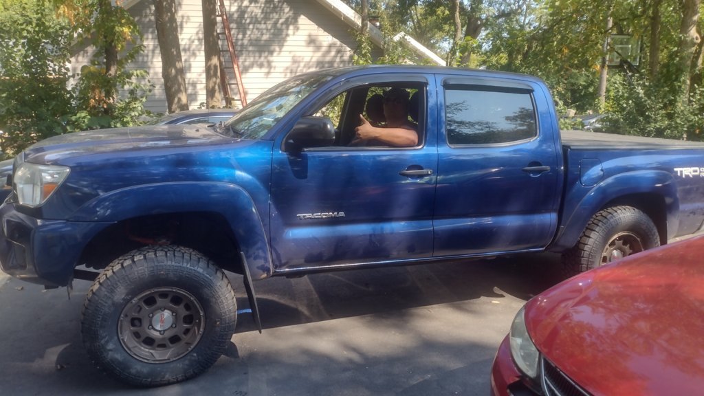

    Well I didn't do this but my buddy installed his front Bilsteins with the lower spring mount upside down and now he has a Carolina squat lol

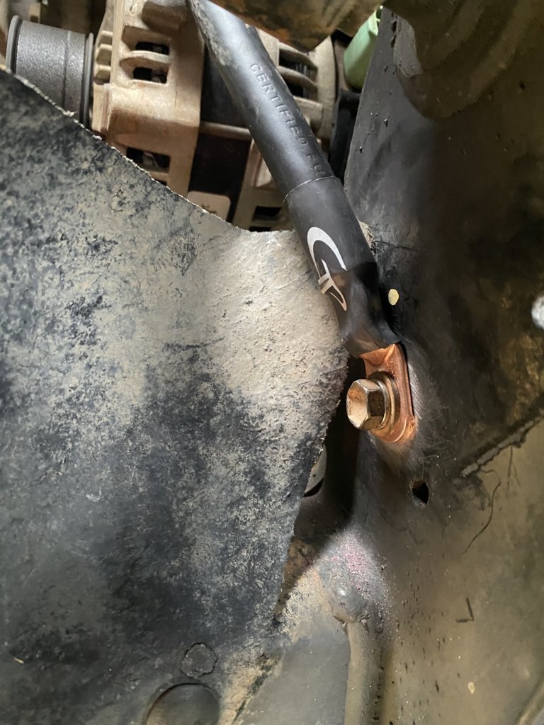

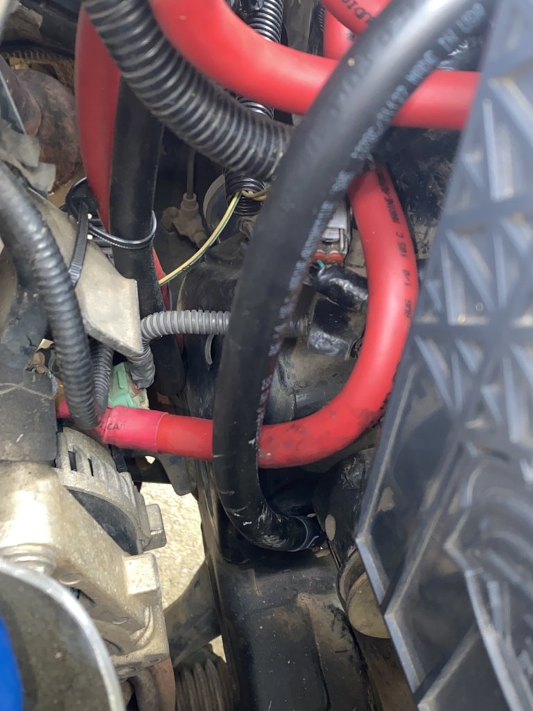

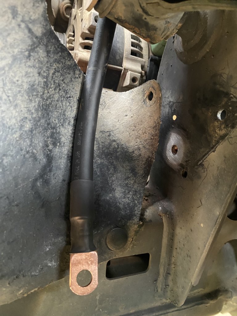

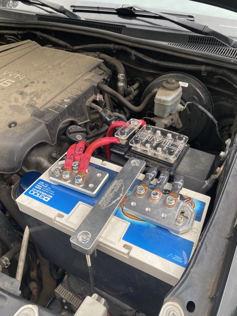

    Today I did something that I should have done during my Big 5 upgrade to 1/0 cables. I initially junked the wimpy 10awg battery frame ground, but figured I’d add it to be safe. Really simple as it can use the stock bolt.

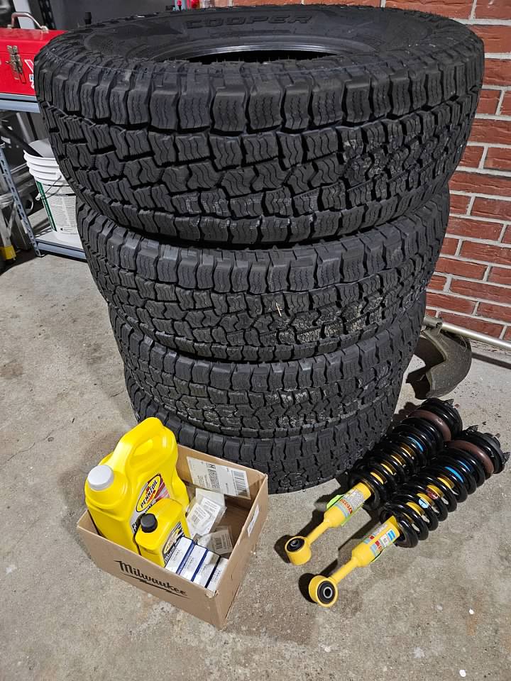

    Gathered everything for my appointment Wednesday at my local independent Toyota Shop.
    195K
    New Tires - Cooper Discoverer Road & Trail AT (SL) 265/75/16
    New Denso TPMS sensors (originals lasted 13yrs...not too bad).
    Replacing my OEM front coils with 5100's at .85" setting with a set of low mile 3rd Gen TRD OR Take-Offs. Should get the same 1" from what I've read here on TW.
    Oil & Filter change.
