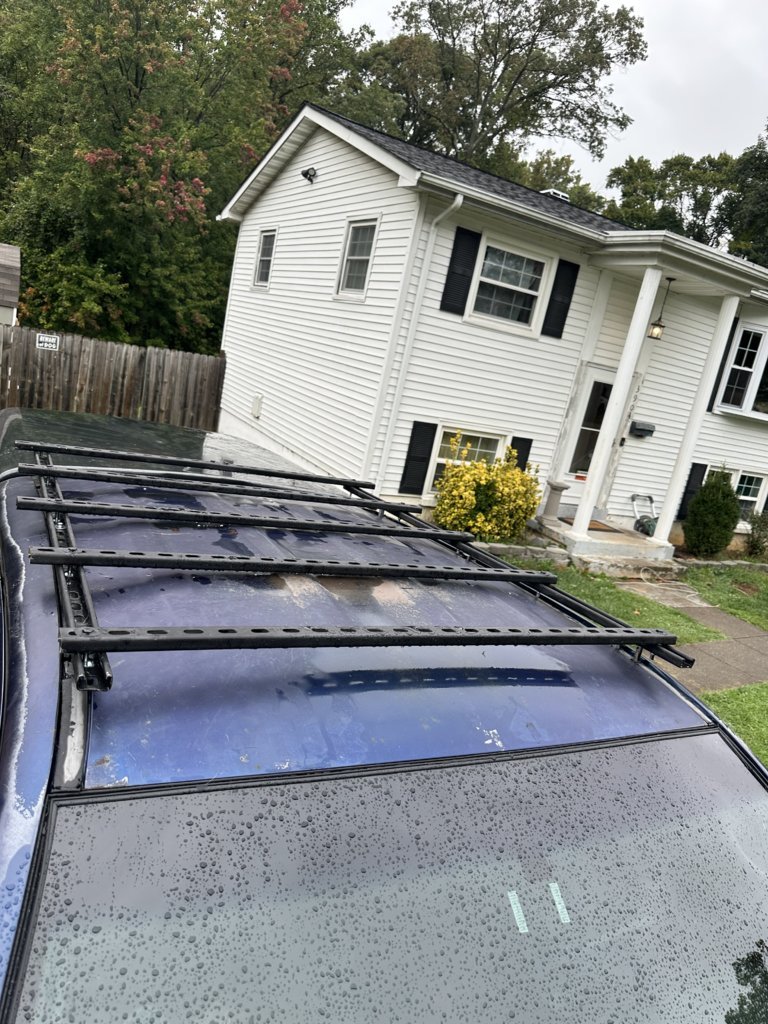

    How much does all that steel strut weigh? A lot of weight up high.

    unistrut is pretty lightweight, I bet that’s less than 50lbs

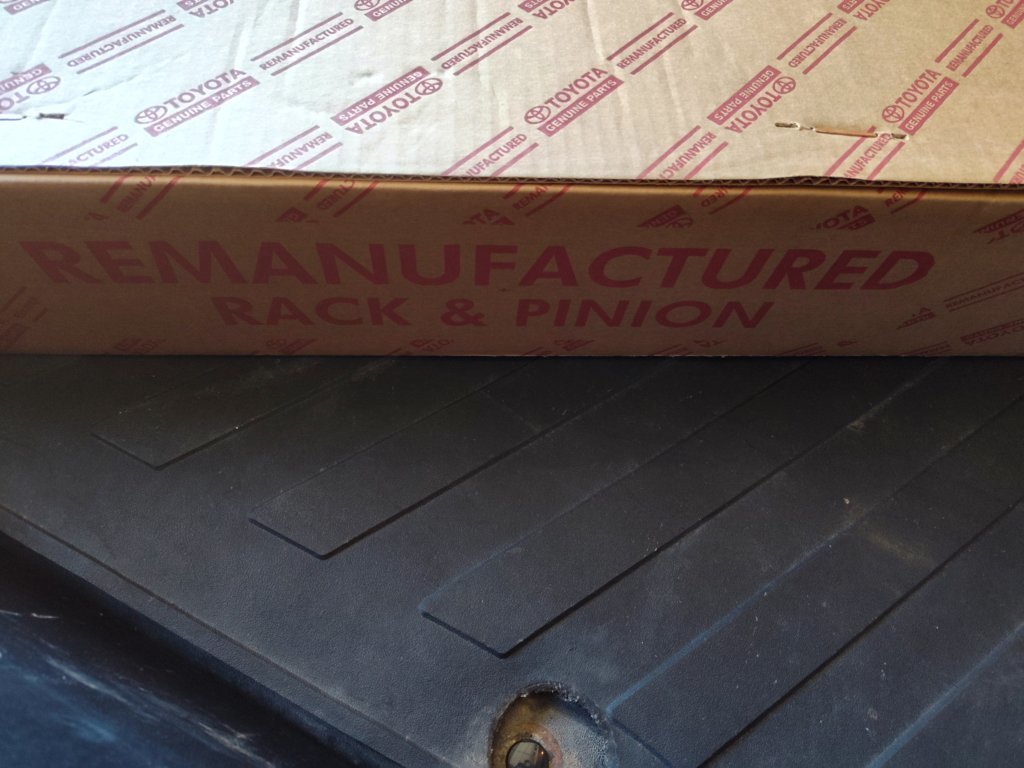

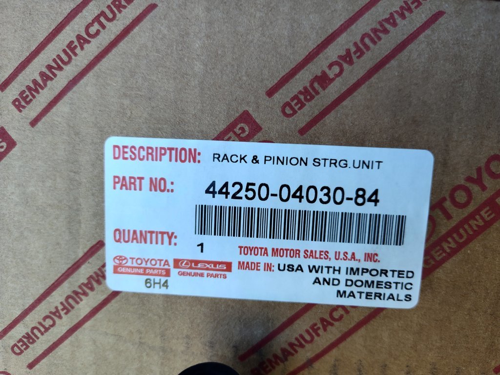

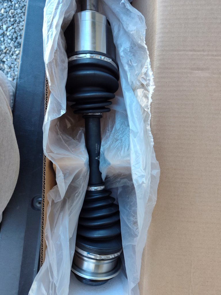

    Picked-up CV Axels and steering rack for my 09 today, dropping it off in the morning.

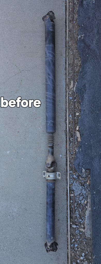

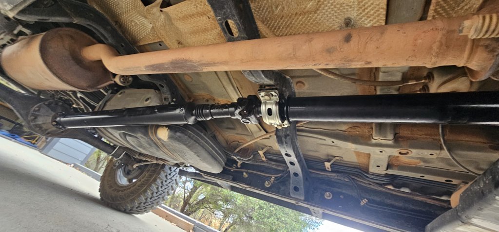

    Rear drive shaft had damage from wheeling so I decided to retube with thicker wall. Also replaced center carrier bearing which was damaged.

    We have different opinions about what constitutes "lightweight" that is sitting atop a vehicle.
    1/2" Unitstrut weighs in at just under one pound per foot - 14.3 ounces to be exact.
    There are seven (7) pieces of Unisturt on the roof of his cab. Five (5) of them are cross bars and look to be ~four (4) feet each.
    4' x 5' = 20 '
    20' x 14.3 oz. = 296.15 oz. / 16 oz. = 17.88 lbs.
    Plus the two long bars that run the entire length of the cab (six [6} feet?).
    So, 6' x14.3 oz. = 85,8 oz. / 16 oz. = 5.36 lbs.
    17.88 + 5.36 = 23.24 lbs. total, approximately, based on best guess of the length of the Unistrut.
    I am told, and this could be wrong, that the manufactures gross weight limit for the roof of a 2nd gen Tacoma is 75lbs.
    With his rack, he has given up 1/3 of the weight he can put on the roof.
    I have never seen a roof rack make of anything other than aluminum, or composite materials, from an auto dealer or aftermarket seller; the above limit tells us why.
    It will not take much to get 50 lbs. onto a rack (6 gallons of water is ~48 pounds).
    My only concern here is safety; not just for the owner/operator of this vehicle and the passengers inside, but for all those on the road in his vicinity should the weight he has on his roof cause a failure that not only impacts him, but others on the road around him.
    What will happen when a vehicle moving at 70+ MPH comes to a sudden, abrupt halt due to an accident? There is a reason they don't want more than 75 lbs. of weight on the roof.
    I see too many vehicles, in the US of A, that people overload with no thought to the potential harm that may result not only to them, but to those around them, traveling at 70+ miles an hour on a highway.

    My uncle drove his 2nd gen 450 miles to me with two 130lb tires strapped to the roof rack. Worked great!

    You can strap anything you want on your roof. So can your uncle and anyone else on the planet.
    But, that will have no impact on changing the laws of physics.

    Dropped it off to get the axles and steering rack done and alignment too.

    lol, why ask him how much it weighs if you are gonna do the math?
    and why criticize if you don’t bother looking up the load rating? Or the weight of a comparable rack?
    he is within a few pounds of aftermarket racks; using your math he is under many of them
