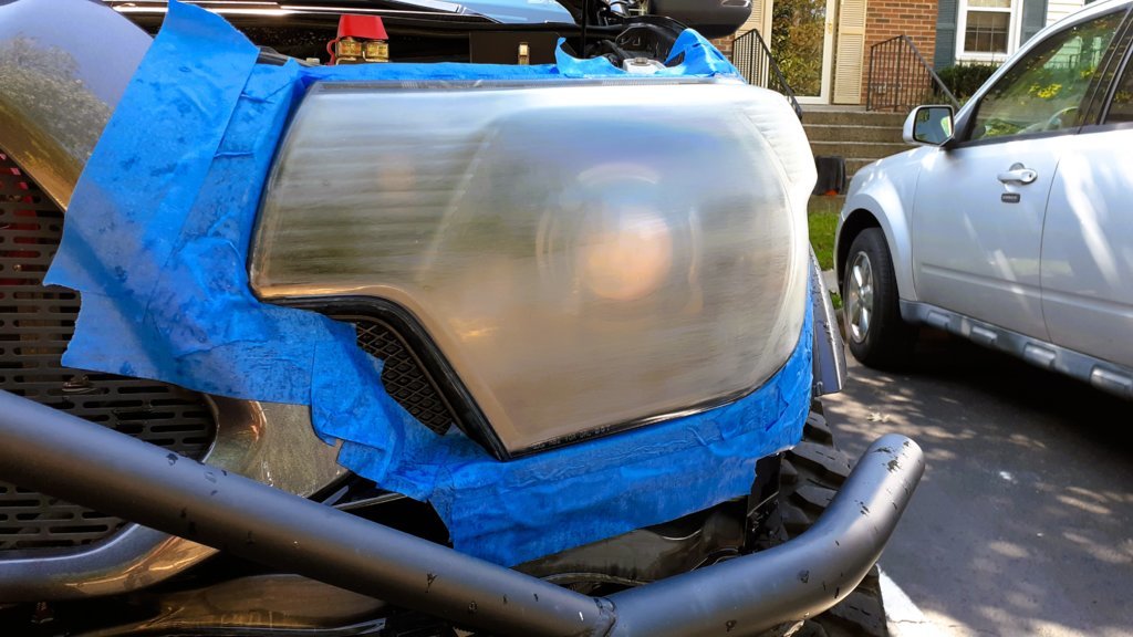

    Cerakote headlight restoration in progress. Guess there's no going back now.

    Be sure to throw on some ceramic coat or clear bra or it will come right back in a year or two.

    The kit comes with a ceramic coat.

    I just did mine 3 weeks ago and wasn’t impressed with the outcome. It left some horizontal streaks on my headlights (after the ceramic coat) that you can kinda see in your pic. Maybe I didn’t follow the directions to the T, idk :notsure:

    Yep. It’s the preparation.

    That’s the thing. They looked great all the way up to putting on the ceramic coat. After using the ceramic wipe horizontally as instructed it looked like crap. Oh well. Guess I have to buy another and start over.

    Yeah. You don’t want to see any sanding marks in either direction. Before putting on the ceramic coating. It should look like this. I now use an orbital sander. With the foam sanding pads. It makes it much easier to get a good uniform sanding. IMG_0251.jpg

    Ah, yeah I’m sure that helps a lot. Don’t have one of those lol.
