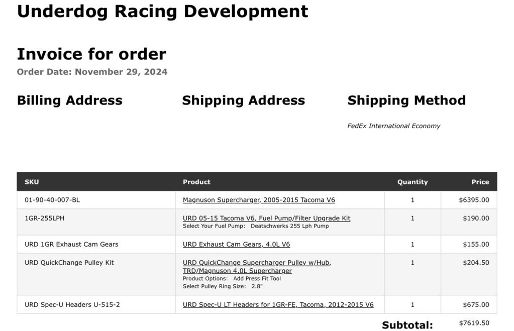

    Does this count?
    jackn7, Bikinaz, reg188 and 2 others like this.

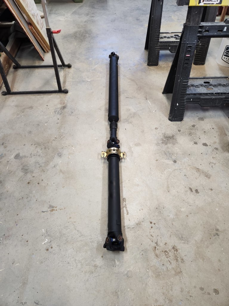

    Pulled the rear driveshaft and rebuilt it with new Spicer joints and a new carrier bearing. Went ahead and wire wheeled it and painted it black while I was at it. Of course I goofed and had to pull a u-joint and flip it to put everything back to the factory orientation.
